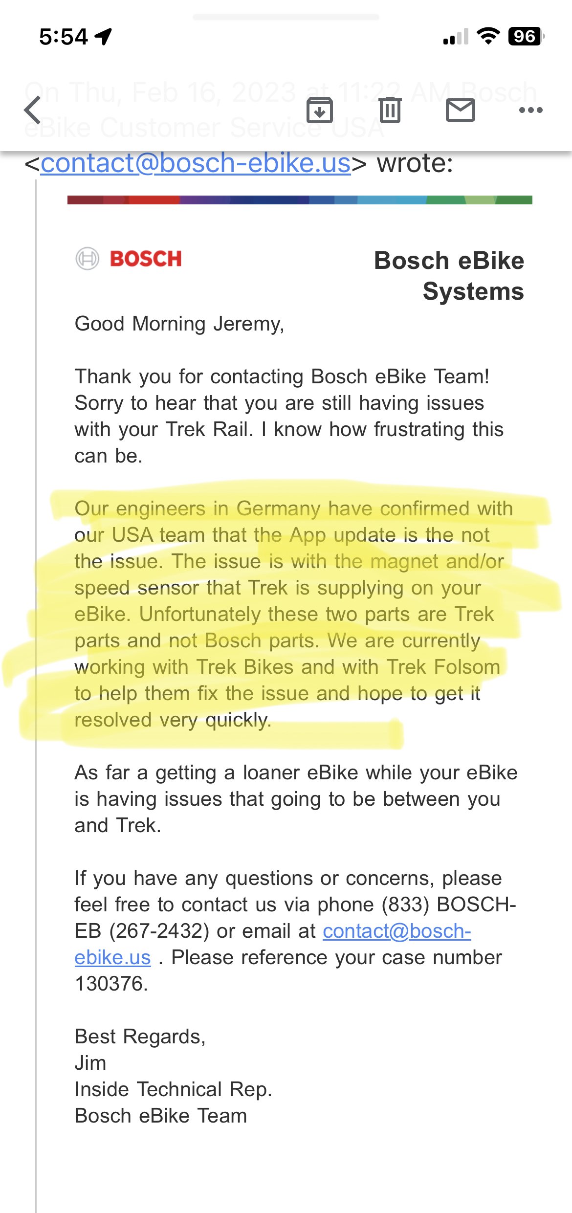

Bosch confirmed it is a Trek specific issue, no rollback of the firmware rolled out.
My Local Trek corporate store acknowledged it’s a Trek issue.

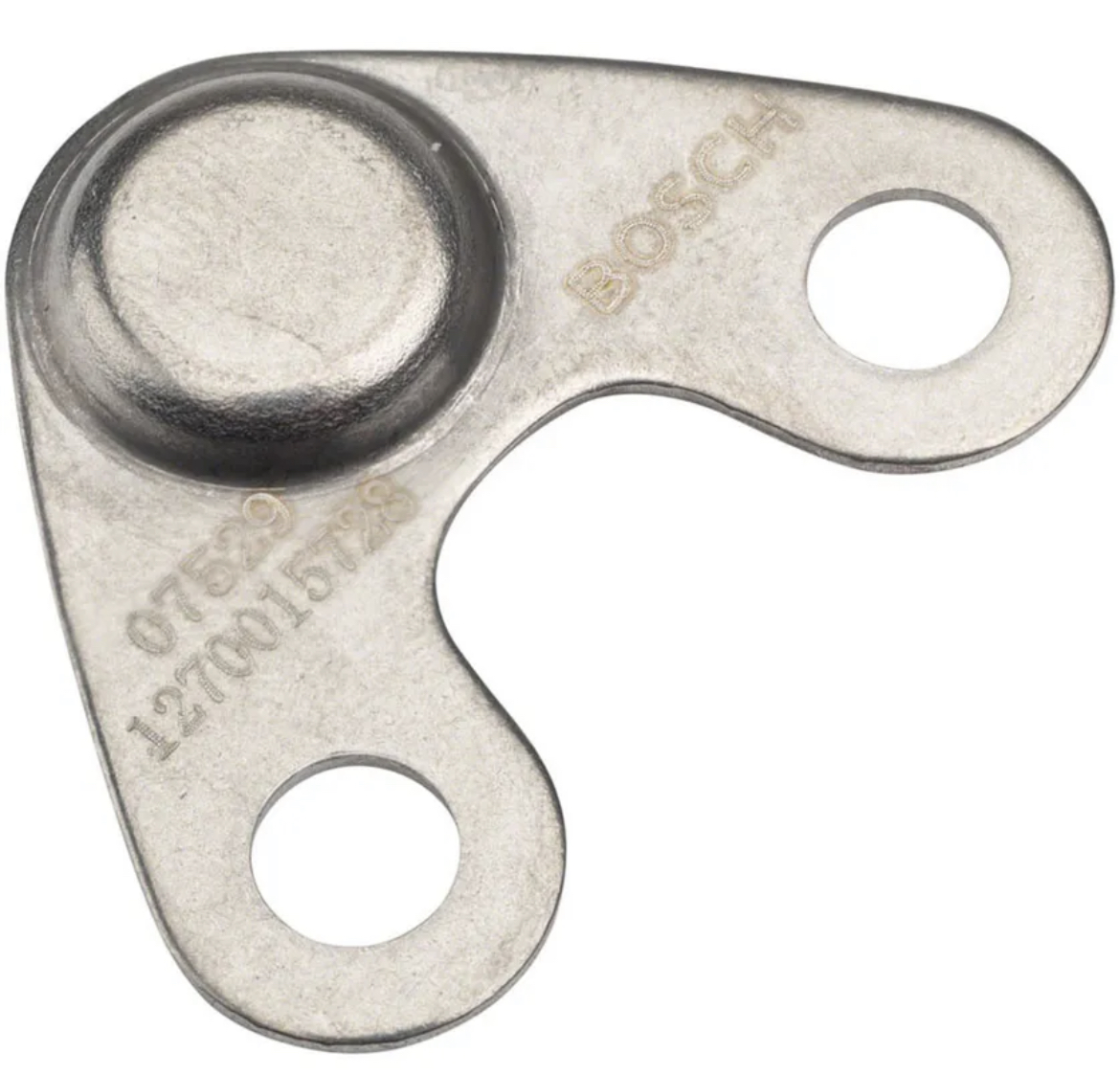

As note on my prior post, to help move this along and solve this together with Trek & Bosch I took my “Bosch” specific 6 bolt magnet (left over from my Orbea Wild FS) to Trek Folsom, they installed it on my 2022 Rail 9.8, & unfortunately no dice.
Which means it only leaves two options
1. Speed sensor cable - this is being swapped on Saturday
2. No solution, Trek will provide a loaner bike until solution it found 😩

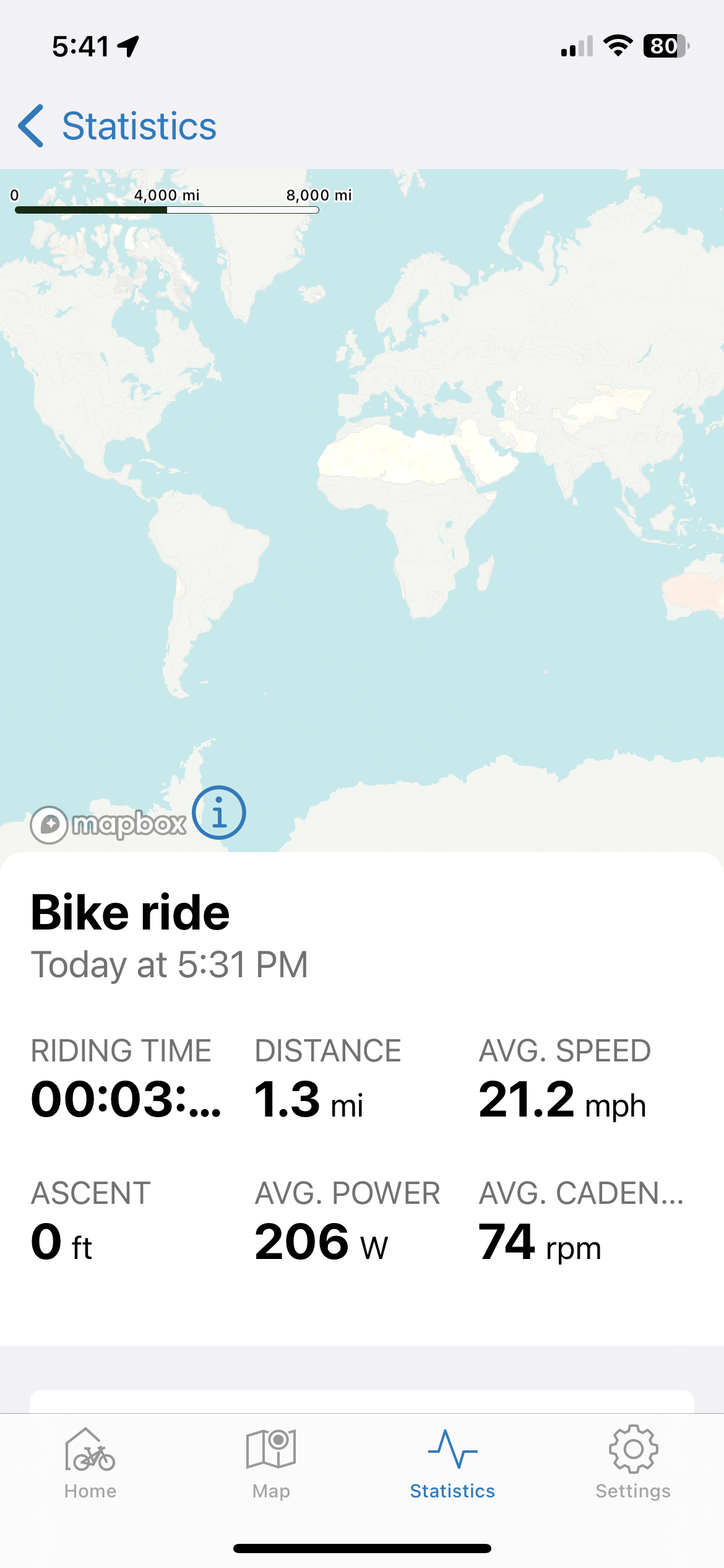

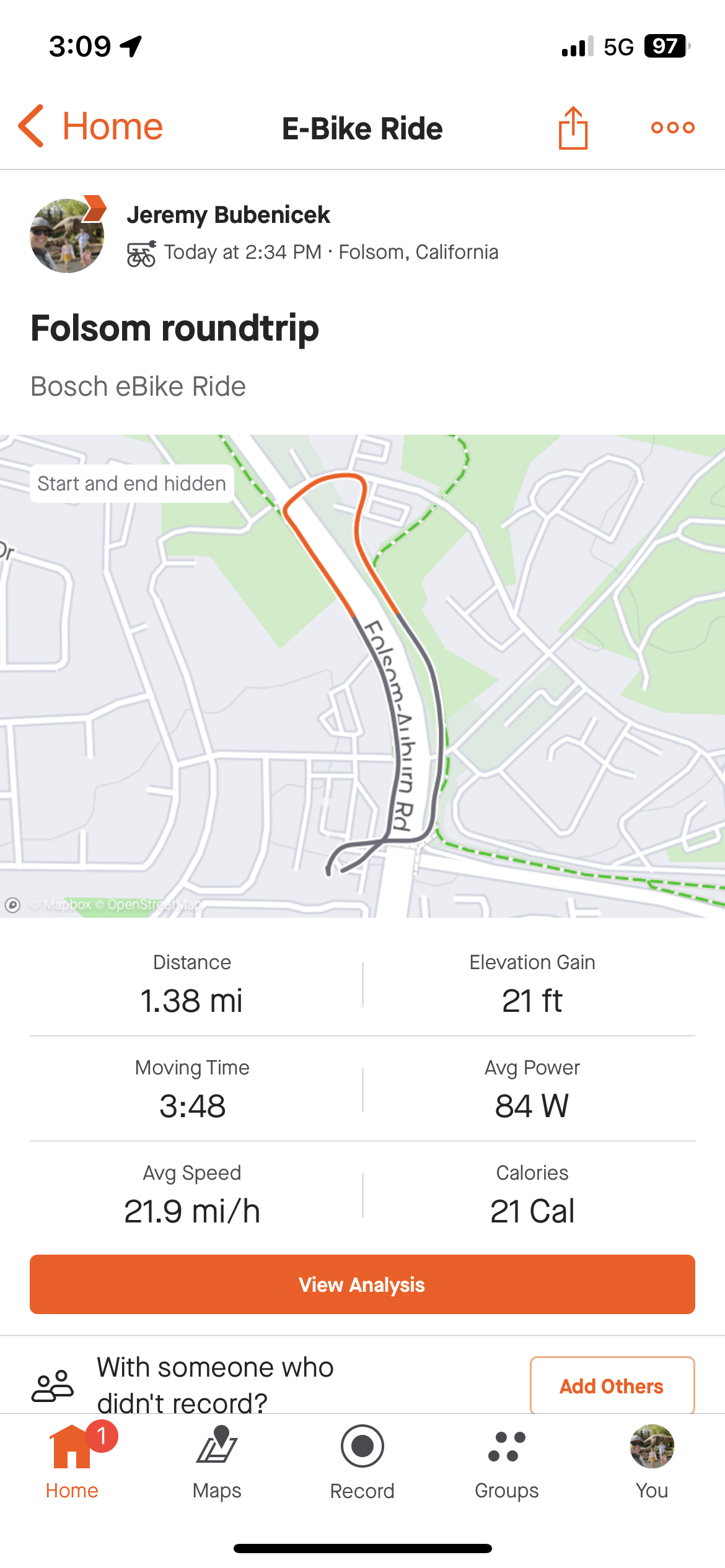

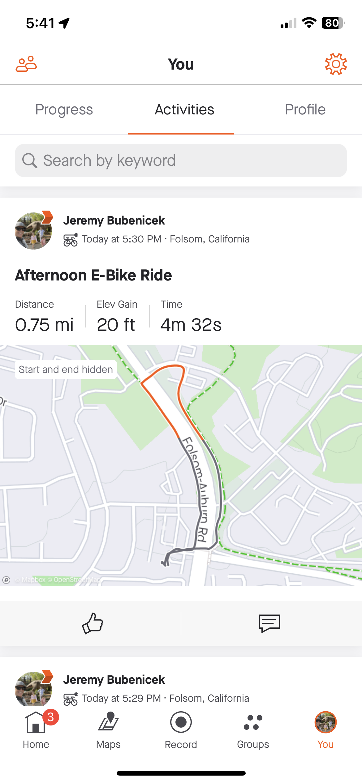

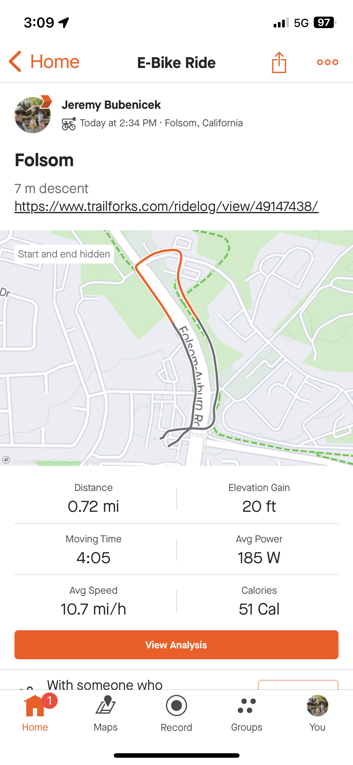

Photos from my starve ride today attached.
5E0C36A9-E98D-4208-9590-C737E16F682E.jpeg 6EE3B898-2FFE-432C-8623-74077A226005.png 0E2E50B8-9539-45E4-A964-E0E377778D7A.png

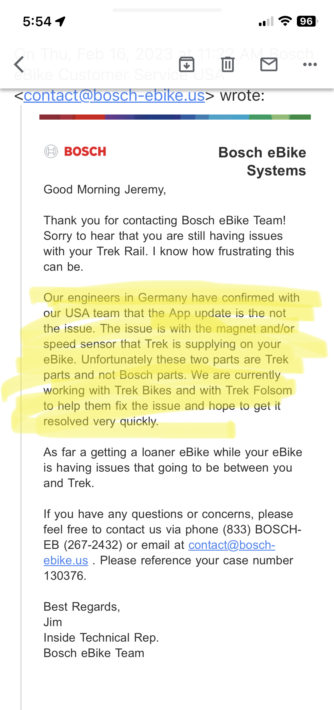

No dice again, Trek swapped out the Trek speed sensor wire and same result, double mile and double speed. The Trek Folsom team is continuing to Work with Bosch tech support and their corporate team to solve the issue after the Bosch Firmware update.
Bosch and Treks current thought is since the issue is isolated to Trek bikes and the only “Trek developed parts” are the magnet and speed sensor cable it has to be the root of the double miles and speed
Bosch offer and Trek took the offer to have Bosch development ship out a Bosch speed sensor and magnet to try on my Rail 9.8gx. Eta is Tuesday February 22nd. Fingers Crossed.

This his is the Bosch 6 bolt Magnet Trek tried on my Rail SS 9,8 with the stock Trek speed sensor cable, no change.
