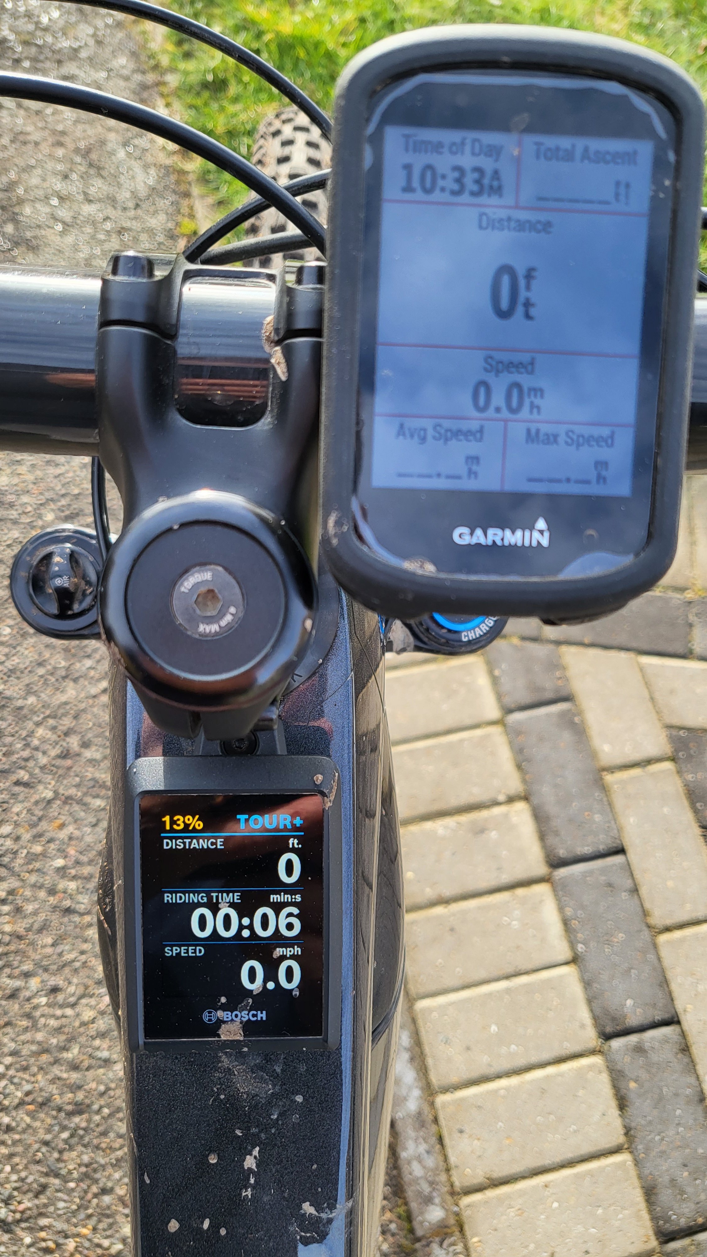

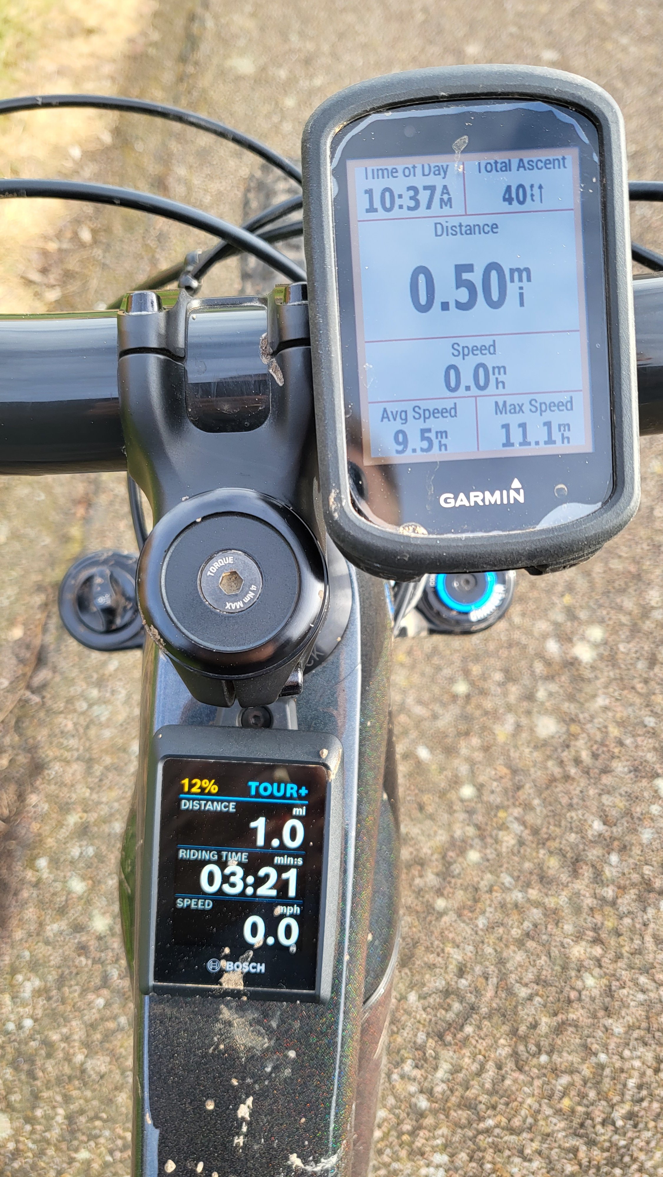

Checked again today, the mileage is definitely recording exactly double, the speed appears to be correct, so don't know what's going on.
Called Bosch they will get back to me.

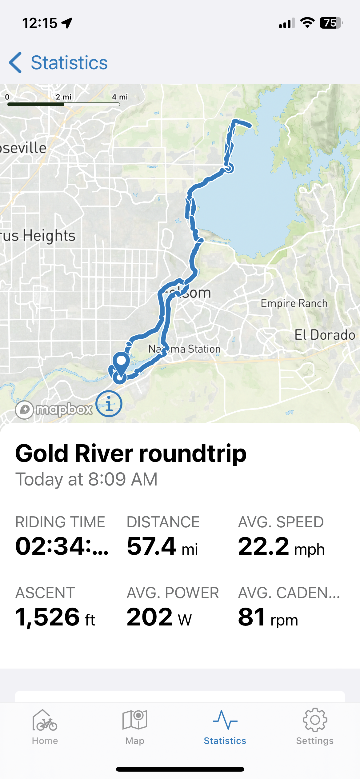

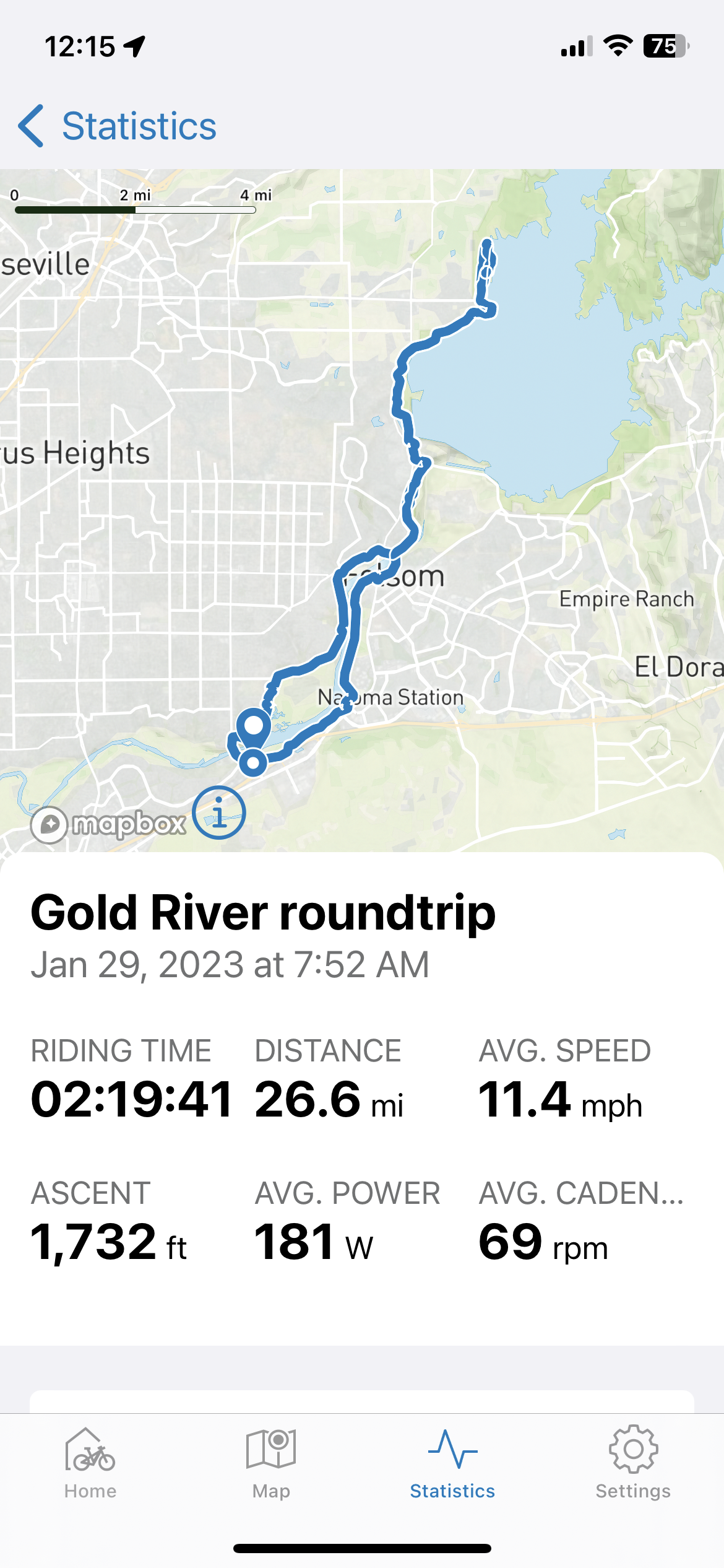

I just got home from a ride. I updated it last night and it did double the miles and speed on mine as well. I called the local Trek dealer in Folsom California and they are unaware of the problem.
see maps attach from prior week and this week, same route and double miles double the speed, BS!
Trek needs to address asap, they are depreciating the resale value!

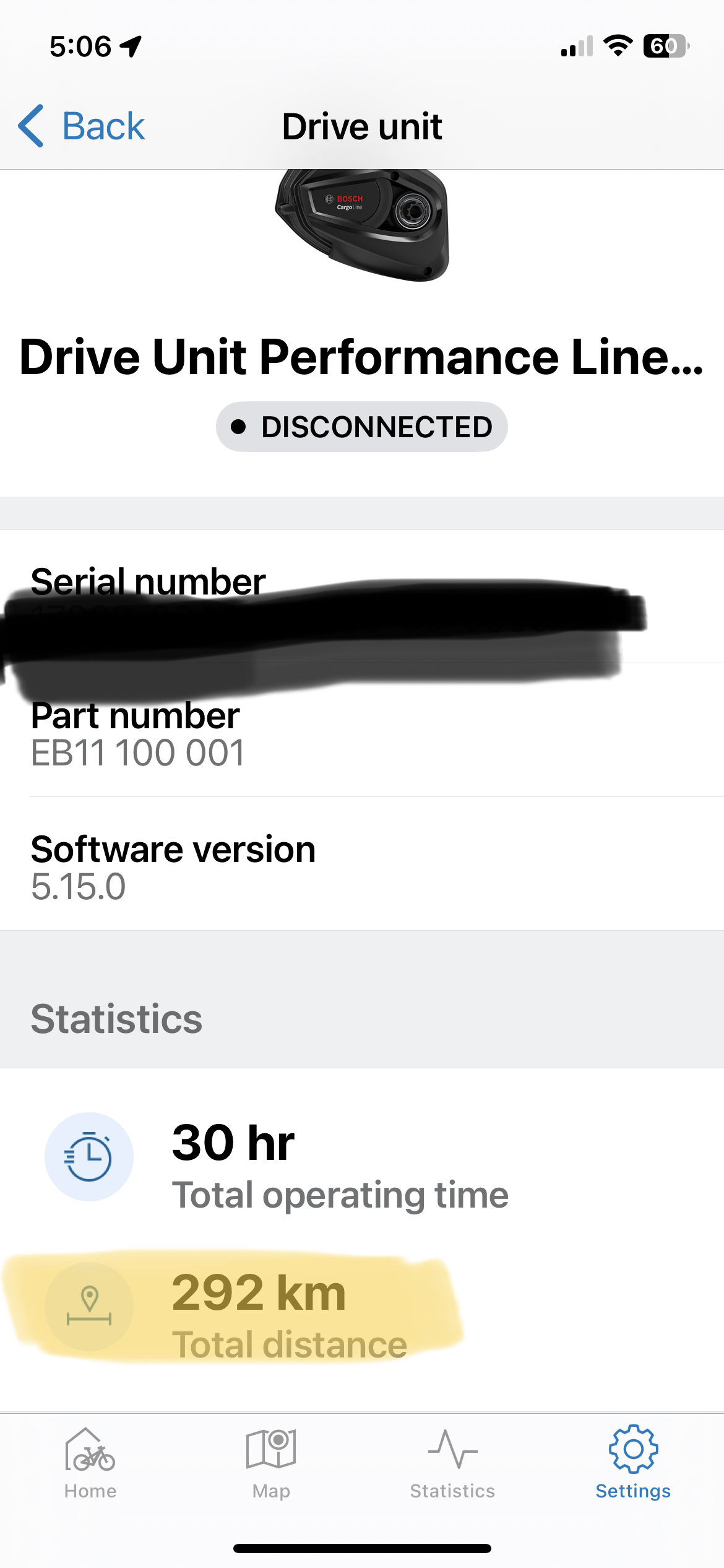

Tested Ibis Oso with 5.x FW and the distance traveled on the Kiox display versus Strava. Were within 5%.

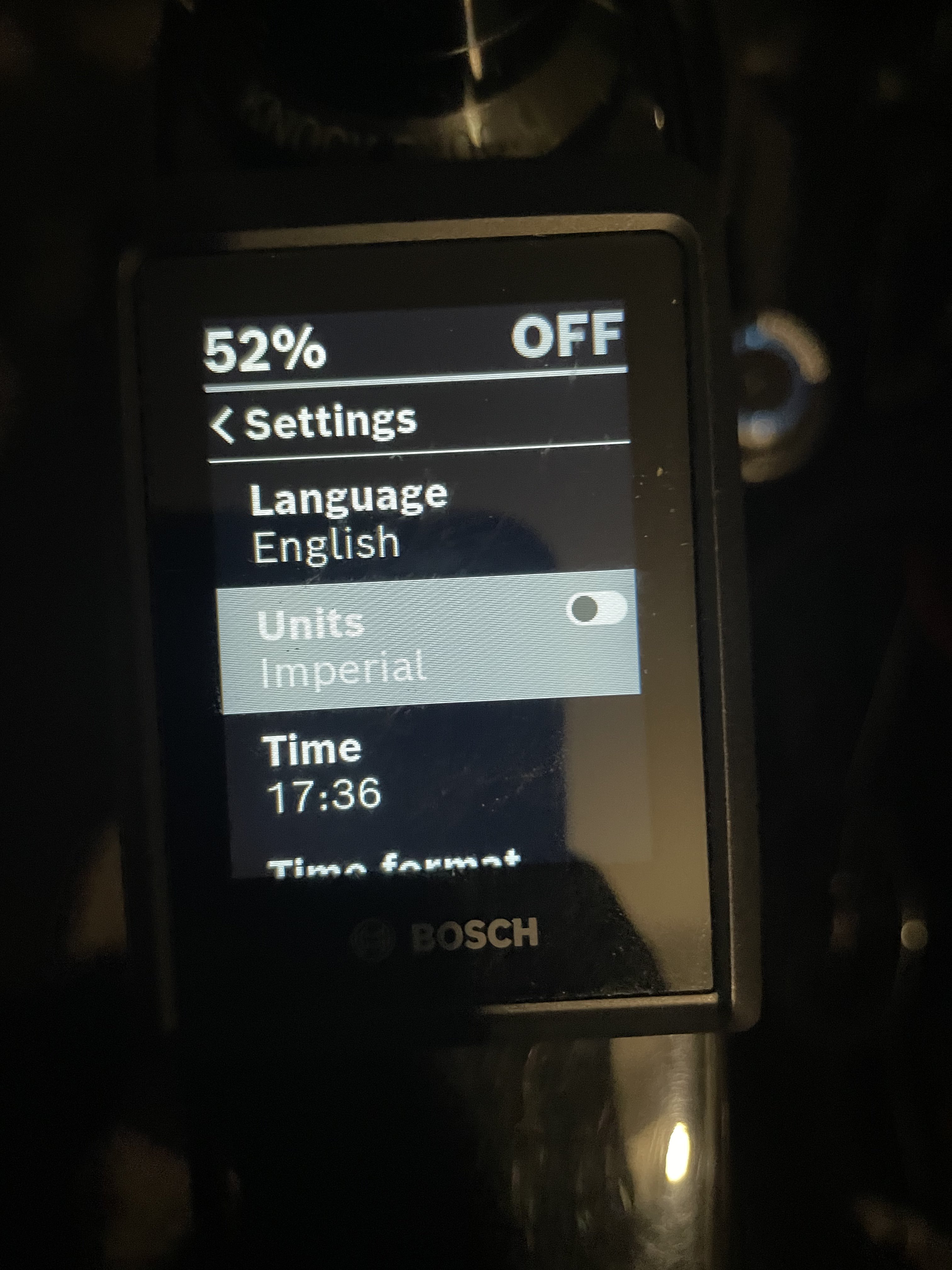

Can you share a snap shot of your drive uint, mime is showing in KM which should be in Miles I believe, i’m in the USA and I wonder if they pushed the incorrect firmware to some folks.

Now I just spun up the rear wheel on my bike stand with the bosch smart system on, I did two full turns of the cranks and the distance I traveled 778 feet, I am thinking it is something in the firmware on the motor and the sensor communication with the magnet, idk, frustrating to say the least.
I also check the units of measure and it is set to imperial.
iphone 12 Pro
