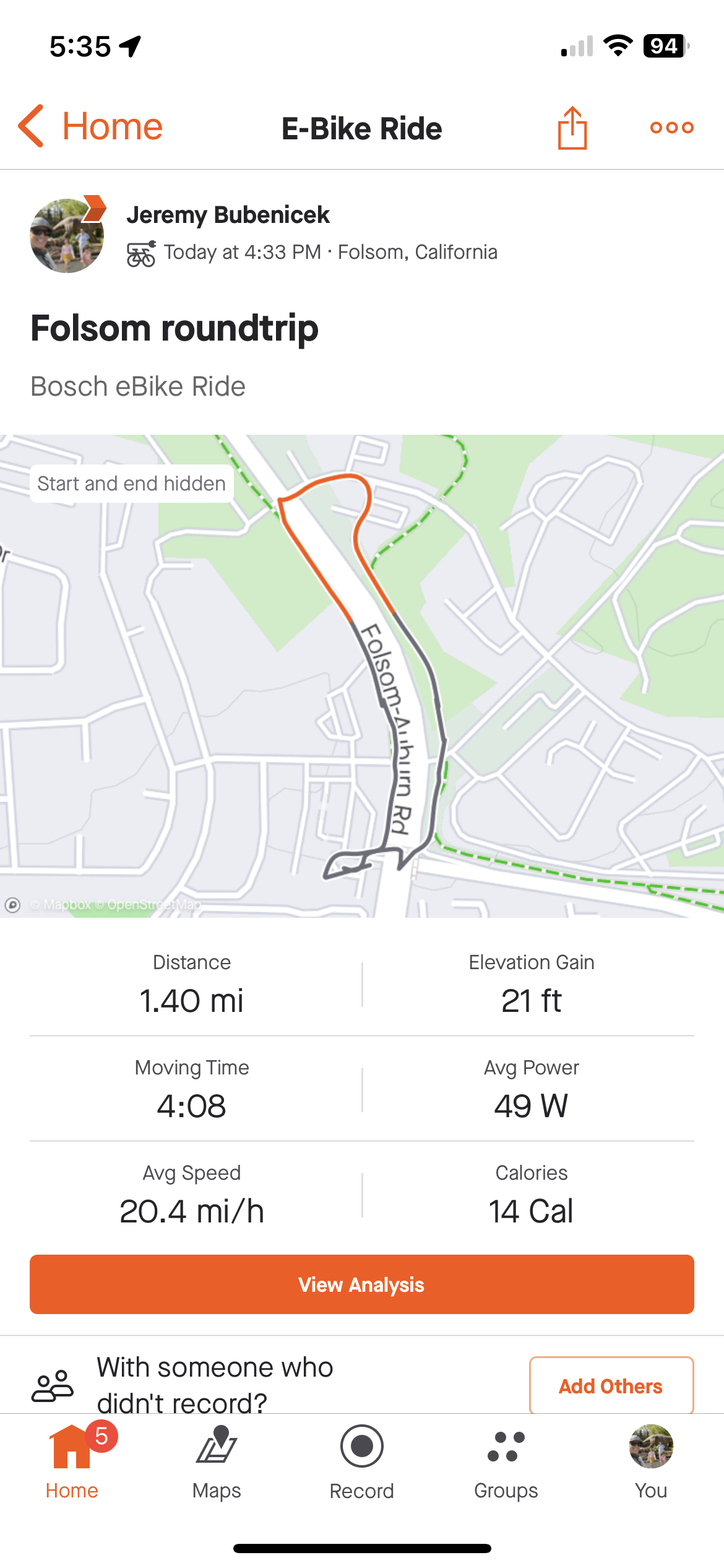

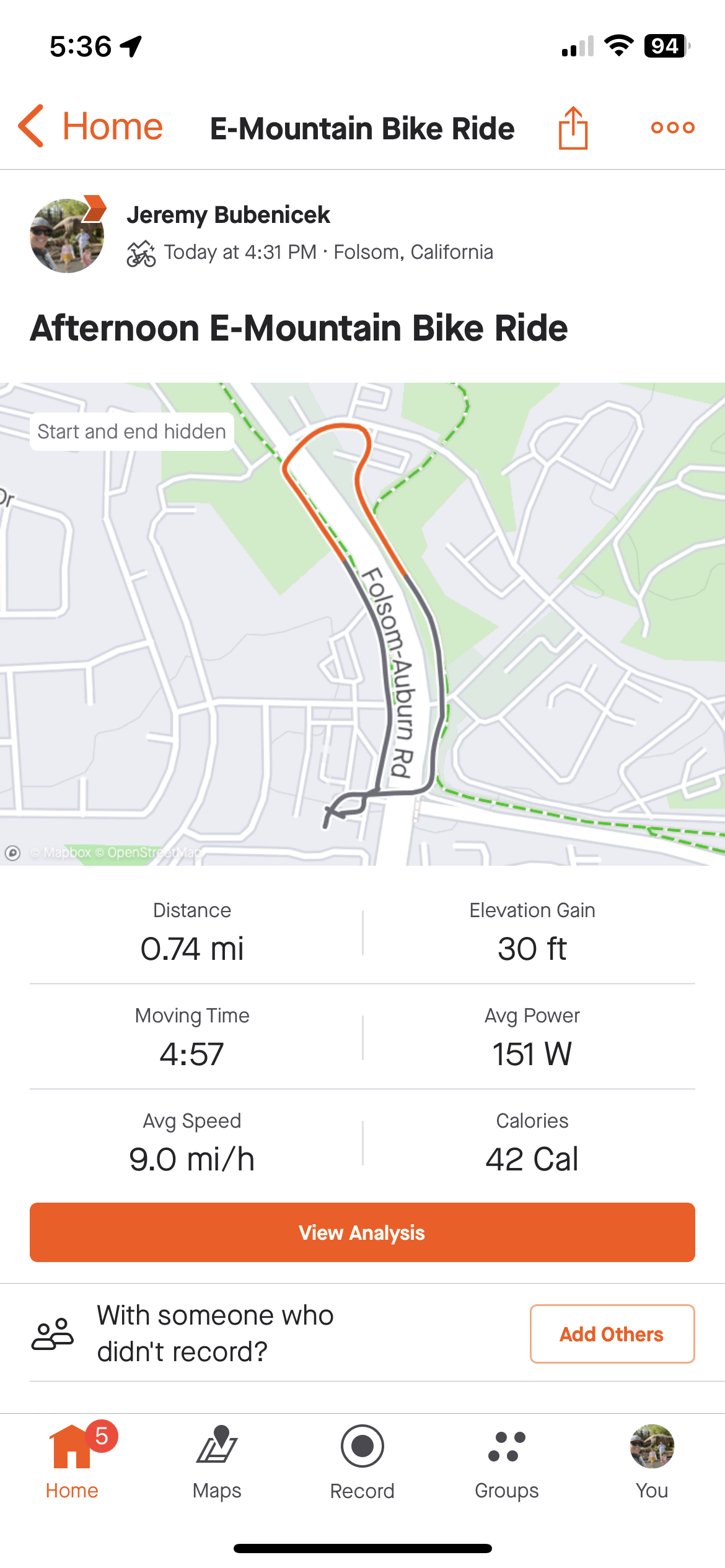

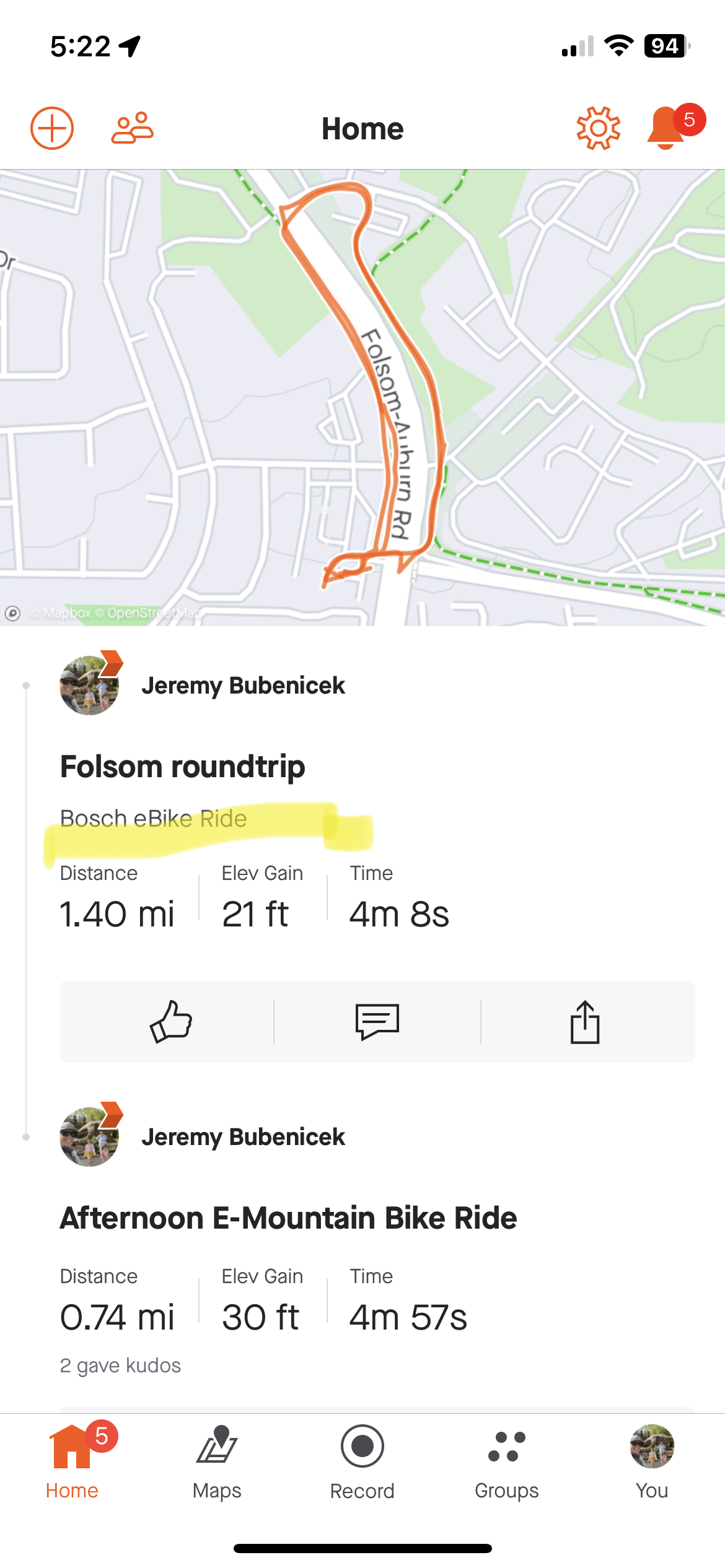

Share Strava images of similar rides or if you have a Garmin use that to compare the Bosch smart system ride.

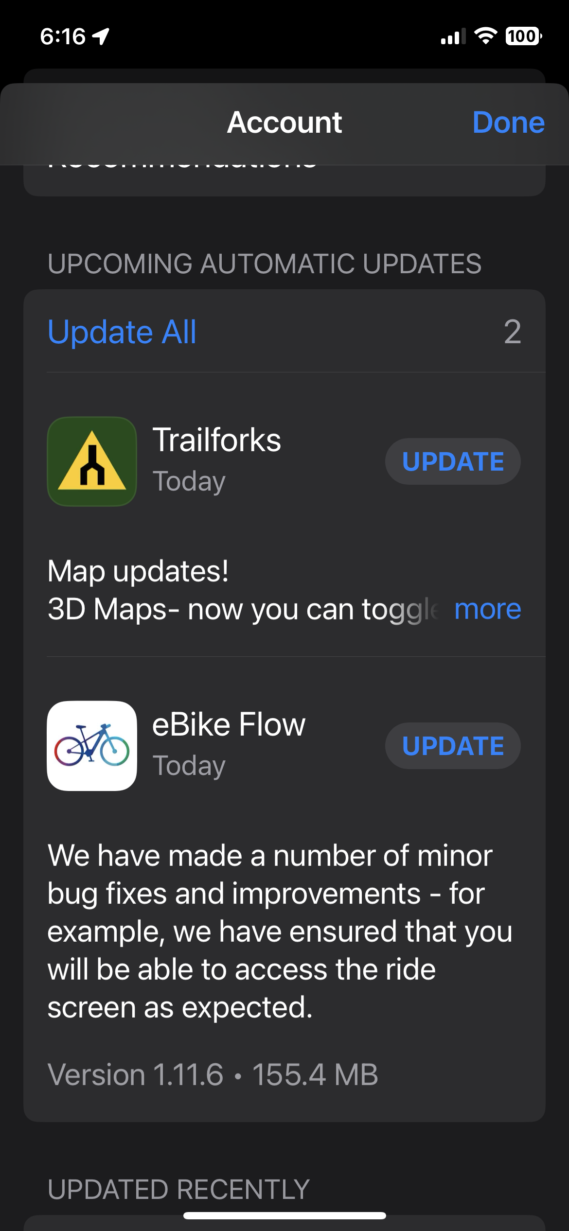

FYI, update from Bosch regarding the resent app update which has been a pleasure to work with and Trek in Folsom.
I contacted Trek Folsom they elaborate on what Bosch said, so here is the deal, per Trek, the NEW elongated magnet on the Rails (with smart system) is double reading the rotation because of the size, this is what Trek engineers which is starting to believe, they are going to install the small round 6 bolt magnet on my bike today to see if this remedies the issue. I hope to hear more by tomorrow.
Note from Bosch:
Hi Jeremy,
The Flow App update that you are seeing is just a normal App update and will not fix the issue that you are having with the Speed/Mileage error.
We believe that the issue is related to the speed sensor or the rotor magnet on the eBike. I spoke to Mike at Trek Folsom and he has already ordered you the replacement parts directly from Trek (non-Bosch made parts) and when he gets them he will be reaching out to you.
If you have any questions or concerns, please feel free to contact us via phone (833) BOSCH-EB (267-2432) or email at [email protected] . Please reference your case number 130376.
