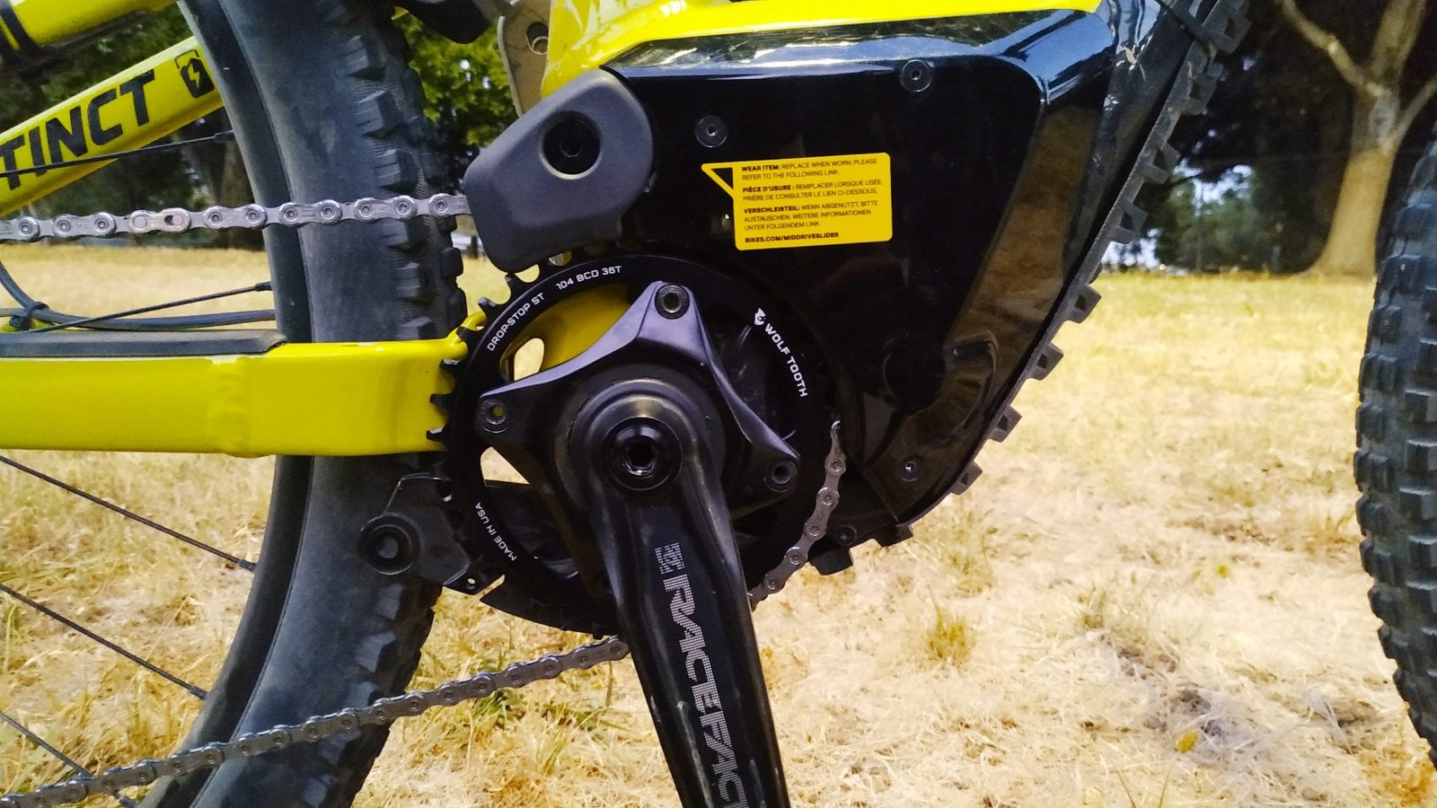

@Common same thing happened to me (twice) on my 2020 Instinct BC. I think, the bike pulls a "Karen" and bitches at you when you smash on it. Issue only happened during the first 3 months. Since then, I've done several major upgrades (like wireless shifter, MTT, coil rear shock, 36T chainring, overtime pack) and it hasn't resurfaced. Going on 6+ months now and still running like a champ.
Oct 22, 2020
47
28
California
@Miscel76 yup the chainring is just normal 104 bcd. i've been using the wolftooth drop-stop st 36 tooth chainring for several months now without issues. top speed is def faster. it also helps that i increased the amperage to 22amps using the MTT. be careful tho because it'll suck up a lot of battery.
btw, you have to modify the cover just slightly to make the 36t chainring fit. search the forums for my post on what to cut on the cover.

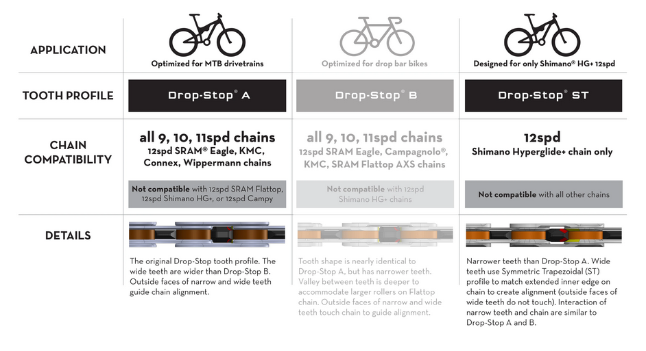

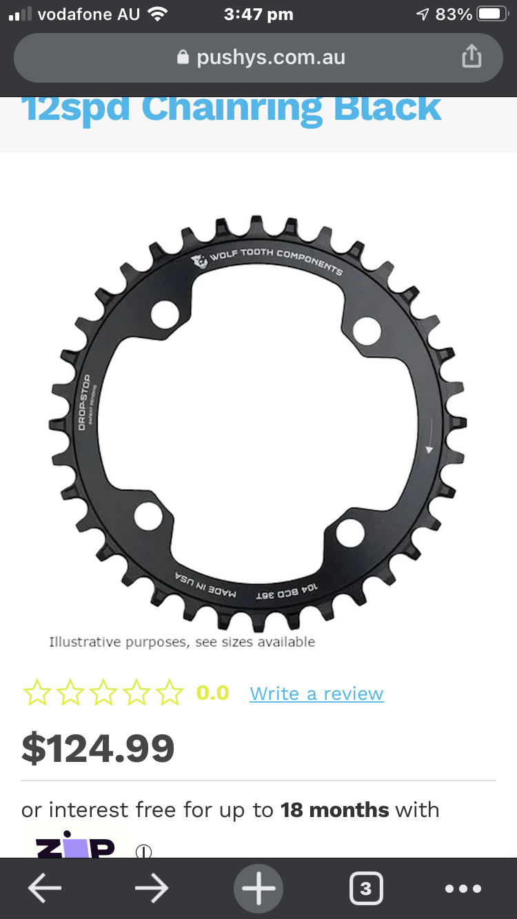

Yep I've tried the 22Amp and went back to stock 20Amp, too much battery consumption. I can't find that chainring in Drop Stop St, I can see is available Drop Stop only.....what "ST" stands for?

Also from the picture I've noticed that you by-passed the small jockey wheels after the chainring, is that alright? I wouldn't mind to by-pass mine if I can
Oct 22, 2020
47
28
California
@Miscel76 you have to by pass the lower chain guide to use the 36t chairing. If you want to have the lower chain guide, replace the small jockey wheel with a regular skateboard bearing. the inner diameter and thickness of the skateboard bearing fits the black screw perfectly. but honestly, you don't need the lower chain guide. the wolftooth chainring prevents the chain from coming off. there are youtube videos on the benefits of drop-stop chainring.

I bought the chainring👍 did you anyway worked out which size should be the bearing in case you wanna put the lower chain guide on? I really ride gnarly stuff at speed and it might be the case that the chain might skip teeth (not coming off) so with the lower chain guide it should be ok
