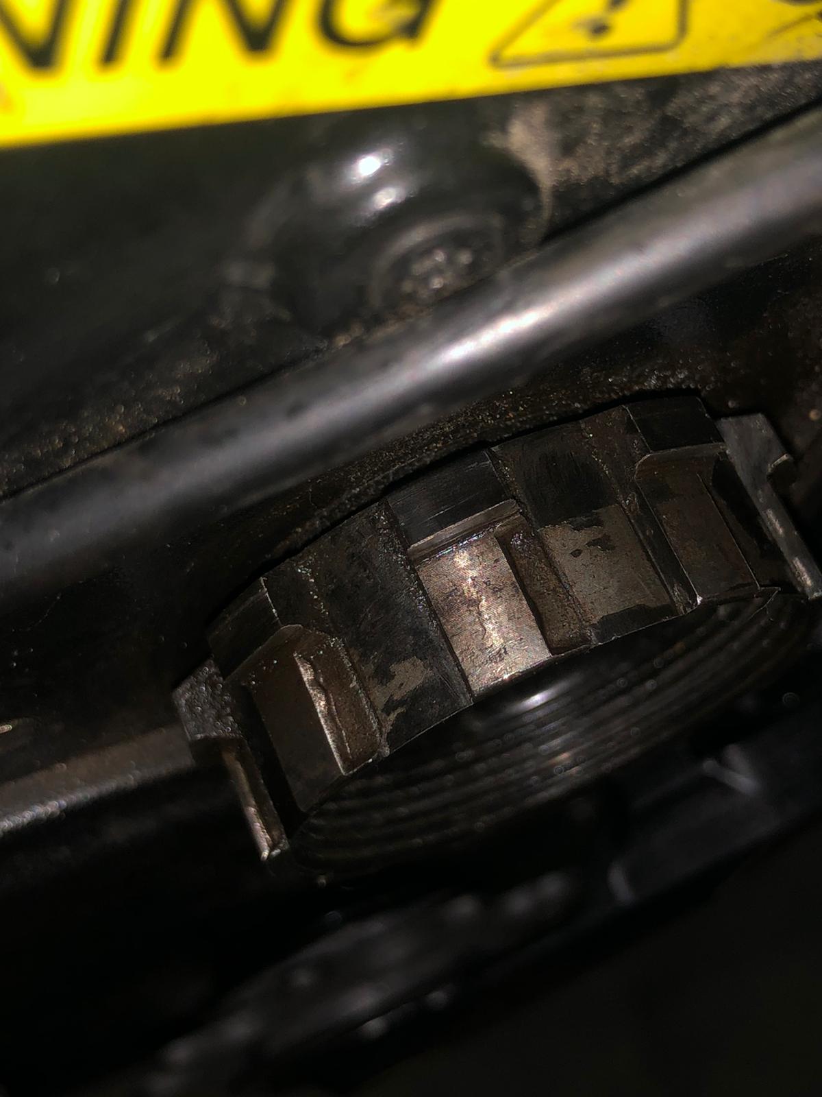

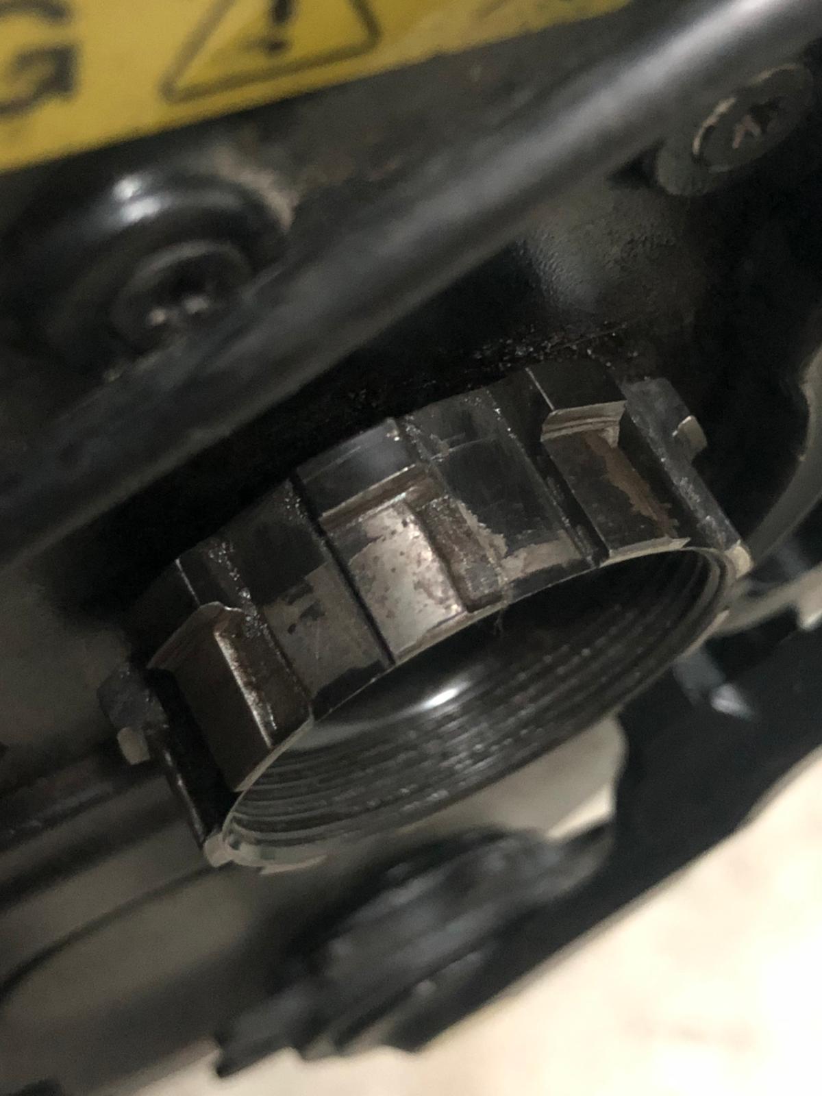

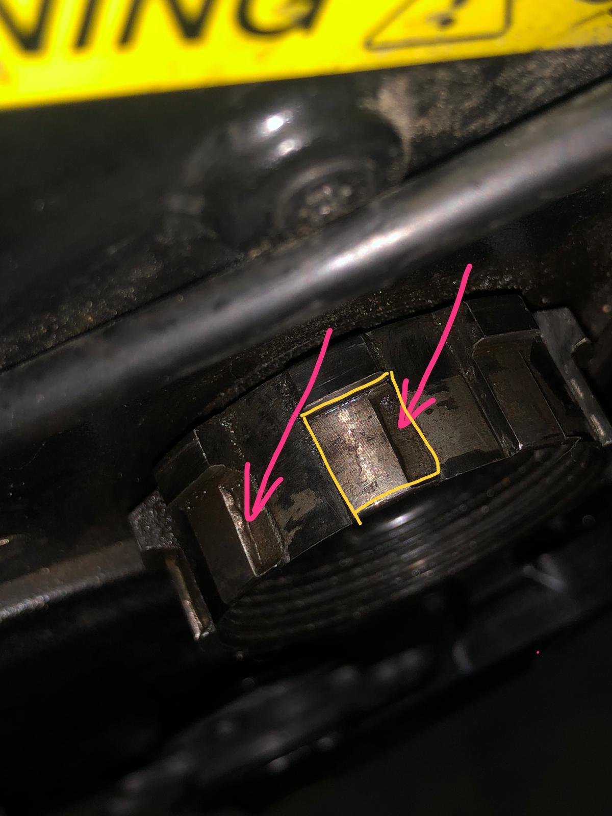

Since I had the common problem with drive cog play caused by a poor and worn lockring contact, I ordered a new drive cog that now comes with a Sunrace lockring as a set.
When I removed the old drive cog, I was surprised to discover that because of the play, the cog splines dug (ate) in the engine "freehub" channels and enlarged these considerably (over 1mm).
While I've seen many lockrings and cogs replaced here, I've never seen a worn freehub like that. Anyone had this problem
What do you recommend me to do ? Is this part replace-able ?
The new lockring seems to have a smaller thread area so it pushes against the cog much better, eliminating any play (at least by hand). The problem with with the old lockring was because the thread area was a little bit bigger and when fully tighethened against the freehub, it was not putting enough pressure on the cog because of the tolerances. The new lockring eliminates this problem but my freehub channels are worn.
What to do ?
Nasty :(
No chance of a warranty claim?
A welder/engineer with a few clues could repair that in place. I could, but am not local to you. Removing the shaft would be ideal for someone less experienced. The lock nut should be holding the cog so it never moves. By the look of that spline, you rode many miles with it loose unfortunately. I would repair it using silicon bronze. If the shaft was removed it could be repaired using tool steel TIG filler, but the extra heat might damage the internal thread. If you contact bikes.com, maybe they can advise where a new replacement could be purchased if no engineering option is available.
Good luck dude.
That looks finished. No way you're going to repair that with a TIG in-situ, the heat will burn out all the seals and, besides, it would want machining afterwards anyway. Best get the motor stripped back and the shaft replaced.
no kidding - wtf happened to that _ I d think also that there would have been veeeeerrrry noticable play during riding , no .. . . - kinda like a really worn and sloppy free-hub no. . . . - was this a rental bike or something?
Yeah, they make a clicking noise as the transfer cog moves forwards and back against the spline. It's quite noticeable, but not everyone is mechanically minded. If Rocky made the cog without a chamfered face, this issue wouldn't be.
