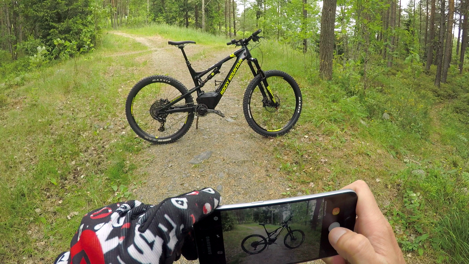

I just rode the C50, the cheapest 2018 with a Yari fork.
Not exceptionally light, guess it was a bit below 23kg with pedals. But it felt light riding it! This is an ebike with proper bike geometry. The Altitude Powerplay has the same geometry as the analogue Altitude. 425mm chainstays! 12mm shorter than Pivot Shuttle It comes with Maxxis 2.5" tyres. 2.8" definitely won't fit. Not sure about 2.6. The Shuttle takes 3.0" tyres, which I think is great for winter riding. The geometry and the motor made this bike feel quite different from most other emtbs. Will be making a first ride review soon.
Price isn't too bad where I live. And aluminium frame bikes are supposed to come for 2019.

I just rode the C50, the cheapest 2018 with a Yari fork. View attachment 2487
Cool!
The motor has about 4 jockey wheels at the front running around the motor - I guess that helps provide a short chain stay too?

Rocky-Mountain_Altitude-Powerplay_eMTB_e-bike-trail-full-suspension-carbon-all-mountain-bike_Powerplay-motor-detail.jpg
Yeah, putting a regular crankset behind the motor should help a lot for chainstay length.
I heard the motor noise immediately. It was a very unusual noise and I assumed it was just this demo bike having lived a rough life. But no. That's how they sound. It's a ticking sound, there was no motor sound/noise. So the electromotor is quiet. This sound allegedly comes from one of these jockey wheels. Possibly the black one on the torque sensor arm. For 2019 they're making the jockeywheel from a different material that is supposed to dampen/deaden the noise a bit. Hoping to test one this fall.
I recorded a bit with a Gopro 5hd blck and I just played the footage. I couldn't hear the noise at all. It definitely is there, and you're bound to notice it. But it isn't loud. It's different. And I don't think it's worse than the usual motor whining noise. I forgot about it once I had to focus on where I was going..
