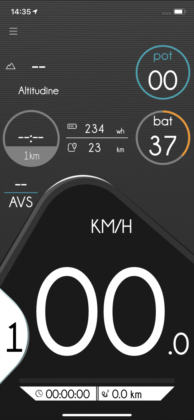

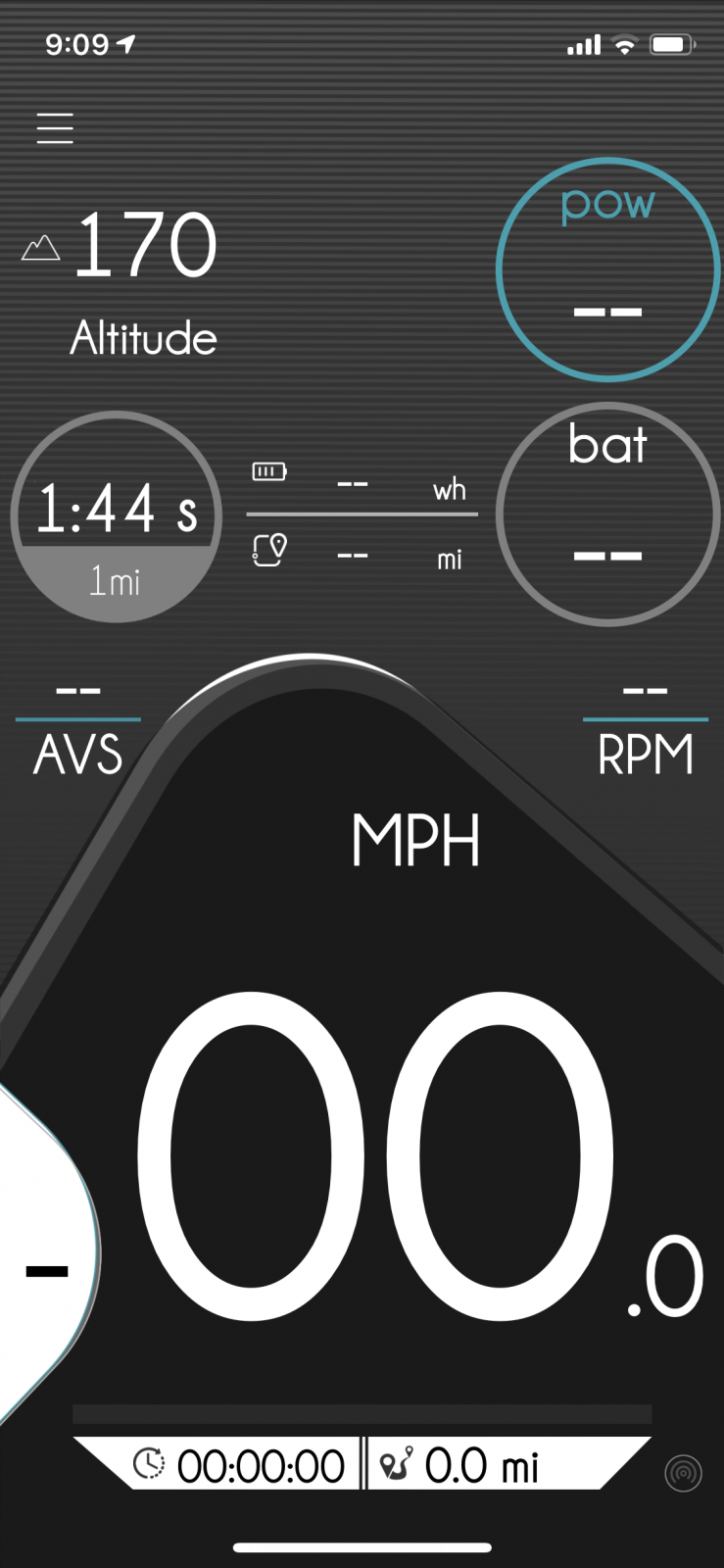

So you can tune with an app from RM?
Any chance of screen shots or links to what you can see with the app please?
Thanks for the feedback.
Yes, you Bluetooth to the bike with the phone app is called: Ebikemotion. I downloaded from the Apple App Store. It allows you to change the 3 power assist levels from 0 to 100. The app also can track your rides. I find it useful to check my exact battery percentage by hitting the voice button and my phone will speak the speed, battery percentage and altitude while I’m riding.

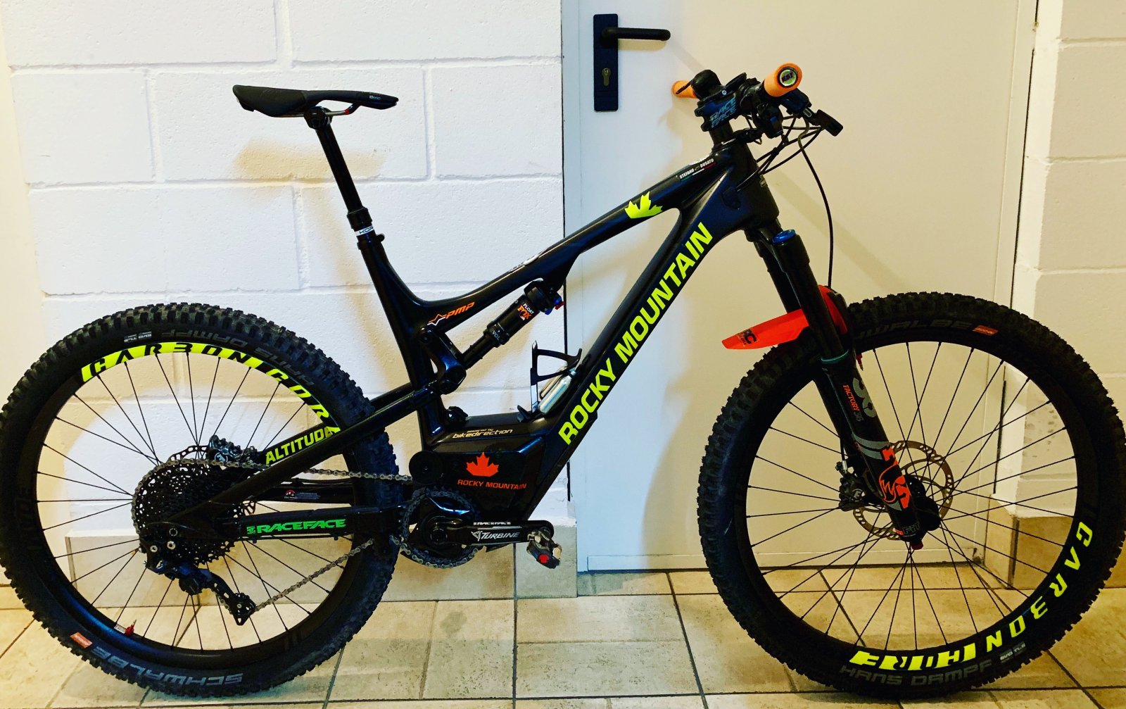

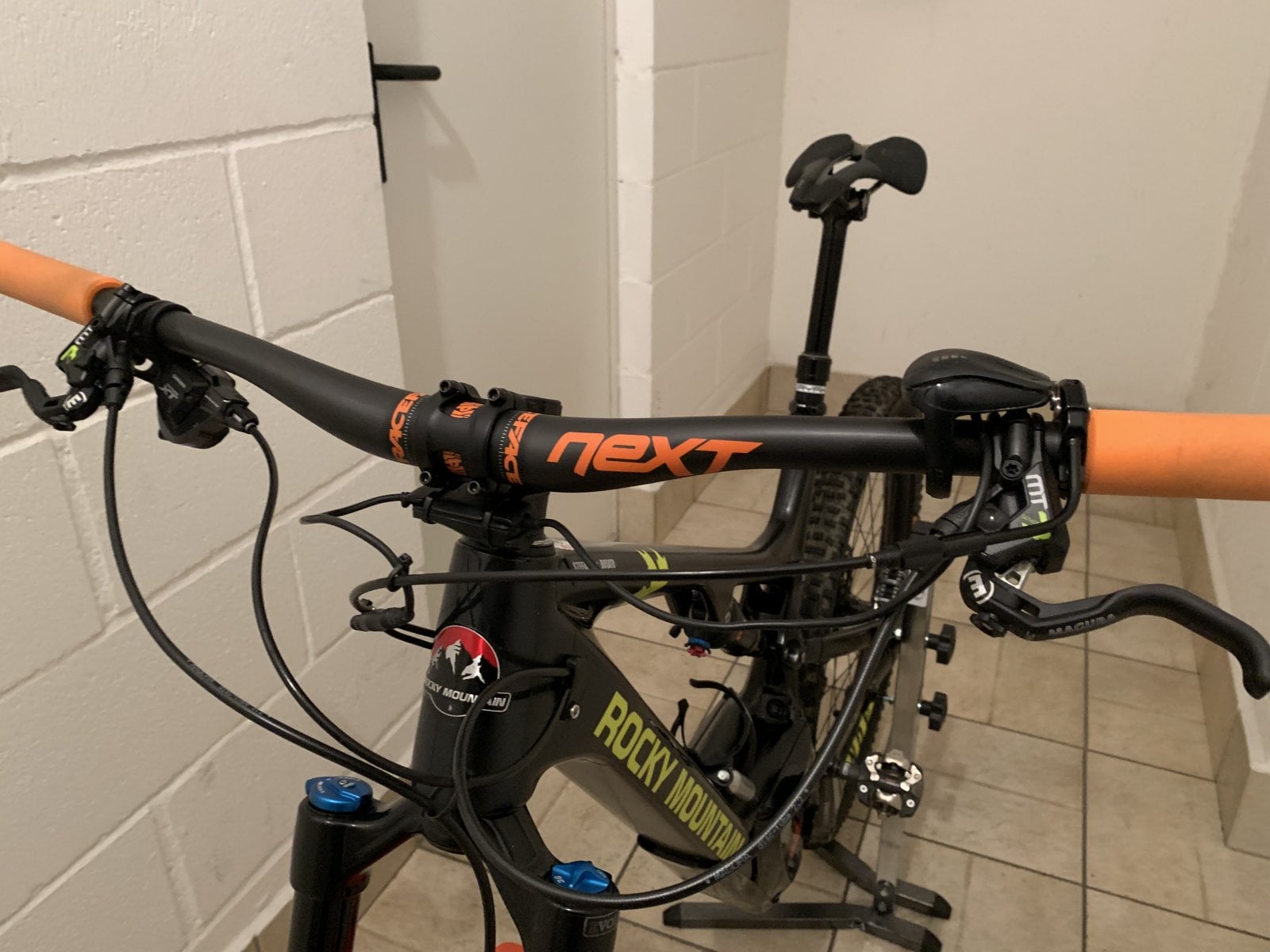

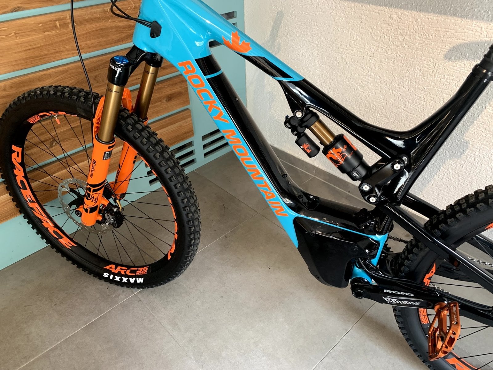

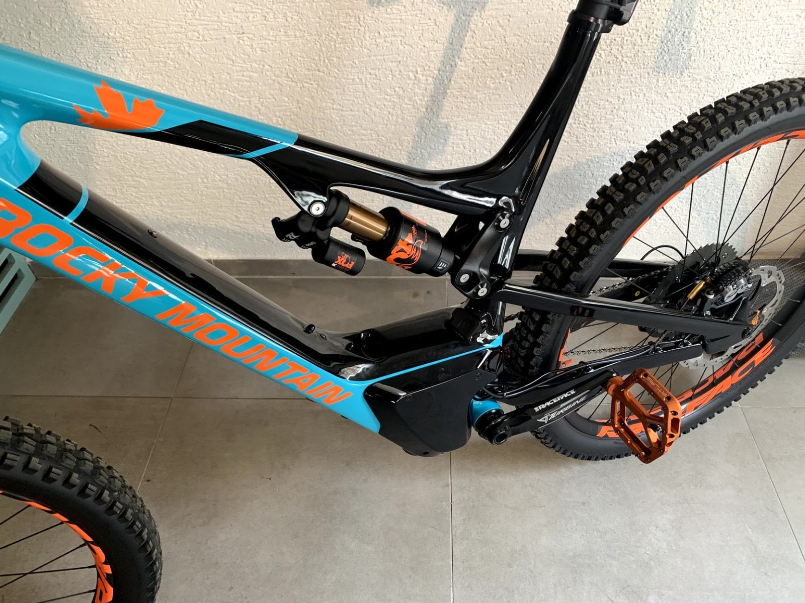

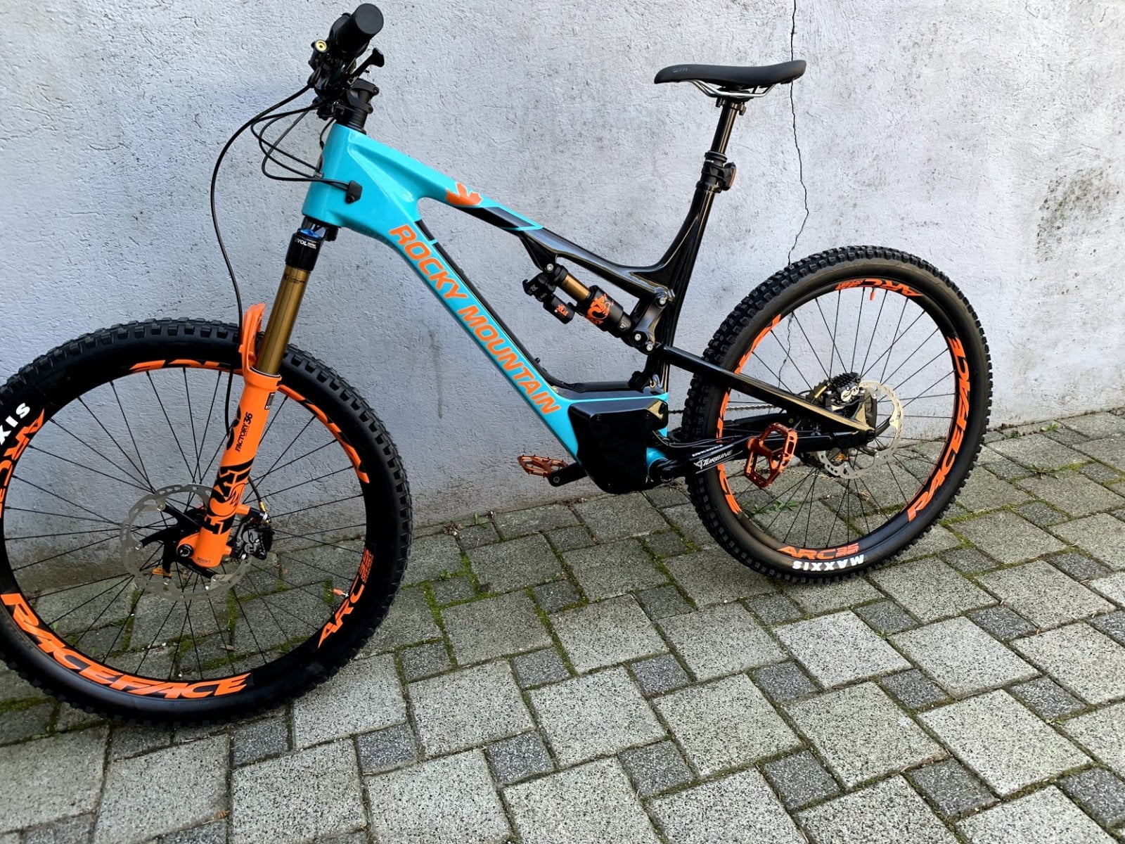

I’ve a Powerplay 70 customized with Magura MT7 180 + 180, carbon wheels from Powerplay 90 with Hans 2.35, Prologo Proxim saddle, RaceFace Next bar rise + 10 mm. I’m not downhiller...One question...if you can help me. Can you tell me where I can buy the powerplay engine chain online? can you tell me how many kilometers this chain needs to be changed?

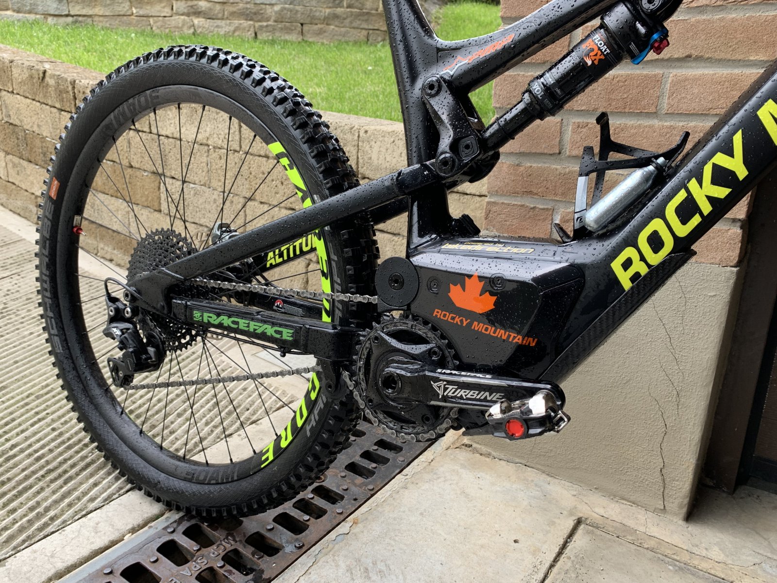

I've 2000 km. I have broken two torque arm in 1500 km (XT drivetrain). Now I have bought the new model...it's much more rigid, I had to increase the engine assistance percentages, first assistance 28%, before 20%.

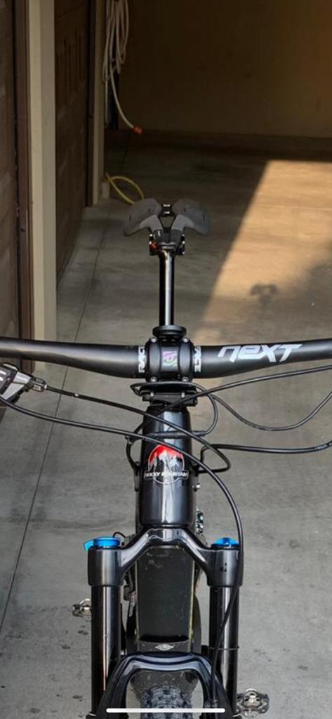

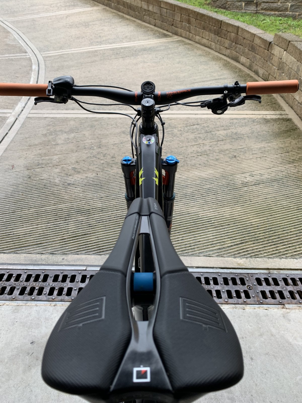

Prologo Proxim saddle...created for ebike..read about it and saw it in a video of Sea Otter Bike Show in California. Can you give your appreciation about it? I'm interested to buy one. I would be happy to heard from real life experience! One saler discourage me to buy it because of the round shape of the saddle..I was told that I will found it very inconfortable...:unsure:
Hi!
I had the Dimension saddle on the XC bike. I mounted Proxim on this ebike and I feel very comfortable. One of the best ever. Moreover, it has a material that does not slide and on steep climbs it helps to stay in shape

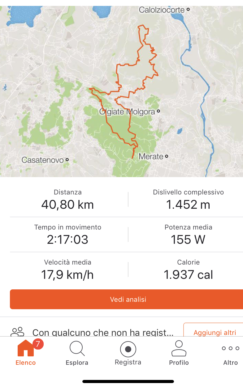

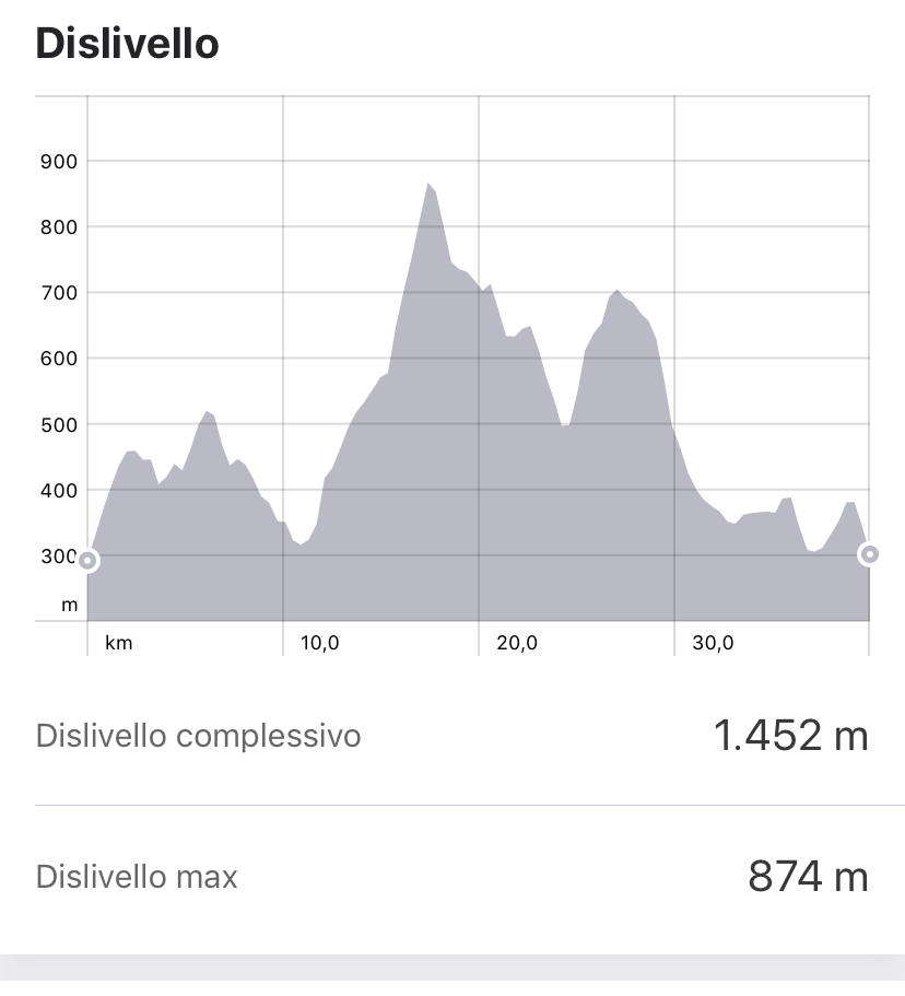

What sort of range are you’s getting out of the c70 model?
Does the app give u predicted kms left?

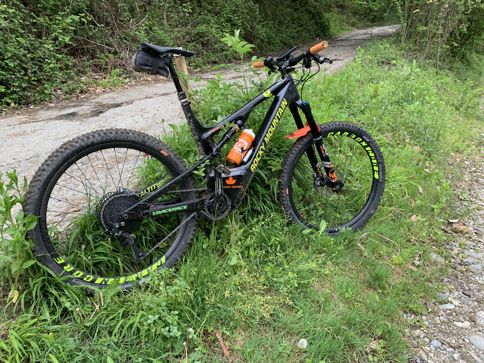

My setting is 28/50/70. Look the pictures of my last ride. I almost always use the first assistance

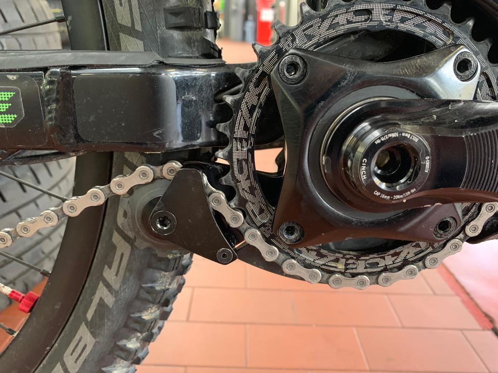

Hi Renato.

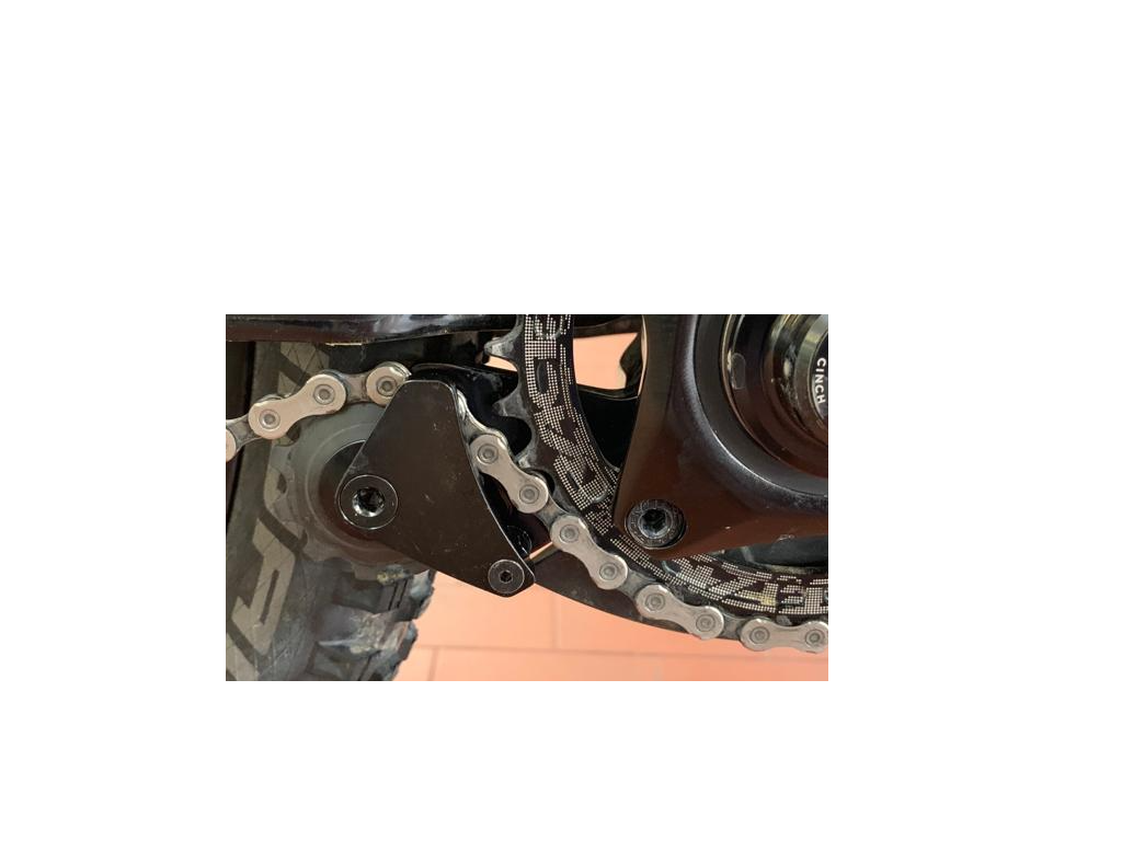

I replaced the torque sensor lever with new model, it's stronger and I replaced the pulley connected to rear arm, now it's connected to engine. This generates less noise, really. Now I have XT drivetrain with Sunrace cassette 11/46 ( 11-13-15-18-21-24-28-32-36-40-46). XT no good (28-32-37-46)
Hi Renato.
