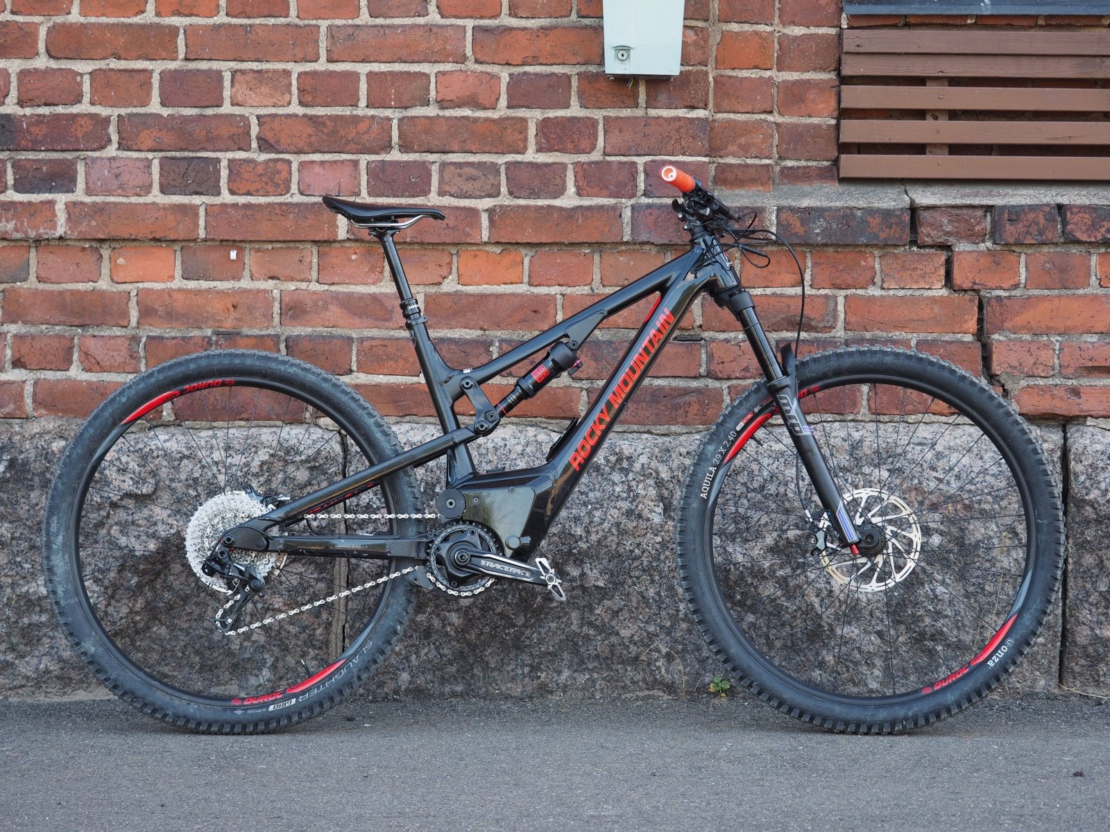

I can start with my new bike. Been riding more than 10 years and now 2 years with emtb. Have had Spectral:ON and carbon LEVO.
I bought Instinct Powerplay Alloy 50 and started to make it to be what I like. So far not so many changes but in some nice stuff is already coming to me.
Fork is MRP Ribbon Coil
Seatpost Reverb AXS(coming)
SRAM Eagle AXS drivetrain(coming)
Syntace/PRO bar and stem with Ergon grips
Specialized Power saddle
Onza Aquila/Spesh Slaughter tires now and Aquila/Aquila when wet trail comes
Not so much riding yet with that bike but it feels awesome! Motor have so much torque and feels super natural.

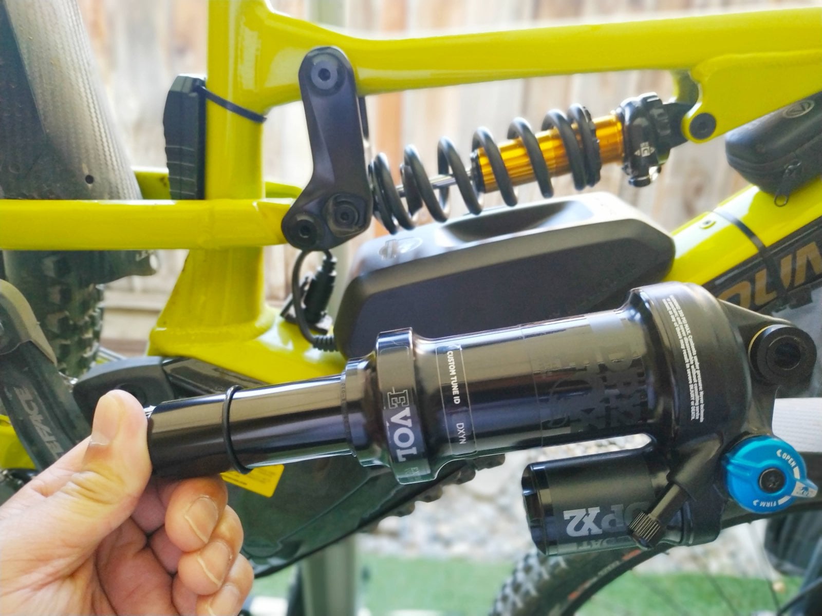

I searched this forum and didn't find any discussion on it but I'm looking for measurements on the rear shock (eye to eye) for the 2020 Instinct Powerplay A50 BC. The original shock is a Fox Float Dpx2 Performance.
I have this bike arriving in 8 days and would like to order a Cane Creek DB IL coil shock and the Rocky Mountain Overtime battery pack so that they all arrive at the same time. By any chance, do you gents know?

210mm eye to eye. Don’t worry if the new one is a bit longer because you can play with the ride9 chip. Many owners ride 170mm shocks and coils at the rear so ...

Thank you all for the assist with the rear shock dimensions.

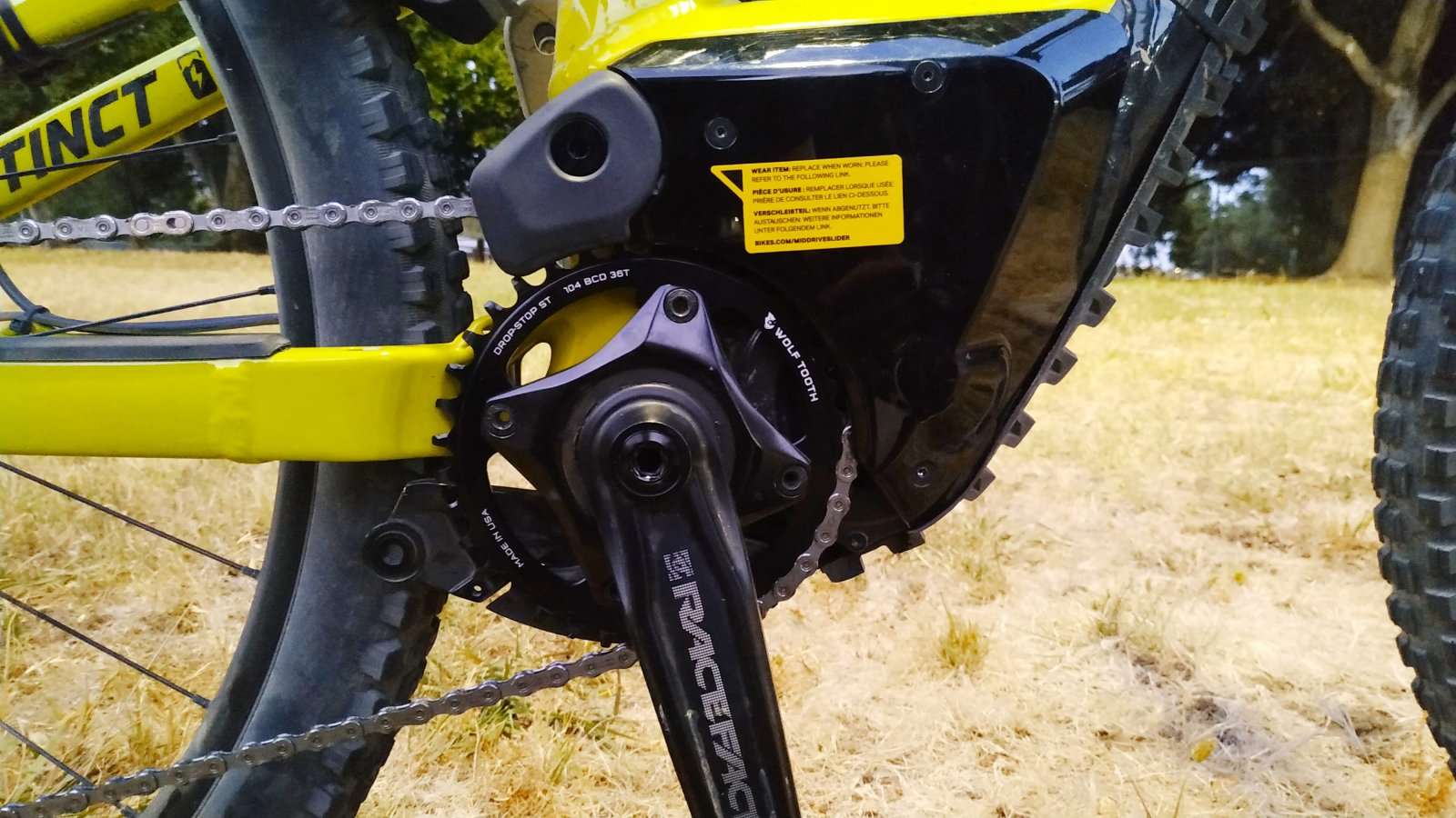

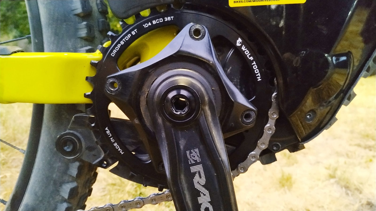

I've been running the cane creek DBcoil IL and Overtime battery pack for 4 months now. I've found that the Overtime pack is the perfect compliment to the Mountain Tuning Tool (MTT). Without it, the main battery drains quick especially when running the motor at 22 amps (1056 watt) using the MTT.
I've been wanting more top end speed so I recently swapped out the original Raceface 34T chainring with a Wolf Tooth 104 BCD Drop-Stop ST 36T chainring. Slight modification to the right motor cover and removal of the lower chain guide are needed to make it fit. Now the bike is twice as torquey and gets to 28mph without hesitation. IMO 36T chainring should be standard on all e-mtb. It makes them run like a beast.
Next mod is to swap out the original 175mm Raceface crank arms with 165mm so I can pedal out of corners faster without pedal strikes.

That looks great!
I was concerned about the reduction of the number of engaged teeth on the chainring when skipping that lower chain guide.
More wear is certain, but after around 7000 km mine is still in a very good condition. So a bit more should not be the issue.
Also good to hear that the sensor still works as it should with the 36t chainring. I think this is why it feels more tourqey.
Tested mine with a 33t and had tp push harder for the same support...
Have you already given the cranks a hard push while hitting serious bumps ? Chain not leaping ?

The chain was a concern so I went to a local high school and rode up 4 flight of stairs, rode down 18 flights of stairs, and did some 2 foot ledge drops and the chain stayed on.
I run the same 36T Wolf Tooth chainring on my 2019 Motobecane (same as Vitus E-Sommet) and the chain has never dropped off. This bike just has STFU chain silencer and no chainguide on it. It was this reason why I stuck with the same chainring.
Anywho I'll continue testing and try to make the chain come off.

Did this ride this morning and took the same route back. I tried to shift under load as often as I could and the chain never came off. It may not come off as long as the clutch on my rear derailleur is on. Also this trail is short and have never needed to bring the Overtime pack on this trail but for testing purposes I used it for this ride. With the bike set up for 22 amps riding at power level 6 (out of 8), it only used 2 battery bars (out of 7).

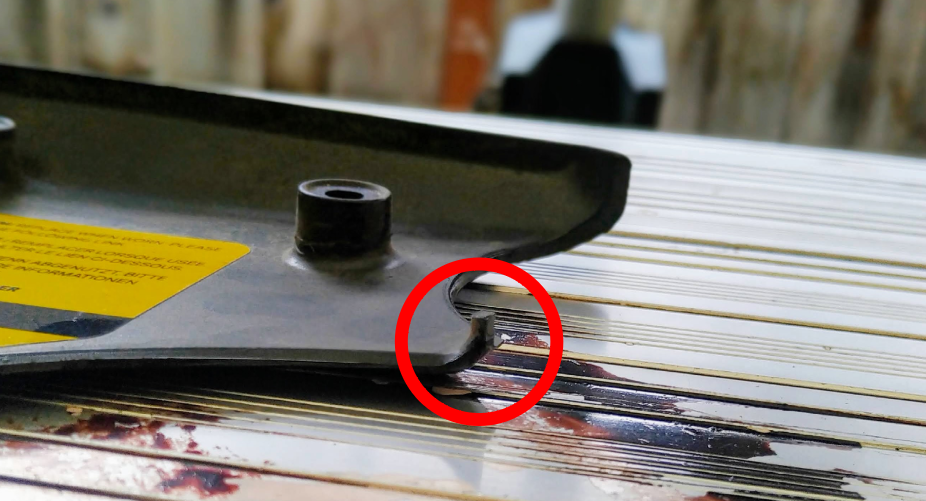

Hi BTaWT, what you need to do to the cover? Trim it? Does the 36 give more power at lower cadences?
Oct 22, 2020
47
28
California

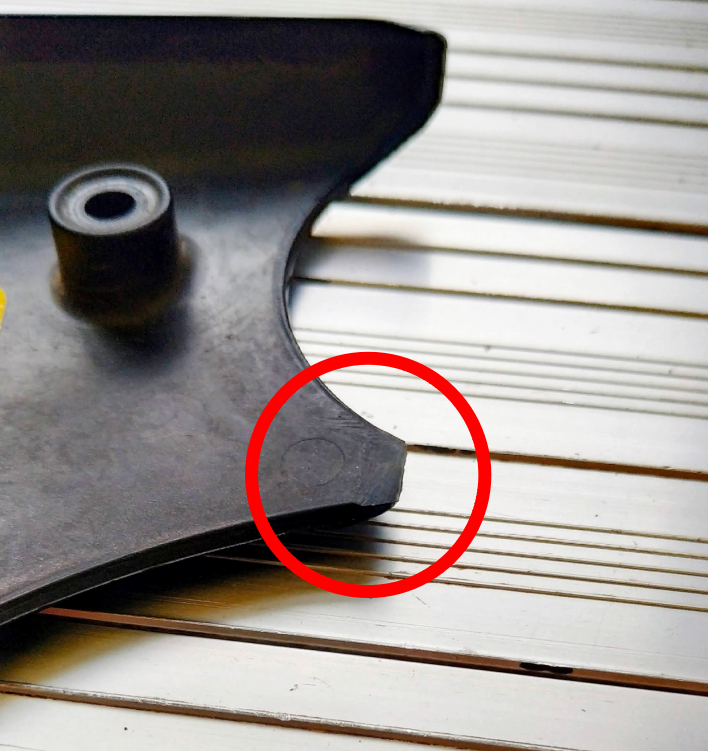

@Eddy Current
see this little piece that's sticking up? trim it.
trim it parallel to the cover (not vertical)
then sand it down or file it down so it's level with the cover
i don't feel like taking a pic of the actual tools i used but i used these

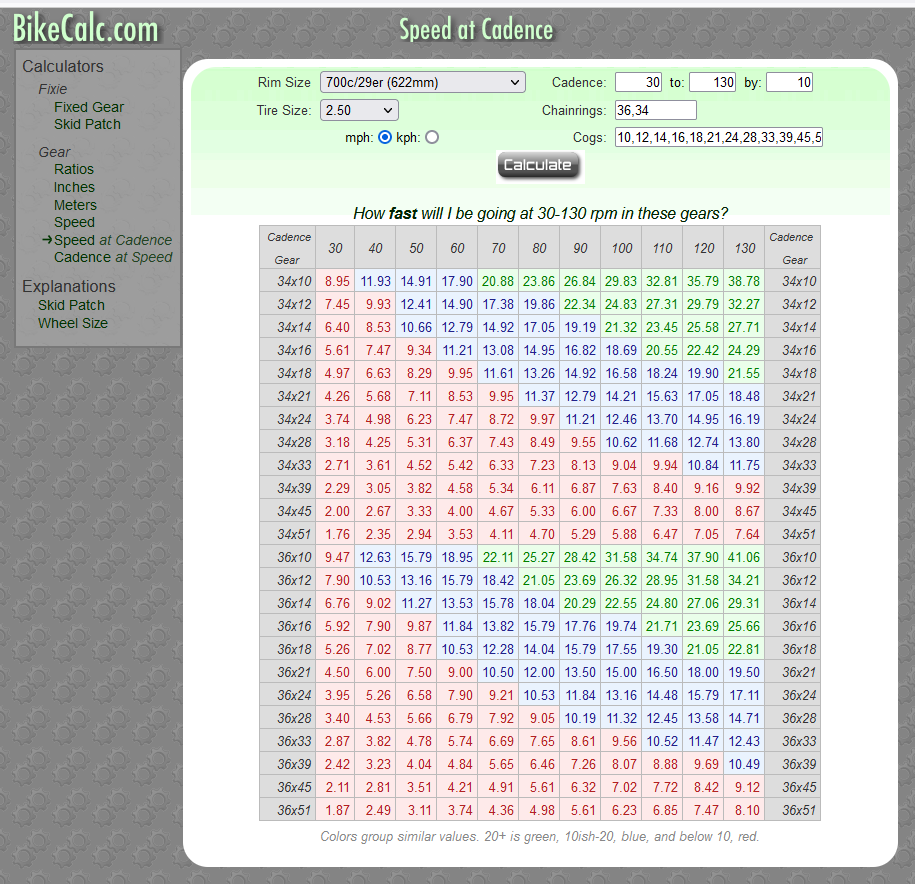

with the 36T (tall gearing), your cadence (rpm) drops when traveling at the same speed
this graph compares the original 34T chainring versus the 36T using these components:
  • original maxxis front/rear tire 29x2.5
  • original Shimano SLX M7000 12-speed (10,12,14,16,18,21,24,28,33,39,45,51)
with 34x10 gearing - at a cadence of 70 rpm, your speed would be 20.88 mph
with 36x10 gearing - at a cadence of 70 rpm, your speed would be 22.11 mph
but if you're trying to maintain an exact speed of 20.88 mph, you can lower your cadence with 36x10 gearing

Different things happen:
  • motor speed changes vs. cadence; your motor spins now 5,8% faster. If I remember well the torque vs. cadence chart you will experience more support at low cadence but you will encounter the peak torque @85 cadence with the 34t. This will now happen @80 cadence already. If you spin the pedals faster support will decrease. But due to the 36t chainring you might be in a lower gear ;)
  • the leverage of the chain with the 36t will clearly cause a bigger deflection of the sensor. With less push on the pedal the output of the sensor is bigger. For powerful riders this might not be desirable because it is possible that the sensor is saturated at moderate pedal input already and the natural feel is lost.
I think subjective and objective aspects mix here; in my case curiosity starts winning...

@nineT larger drive sprocket (chainring) rotates slower. Similarly, on a motorcycle, the rpm is reduce when you add more teeth to the front sprocket. Watch the first 6 min of this vid that explains "tall gearing" vs "short gearing". To make it easier to visualize which chainring rotates faster, put it in terms of wheel size: 27.5 vs 29er.

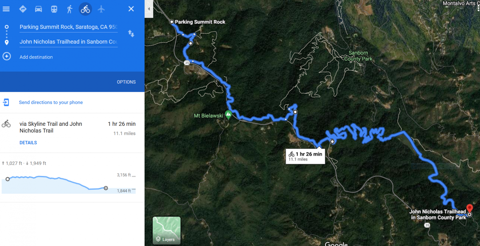

Cheers ! I just came home from a ride and checked out the Sanborn County Park trails at alltrails.com - what a nice place!
Waiting for that 36t chainring...
