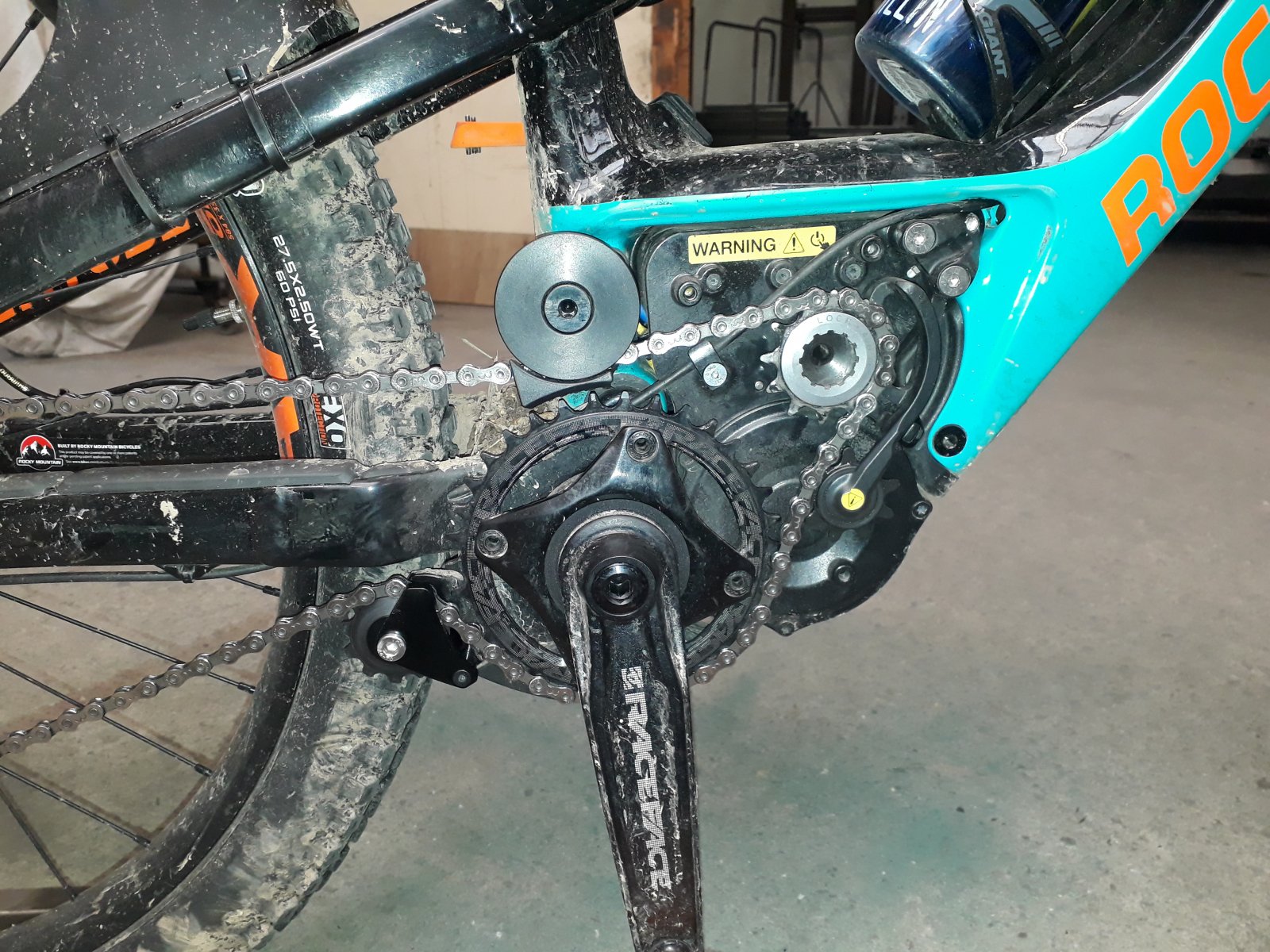

Haven't they changed something for this model year to deal with the noise, sure I read about it somewhere
Upper roller replaced with a slide-guide that pivots a little. Def quieter.

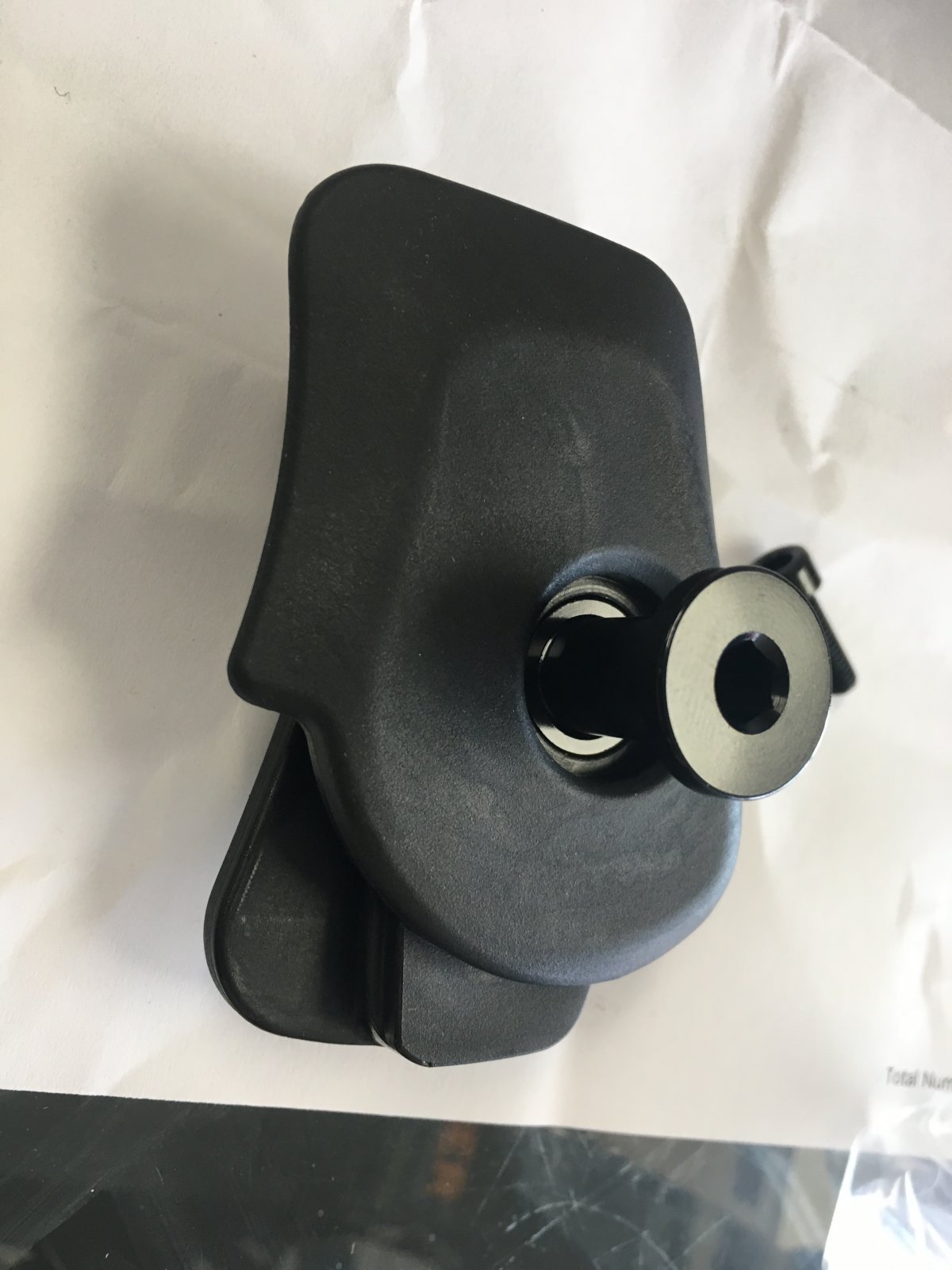

OK about to pull the pin on a 2019 Altitude C70. Looks like one of the last Large bikes left in Australia and reduced by $3000 AUD. Seems I cant justify a 2020 bike now especially with the redesign of the chain guide on the RM. A dealer told me today that RM went through 12 different designs before they settled on the one they are bringing in for the 2020 model and can be retrofitted to 2019.
New Guide

World of difference. Have noticed I need to take it off to clean every few rides as it builds up with gunk. I also pull the cover next to it and clean cogs in there too. Keeps thing running smooth and quiet.
I also had gunk build-up issues with mine. I tried a couple of different lubes but for the last 2000km have been using Purple Extreme. I wash the chain in petrol, dry it with compressed air and then apply a drop of PE per roller. Best lube ever. No mess, no build up, doesn't attract crap, and if you allow it to dry overnight after applying to a clean chain, won't wash off in wet either. 2000km on one XT12 speed chain which is just now approaching the end of its serviceable life. Highly recommended for the RM drivetrain.
The noise doesn’t bother me at all. Is a mechanic sound like the ratchets or some, def less annoying for me than the buzz from a motor. When the time comes to service it I upgrade to the new one but for now is no prob for me at all.
Same mate. I still use the original toothed roller and won't replace til it's shot. I really only notice the noise when I'm riding with friends on their push bikes.

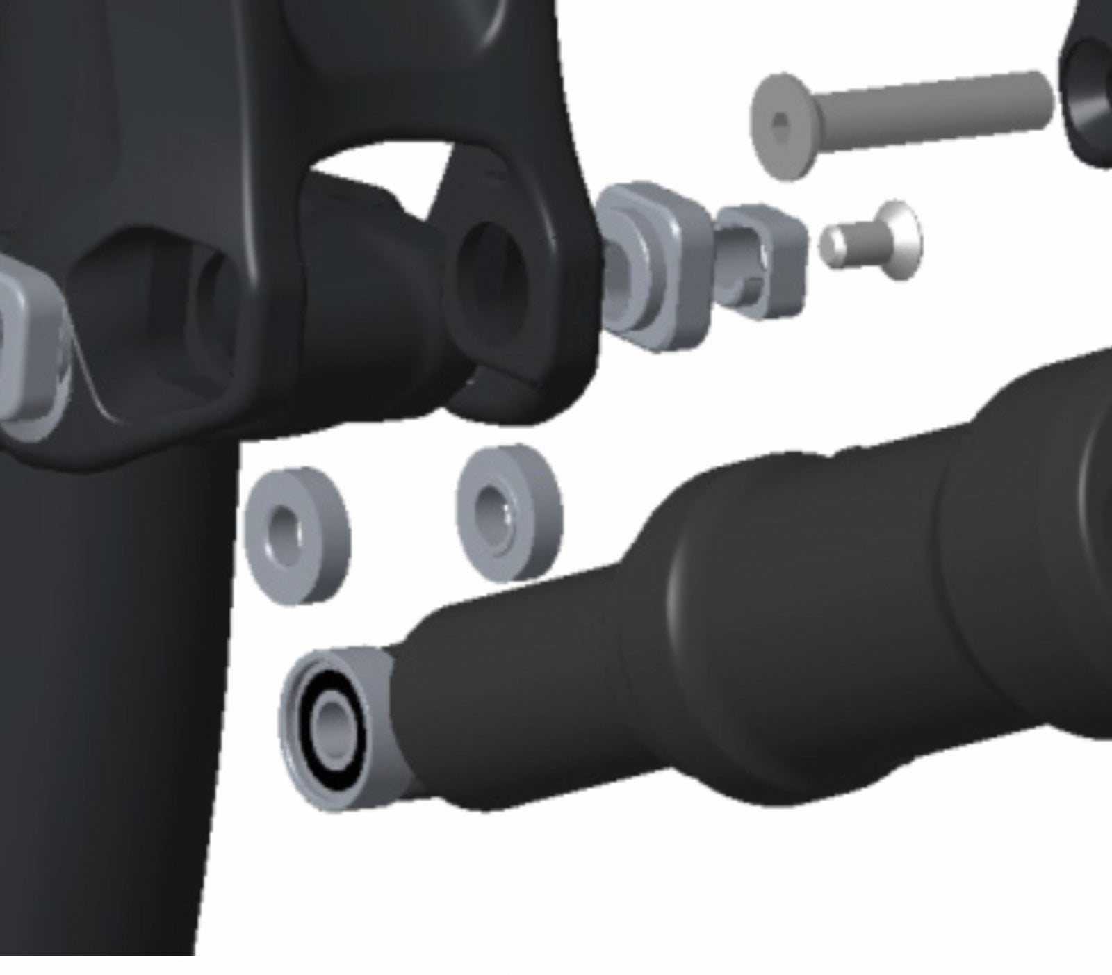

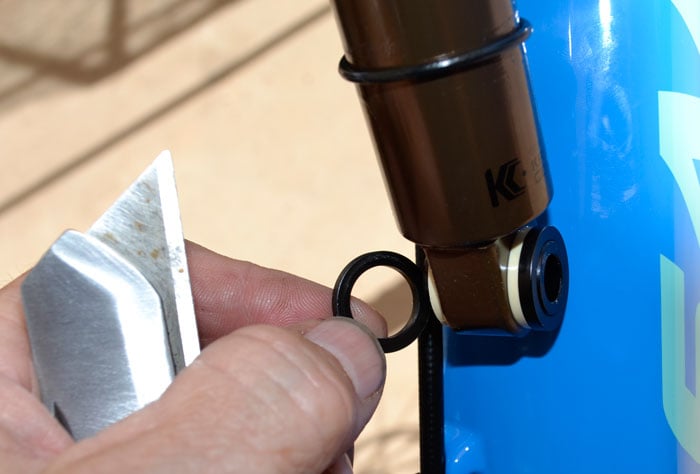

Flat, the link you post in the suspension thread ... there’s something that I can’t understand due to my bad english
Seat bearing spacers with narrow inner faces against bearings, and slide shock into link.
This means with the flat side of the spacers and that smaller “ring lip” like this pic?
The draw on the manual show it the other way around, the lip side facing inside, the flat side outside.
