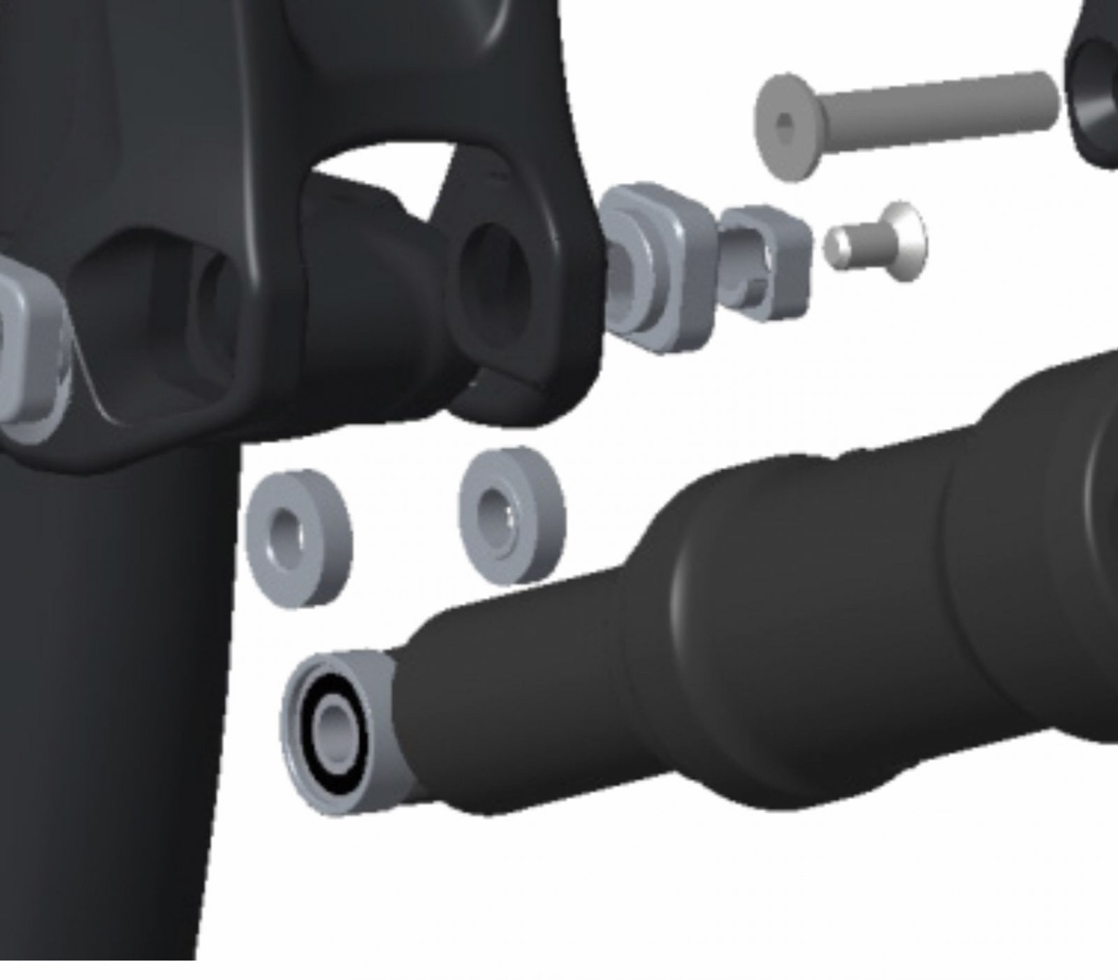

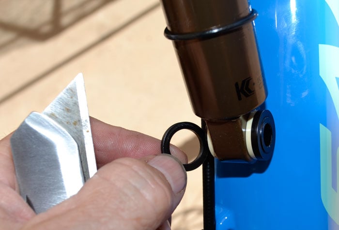

Flat, the link you post in the suspension thread ... there’s something that I can’t understand due to my bad english
Seat bearing spacers with narrow inner faces against bearings, and slide shock into link.
This means with the flat side of the spacers and that smaller “ring lip” like this pic?
The draw on the manual show it the other way around, the lip side facing inside, the flat side outside.
The reason the little spacers have the lip on the inside (shock side as per the Tech Manual diagram), is that lip seats against the inner bearing race. If you installed them back-to-front, the spacers would bind against the inner and outer bearing races and it would be nasty :D
Hope that helps.
