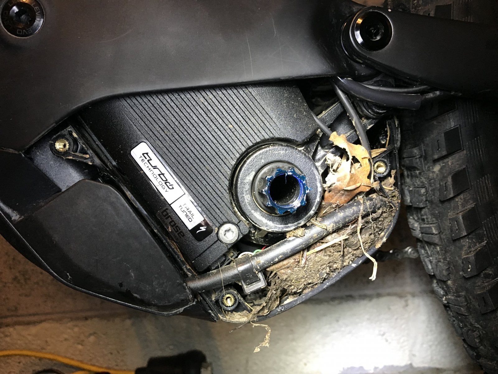

Hello,
Just for information, it seems that on the Levo 2019, a pile of earth (mud) and leaves is deposited in the engine cover (see photo). Specialized prepares a foam to overcome this defect. In the meantime and for the sake of caution, perhaps take a look at your bike to clean and dry this area.

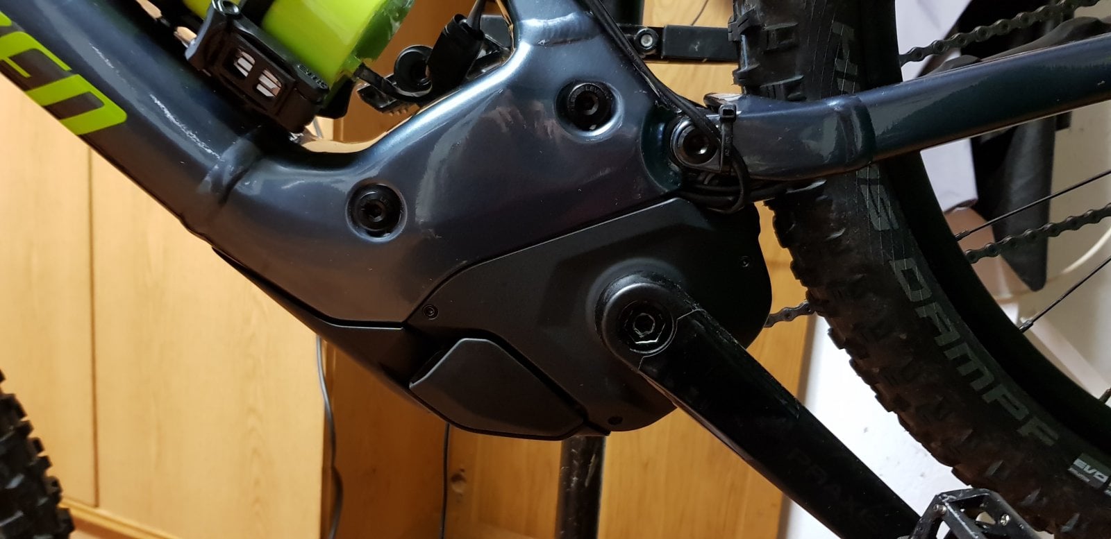

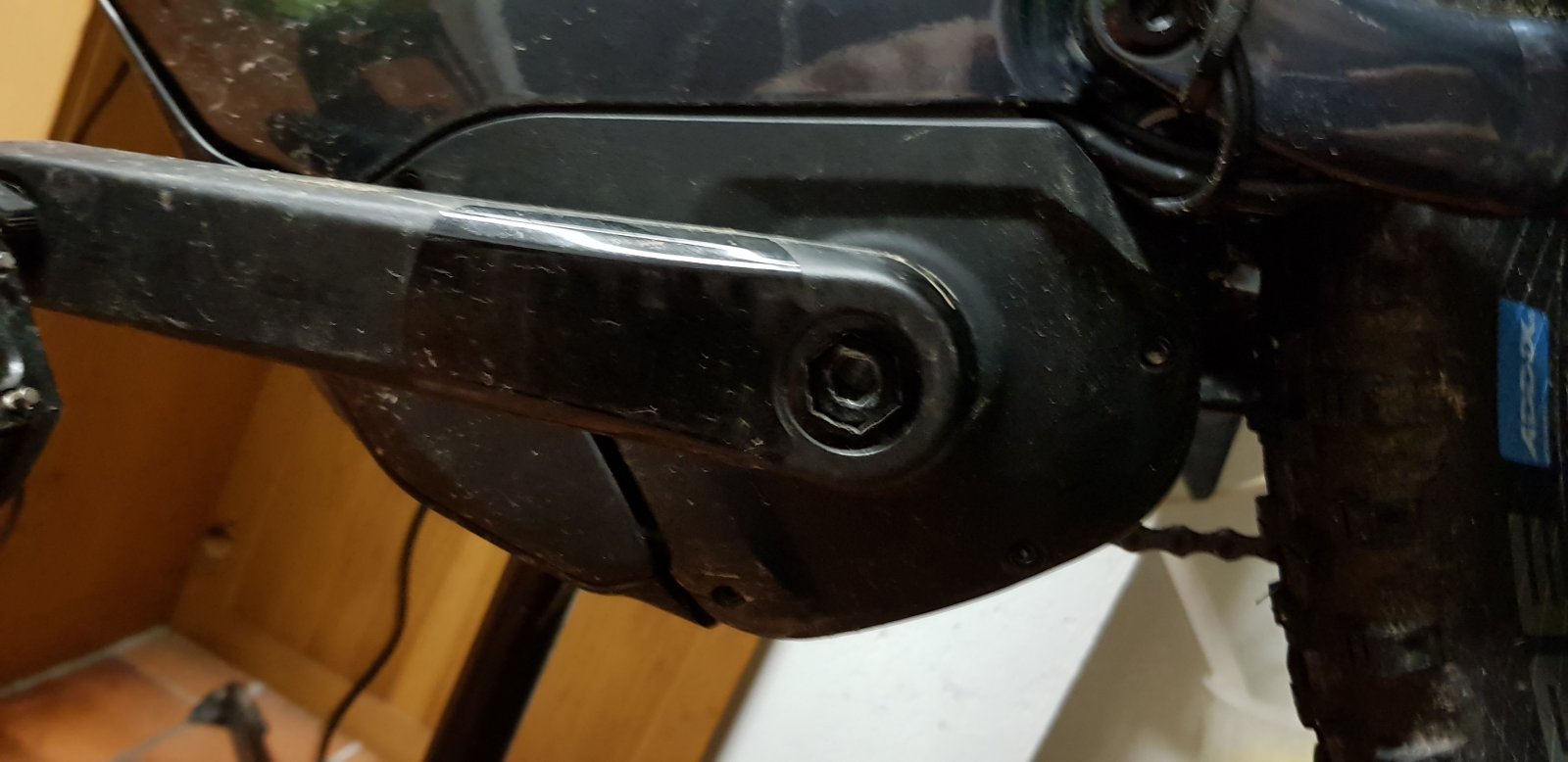

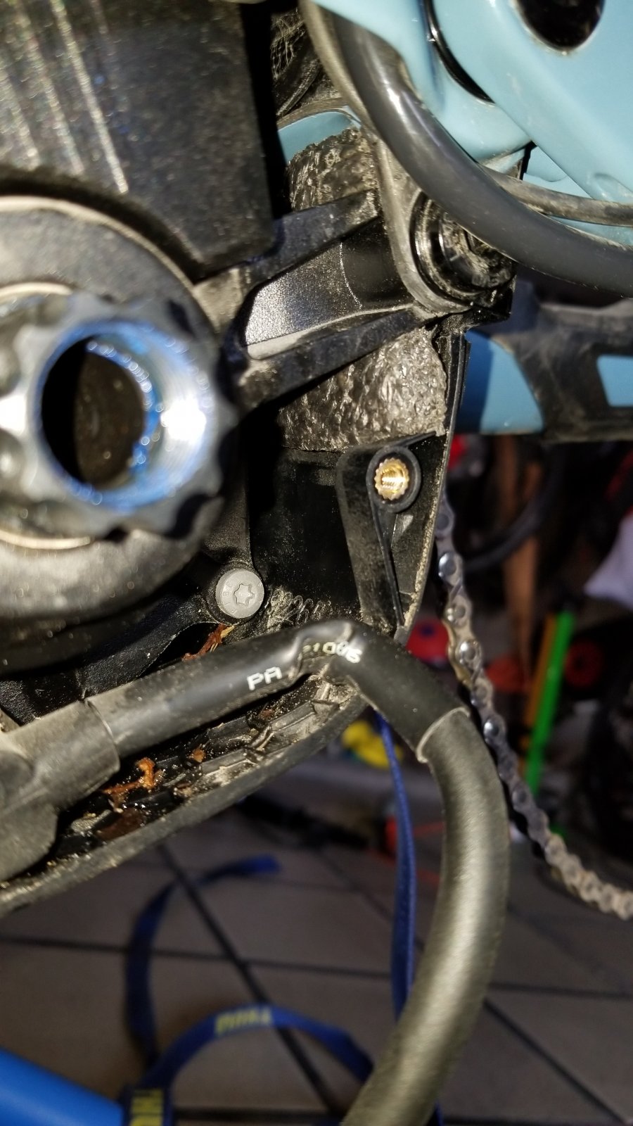

Last Friday I got back my Levo from dealer with the new motor, case and sponge. Wow...the motor is absolutely silent now! It's a little more noisy than 2018 to stay 100% objective, but really nothing to care about. The new case is perfectly fit now and the sponge looks like doing its job. Yesterday a lot of mud, but I didn't find debris jammed inside, therefore just cleaned with washer...I'm not sure if mounting something as a shelter makes any difference now, apart from aestethical point of view...

Thanks for sharing! I am waiting for the same mods as well. However not all required parts have been received by my dealer yet.
Can you please share the photos once more? I guess something went wrong with your post.
I have the exact same colour. Is this the xl frame size? I am asking while I read comments of others that were linking the louder motor noise to the frame size as well. Did you now also receive the four bolt cover? I can't see it on the pictures as the extra bolt should be positioned right behind the crank.
This is the M size. I received also the new frame with 4 bolts...you are right the 4th is hidden behing the crank...sorry:-) but also the frame is really more tight and follows better the line than the original one.

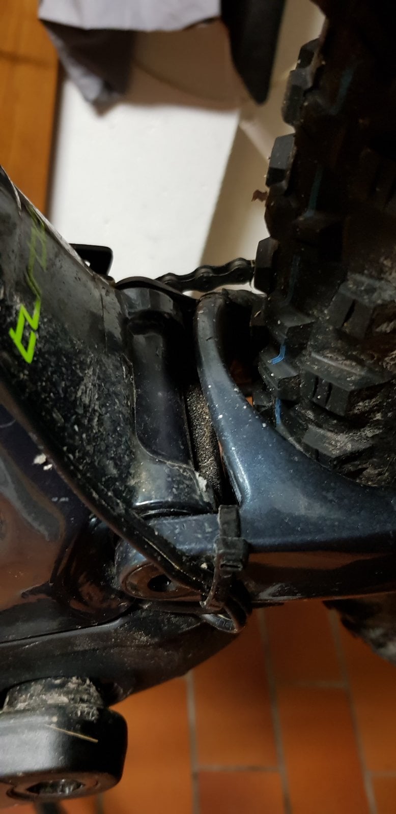

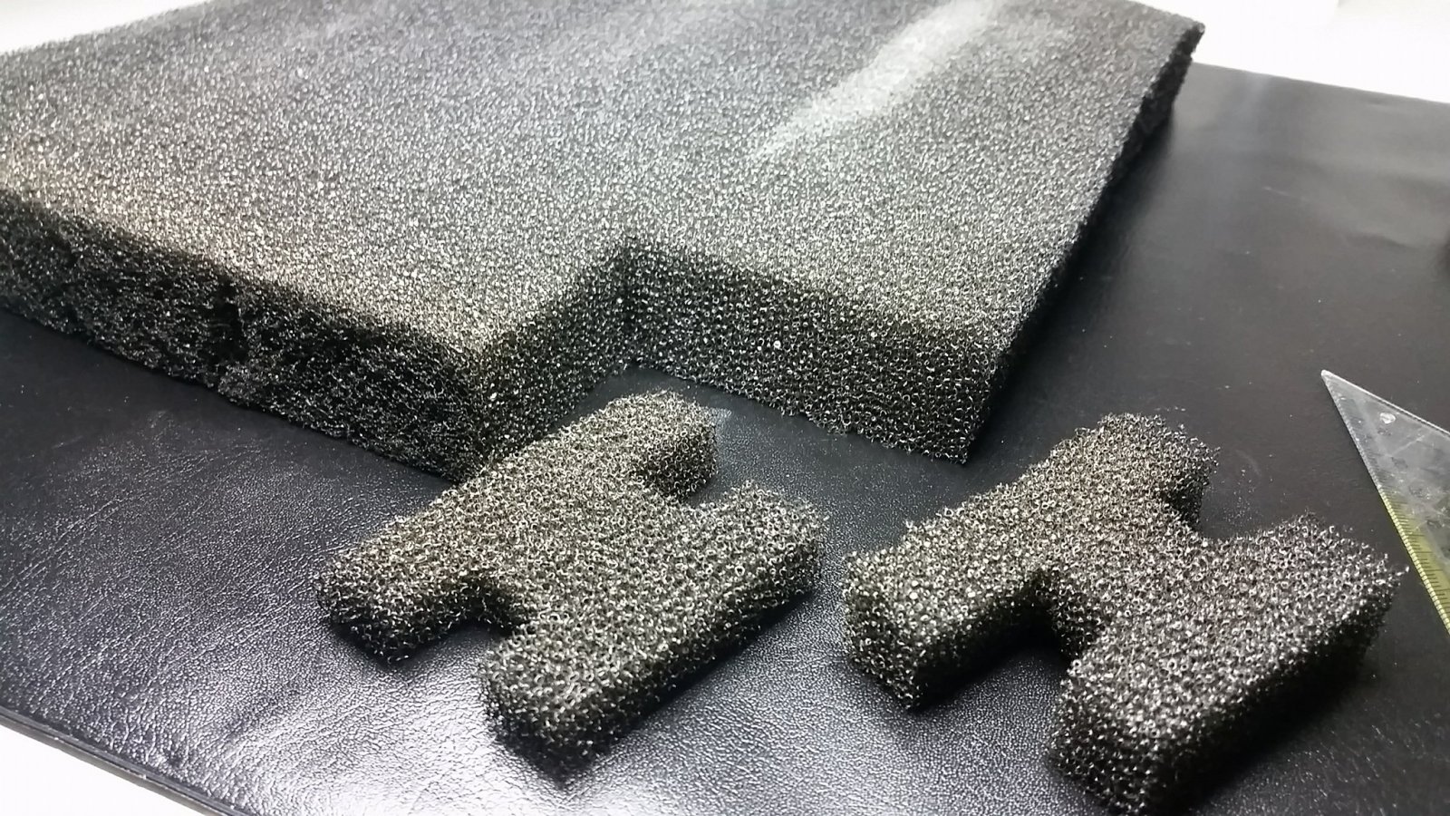

I will try to keep this short...
I prepared the sponge and took it to my LBS since they had offered to install it for me before taking delivery of the bike, this is of course a well known issue and the service manager showed me the service buletin that they got with the complete instructions, my bike was the first one that they installed the sponge to and only because Iinsisted thanks to this grat forum! After the first ride that same day (before installing the rear fender) I noticed how the dirt collected between the frame and the chainstay as others have explained.
When I installed the mudhugger I decided to remove the air from the rear shock and cycle the suspension tho check for interferences, that is when I was very surprised to see the gap and no traces of the sponge! So on Saturday after the second ride Idecided to stop at the LBS to have a little chat, they assured my that they had installed the sponge and even showed me pictures and explained the whole procedure wich apparently was quite involving.
So Iremoved the cover when I got home and what Ifound was that the sponge was quite loose inside and out of position and that there was some crap already in the motor area. After thinking it over for a little while and understanding how the sponge is supposed to work I installed it again and after a few trys I thin I got it right, I also added a small piece of foam to secure it in place between the sponge and a support. It is worth noticing that you need somebody with thin fingers to make the installation easier. here are a few pictures on how it looks. As a note I kept the suspension at almost full travel so that I also had access to the gap to see that the sponge was fitted properly and to help position it, of course there was no air in the rear shock! to avoid any risk of loosing a finger...

So now we know why there is a drain hole in the bottom.
This is the M size. I received also the new frame with 4 bolts...you are right the 4th is hidden behing the crank...sorry:) but also the frame is really more tight and follows better the line than the original one.

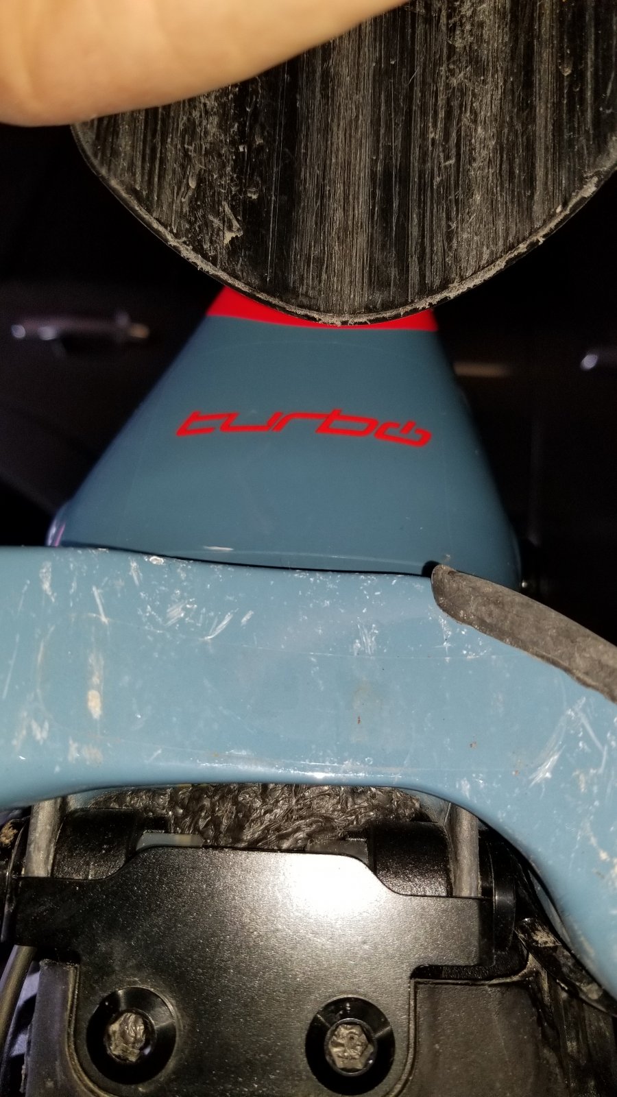

Hi all,
i'm trying to install the sponge i've just made, but i'm not clear on how to reach the position on "the back" where the sponge should be fitted.
I have removed the carter via unscrewing the three screws, but the back side is still covered by a plate, am i supposed to remove something else on top of the carter?
