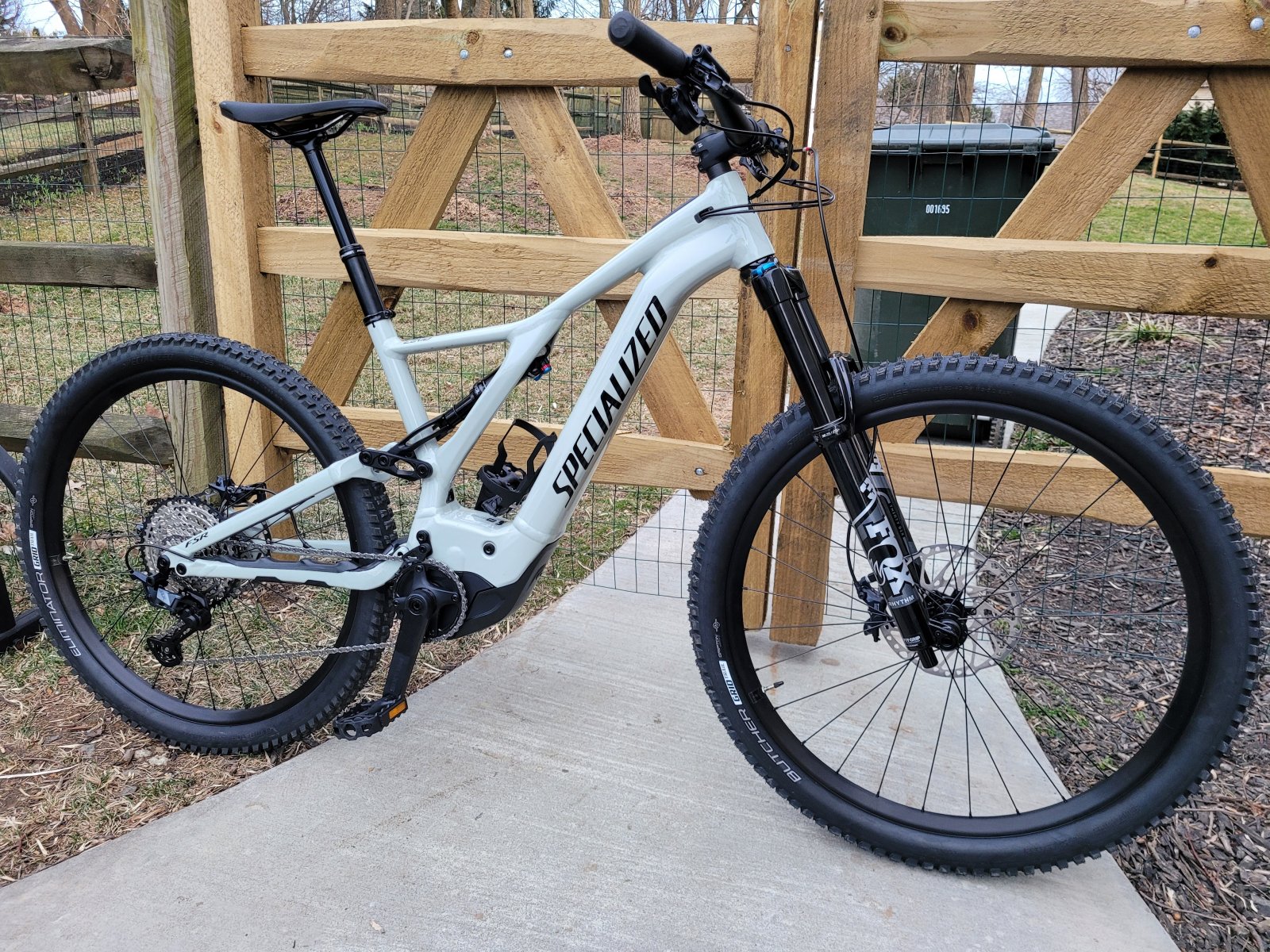

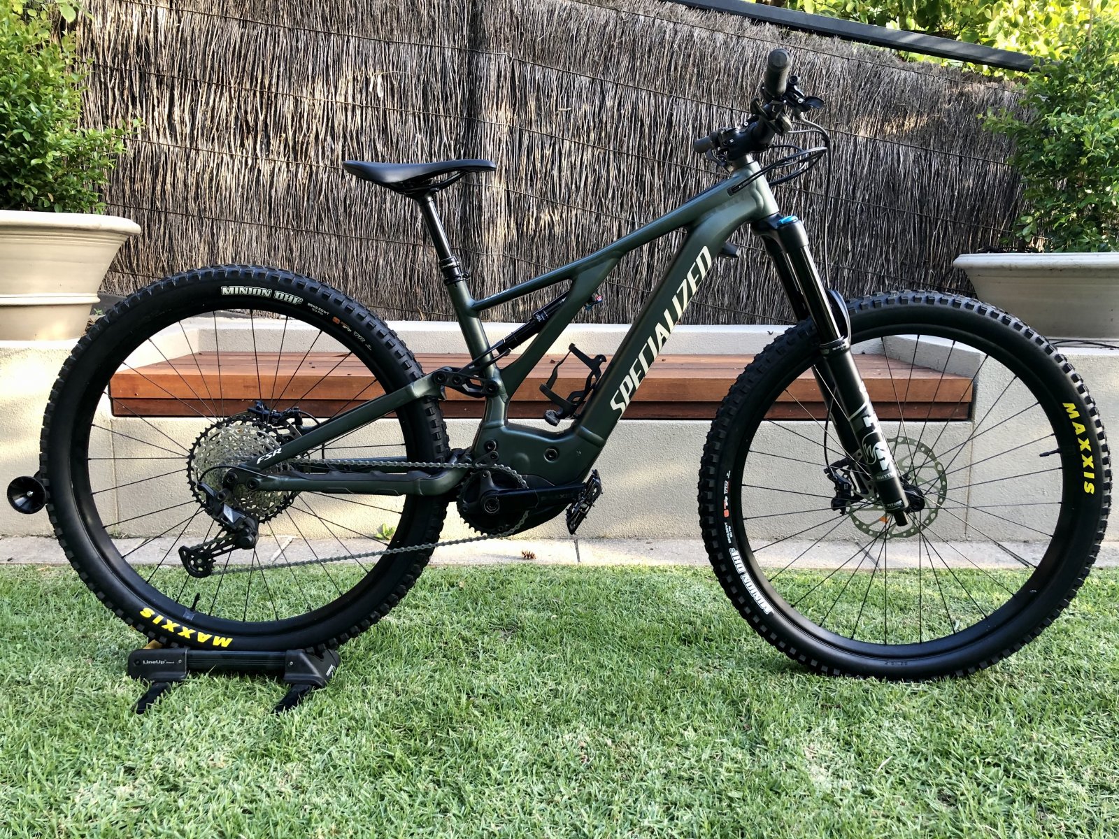

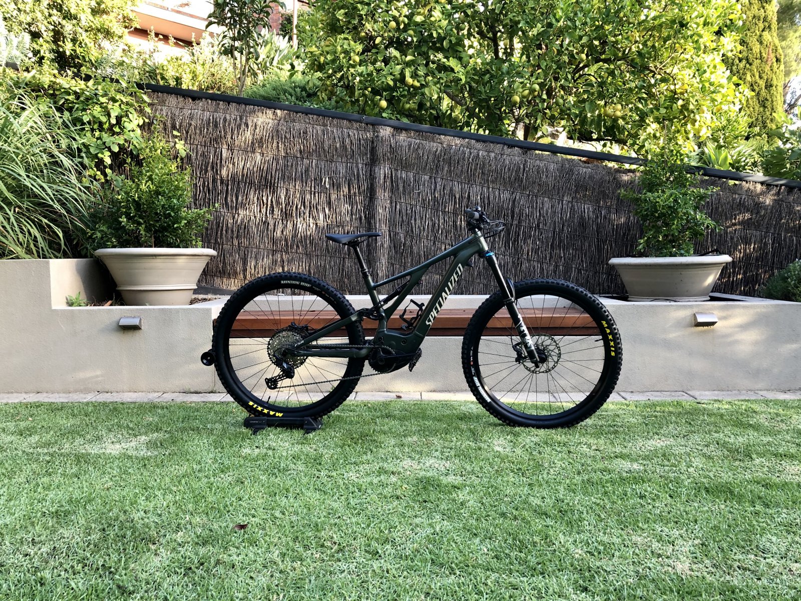

Hello all, I just wanted to say Hi and introduce my new 2021 Specialized Turbo Levo to the group. I have had the bike for a few months and just wanted to say how much I love it. I have put a few hundred miles on it thus far and it has been all smiles. I made some minor adjustments like changing out the pedals, and adding front and rear fenders as well as a 50mm Vibrocore handlebar. It rides like a dream once I took it to a local bike shop and had them add air to adjust the front suspension and rear suspension to handle my weight. It glides down hills like cloud. If you can get your hands on one I highly recommend it.
View attachment 51196View attachment 51197
cool. looks like Livermore-ish

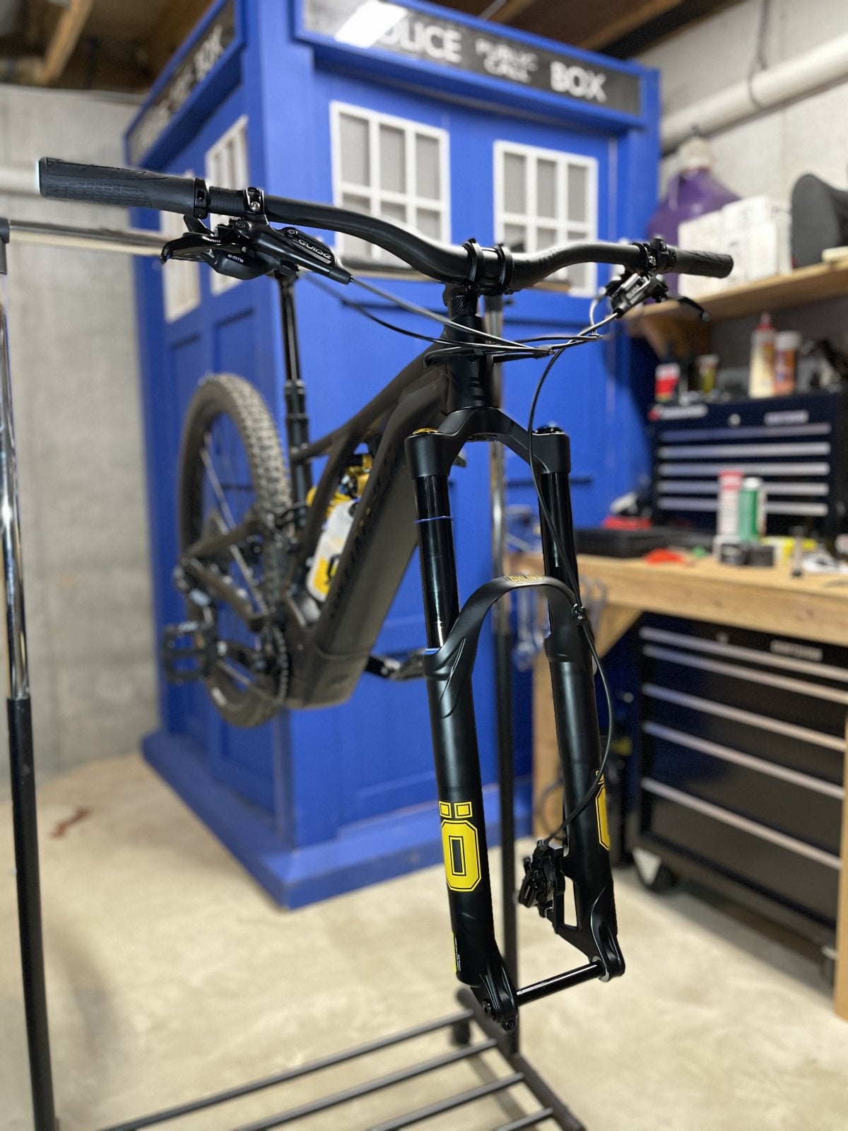

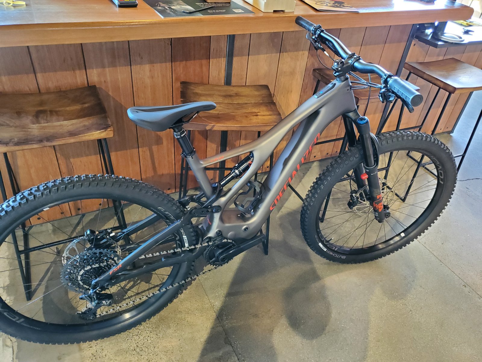

Just installed my new Öhlins m.2 fork... can’t use it yet as my front wheel won’t fit ?
I have the base model which came with the Rockshox 35 fork. On this fork it seems Specialized used the Rockshox specific 31mm torque caps on the hubs which don’t fit. Spoke to Specialized and they helped me out with the new part to adapt my existing front wheel.
Use the TARDIS to go back and tell them to make the wheel the right size? (bring K9)

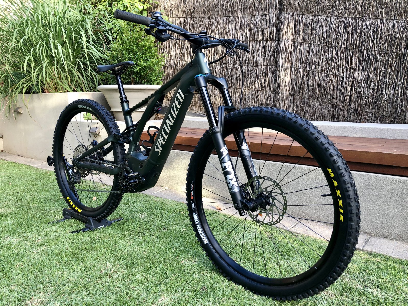

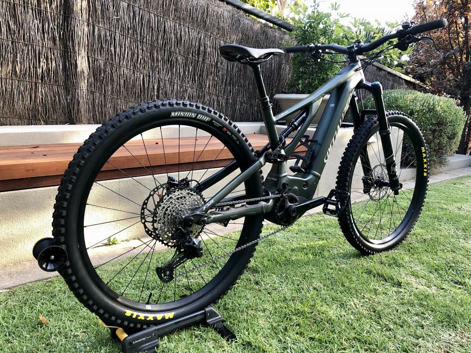

Hi all!
Since one month now, my wife and I both have a Levo Comp 2021.
For her a Medium Spruce, for me a Large in Oak Green.
I am not much of a poster, but since I owe a lot of the good choices to this forum, I thought I'd post my choices here.
Ordered in September 2020, arrived at LBS in February 2021. Long wait, but worth it.
After purchase, these were the 'upgrades' we did:
1) Flat pedals: Shimano XT 8140
2) Shortened handlebars (more for my wife, less for me)
3) Grips: Ergon GS1 large
4) Lupine SL SF for front and Lupine C14 for rear
5) Garmin mtb mount
6) Wolftooth bottle shifter to make room for pump
7) Topeak minipump
8) Coastguard rear fender
9) Saddle to personal liking for my wife
Now first a lot of rides, getting used to the bike(s), finding the right settings for us of the suspension.
Later perhaps some changes.
On Garmin:
Connected the powermeter and cadence of the bike itself.
Connected my own garmin speed2 after mounting it on the front hub.
Installed the connectiq app 'EBIKE field' of JanCapek, providing the battery percentage.
Using the Specialized Mission Control (one time, will check probably every 3 months):
-to register the bike
-to verify the (close to zero) mileage after purchase
-to verify whether the firmware needed an update
-to set the shuttle mode and peak power (tune)
Thank you all for posting your experiences, so I could make my choices.
Happy riding!

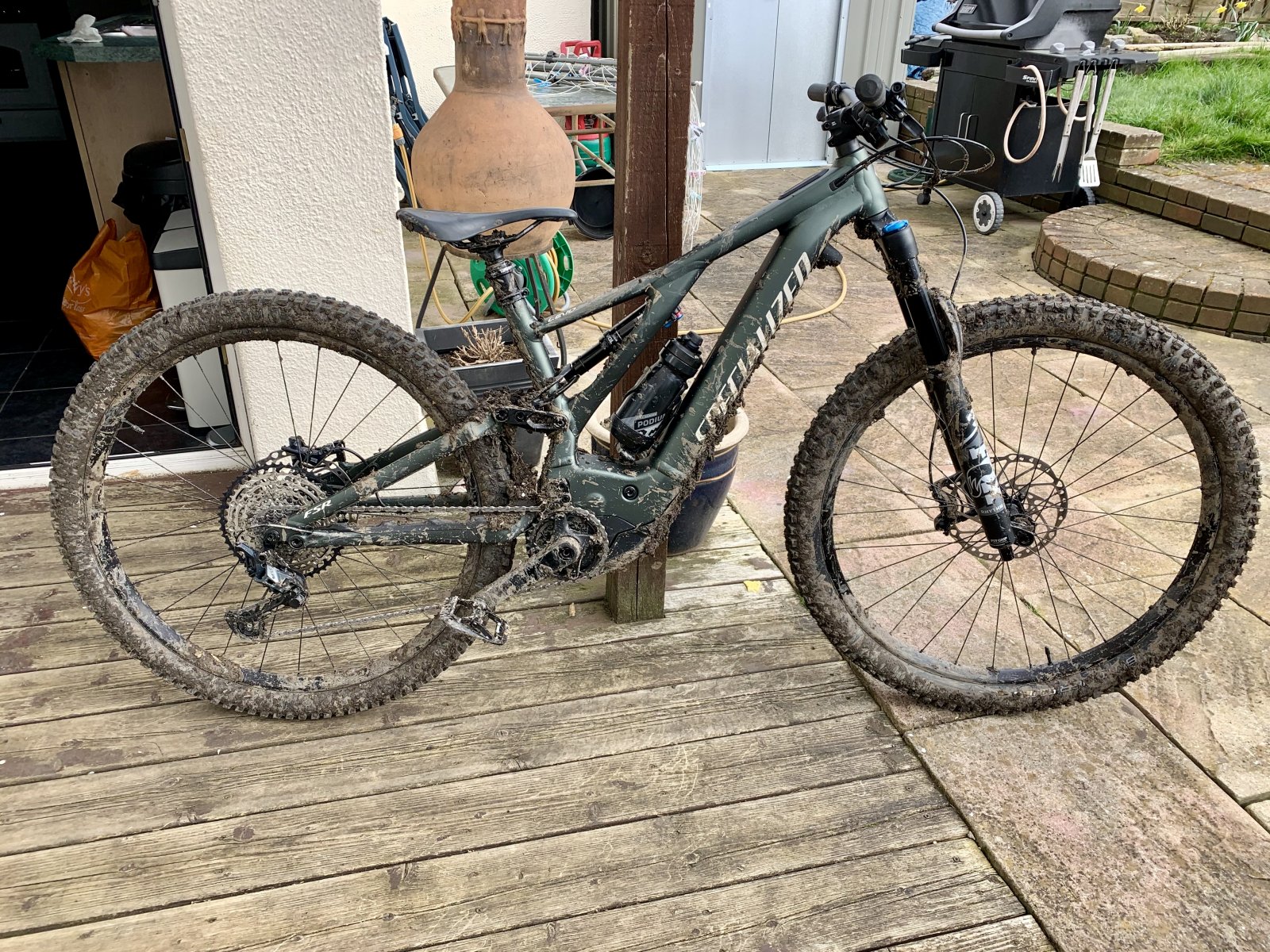

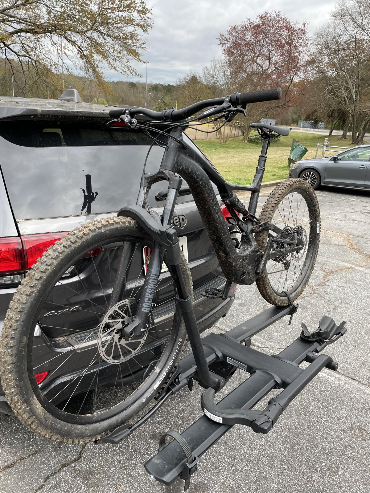

Thought I would share my '21 TLC Specialized after todays ride, first time the bike has got this dirty, loved every minute of it.
Looking at the photo above, I need to get a bike rack, first I need to convince the wife that we need a tow bar, so far it hasn't worked.

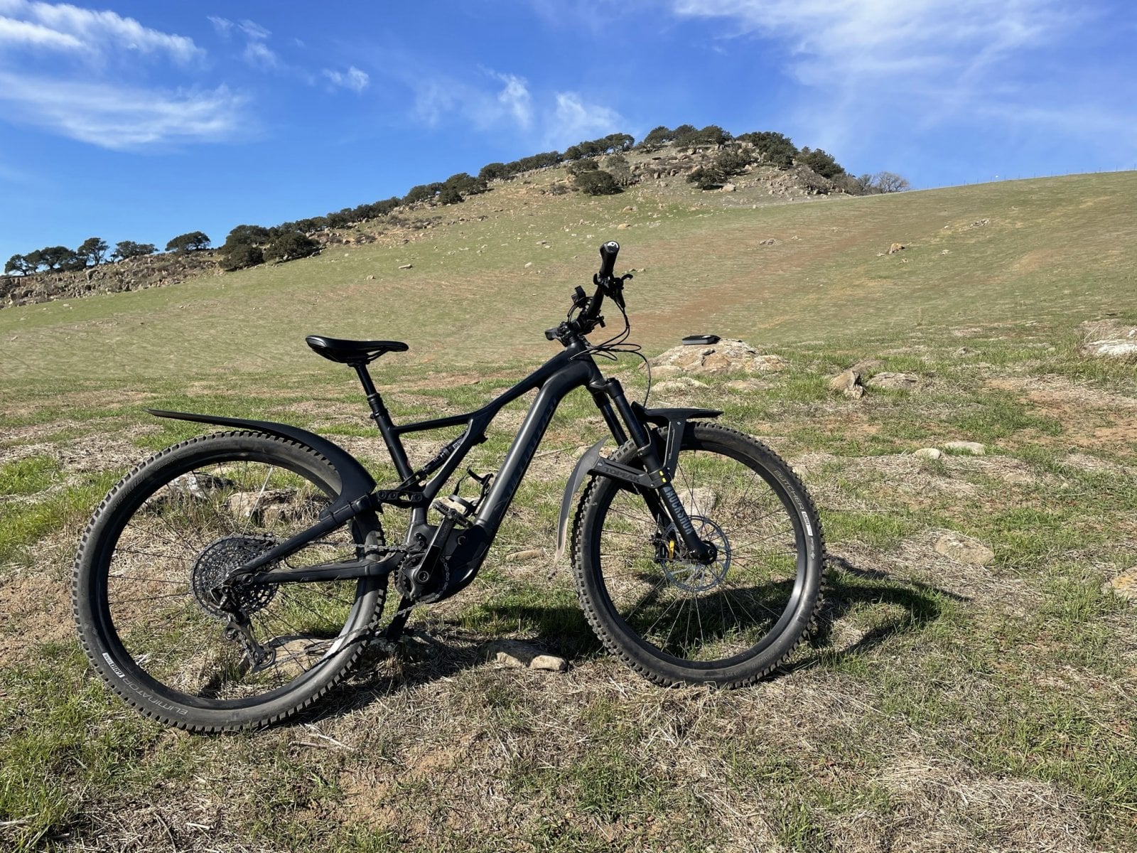

Finally joined the Turbo Levo club. After 2 very good years on a Giant Trance, I sold it & got a 21 Specialized. Only rode it for 5.5 miles, but what a huge difference. I'm in love with the Levo

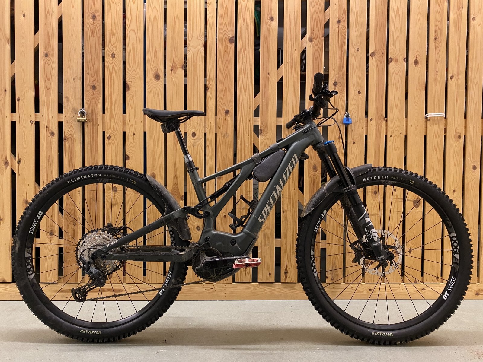

New tyres day. I Swapped originals to Butcher 2.6 Grid Trail T9 and Eliminator 2.6 Gravity T7/T9. Also asssembled Huck Norris-inserts to both ends. No more Nasty Dents, Snakebites or Bruce Leaks i hope. ;)
Original tyres are very good for stock tyres but 2.3 on rear causes dents to my Roval rim. And to front i wanted even more grip. New tyres are now on my second wheelset. DT Swiss E1900. Very good and cheap wheelset In my opinion.
