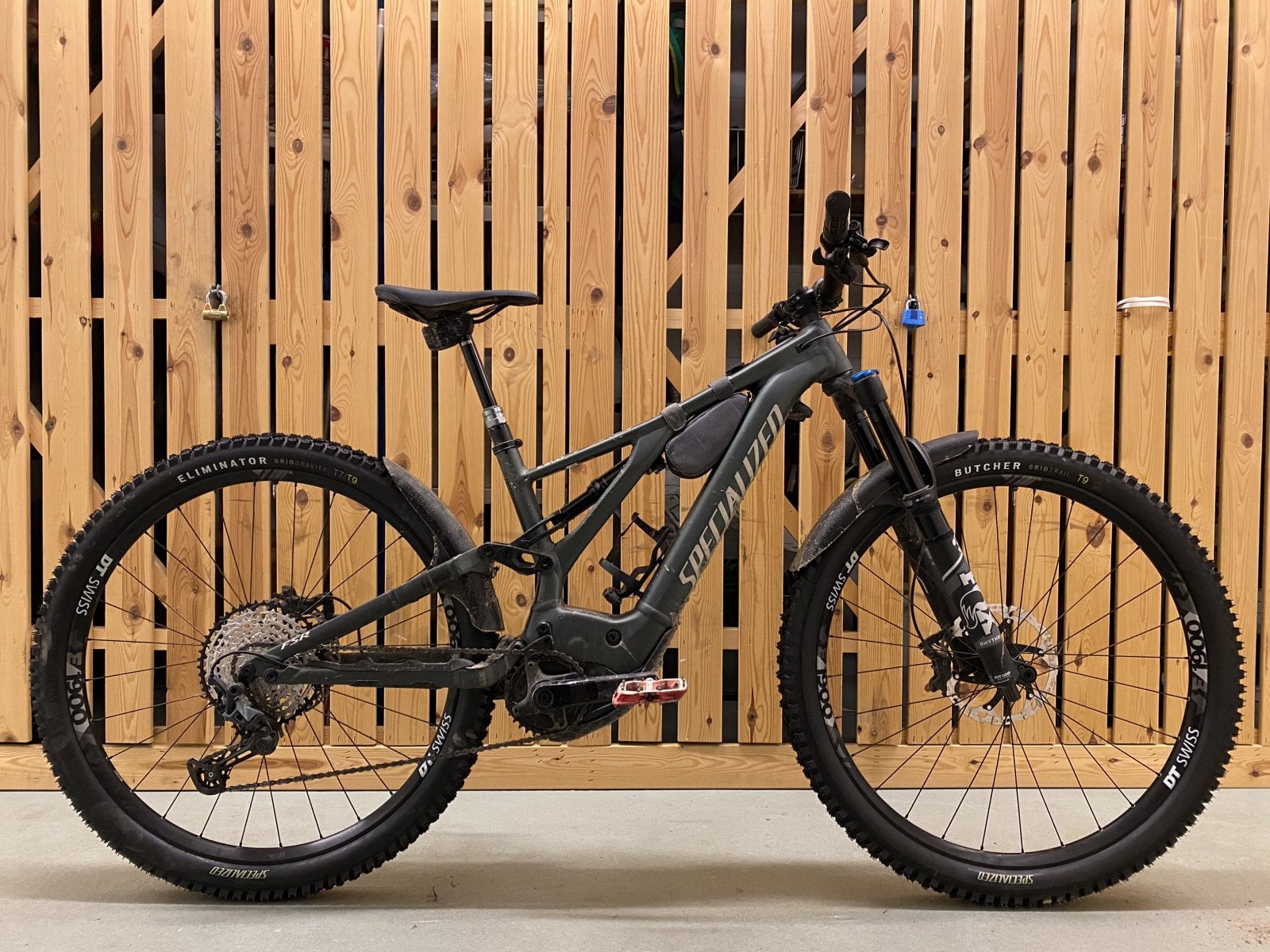

New tyres day. I Swapped originals to Butcher 2.6 Grid Trail T9 and Eliminator 2.6 Gravity T7/T9. Also asssembled Huck Norris-inserts to both ends. No more Nasty Dents, Snakebites or Bruce Leaks i hope. ;)
Original tyres are very good for stock tyres but 2.3 on rear causes dents to my Roval rim. And to front i wanted even more grip. New tyres are now on my second wheelset. DT Swiss E1900. Very good and cheap wheelset In my opinion.

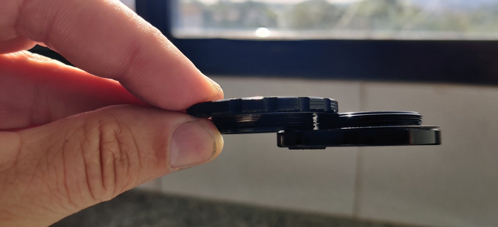

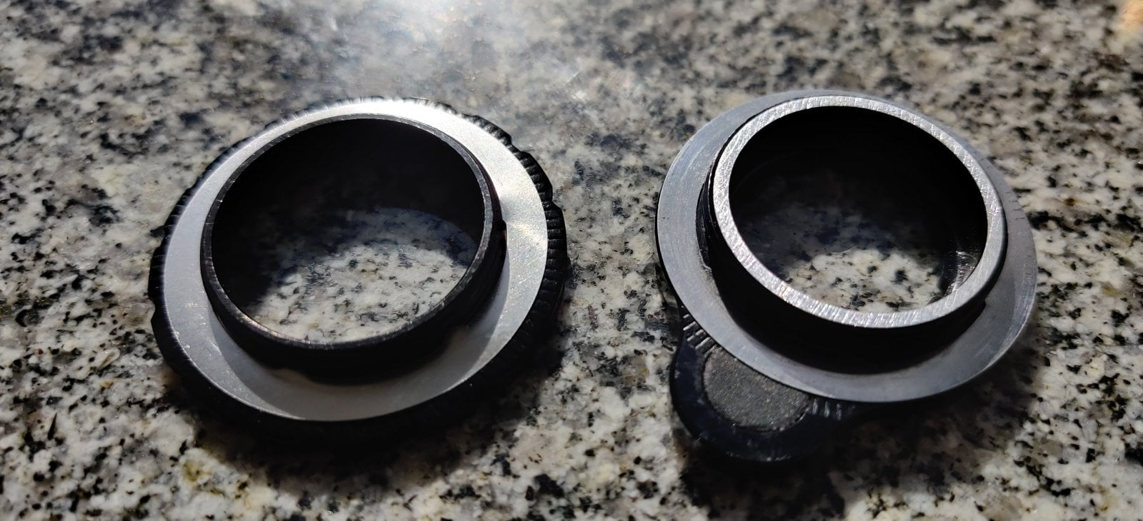

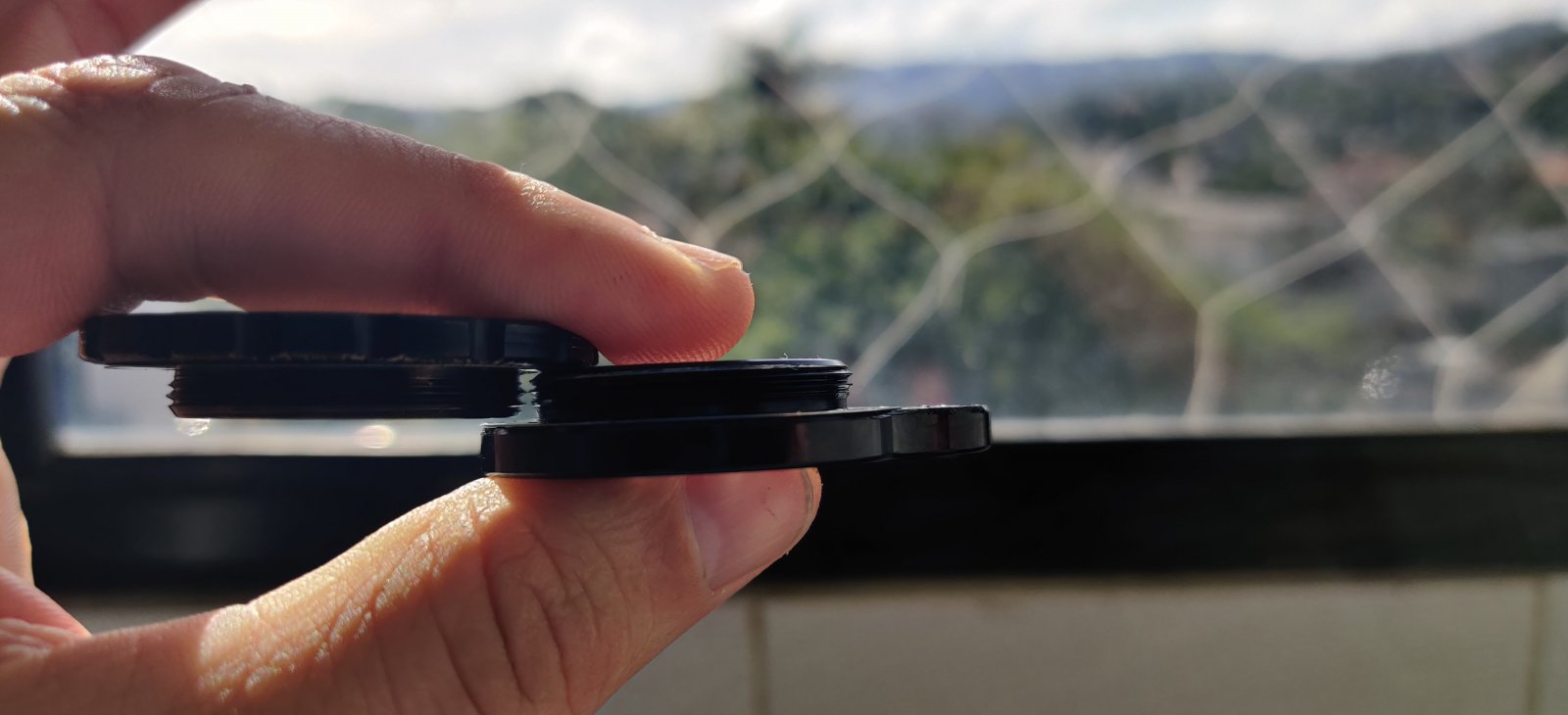

I bumped into the same issue with my wife's base model MY21 Levo. I had removed the suspension from my Comp model and thought it would be easy to source non-Torque caps for the hubs, but turns out these are the cheapest of the cheap hubs and while I found the end cap part number as mentioned above--they are not possible to order on shopbikesupply (not in stock) or any other authorized Specialized dealer. I also cold called about 10 specialized dealers to see if maybe they had the caps laying around as this hub is used on many other bikes. No dice.
I went out and bought her a new Roval Traverse SL Alloy front wheel, which was much higher quality than the stock base wheel. My only regret is I should have bought the set. Specialized sells the front only - or the set, no rear only option. So i'll have to wait til a rear pops up sometime.

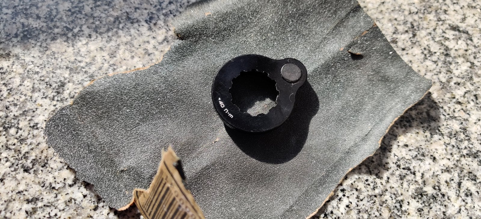

Day 3 of my new COMP. Started getting loud noise and vibration from the rear brakes. Others have had this problem as well. I think I figured it out, its not the SLX brakes the problem.
The disk was a little loose and It wasn't noticeable to the naked eye. The centerlock nut with the magnet on the rear wheel from Specialized is wider than the stock Shimano nut. I just sanded it down a bit with some sandpaper against a flat surface and now it tightens the brake disk properly. No more noise or vibration
