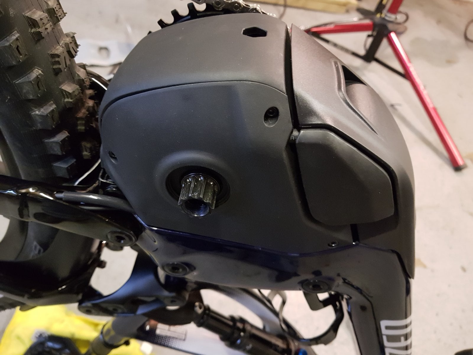

i'm trying to install the sponge i've just made, but i'm not clear on how to reach the position on "the back" where the sponge should be fitted.
I have removed the carter via unscrewing the three screws, but the back side is still covered by a plate, am i supposed to remove something else on top of the carter?
Thanks
You only need to remove the side cover, what I also did as explained in post 1156 was to empty the air from the shock and used a strap to hold the suspension compressed to gain access to the gap to assist in positioning the sponge and to confirm that ir was blocking the gap. You have to push it thru the middle of the support and then position it in place.

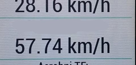

I need to go faster on the flat!!!
On the flat, it will hit 58 km/h with 36T chainring, at unsustainable cadence around 130+ rpm.

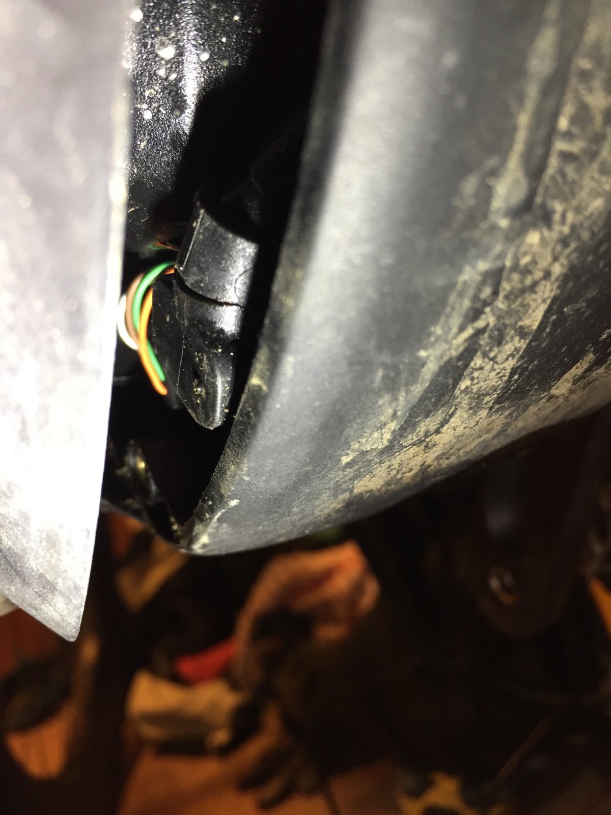

Just reassembled the motor cover after installing the sponge. Seems to be fairly big gap near the top left edge nearest the tyre. I know this is supposed resolved by the fourth screw (which I don’t have) but concerned I’ve done something wrong.
It will be the battery cable is bulging out a bit, it's a very tight fit and you really have to push it in so it doesn't do this.
I've left mine like yours because otherwise you really have to push in the cable and I feel it's too severe a bend in the cable.
The new cases will sort it

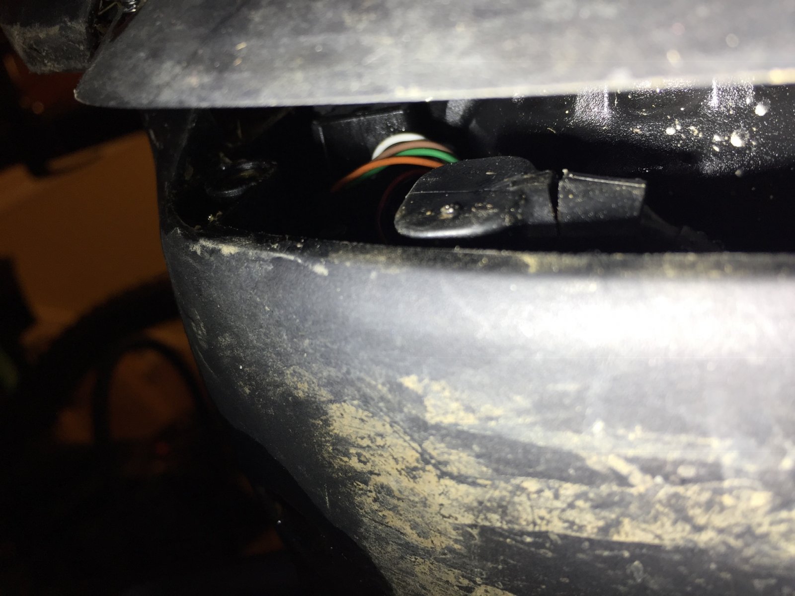

I had my motor changed and the foam put in by Spesh UK - I thought I would check that crap was being kept out so I loosened the non-drive over screws to have a peek and it was clean, but the rubbber cable/connector seal has split (probably by too much pushing like you say). So I will seal it but report to Spesh.
I asked them about the 4 bolt cover, and they said they had checked for any gaps in the cover and showed me there wasn’t a gap.
Simon
I have been told the new 4 bolt covers are due in early next year and if You get your dealer to order one they will send one.
On the subject of the battery cable, it is about 12 inches long, but only needs to be about 6 inches long, don't know why they make them so long, when it has to be folded in half with an acute bend in it?
Not only does it not fit in the casing properly, but it is asking to fail with the bend!
Thanks, will have another go at squishing it in before replacing the crank.
You can heat the lower part of the cover with a heat gun (a hair dryer may not be hot enough) and bend it against a hard flat surface so that it takes a set . I took mine off earlier to seal the cable split in my cable, and it didn’t want to go back without a gap - heat gun has bent it in slightly and now it pulls in nicely with the screws.
Simon
