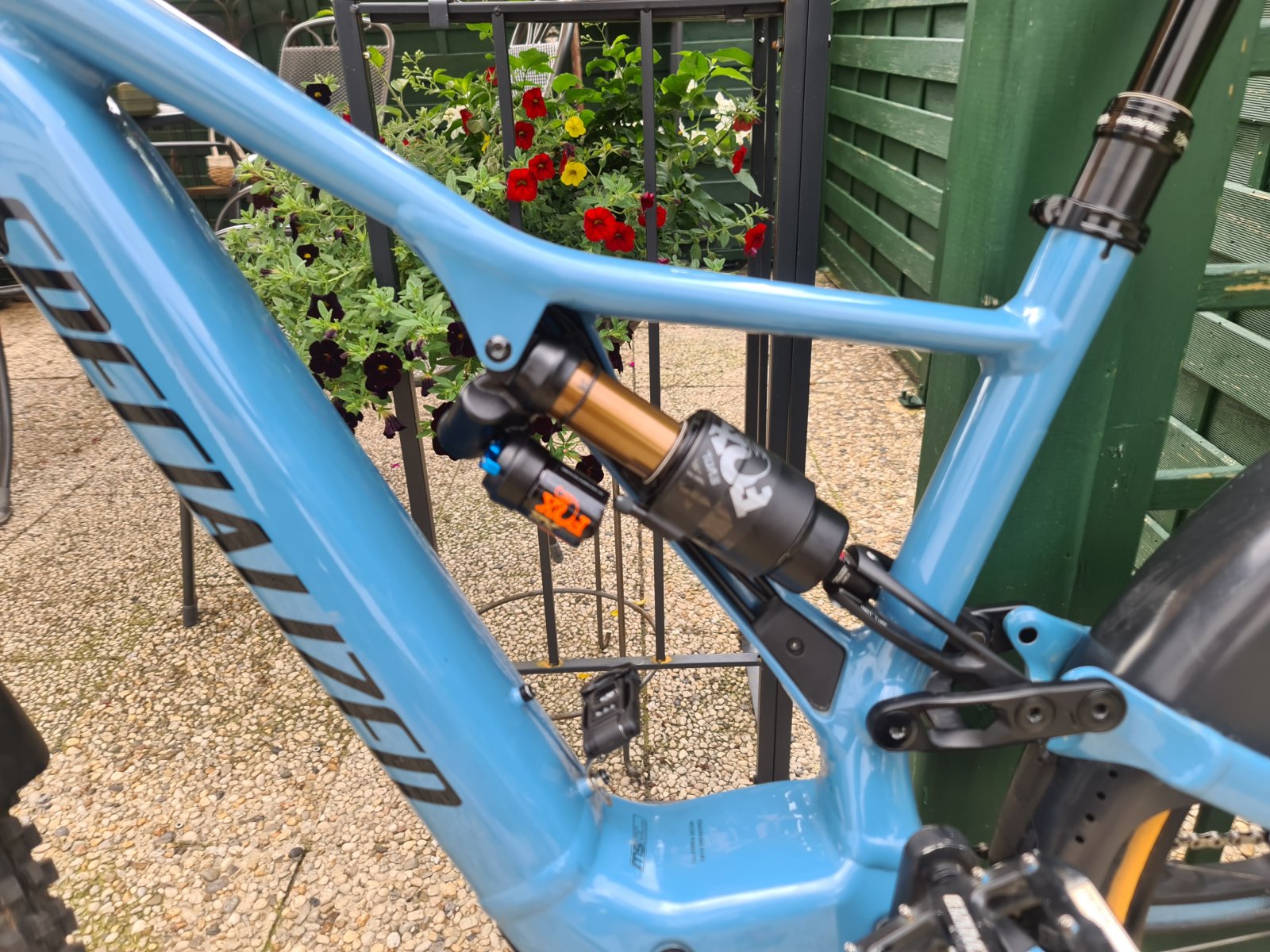

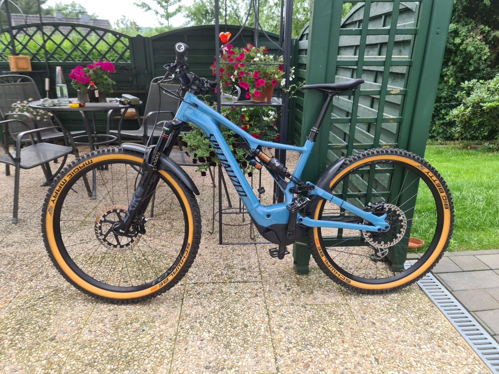

Out of interest, what rear guard do you have fitted there? Does anyone know?
Looks like a mudhugger front guard at the back
Possibly the shorty
It's this one:

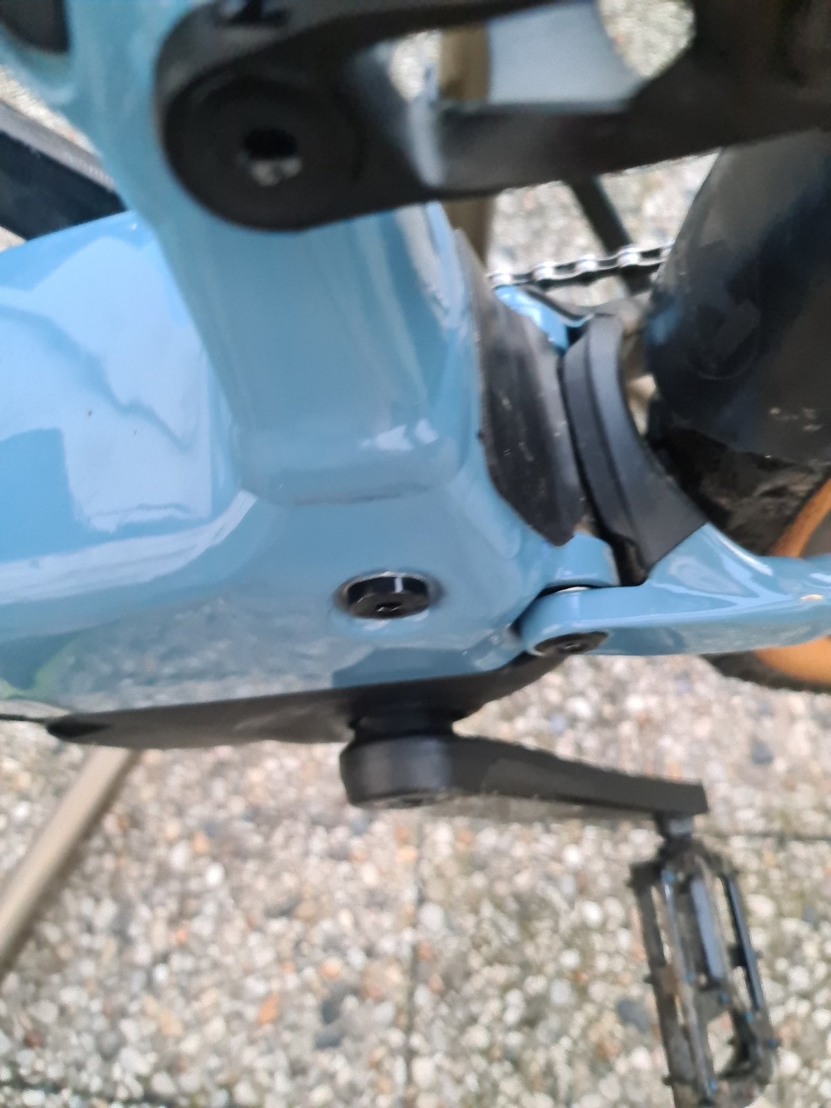

Drilled the holes for the upper swingarm by myself.
And i used additional slapper tape at the bottom to protect the frame.
Don't like the long once which always in contact with the lower swingarm.
