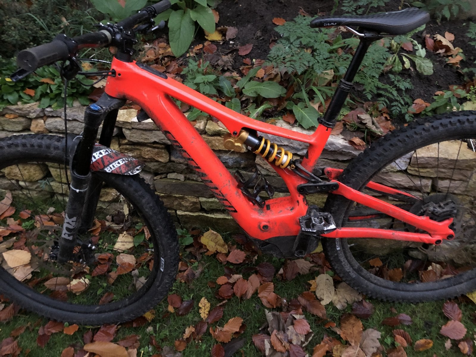

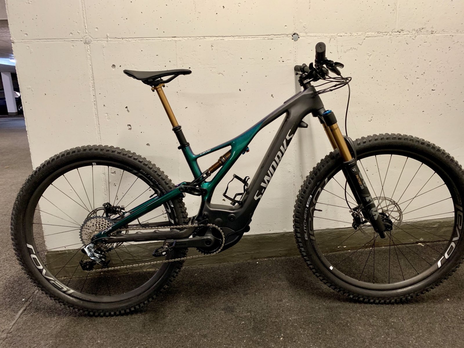

The Burgtec finished kit was just fitted by RaceCo and is just extra Burgtec bars, pedals, stem etc. I stuck with the 50mm stem length rather than going shorter.
Yes the bike had an invisiframe kit fitted for protection. Well recommended!
Hope your pleased with yours in Dec!
Is that your bike on EMBN this week?

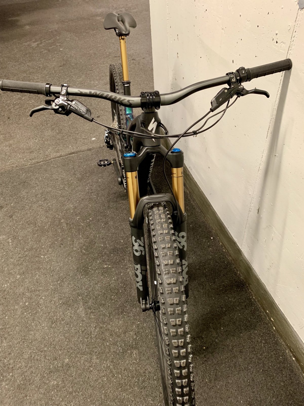

Mine arrived this week.
Because of work i did not have much opportunity to ride a lot, just few kilometres. It feels very light and „bicycle-like“ compared to the 2018 model.
The engine is now a tiny bit louder, but i did only notice it inside my underground car park. Still quiet enough for me.
Changed the dropper post and went tubeless. No other mods so far.

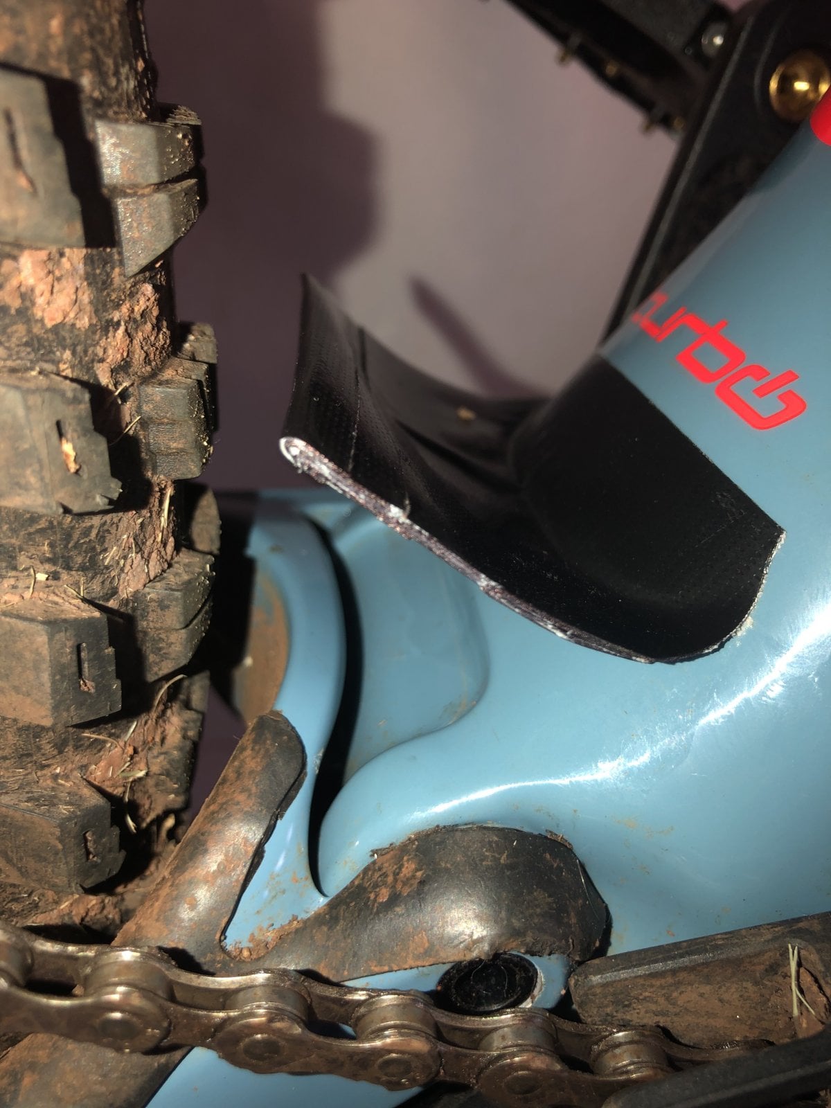

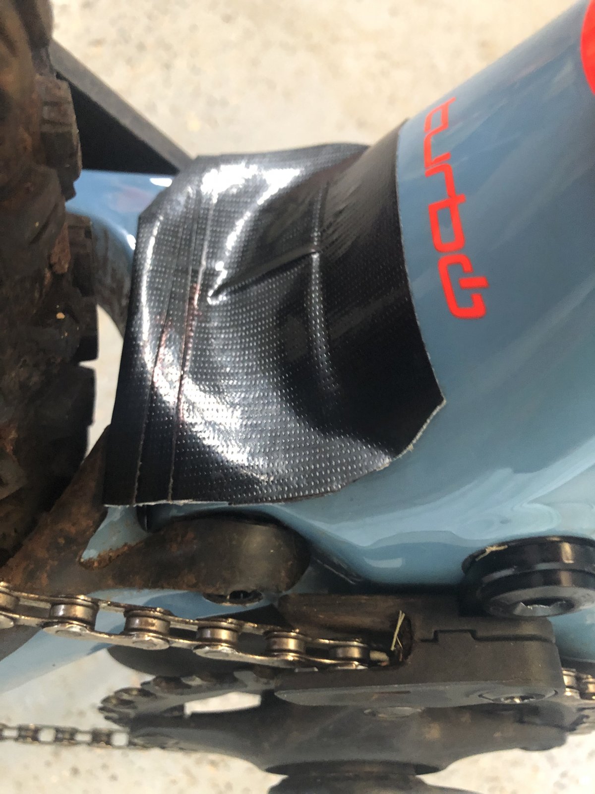

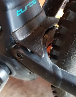

My version 2.1 Gorilla Tape fender. Just stick to pieces together, then tape it on.

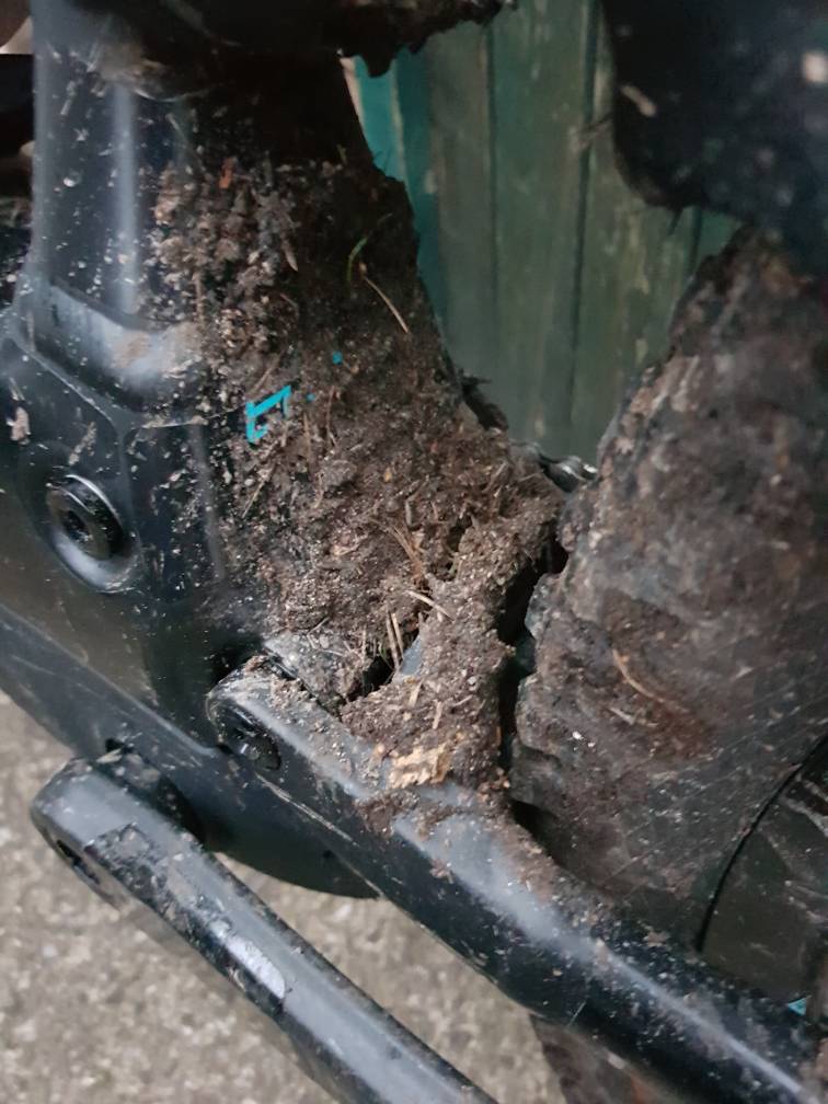

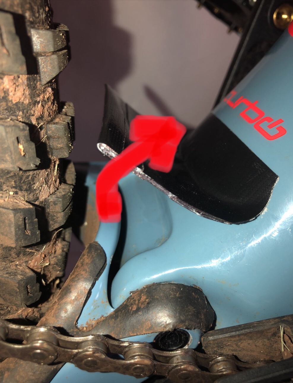

All, This particular ‘fix’ is NOT going to stop ALL of the crap getting in.
Let me try to explain....

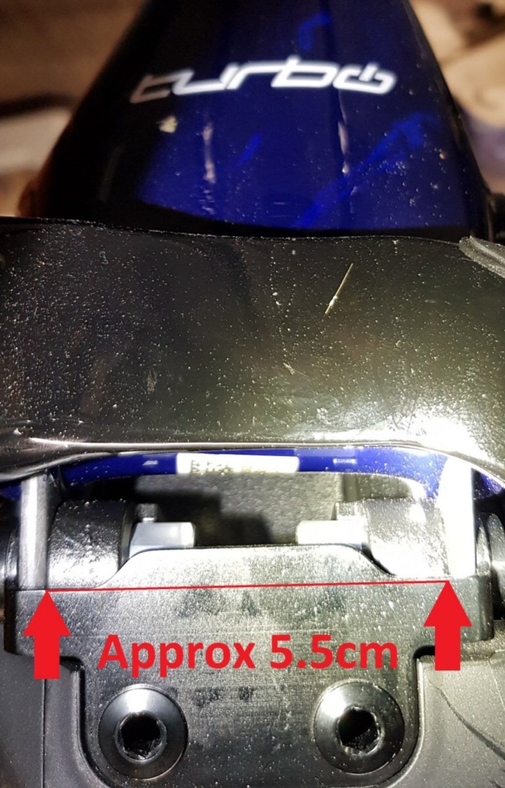

When the suspension is static as pictured in your post the ‘large hole in question’ is covered by the swing arm brace. The tape you have on the bike as pictured ‘will’ stop most of the crap getting in and this would work ‘if’ the bike was a Hardtail.
However, as soon as you sit on your rear suspended bike the ‘swing arm brace’ as pictured below will move in an upwards curved direction (See the first photo). Also once you start riding the swing arm brace will move up even further as the suspension works its way through its 150mm of travel. This movement upwards exposes the hole which is covered when the bike is static or the rear suspension is locked out to everything that is attached to your spinning rear tyre. At full travel on the rear the hole is completely exposed (See the second photo below) If the hole is not covered or filled with foam everything attached to your spinning rear tyre that is flung off it when next to this hole will find its way in as it is a very BIG hole.
At full travel on the rear suspension this is what the hole looks like.
If you were off the bike the black swing arm brace as pictured below (blue on your bike) completely covers this hole.
There is no risk of over-heating by closing the gap here. The motor will automatically de-rate itself if it reaches a certain temperature, allowing it to cool naturally - it's part of the Brose design so you cannot damage it like this.
I put a piece of scouring pad sponge in the gap between the swing arm and motor housing and fitted a a front mudhugger as others have, I also filled the motor casing gap with silicon grease.
My first 6 week service with 350 miles found 1 pine needle inside the motor casing, probably as the first few rides had no protection.
Simple precautions and no worries from my perspective
My first prototype, Will add sponge as well.

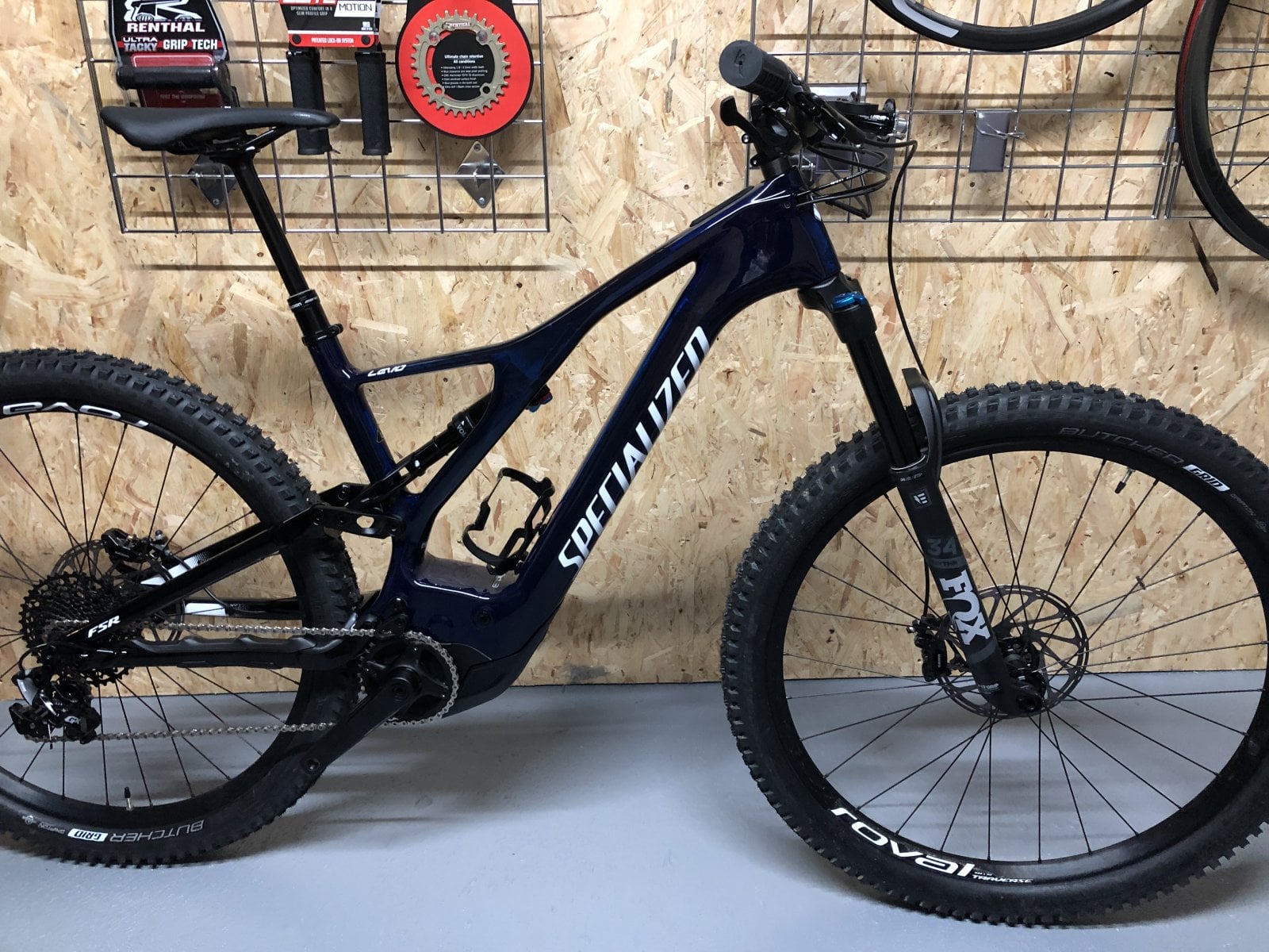

Just got this bike two weeks ago. Love it!!
Cheers
Wow, good work. What kind of material did you make that out of? Will that stop stuff from getting in the motor when the rear suspension is fully compressed like @Kiwi in Wales was refering to? How are you going to put a sponge in the gap withough taking the motor cover off? They are supposed to be replacing the motor covers also.
Thanks sounds right to me. After riding though, there is all kinds of trail debris on top of the tape, but under the tape it looks clean.
