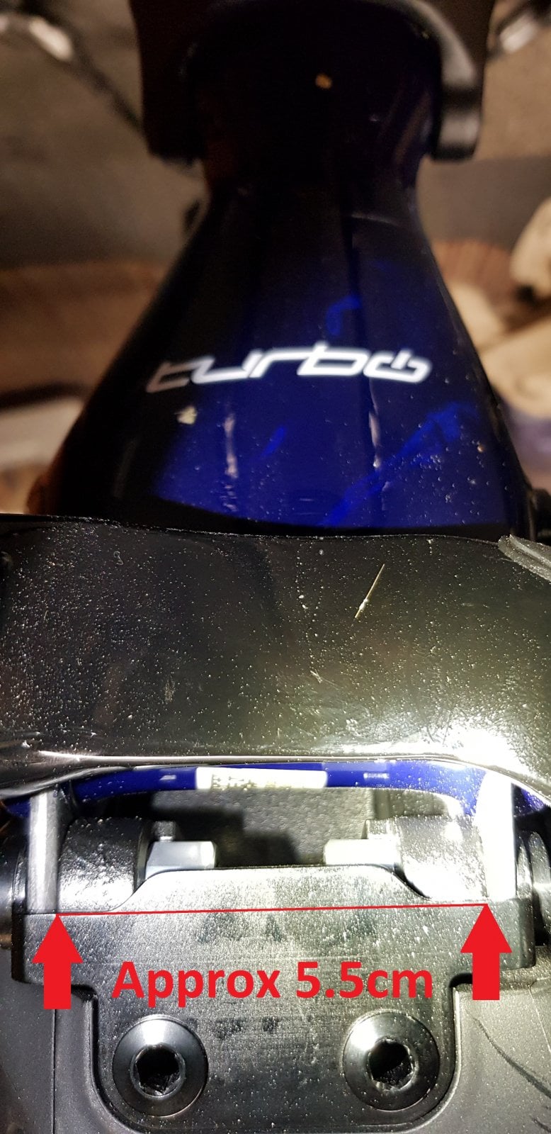

Disagree sorry.... #1,034 is the best solution not #1,042. The foam option from Specialized is okayish and good for a temp fix but #1,034 gets my vote (y). Please take note @Specialized Rider Care.
Post #1,042 will definately stop some of the crap but not All of it.
When the rear shock is at half or full compression the swing arm raises which exposes the hole.
@Indigo have a look at the photo below and you will see what I mean. The photo is with the rear shock at full compression and the rear wheel removed. As you can see, it is a BIG hole. Debris from the spinning rear wheel is still going to find its way in if you go with the #1,042 solution.
I think you're right, debris will still get in that BIG hole.
My thinking - Debris thrown off by centrifugal force leaves tangential to the edge of the tyre. Looking at the bike side on, that big hole appears to be shielded by the chainstay bridge. But any debris that collects there could easily end up in the big hole anyway.
Fig 9.7 of manual shows big hole very clearly so it has to be there for a reason. Impossible for engineers to not notice it; or not consider water and dirt runoff. Therefore, some ventilation is required.
Post #1,009 shows the chainstay bridge from many angles. I think what is needed is a rubber membrane joining seat tube with chainstay bridge to form a roof over the big hole. This would keep the hole open for airflow and guide debris from above to exit over top and down rear side of chainstay bridge. Then have a small mudguard (or likewise) projecting down from rear face of chainstay bridge to form an exit shoot. It wouldn't need to project much, just enough to form a lip to stop water running under the chainstay bridge. @Specialized Rider Care

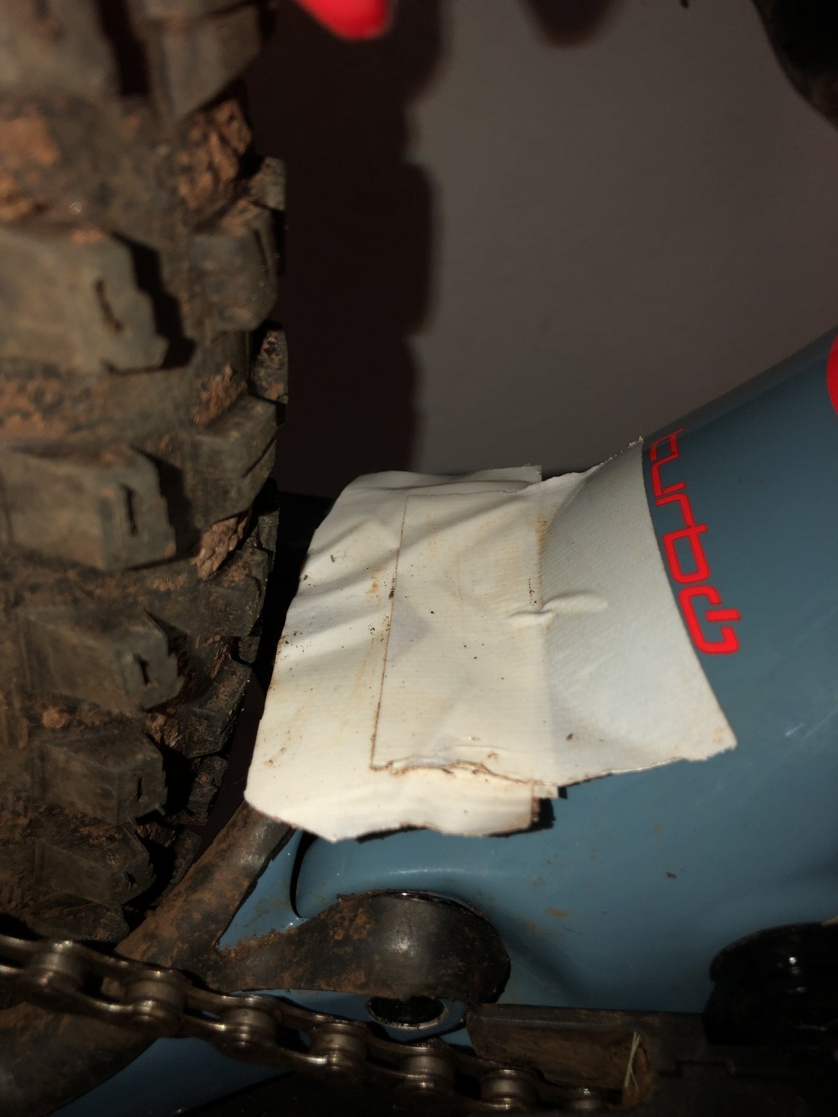

Rode tech trails with this today. Maybe just put a piece of sponge in the bottom hole? This is a few pieces of duck tape. What’s your thoughts? Need to take a pit crew of specialized mechanics with sponges, extra motors, command posts, etc. along for the ride.

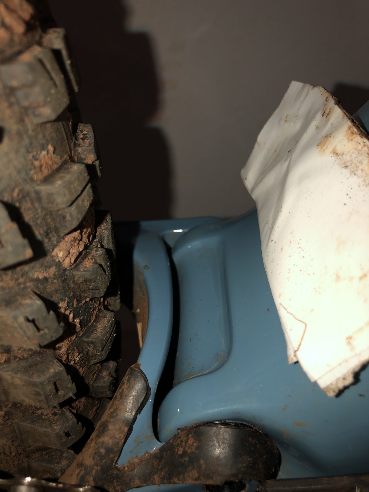

The chain guard kept moving and rubbing on the chain today, it’s attached to the motor mount screw, had to take screw off and reposition but worked.

That’s just the 2.0 version, the 2.1 will be using either black duct tape or might just put a sticker on this mini fender.. works good as long as the tape don’t mess up the frame. The frame should be able to accommodate tape or stickers.The clearance for the stock butcher rear tire is about 1/2 mm. They should have made the small piece of frame that is near the tire in a bridge shape instead to offer more clearance. Might have to tape a piece of sponge over the drain hole underneath but not sure if that’s necessary, like the other poster said. Your thoughts on the drain hole underneath?
