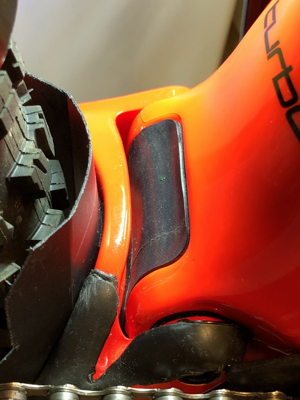

From Antony at bikescene
"Its just a rubber tube cut up with a plastic shim to secure it at the bottom. We’ve made a template so it’s easier to make in the future. The top section is just held in place with double sided automotive trim tape. This section acts as protection for when stones get caught up there too. "
Brilliant! The ultimate solution, and very neat. Well done Antony - you should have been involved in the bike design from the outset...

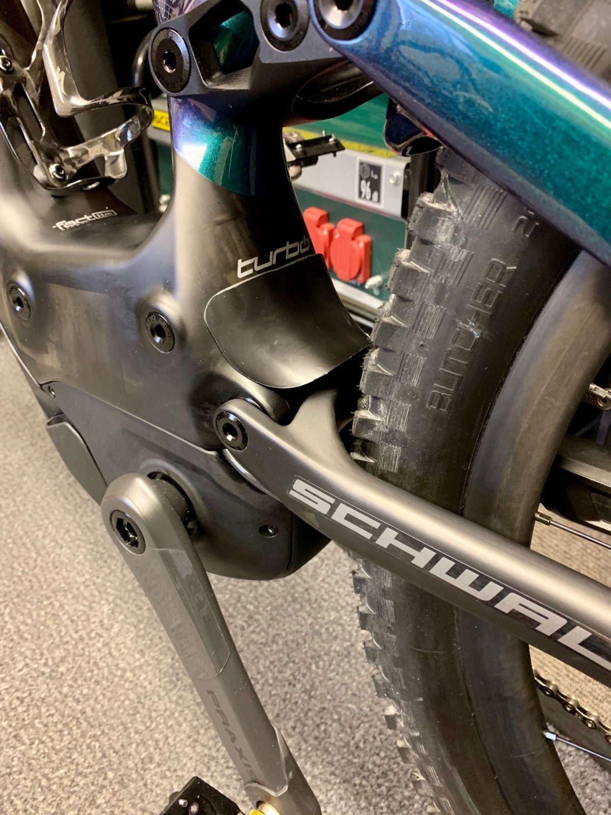

@Highflyer I think you have come up with the best solution so far.
  • It should solve the problem.
  • Keeps the back of the motor open for ventilation.
  • And it looks good.
Looking back at post #1,034 which shows a recessed area, makes me wonder if Specialized forgot to fit a rubber flap/bridge? Their current "sponge" solution seems like it's a knee jerk reaction to adopt the current forum solution (at that time). They probably passed it by the engineers for their approval, rather than asking them to come up with a solution.
Don't mean to rubbish your shit shield, but I think crap will still get in :-(
Disagree sorry.... #1,034 is the best solution not #1,042. The foam option from Specialized is okayish and good for a temp fix but #1,034 gets my vote (y). Please take note @Specialized Rider Care.
Post #1,042 will definately stop some of the crap but not All of it.

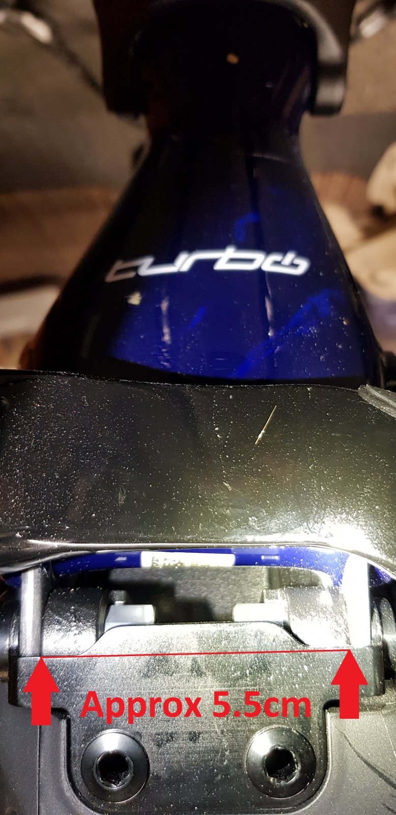

When the rear shock is at half or full compression the swing arm raises which exposes the hole.
@Indigo have a look at the photo below and you will see what I mean. The photo is with the rear shock at full compression and the rear wheel removed. As you can see, it is a BIG hole. Debris from the spinning rear wheel is still going to find its way in if you go with the #1,042 solution.
Is there any chance to get one of these things from your LBS? I love the solution!
I think this is the best solution so far as well but I am only asking myself if the hole was also designed for cooling purposes? If so, then the sponge would be the best solution although I also think it clog/block rapidly. Anyone any ideas about this?
