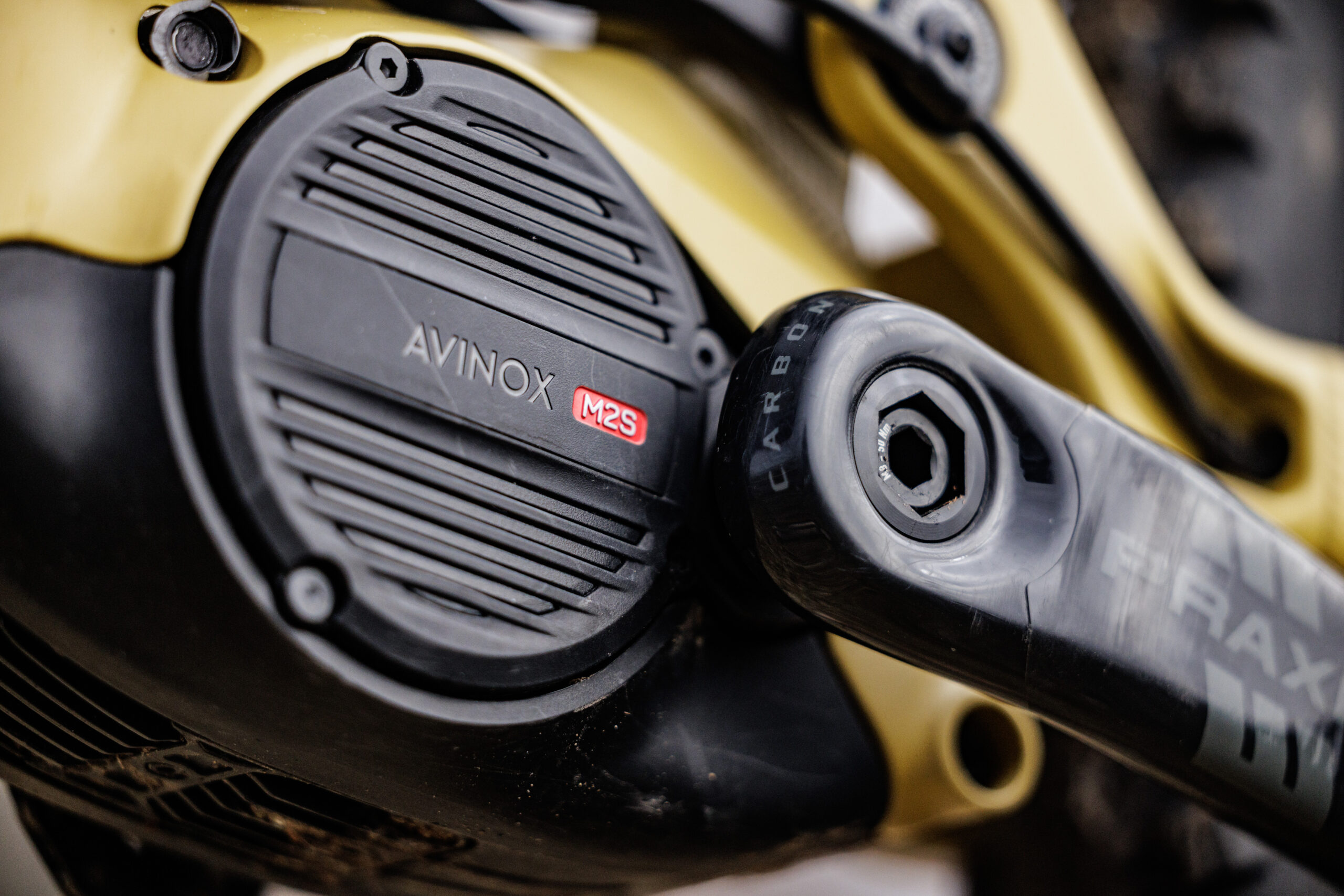

DJI's flagship is the most powerful production eMTB motor yet measured — 150 Nm Boost and a dyno-verified 1,450 watts at the cranks, in a 2.59 kg package. Here's what that actually feels like on the trail, where it lands against Bosch, and the one thing no-one can vouch for yet: how it holds up over time.
M2S eMTB motor
The DJI Avinox M2S — 150 Nm Boost and a measured 1,450 W from a 2.59 kg drive unit.

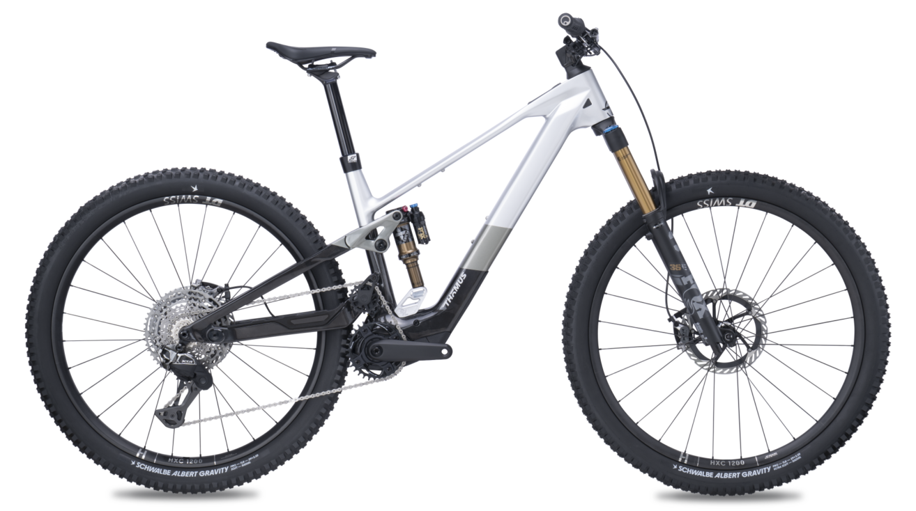

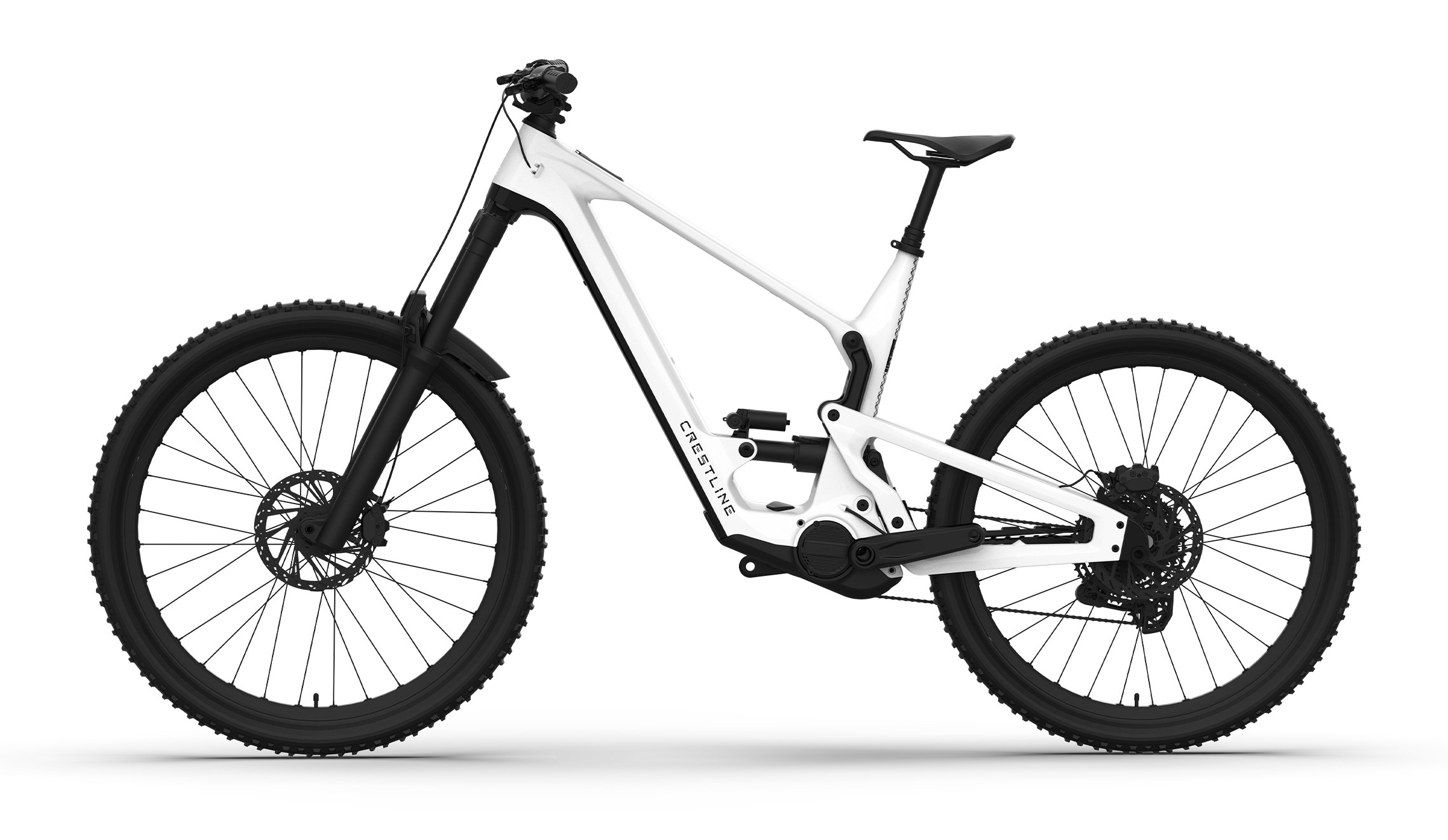

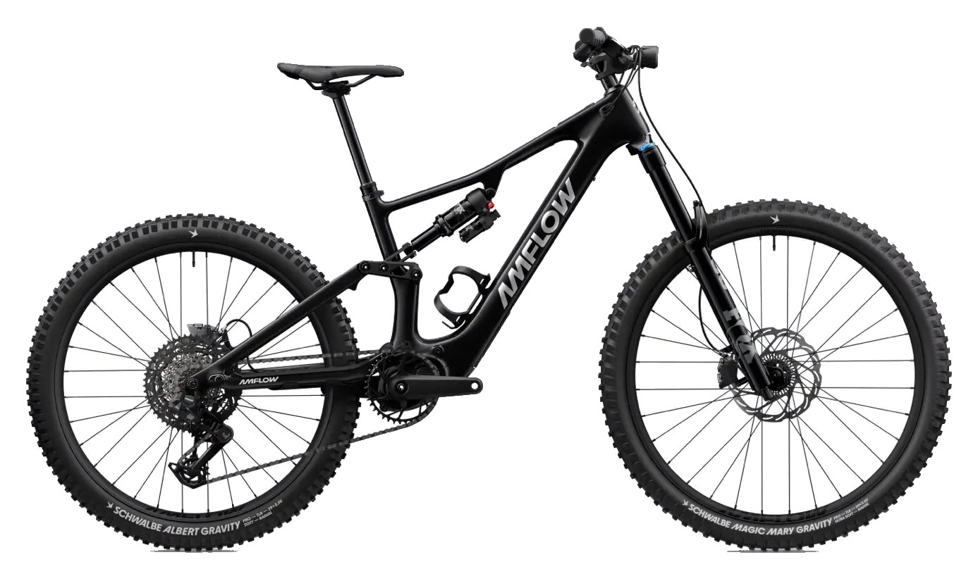

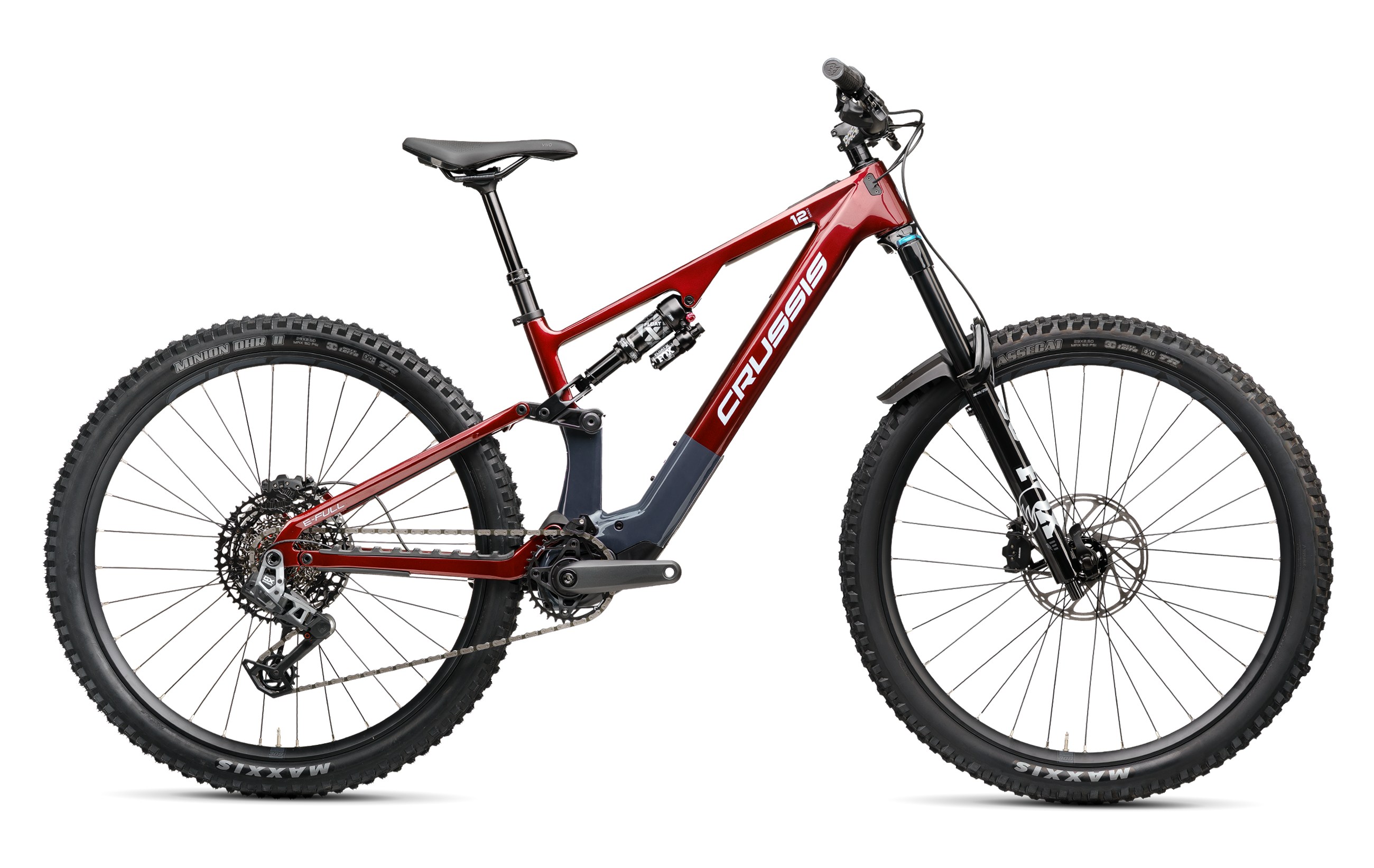

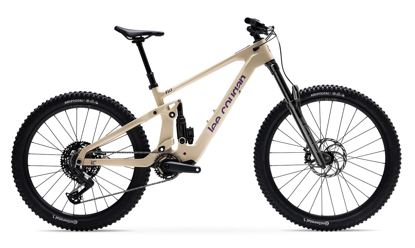

Bikes you'll find it on. The range now spans roughly sixty brands. For trail duty the Forbidden Druid E 2026 at 160/150 mm is the obvious benchmark, paired with the RS800 pack. The Amflow PX Carbon 2026 is the reference enduro build at 2.4 kg frame weight with the FP700 for full sustained output. For bigger terrain the Atherton S.170E 2026 runs 180/170 mm on the same drive unit, and the Crestline RS181 2026 pushes to 180/181 mm. Budget-leaning, the Megamo Reason 2027 brings the M2S into more sensible money. Tuning varies: Amflow's stock map is the most aggressive in Boost, while Megamo softens the initial ramp noticeably.
