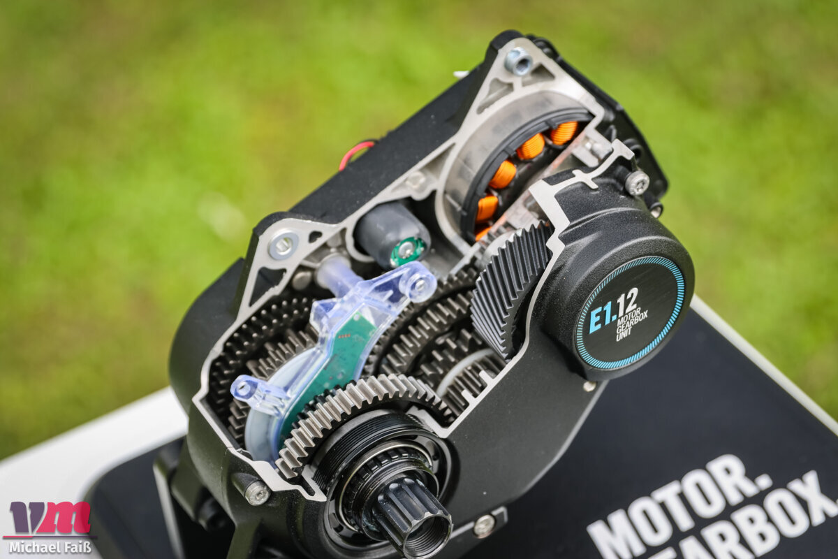

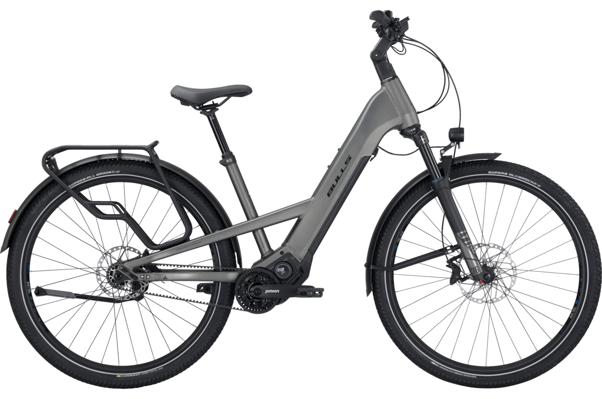

Pinion's MGU E1.12 is a radical full-power motor with a 12-speed gearbox built into the same housing, replacing the derailleur entirely. It trades 4.1 kg of mass for a 600% gear range and genuine tractor-like climbing.
MGU (E1.12) eMTB motor
Cutaway of the Pinion MGU E1.12 — motor and 12-speed gearbox share one housing.

Where it stands apart is the gearbox. Because the motor always works through whatever ratio you select, the easiest gears multiply torque to as much as 160 Nm at the cranks. No climb is too steep for the gearing, and the assist comes on early and full even at low rider input. The flip side is character: testers call it 'more brute-force than caress', with little of the gentle power trailing (Nachlauf) that helps on slippery technical climbs.
It is also the heaviest motor in the field at 4.1 kg, and audibly louder in the lowest four gears — though near-silent in the high gears and downhill thanks to the belt drive. On heat it is reassuringly undramatic: both BIKE Magazin's lab/trail test and Velomotion's climb runs report no derating problem under sustained load, so the headline figure is sustained climbing pace rather than a number that collapses after a few minutes.
