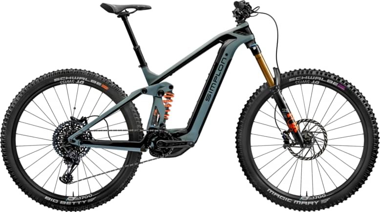

The Simplon Rapcon Pmax 2024 is the Austrian brand's all-mountain eMTB platform, available in two trims — the base (Pinion MGU E1.12 gearbox-motor at €9,999) and the :eCX variant (Bosch CX at €9,779). The Pinion build runs an 85 Nm torque / 600 W manufacturer-claimed peak motor (4.1 kg motor weight) with a 720 Wh FIT Ultracore battery. Travel is 170 mm front and 165 mm rear on a carbon FSP 4-Link (four-bar) chassis. Four sizes from S to XL, reach 424-495 mm, head angle 64.2 degrees flat, chainstays 447 mm flat, claimed weight 24.72 kg. The community read in one line: a thoughtful Austrian carbon all-mountain platform offered with the choice of Pinion MGU gearbox or conventional Bosch CX, with documented MGU teething issues and some historical frame quality concerns.
Drive system and range. The Pinion MGU E1.12 trim is the headline: an integrated motor-and-12-speed-gearbox in a single 4.1 kg unit, eliminating the rear derailleur and cassette in favour of belt drive. 85 Nm of torque. The :eCX trim runs the conventional Bosch CX motor for buyers who want the proven mainstream ecosystem. The 720 Wh FIT Ultracore battery is removable. Real-world range on either trim will sit in the 50 to 75 km territory on Trail/Boost mode. The Pinion MGU offers shifting under load and shifting while stationary — properly different from a conventional drivetrain — but with reliability caveats.
Geometry and handling. Modern, sensible. 64.2 degree head angle is bang on the all-mountain norm. Reach progresses 424 mm (S), 455 mm (M), 475 mm (L), and 495 mm (XL). Chainstays held at 447 mm flat across all four sizes. Wheelbase 1210 to 1302 mm. The FSP 4-Link suspension is a Horst-style four-bar that delivers consistent small-bump compliance and progressive bottom-out. Simplon's geometry is designed for daily-and-trail versatility with trailer approval — properly Austrian utility ethos in an all-mountain package.
Build and value. Two trims well-spaced. The (base) Pinion MGU at €9,999 (24.72 kg) is the headline build with gearbox-motor and 720 Wh battery. The :eCX at €9,779 (24.4 kg) is the conventional Bosch CX alternative. At these prices expect RockShox Zeb Ultimate or Fox 38 Factory at 170 mm front, Super Deluxe or Float X2 shock, SRAM Code RSC or Magura MT7 brakes, and DT Swiss H-class wheels. Premium European pricing for premium European specs.
