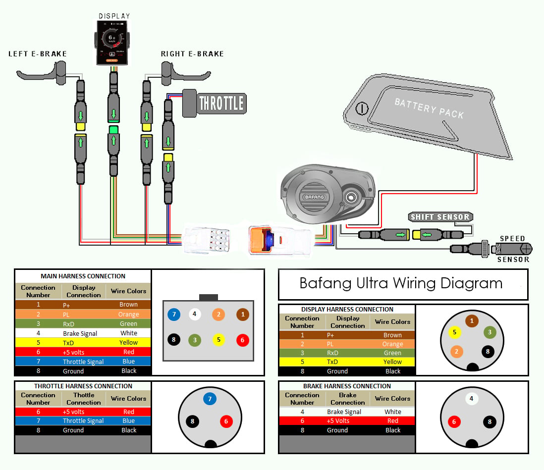

Does this help?
My 510 has the plugs color coded, it's just plug and play.

I managed to put it all together and make it work. Indeed, connectors are color coded and only fit where they belong.
As a piece of advice for newbies like me reading this thread, make sure that connectors are fully inserted, as the connection is made only when they are bottomed out in their sockets. Because of this, I learned that it is better to insert all connectors to the motor before putting it in its place and fixing it, because you can better apply force to insert them.
