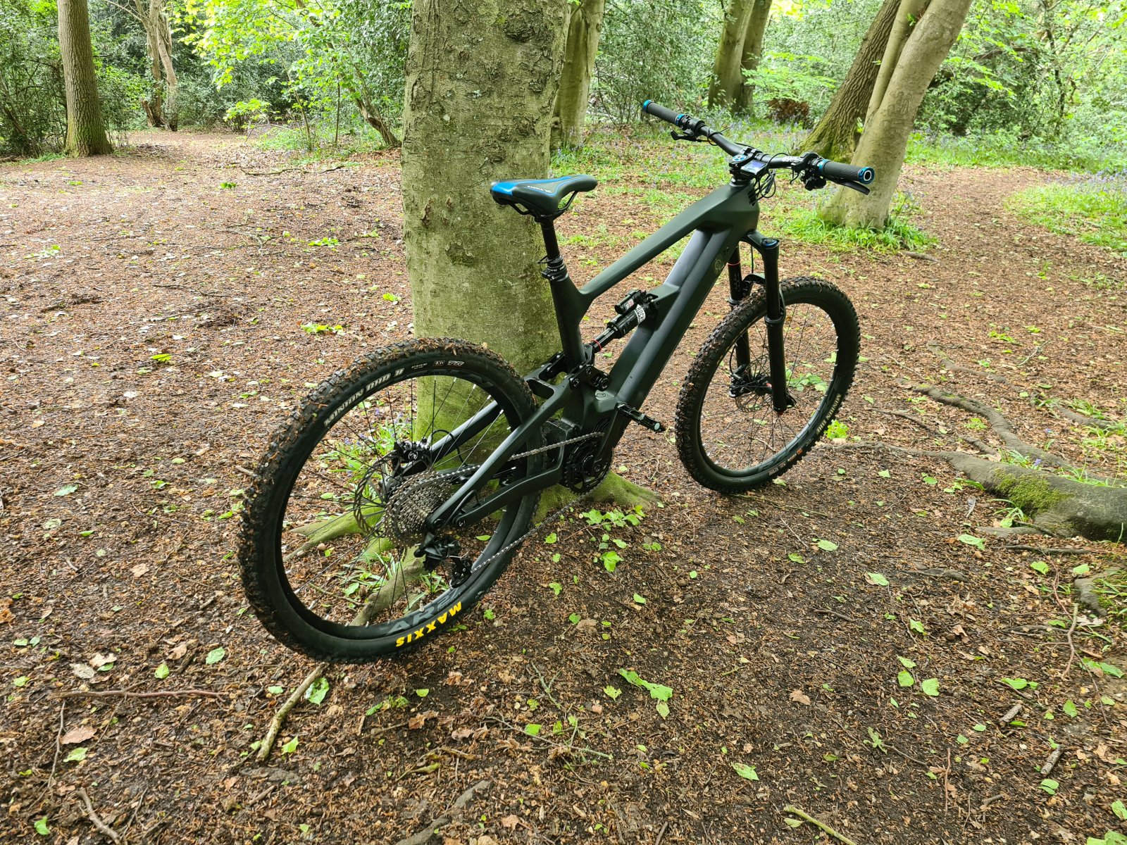

Hi I used RockShox yari 180mm RockShox rc3 216×63 Offset bushing front and rear for shock 27.5 dt swiss 370 wheels madura 05 brakes 200mm front and rear and matt black spray from Halfords 150mm dropper seatpost 31.6 and the only thing I brought brand new was the seatpost most of it off Facebook marketplace or eBay
