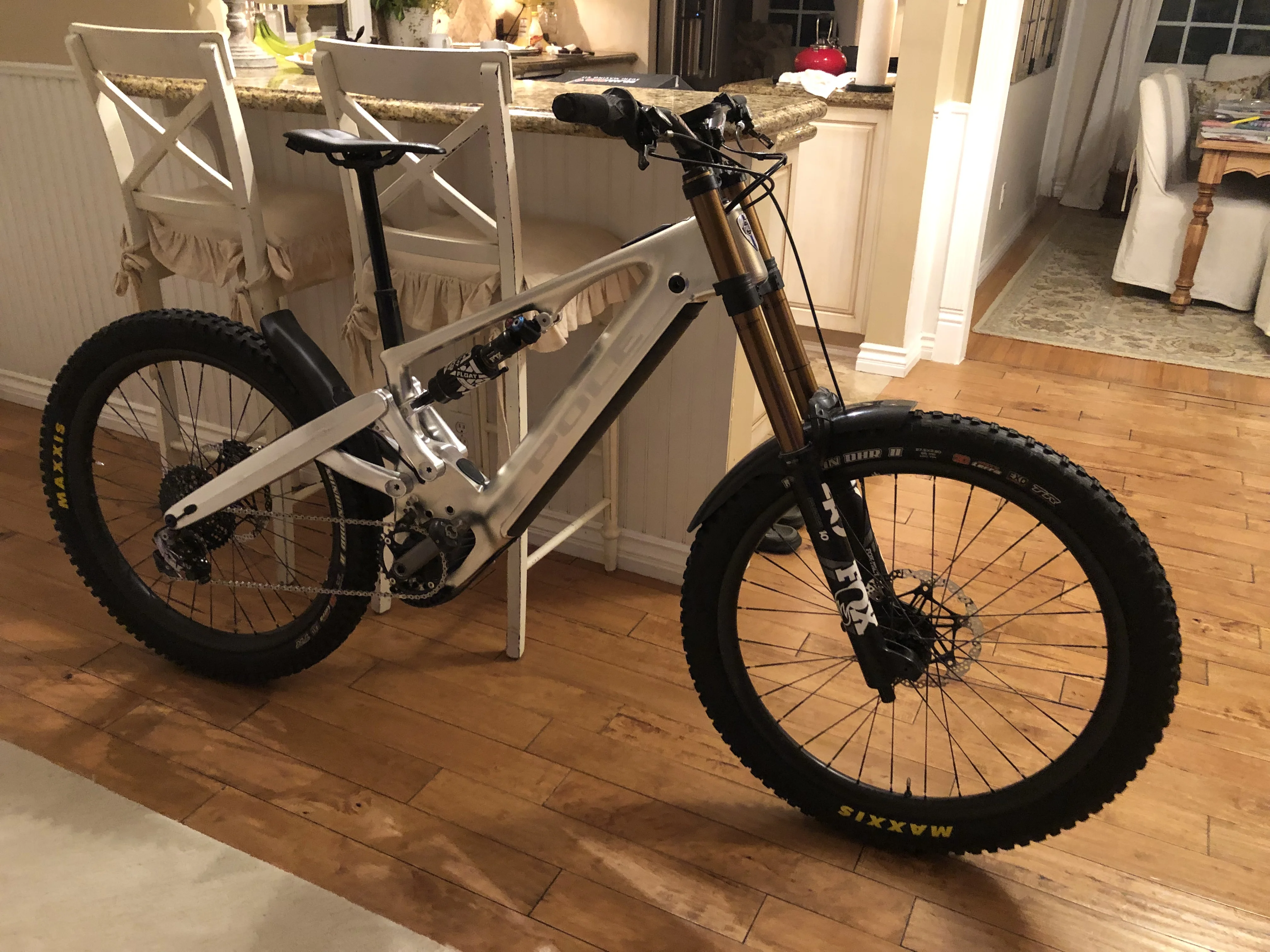

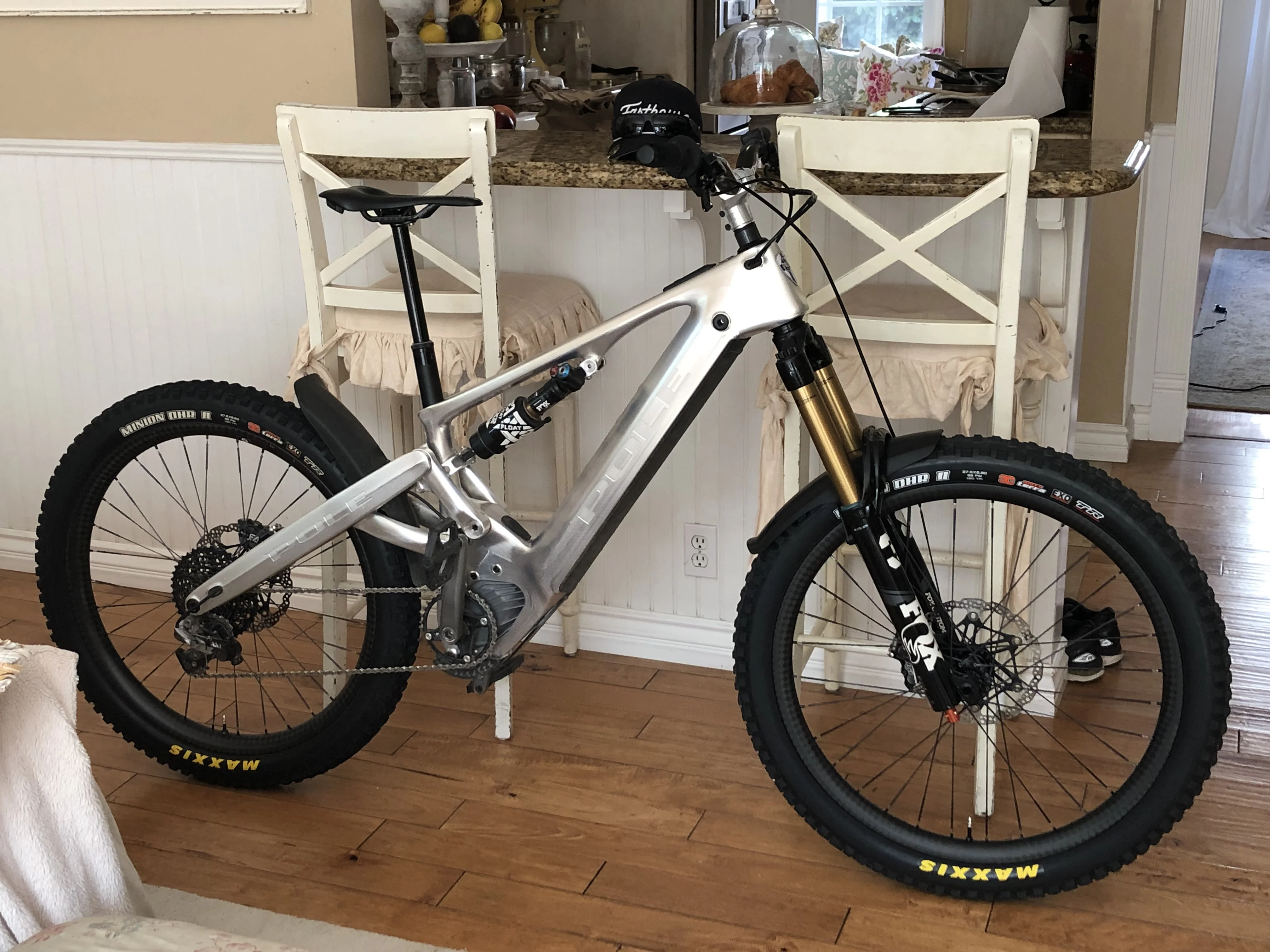

I think my Kenevo looks badass with this setup, it looks like a proper DH bike (profile pic is a bit old, but its similar), looks super slack and moto

It would certainly help the geo since the stack is way too low, and the reach too long on the kenevo.

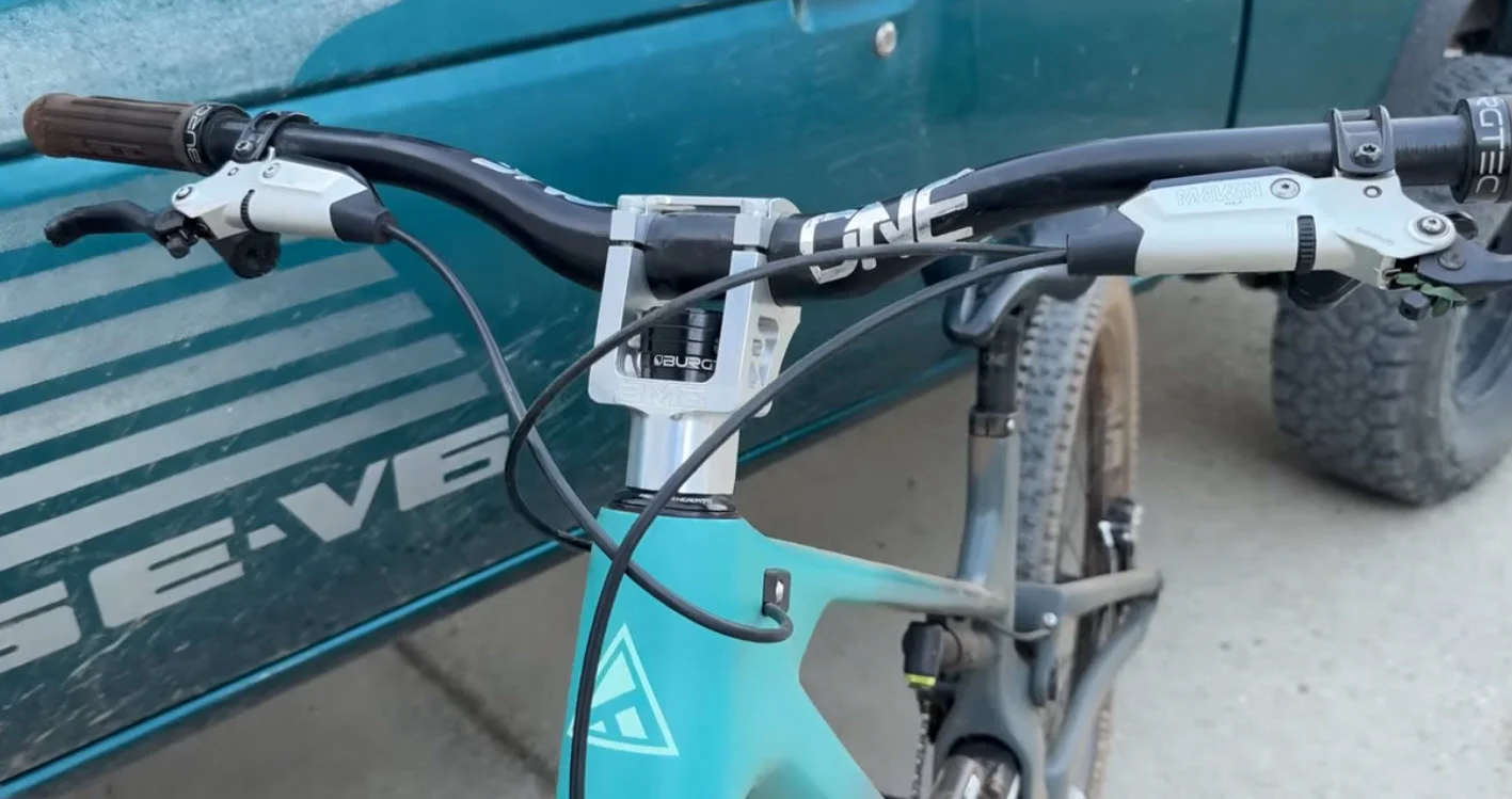

It's tolerable once you put 60-70mm of spacers under the stem 🤷‍♂️ .
A size 4 kenevo has an okay f/r ratio, for an older bike, at 1.84. Unfortunately the long reach at 500mm puts you forward of where you want to be. Because of the laughably low stack at 620mm though, you can run a pile of spacers and long steerer to achieve a more modern body position. Which is kind of what you have done, no ?
