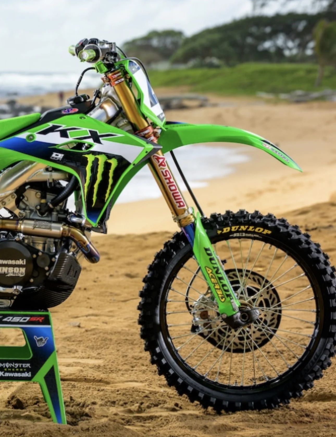

It’s taking notes from the moto world. Bars over/slightly behind fork.
I think it could be made to look ok if it wasn’t so tall then get the rise more out of the bars if needed. I’d be interested in trying one out
Funnily enough, no connection to moto. I don’t ride and have never ridden a dirtbike. That said, on dirtbikes your hands are behind the steering axis typically about 45-55mm with the bar sweeps they use, and a straight line drawn from the foot pegs to the center of the grips is about 65-66 degrees. With the RR stem on a size L mtb from many brands, your hands are 45mm - 55mm behind the steering axis, you have a 65-66 degree angle, and the actual stack and reach is within mm of on a dirtbike. 😅 I came to this geo over 3 years experimenting with 70mm forward to -70mm Reversed offsets from below traditional heights to about 80mm taller than the Gen 1 150mm RR stem across 9 different bikes of various frames sizes, wheel sizes, and geos. I often jokingly say that I could have saved myself 3 years of development if I just copied a dirtbike. 😅 My driving philosophy though is you never learn if you don’t experiment, and I’ve certainly learned a lot. 😊

As for high stack, look at old and new snow mobiles. New have super tall bars and are built to ride standing fully straight, and old are built to sit down and are "unrideable" by modern standards
Also I don't think it's exactly comparable to an MX bike. First, MX bars are pretty low and nearly straight so they don't sweep way back. Secondly fork offset is typically about 22mm, not 44mm like on a MTB. Thirdly if set up correctly, even after bar sweep, the bar ends should not be behind the inline of the fork. I do agree that on a MTB the bar should be aligned with the fork angle, but not a dirt bike. Because when you huck big on an MX bike your weight comes nearly straight down over the front end so that's the angle you want the bars at for the most absorption. But importantly, MX bikes turn on the throttle with very light front ends and really don't depend on front wheel traction the same way a pedal bike (or e-bike) does.
I’m sorry dude I have to call you out on this info being completely false.
Eli tomac bar rise 54mm and bar sweep 54mm
Jason Anderson bar rise 52mm sweep 52mm
Chase sexton 56-58 on both
Bar ends are 100% not in line with the fork. That would be a terrible setup. You make the bar bend parallel to the fork which is in line with the steering axis and with the bar sweep your grips will be back end or behind the fork. Unless you’re calling ever professional racer ever wrong.
When your are turning you 1000% are depending on front end traction lol. You have to counteract the throttle by moving your weight forward. That’s why we sit way up near the gas tank and keep head over bars in turns with smooth throttle to weight the front end and get traction.
