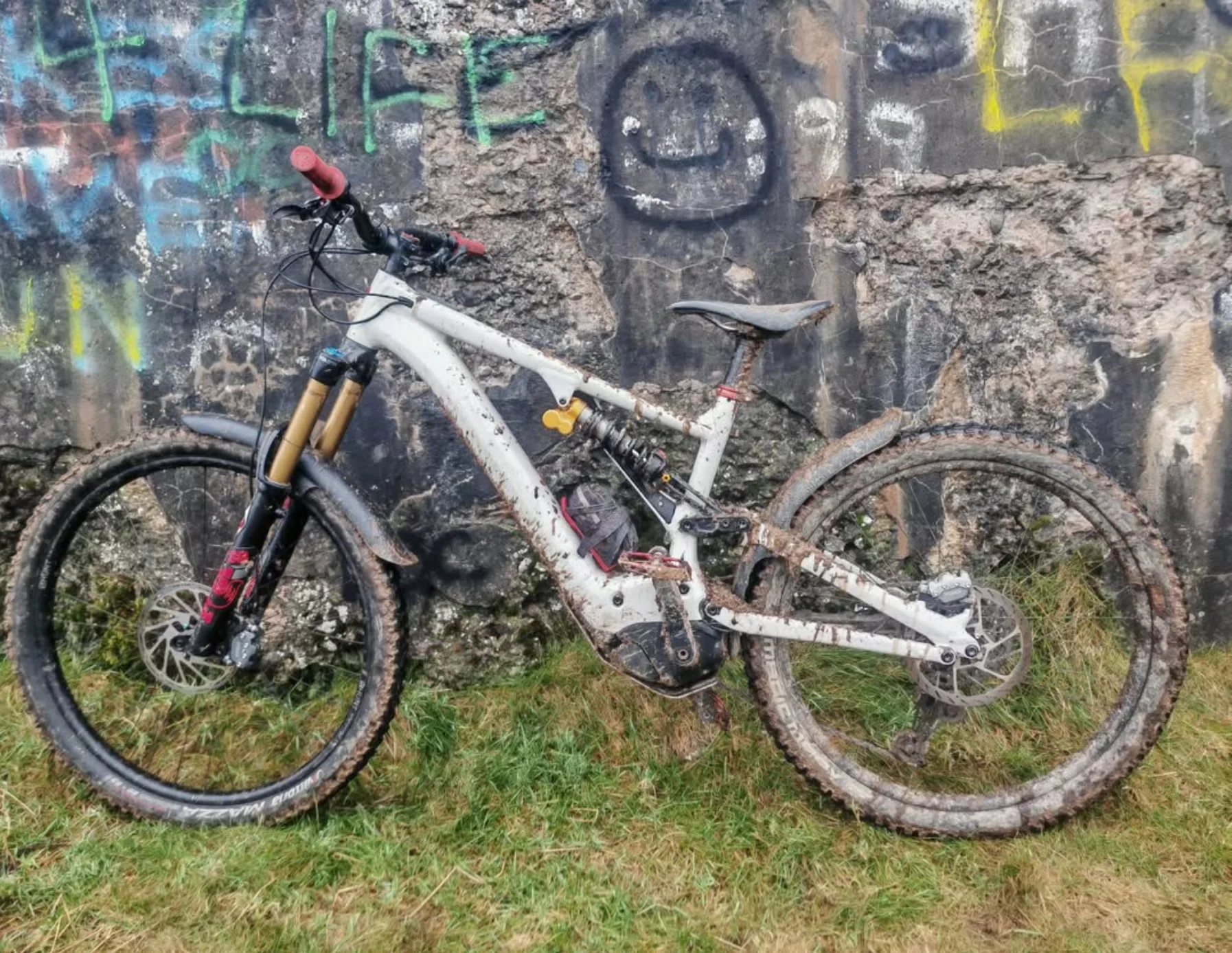

Had another ride today in the Surrey Hills. Much flatter terrain, lots of tight flat corners, jumps, drops, classic Surrey Hills riding. Bike was superb. Lots of people LOL'd at the bike, thinking that I should be doing Rampage on it! But then after a while when people saw how it handled everything they were more intrigued.
I sat on my friends "traditional" enduro ebike whilst he had a quick go, and his felt like a tiny toy bike in comparison 😁
I am going to run this setup for the foressable future on my bike. @BeMoreBikes what an amazing concept!

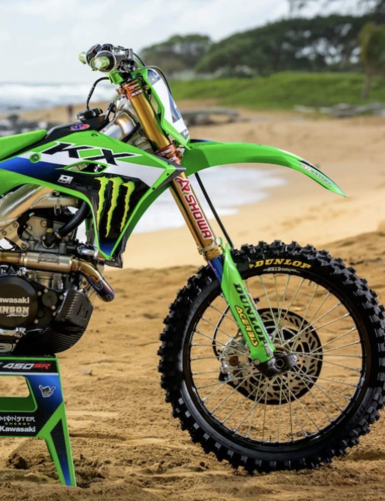

I’m sorry dude I have to call you out on this info being completely false.
Eli tomac bar rise 54mm and bar sweep 54mm
Jason Anderson bar rise 52mm sweep 52mm
Chase sexton 56-58 on both

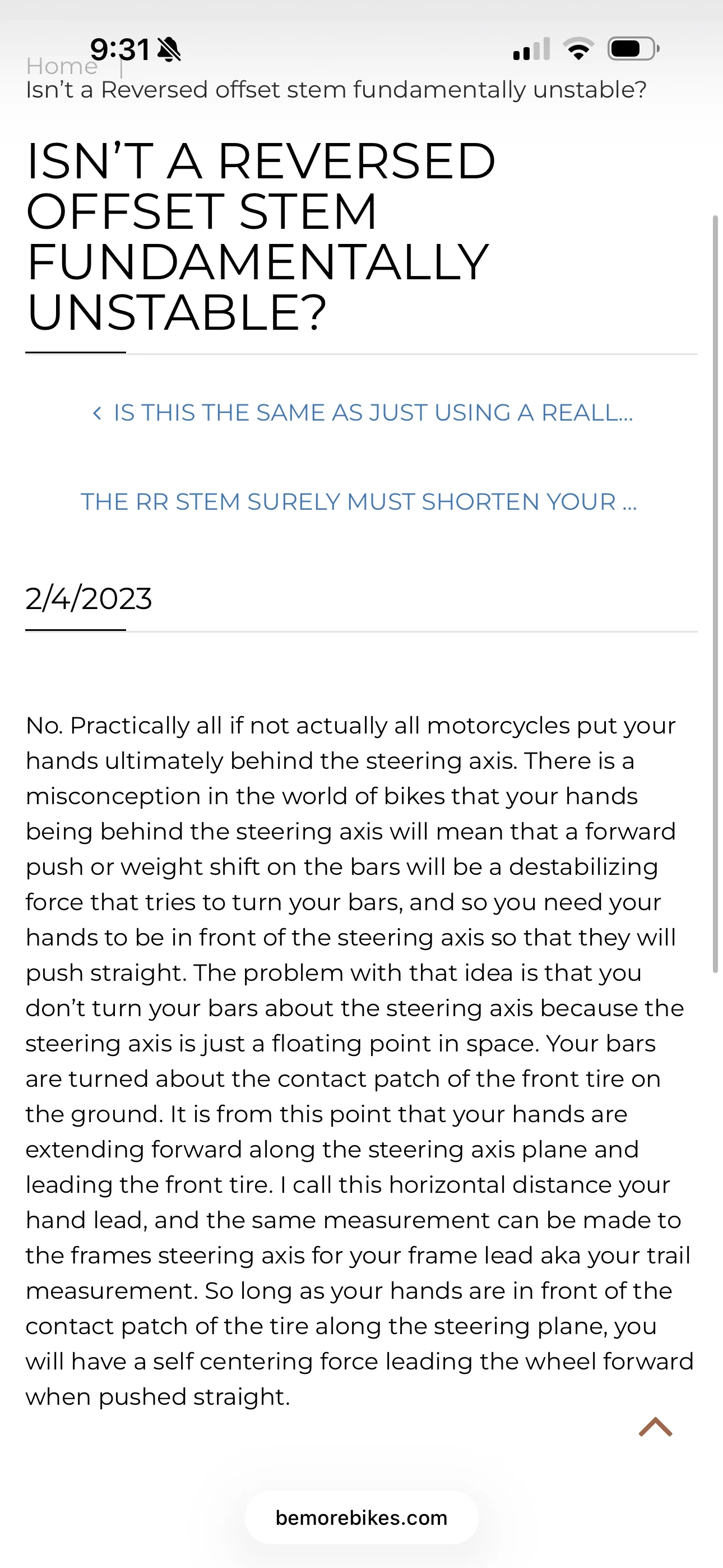

Bar ends are 100% not in line with the fork. That would be a terrible setup. You make the bar bend parallel to the fork which is in line with the steering axis and with the bar sweep your grips will be back end or behind the fork. Unless you’re calling ever professional racer ever wrong.
When your are turning you 1000% are depending on front end traction lol. You have to counteract the throttle by moving your weight forward. That’s why we sit way up near the gas tank and keep head over bars in turns with smooth throttle to weight the front end and get traction.
I never mind be corrected with good info, so thanks for the actual numbers on the current crop of MX bikes.
That said, I was a decent MX racer until I broke my spine in 2011, and I disagree on your take on front wheel traction. You load the front tire up with hard front brake use entering the turn to initiate the turn, after that you are hard on the throttle and the front tire is basically a direction indicator/ rut guidance system contributing very little to direction changes which come from rider balance and throttle use.

Sorry I came off a little harsh, didn’t mean to sound like a jerk.
Agree that mtbs turn a little differently, but that comes down to weight of the bike. In mtb our bodies are the heaviest weight. In moto it’s the bike. Moto depends on the surface. We arent riding mtb on sand tracks. Sand track in moto, yes your weight is a little more back to keep front lighter, but you still absolutely need front end traction. But on harder pack tracks this is where the turning is more comparable to mtb especially with newer riding style of standing further into corners and sometimes throughout (Jett Lawrence is the new god of moto technique and worth a watch as his attack position and technique is just as proper for mtb). You have to have front end traction or you will wash the front out. You do not “load the front” then go “hard on the throttle.” This is bad technique. You brake before entering the turn just like in mtb. You don’t blip or go “hard on the throttle” at all. That’s a beginner move. Your throttle should be controlled to keep front end traction and load the bike properly. You also weight outside peg like in mtb.
All good if you don’t agree though. Fun chat on that. I guess my whole point of comparing to moto was that there are a lot of similarities and this new stem design keeps the bar bend more in line with the steering axis which imo is where the benefits come from (similar to moto). It’s well known that a longer traditional bar stem is worse than short. People use longer stems for reach, but it’s more ideal to have shortest stem possible keeping bars closer to steering axis.

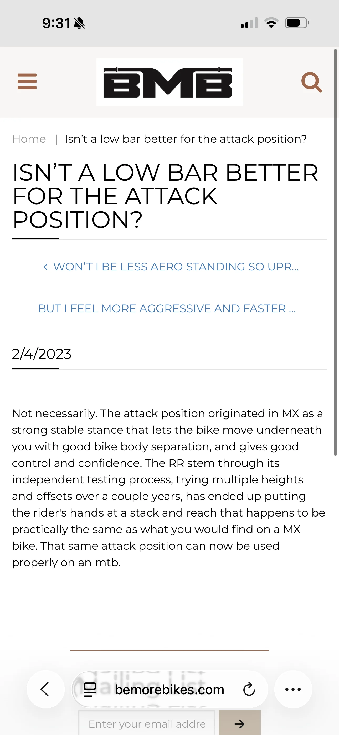

@Suns_PSD
These faq’s are directly from that stems website. It seems like they are taking direct inspiration from moto and the stuff I was just talking about.

Mtb and moto cornering isn’t directly the same, I agree with that. I also agree you can use the rear end to turn a bike, but that’s not a blanket generalization for turning a dirtbike. Front end traction does matter though. I am simply comparing this stem and where it puts your bars to dirtbikes as it seems very similar and was my first thought when I saw it. This goes beyond cornering as well. I see this setup putting your body in a better position for probably all dh situations. Jumping, cornering, drops, rock gardens, stability at speed, etc.
I’d love to hear @BeMoreBikes comment on comparisons to moto and if there was any inspiration there. I may be completely wrong and I’m ok with that, no hard feelings if you guys correct me.
@Suns_PSD
Funnily enough, there was no inspiration from moto. I do not and have not ridden moto, and I found out how similar it was after having customers tell me it felt like their dirtbike.
I make the comparisons on the website because it is really similar, and there’s a decent number of mtbers with moto experience who can be helped to understand it better when they see that. If only I had a penny for every time I’ve heard that if this made any sense we would have seen it before in mtb or moto because they don’t realize mtb geo has been moving in this direction taller and shorter stems for years, and moto is already like this… 😏
As you noted for bar sweeps, dirtbikes put your hands typically about 45-55mm behind the steering axis with their bar clamp location which is the same hand offset you have with the RR stem on typical mtb bar sweeps. Also, the angle feet to hands on a dirtbike is typically in the 65-66 degree range which is the same as you get with the RR stem. On most size L mtbs you are within mm for stack and reach to the hands as on most dirtbikes. I often like to joke that I could have saved myself 3 years of development if I just copied a dirtbike. 😅
I came to the tuned -15mm Reversed offset with a notably Raised height over about 3 years experimenting from 70mm forward offset to -70mm Reversed offset from below traditional heights to about 80mm taller than the Gen 1 150mm RR stem and all kinds of heights and offsets in between across 9 different bikes with different frame sizes, wheel sizes, and geos.
