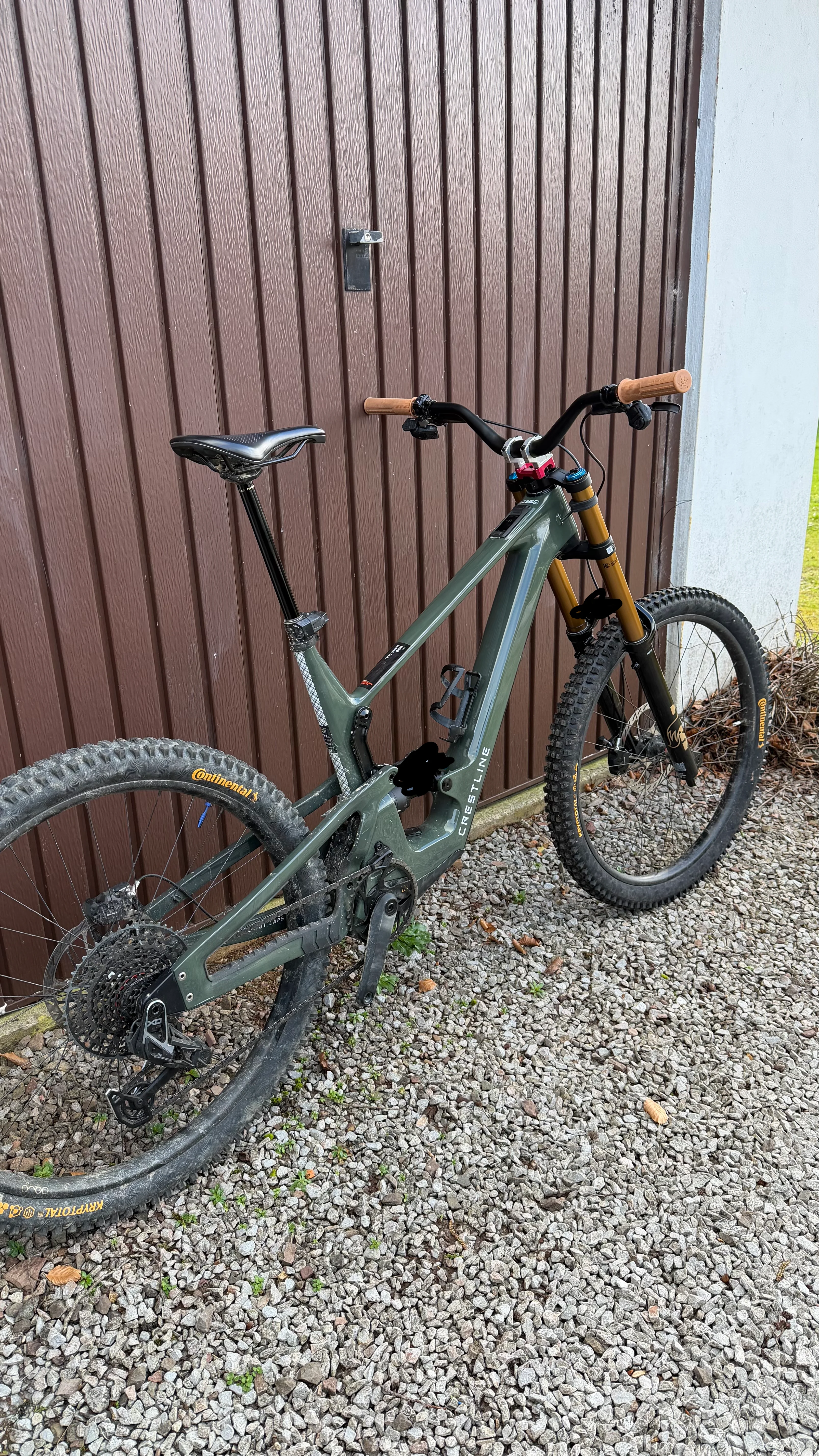

Intend 25mm stem, love the front end control, full blown test mule w 474 chainstay and 502 reach in the making.

These are all on a standard 2022 Trek Slash 8 29 M/L with a 75.6 degree seattube angle and 437mm chainstay run with the even taller Gen 1 150mm RR stem and typically about 30mm spacers below it bringing it even taller for me at 5’8”.
