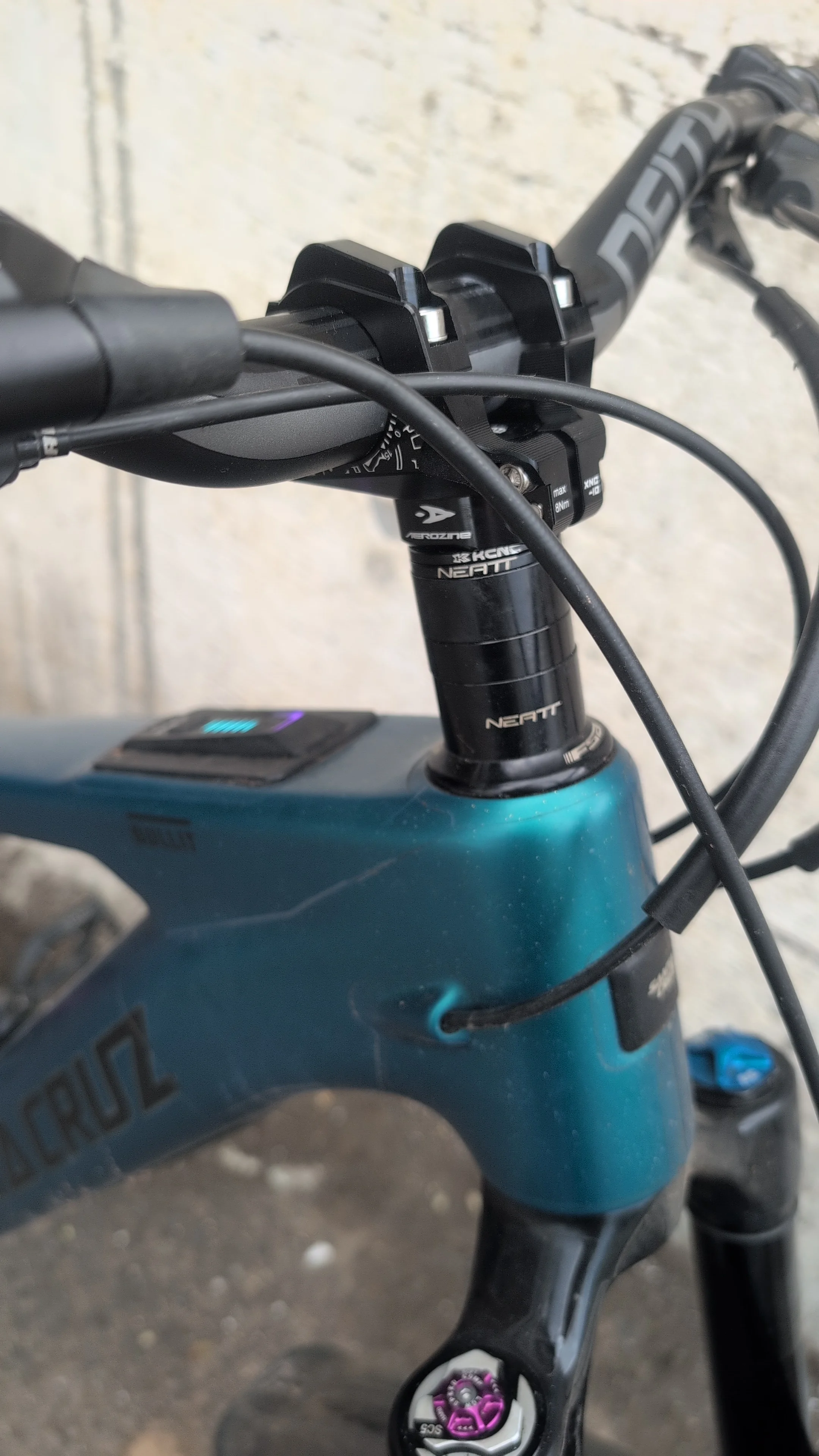

New member. Joined on account of this thread. I've ridden the RR stem loved it and have been running a similar setup for the last 3+ years.

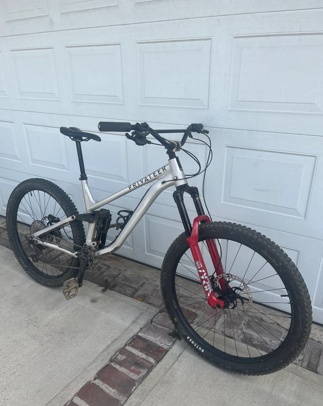

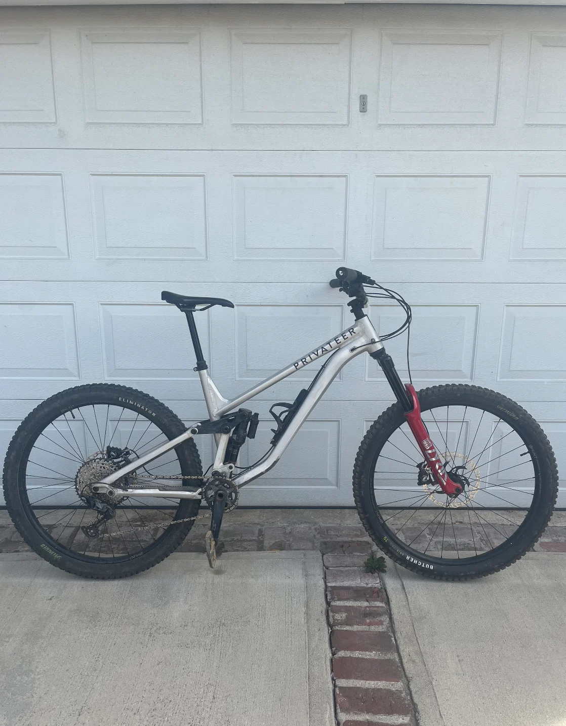

My bike is an XL gen Privateer 161 with Surly Sunrise bars and a 31mm renthal apex stem. I'm 181cm tall (6'0").
- RAAD ~60°
- RAD 899mm
- Reach 443mm (from grip to bb)
- Stack 783mm (from grip to bb)

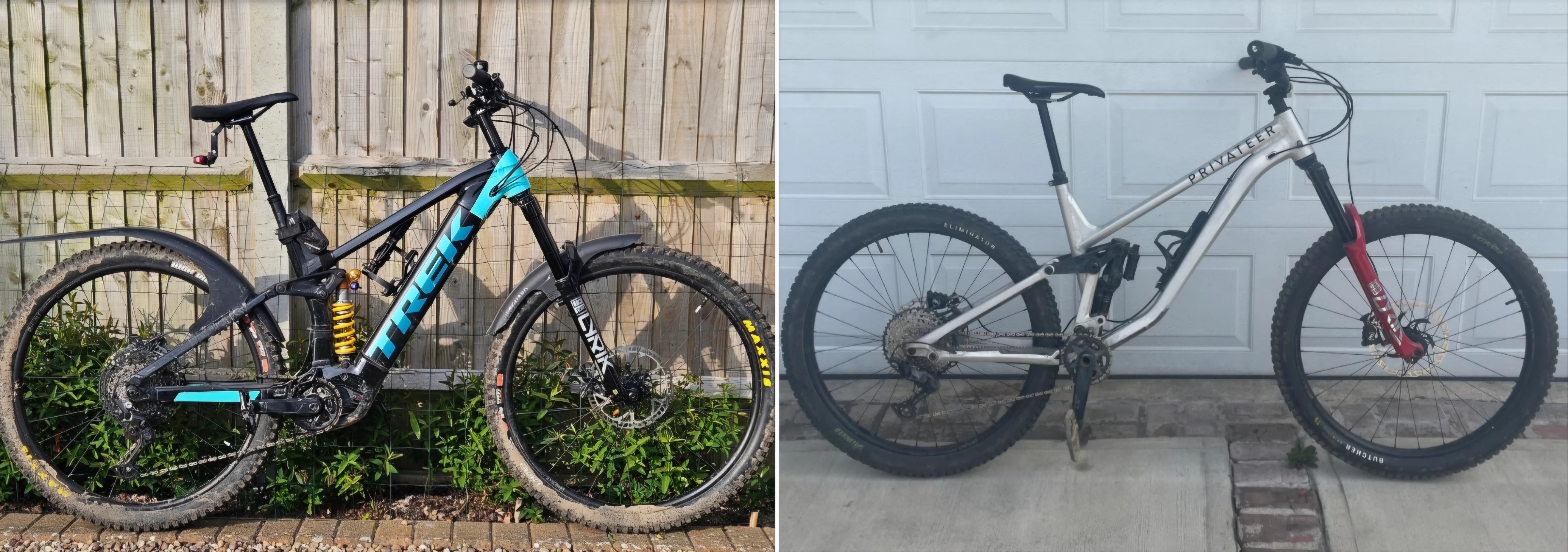

That is such a franken bike.

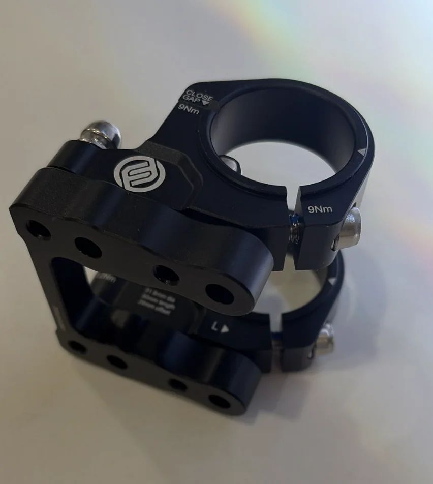

I've just ordered one of these:
Should be arriving this week.
Not cheap (or obscenely expensive considering its origins) so I hope I get on with it!
I'll feedback here. Thinking of adding a Reach increaser headset too as I have a ZS56 headtube, or rotate the stem like plf013 above, but the Intend stem is +25 length, maybe too long to spin around!
I run PNW Range handlebars with 25mm or 38mm rise, I can't remember, so it'll be interesting to see if they fit the stem with it's 20mm rise limit and clamp design... 🤔

Why is there a max rise?
I would guess that because of the 2 bolt clamp design. Trying to fit high rise bars through the clamp will prove challenging because you can't open up the clamp wide enough.
With most stems the 4 bolt clamp face completely comes away allowing any rise bar to be fitted.

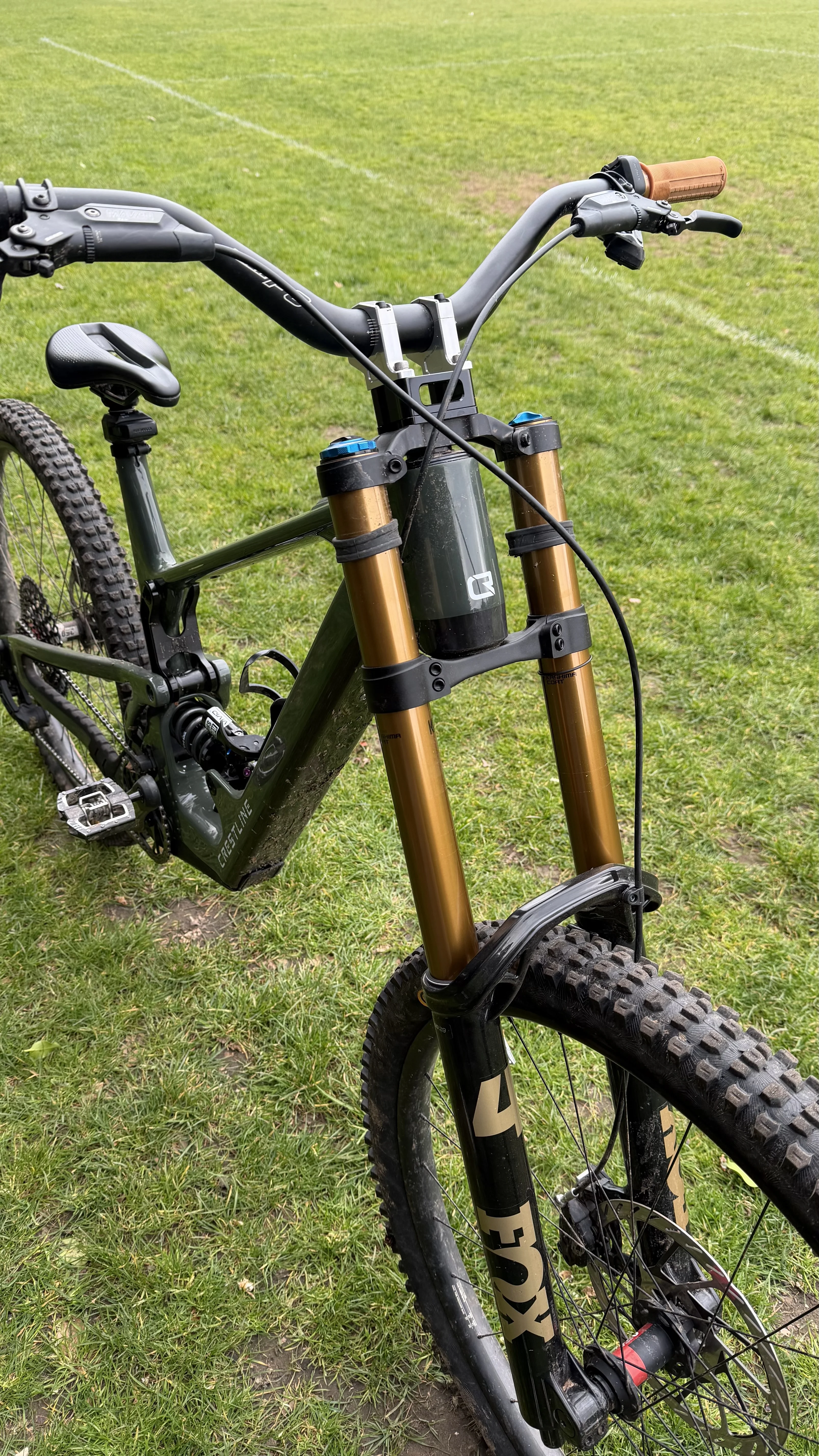

The bar is already 38 mm high. Very hard top find a bar witha higher rise, good shape (up and backsweep) in 31.8 mm.
I know This fitting is uggly af, and very flimsy.
Only one ride with it for now. I will dig into it a little bit more now to find the good balance. I ll add one more token in the fork and réduce the pressure. Lot more to come
Where did you buy it? I can't find it in the UK. Also, I've seen other people comment that they couldn't get it to grip tightly enough on the steerer as there isn't a large clamping surface - does it feel secure to you?
Aerozine Website. It took only 4 days to.come: XNC 10 STEM Bundle (31.8 mm clamp diameter) - AEROZINE
Only one ride and no issue with the only 20mm high clamp. Berms, jumps, rough stuffs it stays strait

OK thanks. Not that cheap with shipping but still less than BMB etc. I'm just wary of cutting my steerer down in case I want to go back to regular stems. Maybe I'll try it on an old set of forks first.

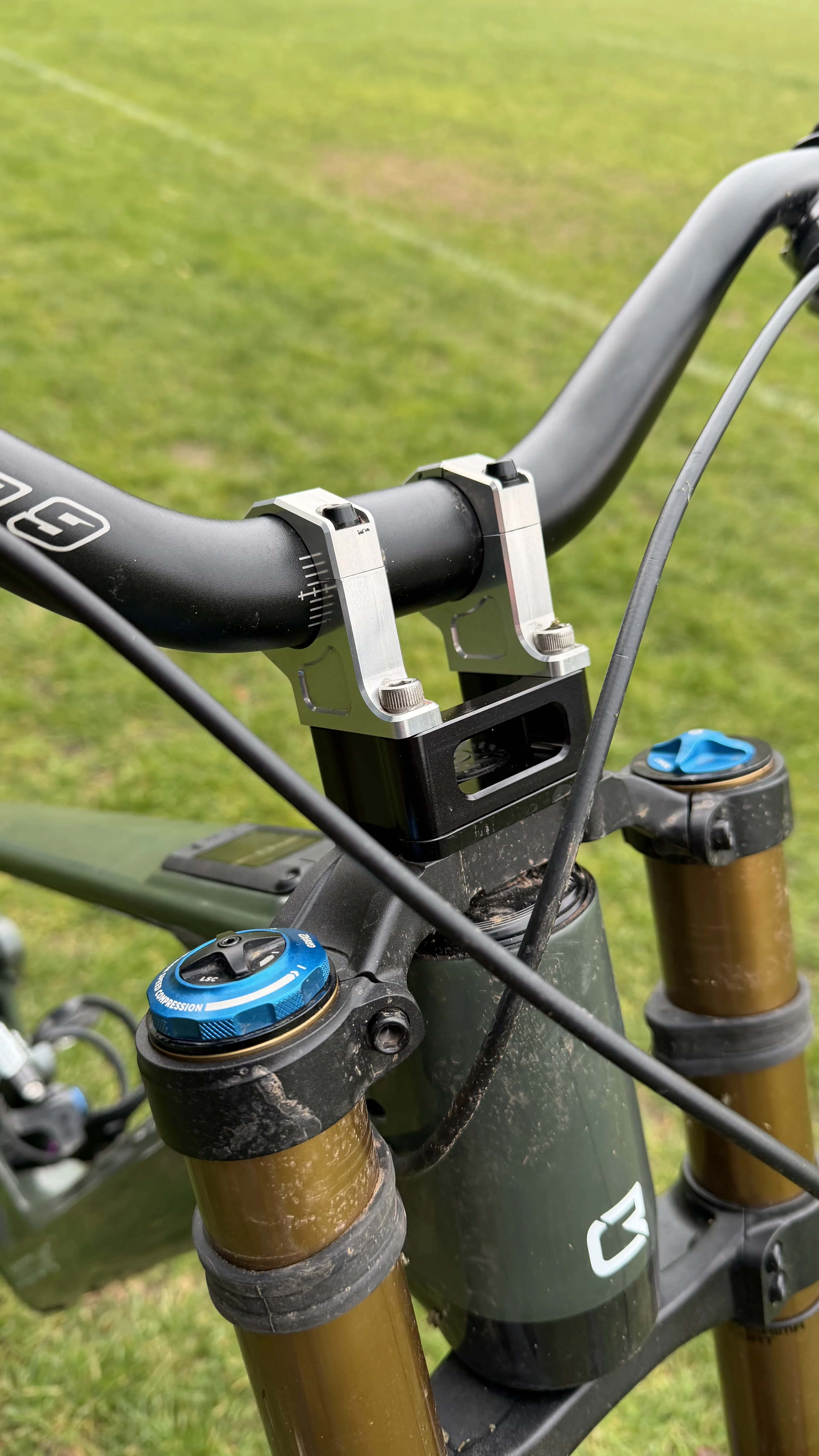

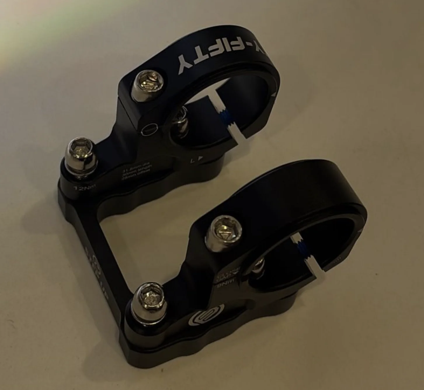

Here's some of my parts.. still waiting on bars.
Fifty Fifty Stem 30mm offset and 28mm rise/ 31.8mm
Spacer / Reach adjust 12mm
Will shoot a complete setup once I get my bars.
Current mounting solution give a 40mm rise and -8mm offset (DM mounting pattern has 10 mm offset, so reversing the stem will natually reduce it by -10)
Bars will be 35mm rise with 5 backsweep @ 780mm. There's a 50mm version available.

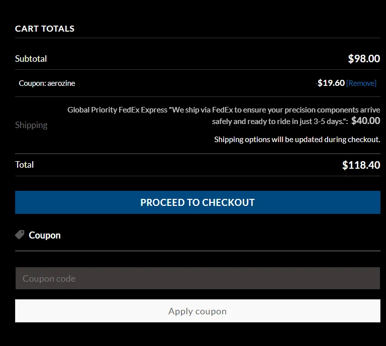

total cost shipped to Canada: $216 CAD.
Stem spacer / offset - $98
DM Stem - $61
Bar - $57

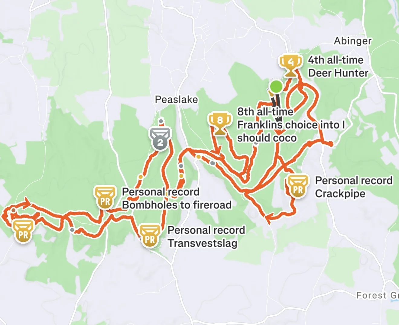

Have you ridden that particular bike in non-goofy format on that route ?
Good point. I’d definitely rode the black Crestline I had with Avinox M1 motor there. Perhaps not exactly the same route.
What I notice with this funky setup is the amount of front end grip on flatter corners. Can really turn the bike hard due to the extra leverage on the bars.
And as soon as it gets steep it’s ridiculously easier than conventional setup.
