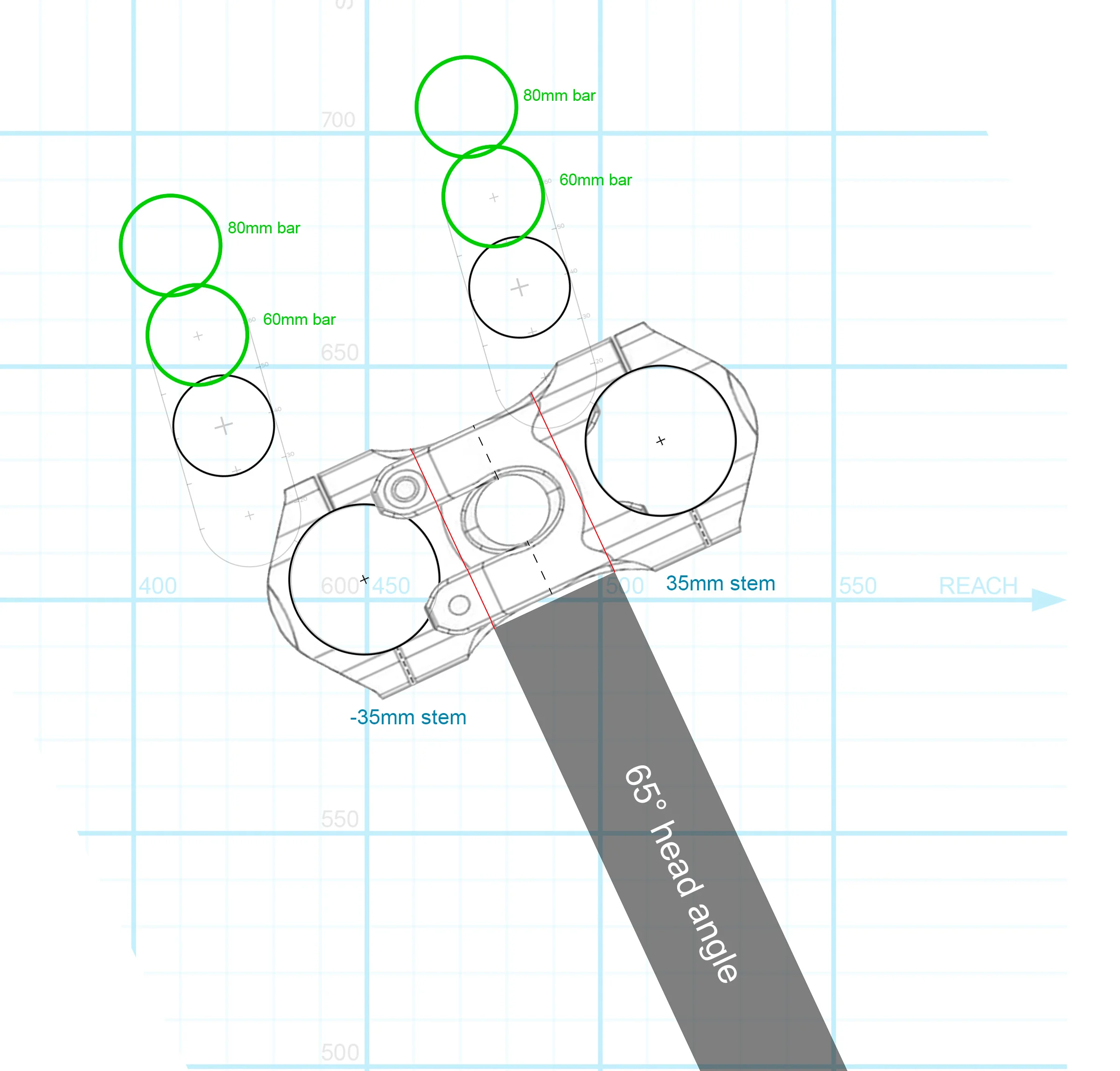

“Frame Lead” is the exact same as the trail measurement you are likely familiar with just conceptualized as the frame leading the contact patch of the tire instead of the contact patch of the tire trailing behind because I find it a bit more intuitive. You draw a straight line horizontally from the contact patch of the tire forward until it intersect the steering axis extended to the ground.
“Hand Lead” is like trail but specifically looking at the relationship of the hands to the contact patch of the tire relative to the steering axis. You draw a line parallel to the steering axis that intersects the line going across between the grips, and you measure the horizontal along the ground from the contact patch of the tire to where that line parallel to the steering axis intersects the ground.
On a forward offset stem, you have a Hand Lead that is longer than your Frame Lead. On the RR stems Reversed offset, you have a Hand Lead that is shorter than your Frame Lead but still in front of and leading the contact patch of the tire. Semi similar to how a shorter trail measurement gives less wheelflop and a lighter steering feel at the frame, less hand lead gives less wheel flop and a lighter steering feel at the bars while keeping all the same steering stability of the frames long trail measurement.
The other aspect of the Reversed offset is that since it arcs to the outside of the frame instead of dropping to the inside like a traditional forward stem, it helps put you towards the outside of the frame when the bars are turned. For example in a left hand turn, when you turn the bars to the left, the bars move over to the right a little bit instead of to the left like on a traditional forward stem. In practice since you move your arms pretty much along the same path as usually this means that the frame leans over to the left more when you turn the bars left with a Reversed offset, and less with a forward offset. That additional bike lean when turning the bars helps drive the bike into the turn more with better sideknob engagement, a kinematically tighter turn for a given rotation of the bars, and gives a more predictable drift response. 🤓

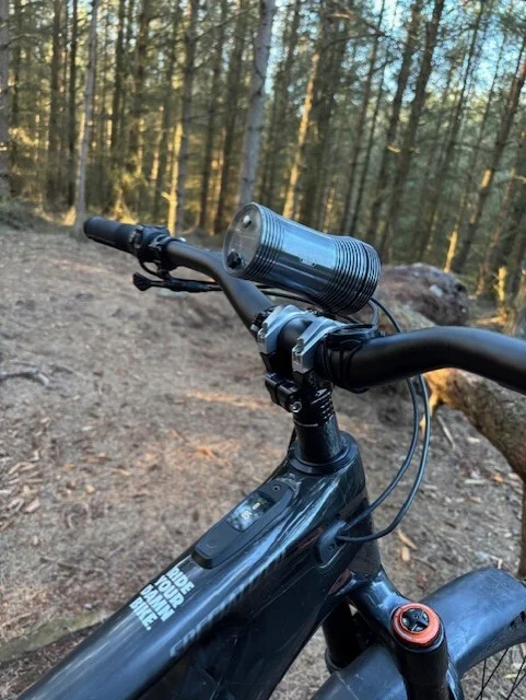

Just went for another ride on a trail I haven't ridden during the winter, and this setup is just so much fun. I get such a feeling of flow and control, its amazing :D I only have like 40mm spacers, rulezman stem and 80mm bars on the Kenevo, which is low stack to begin with. Not sure what that is in total, ~140mm rise?
I'm getting more and more sure I need to go higher. At that point I will might start to compromise the aesthetics though..

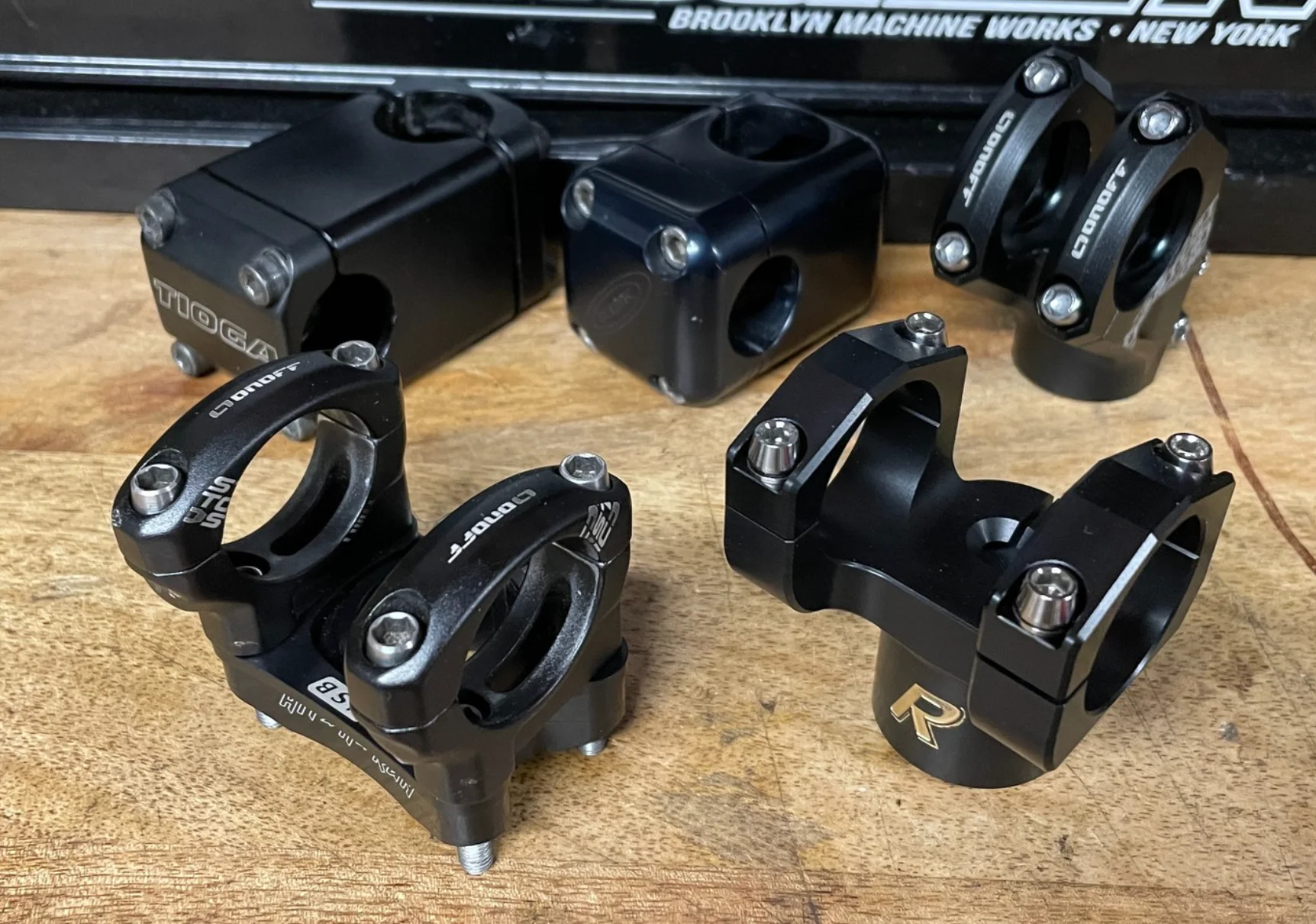

Looks great the little you can see in the videos. I have bars with rise from like 30 to 80 so adding an extra 50-70 mm from the stem by replacing the rulezman should let me adjust the rest through the bars. Soon time to buy another very expensive custom stem it seems like..
How does -15mm compare to running the rulezman direct mount stem reversed?
Edit: Also make sure they are available in plain aluminum / silver!

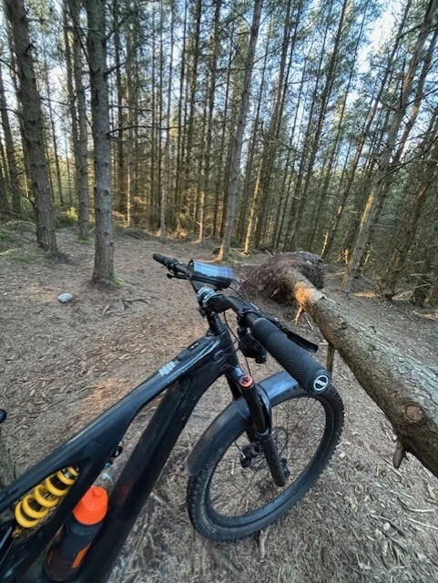

Just got back from a 30 mile ride. Thought I'd share some things I noticed.
1) Cornering felt fantastic. I've been working on leaning the bike and bike body separation when cornering. This just made leaning the bike feel natural and effortless. Uphill hairpins felt great immediately. Downhill hairpins needed a bit more practice but were fine towards the end of the ride.
2) The bars being more towards my waist when seated riding was a noticeable downside if I was being lazy and climbing rock gardens seated. Square edge hits that try to fling my weight forward are harder to catch with the disadvantaged angle. I don't consider this a real downside though, since it's really a result of me riding sloppy when tired.
3) The cockpit is notably smaller. I found that it's harder to get up on the saddle when stopped, as I kept catching my shorts on the saddle. I had to stand/lean forward quite a bit when getting up. I'm thinking I might slide my saddle back a bit.
4) Jumps felt good. I don't do big jumps, but the small ones I do felt good and balanced.

After seeing the Raised reverse stems a couple of years ago I gave it a try, by using direct mount stems reversed. I have an OnOff 10mm, which reversed becomes 0mm (not -10mm due to DM fork mounts being 5mm offset from centre). I also have a flippable Hit'n'Run DM mount for single crown forks, a 15mm Rulezman stem, and 20 and 25mm DM stems, so I was able to test everything from +25 to -25mm stems, taking the pullback of handlebars into account each time too. I tested with bars from about 10mm rise to about 100mm (Renthal DJ bars, NS District, ProTaper pit bike, and some cheap 31.8mm hi rise bars from China.
I came to the conclusion that approx +15mm was the best for me, which depending on bars puts your hands inline with the steerer, essentially a 0mm length. I didn't notice any improvements with a reverse reach.
One thing that is definitely questionable is that the further back your bars are, with the reach of the bike and wheelbase staying the same, the less your weight is over the front wheel.
I've had conversations (arguments/discussions) with the guy from BMB who makes that stem, and I don't agree with everything he says. He makes a lot of scientific claims, but whether these technicalities are actually a benefit or not is still subjective.
Another perceived difference can also be that everyone's buying longer and longer bikes and using a reverse stem is bringing your posture back to how it was 15 years ago, with shorter more nimble bikes.

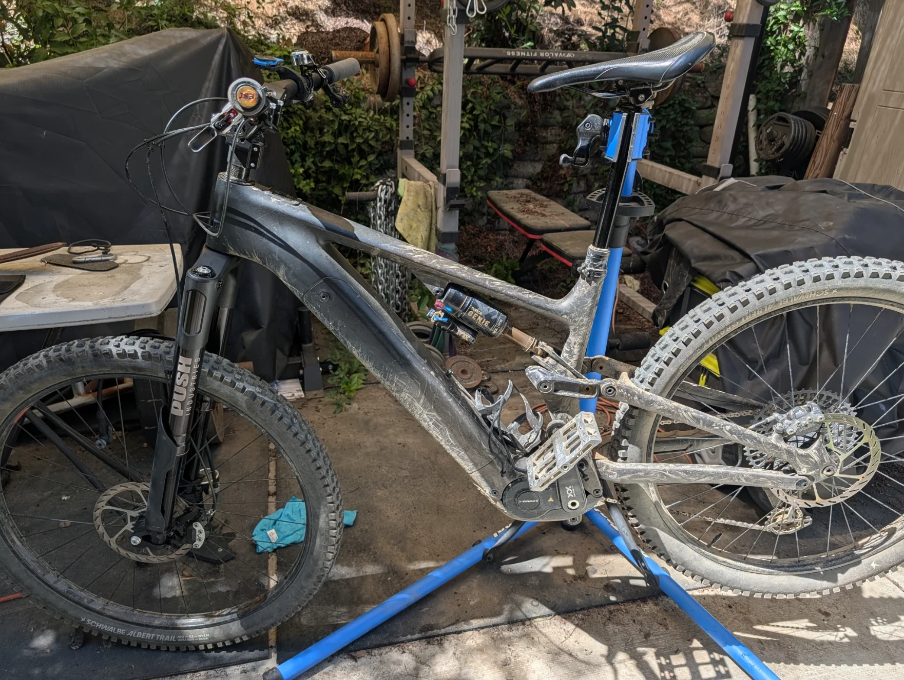

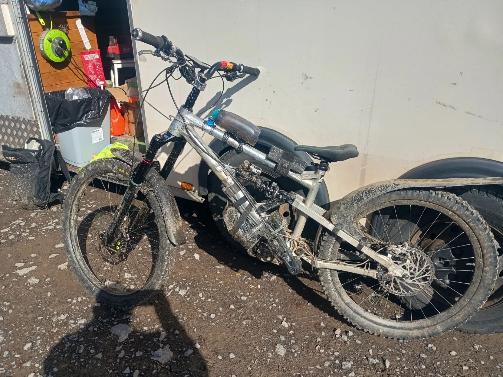

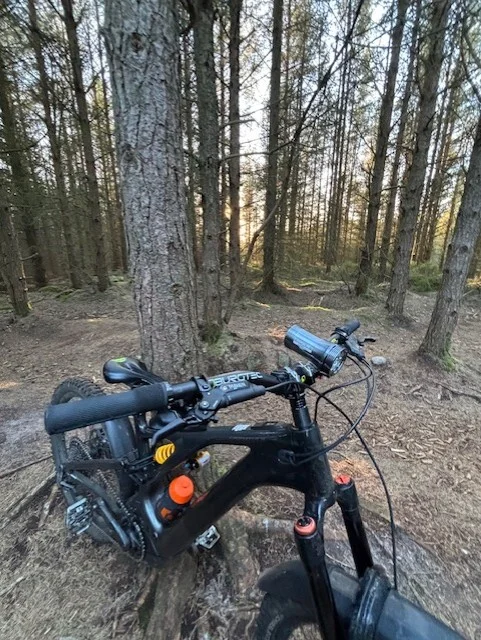

Took my medium Geometron G1 (with CYC X1 Stealth motor and DIY battery) to Bike Park Wales on Monday to try out the high bar idea. I'm only 172cm and the reach is something like 490mm so I always had the bars pretty high to compensate, but never this high.
As advertised, it was much better in any situation where going OTB is a concern: steeps, drops, chunky rock gardens, long corners, some jumps. The front wheel did lift a bit on steep climbs, but it wasn't too bad with the current 445mm chainstays (the battery weight helped keep the front down), and they can be extended to about 460mm. I didn't have any problems with front wheel traction on corners.
It wasn't all roses. There's no getting around the fact that higher bars need to be moved a greater distance to achieve a given lean angle. This made quick changes of direction difficult for me, so the high bars didn't seem ideal on tight, twisty, flat sections of trail. The front end also felt a bit flexy under my 110kg of weight; a dual crown fork would be better.
Overall, I'm pretty much sold on the concept for a DH-oriented bike, especially on steeper, more open terrain. I'll need to ride the bike some more on XC-type routes before deciding whether it's suitable for general trail riding.

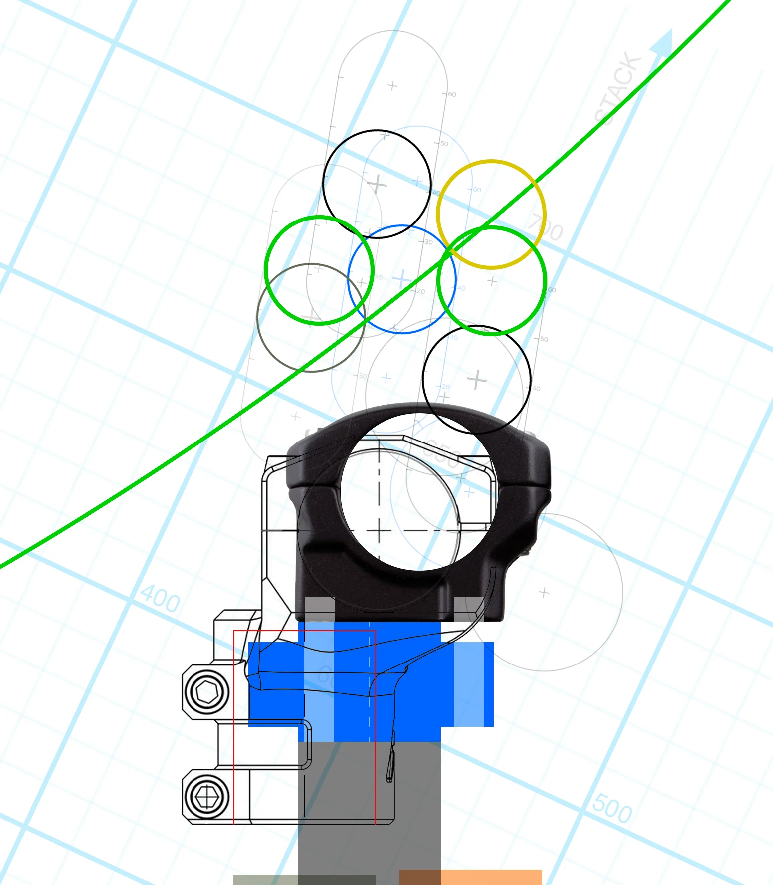

Not exactly, high rise bars don't shorten the stem, they shorten the reach. So if you reverse your stem and have -35mm reach, the high bars won't make that seem like -20mm, it will add to it, making the end result seem like -50mm. And 10mm rise is more like 2-3mm reduction in reach.
An 80mm rise bar on a reversed 35mm stem would put the bar ends approx 45mm behind the steerer tube, compared with 25mm in front of it the correct way round.

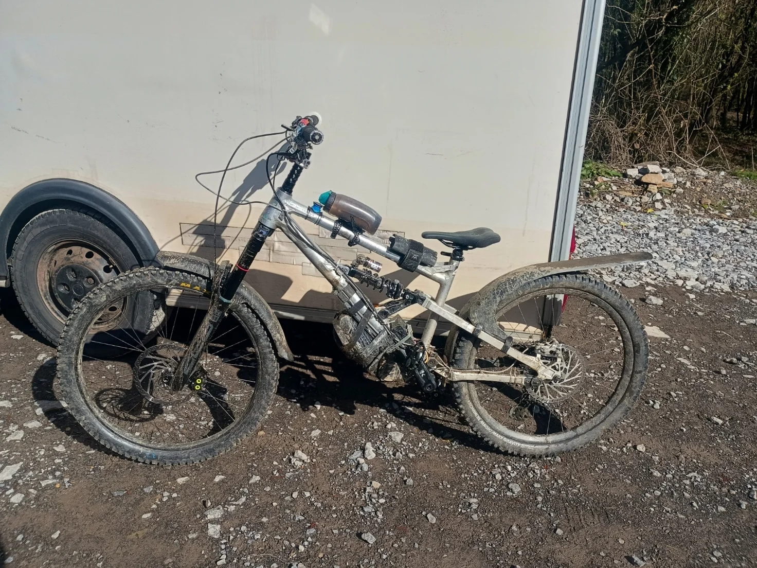

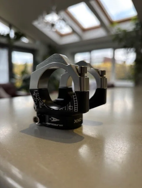

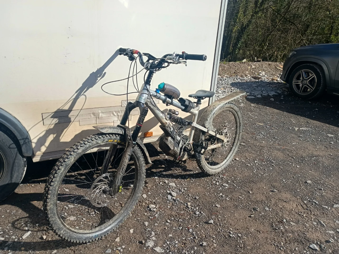

It feels more confident and reassuring, almost like a cheat code, lol. The corners feel sharper with less jack-knifing, which greatly boosts your confidence on steep sections.
I'm using the 35mm AEROZINE XNC-10 Stem, which comes with 4 spacers (5, 6, 10, and 20mm), a top cap & bolt, plus a star nut. I highly recommend it.
Yes, the stem spins, but not once you tighten the bolts.

I'm normally a function over form kind of guy, but that is quite an abortion :LOL:
And yet, somehow I still enjoy riding it - almost as if it doesn't really matter what the bike looks like.
