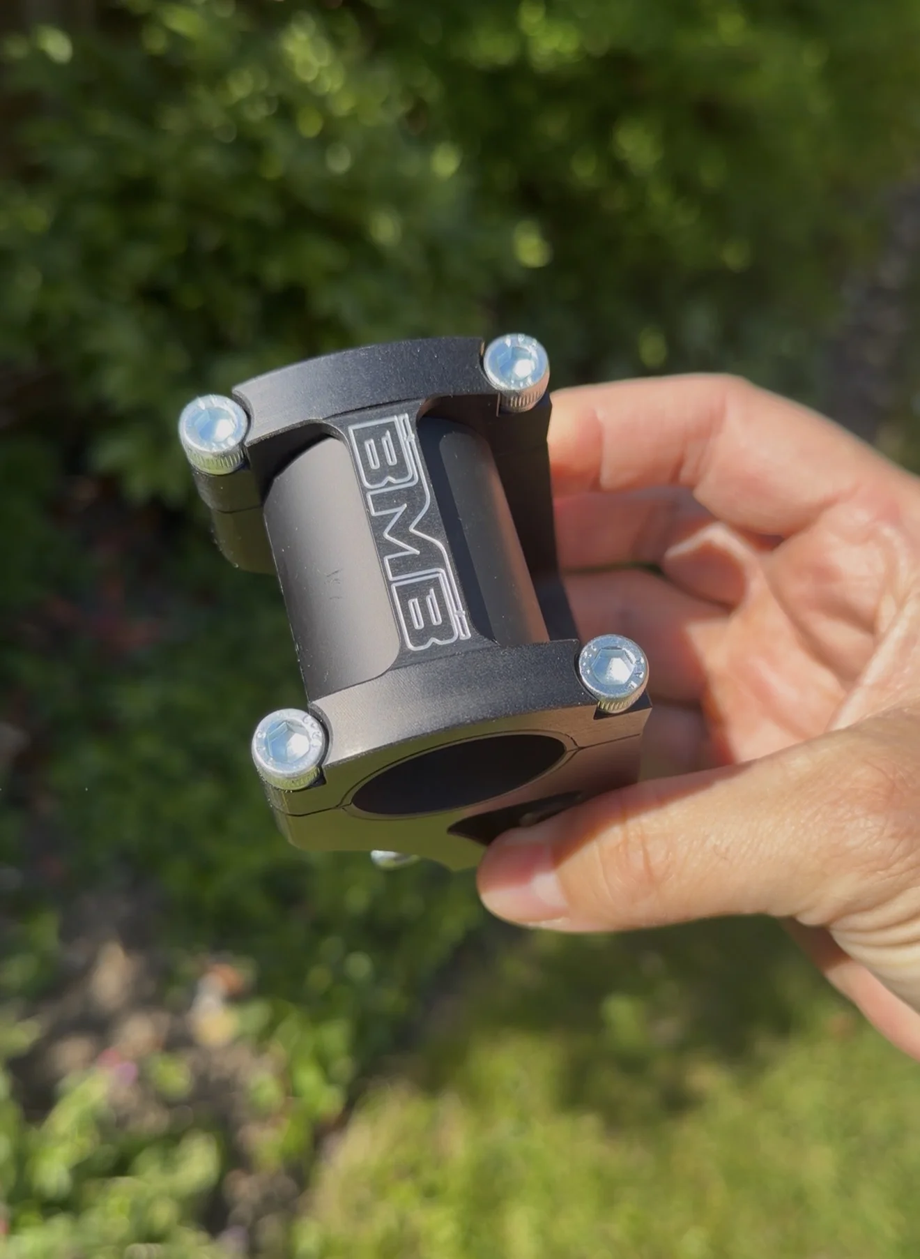

I just purchased the 90mm single crown version from @BeMoreBikes - looking forward to getting some time on it asap.
What I don't understand with this whole thing is, if you want your bars in that position then why not use a riser bar and a "normal" stem rather than this bizarre looking stem and a regular handlebar?

Because you cannot get the same position at all with what you’re suggesting. I’ve tried pretty much every combo of stem length and rise.

You can’t get the benefit from a traditional stem. This stem changes where your input into the bar is on the steering axis. It’s not just about rise. Even a normal stem with huge rise bar pushed back to the rider wouldn’t be the same because your input is still in front of the fork steer tube if that makes sense? Could put you in similar ride position, but wouldn’t be the same effect overall.

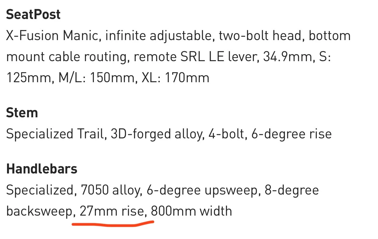

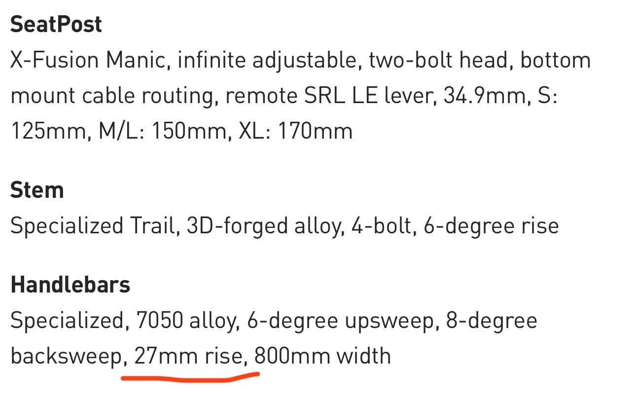

Noo, 35mm rise was not massive; that's been about the norm for over 10 years I'd say. I've been running bars taller than that for over 25 years!
I remember my 180/180 Kenevo came with 27mm rise bars. This was a long slack enduro sled back in the day!

its a REVERSED stem - a normal stem isnt reversed! This stem puts the bars into a reverse offset position, approx 15mm, that you cannot do with a standard 30-40mm stem.

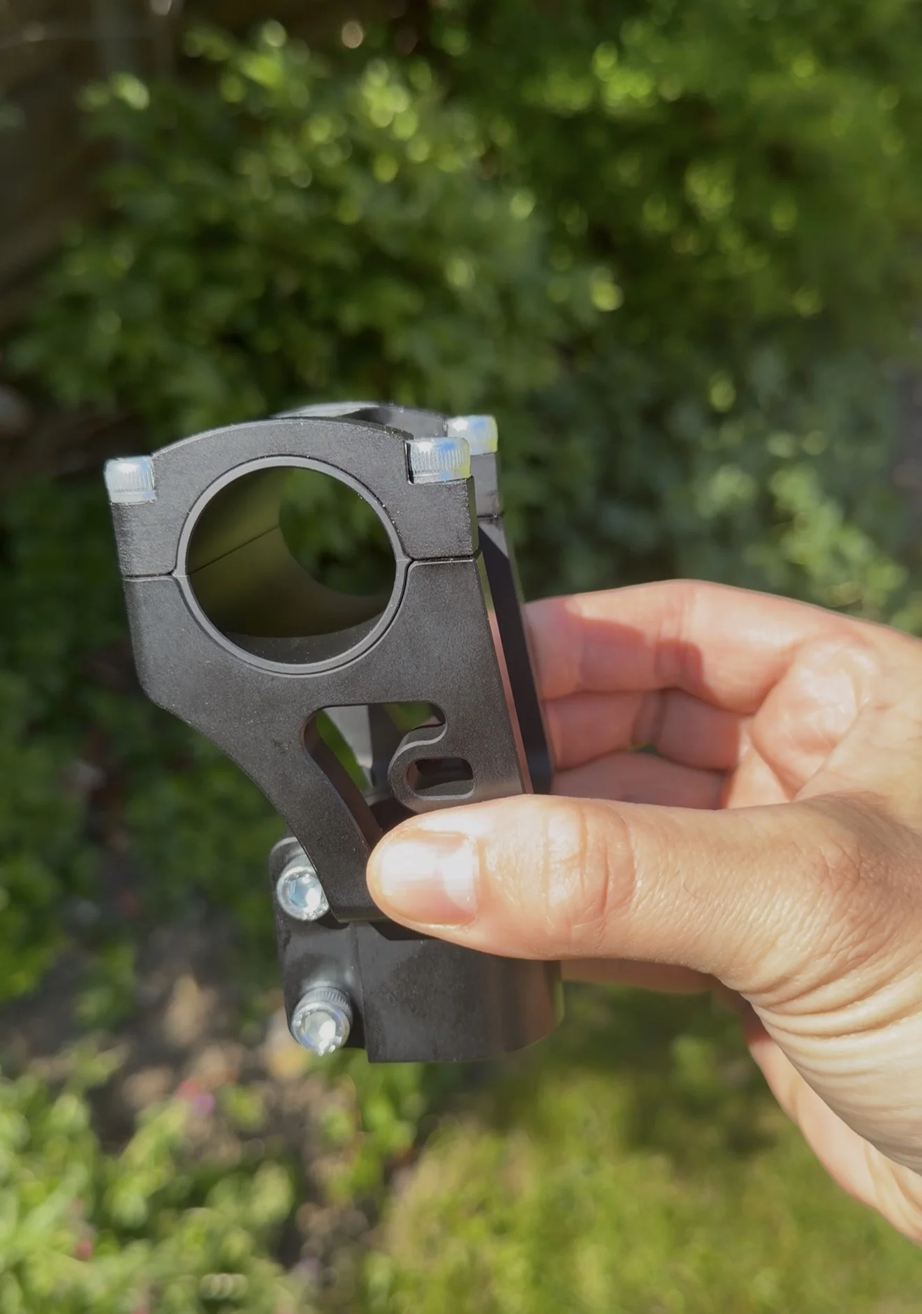

I think you can, if you start looking at what's available in the BMX world.... there is a whole world of bar designs out there in every height and dimensions imaginable.
For example, if you combine these Rixin bars (which have a 150mm rise) with a super-short stem like the S&M Reneck FLT (which has a 26mm reach, and can be run either way around) that would give you pretty much the exact same bar position as your 100mm BMore stem and 50mm rise MTB bars.
