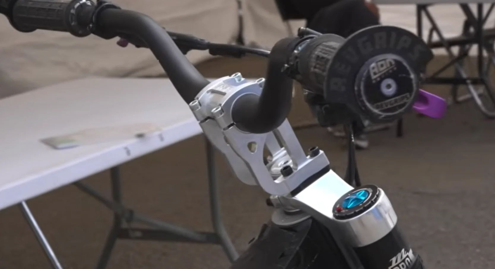

The RR (Raised Reversed) stem is not the same as a very tall bar. The RR stem is both Raised and Reversed. Due to this your hands will be notably behind the steering axis of your frame instead of in front as they traditionally are. A really tall bar or even a long steerer tube with a bunch of spacers or a stem riser would just be higher up without the Reversed offset, and as such will perform a lot differently. A really tall bar is also not ideal because it will move your hands quite significantly relative to the steering axis when adjusting bar role, and is more reliant on having a very strong hold at the bar clamp on the stem to keep the bar from slipping forward and back.
This is completely untrue.
The stem and bars combine to define the positional relationship between your hands and the steerer tube. How they do that between themselves makes no difference whatsoever (apart from maybe stiffness in extreme cases).
If you rolled a really tall riser bar back to achieve a similar geometry, you would need to roll it from its notably in front of the steering axis position back to about 40mm - 55mm behind the steering axis to achieve the same hand to steering axis relationship. This would give a substantial degree of downsweep to the bar instead of upsweep which greatly affects how you can load and interact with the bar dynamically. Most riders feel a little bit of upsweep works best for their bar roll, but individual preferences and wrist ergonomics dominate. This is why it’s best to get the geo largely from the stem and then use a lower bar that can be rolled forward or back to your preference without substantially moving your grip position forward or back.
But you can mount a stem 'wrong way round', shocking I know. :LOL:
Simply turning your existing stem around will not achieve the same offset as the tuned Reversed offset of the RR stem or achieve the Raised height. I tested anything from below traditional height to about 80mm taller than the taller Gen 1 150mm RR stem, and 70mm offset forward all the way to 70mm offset Reversed over the course of about 3 years across 9 different bikes with differing frame and wheel sizes and varying geos always benchmarking against a traditional 50mm - 35mm stem. The RR stems geometry is what gave the consistently fastest times and most control. The Reversed offset is the main feature to me, and works best in combination with the Raised height.
Can not exactly the same geometry be achieved by having a reversed short short stem on an uncut or extended steerer? And if not, exactly why not? No jargon please, KISS. Thanks.

A bar with enough backsweep to put your hands in a similar position to the RR stem of about 40mm - 55mm behind the steering axis would have such a large amount of backsweep, ie. about 22 degrees or more on a 35mm stem, that getting a good bend in the elbow in the attack position would be quite uncomfortable at the wrist for most riders. Along with that, the change in wrist angle affects how you can apply loads to the bar dynamically. As such, it would compromise the ride dynamics too much to fully take advantage of the Reversed offsets steering geometry. That bar would also need to have a minimum of about 80mm of rise to be a comparable height. Most bars that have very high levels of back sweep sweep forward before they sweep back among other shape adjustments to get the grips to not actually sit as much further back as their increased sweep angle would imply, and aren’t often offered in the widths we use for mtbs.
It can yes. In fact, this is a great link to a Reversed short short stem that can be run on an uncut or extended steerer. It even has a window for spacers put above or below the steerer tube clamp to fine tune height down to the mm and can be used with whatever bar you want in 35mm diameter or 31.8mm diameter with the included bar shims. 😏
Great super short stem that can be Reversed!
So the same can be achieved without the purchase of a custom $400 stem. (y)
So the same can be achieved without the purchase of a custom $400 stem. :cool:
Not really, as there aren’t any -15mm stems on the market, and the closest thing is explicitly advised by its manufacturer not to be run in reverse, has no height adjustment, only accepts 31.8mm bars, is lower even at max allowed height, and doesn’t even cost much less… The reason I made the RR stem was because there weren’t any otherwise commercially available ways to safely achieve the geo I found performed best. I started selling them because I figured that I’m not weird enough in my riding style or use case that it would only be beneficial for me. The overwhelming positive reception from customers I’d say shows that it works for a wide range of riders. 😊

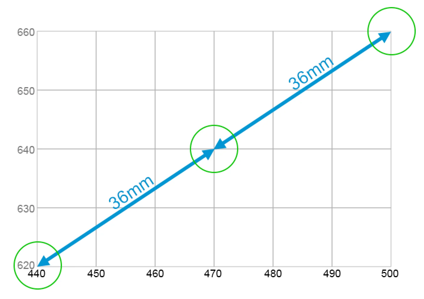

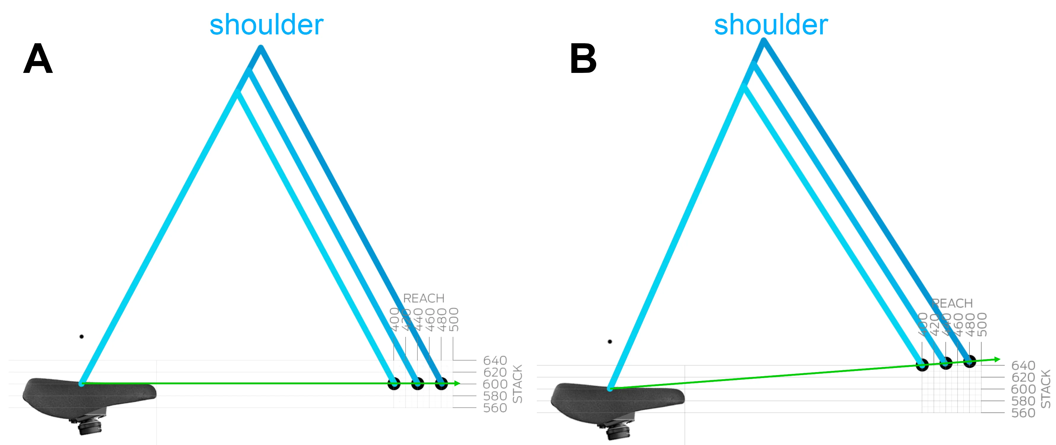

This is because the size a frame grows by is in actual fact, one distance, at an angle. It's just given as two distances for ease. But a frame size increase of 30mm reach and 20mm stack for example is actually just 36mm at 33°...
So it isn't simply "a bigger frame should increase in all directions", it depends on what direction the body grows by. Assuming a saddle (or hip joint) is at the same height as the handlebars, a taller rider wouldn't need a higher bar at all - if a rider's arm length increases with torso length. Taking that as a base, the stack wouldn't grow at all. (image A)
If the saddle/hip joint is lower than the handlebar, the frame size would increase at that angle (image B). In theory, a lower handlebar would actually require a lower stack height for a taller rider, unless you want the taller rider to be in a more upright position.
There's obviously a lot of variables - seat height (or leg length standing) riding stance, bar/stem combo. But the important thing is the direction in which the riders upper body triangle increases, and this is at an angle. Which angle? Debatable. But a single distance at an angle nonetheless.
This ignores that the taller rider would also run a higher seat height because people get taller from the waist down along with from the waist up. The taller riders taller seat height would need a taller bar just to maintain being level with the increased seat height. Even a short rider having a seat higher than their bars would still mean the bars for a taller rider on a proportionally taller seat version would have higher bars in an absolute sense that way it will maintain how much proportional saddle drop it has to the bars.
The angle to increase the size along on a 460mm reach and 630mm stack is 58 degrees at 780mm length. It’s along this 58 degree angle line that the stack and reach would increase proportionally. What you are showing is how two riders with the same inseam and seat height may have different cockpit preferences due to differences in arm and torso lengths.

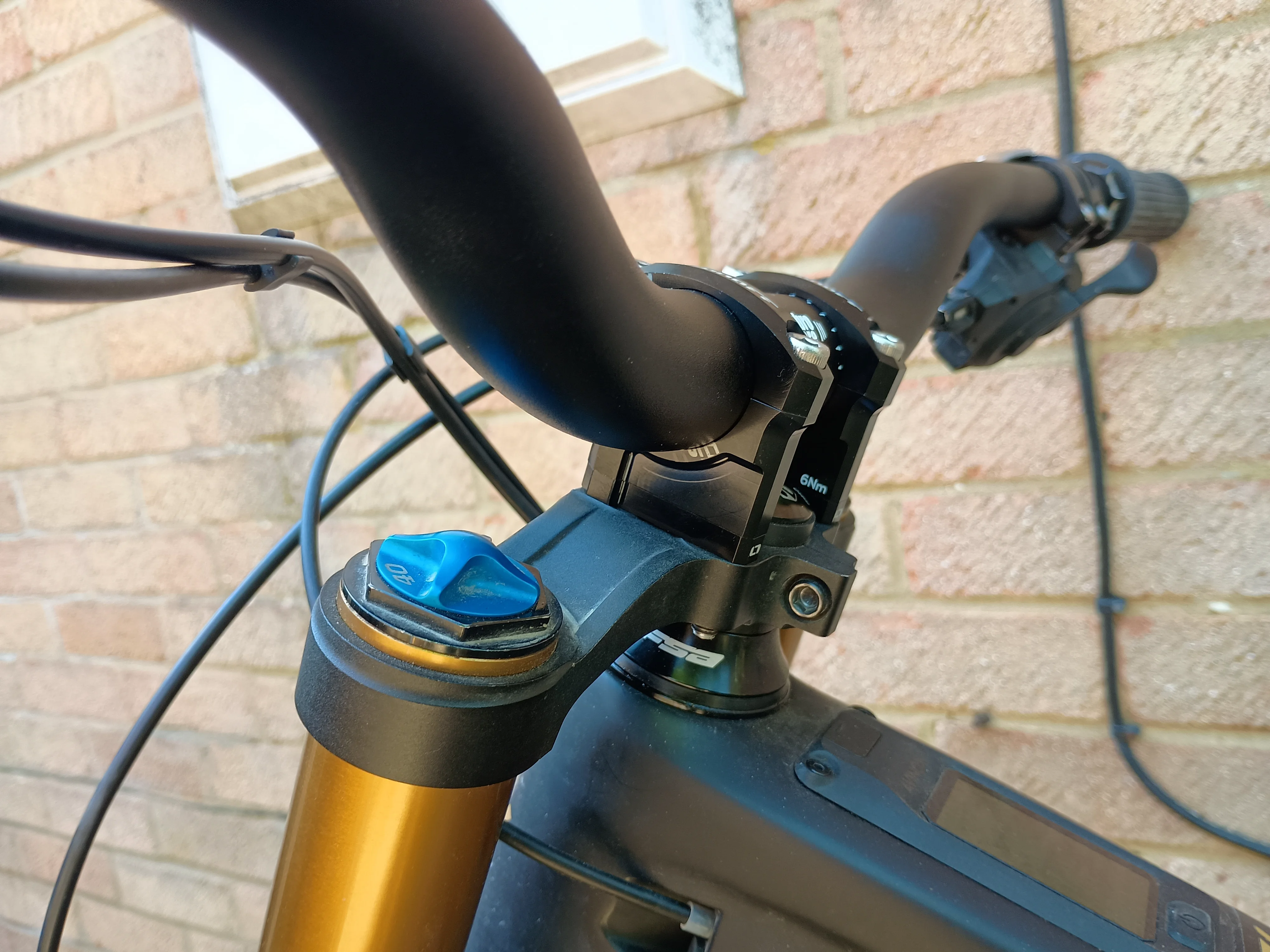

Fitted my onoff 10mm today. Thanks to @CJG for posting the deal a while back in this thread, came to less than £20!
Replaced a spank 40mm with this giving 16mm rise and 10mm length. With spank 50mm risers.
Feels decent, makes me think i could have gotten away with a medium frame 465mm reach rather than the large 485mm.
Hopefully it will help with my damaged back and give more confidence.
Ive been wary of front end grip since a serious washout crash a few years ago resulting in puncture lung, broken ribs and clavicle. So certainly don't want to lose any grip or feeling.
Haven't tried to reverse it yet, will try that once ive gotten some more ride time on this new bike.
