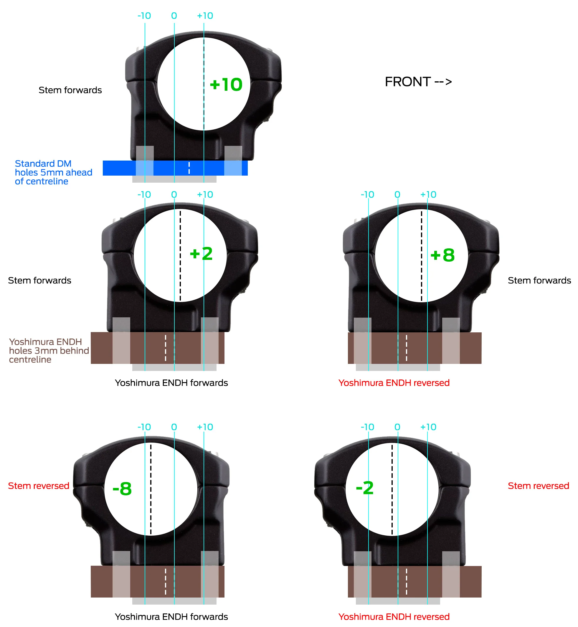

First proper test with the yoshimura adapter and 10mm stem. Was a lift access day so I tried all possible positions -10, 0 and +10.
At -10 it was quickly obvious that bumping up rear spring rate 25lbs wasn't enough to correct suspension. Front end was too stiff and lacking traction. Body position also felt a bit too upright and unstable on fast berm stacks. This setup felt much better on steeper natural tracks, no surprise really.
Next was the 0 offset setup and this already felt better on the berm tracks, but front end was clearly still too stiff.
Then wen't to +10 and it felt the best with more weight on the fork. Most confident on the faster tracks. I like this setup more than my old setup with 40mm stem.
I need to put a softer spring in the fork and try the 0 and +10mm setups again. I think the -10mm is too much for now.

View attachment 187671View attachment 187672
The Yoshimura DM adaptor is slightly different offset to standard DM, so it'll be more like +8mm or +12mm, depending on which way you run everything.
Oh, thats good to know. I must have tested +-12mm and something in between then. Standard DM offset is 5mm?
Looking at my schematics from when I was doing my own research, normal DM has the holes -10mm and +20mm of centreline, so that's -5mm offset.
Yoshimura is -18mm and +12mm, so that's 8mm further back, -13mm offset.
Onoff 10mm stem on a normal DM mount will be 10mm, reversing the stem only makes it 0mm.
Onoff 10mm stem on Yoshimura ENDH will be 2mm, reversing the stem only will make it -8mm.
If you flip the Yoshimura mount around, you can get your Onoff stem to be +8mm.
Thanks, that makes sense. That means I've actually tested -8mm, +2mm and +8mm positions.

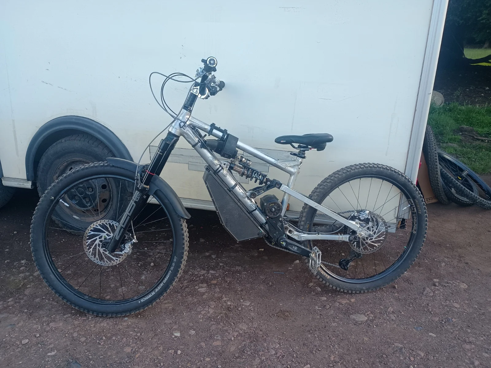

That HA might be the main issue. Single-crown forks tend to start bind up with a head angle much slacker than 63°. The fork starts to bend rather than engage its travel. The bike then wants to stay too slack in corners and pushes wide. Someone called it the "wheelbarrow effect": the front end flops from side to side instead of steering.
A low BB feels good when cornering, but it has a tendency to actually stand the bike up when you lean into corners, meaning you have to work more with your arms. A higher BB would let the bike tip into corners more naturally and actually make lifting the front end easier.
My suggestion would be to get the HA closer to 63°, the BB height between 340-350mm, and the chainstay between 450-460mm.
Are you running the bike in the 175mm travel mode? You could try the shorter travel option to reduce the leverage ratio on the shock so the bike isn't so eager to sit deep in its rear travel.
A 780mm bar is probably as wide as you want to go. I think having more arm travel is better with these longer-reach bikes. I'm running 775mm bar at 185cm tall, and my bar ends measure 115cm from the floor.
OK cheers. I sometimes struggle to predict how various combinations of geo adjustments will affect handling, and to diagnose the source of a problem. I dropped the fork down to 170mm today at the first 50h service interval, so I'll see how that rides first, then try raising the BB again (which will further steepen the head angle). I'm a bit reluctant to extend the chainstays at the moment because I've got a heavy battery holding the front down, but it might be okay on non-jump trails. I did prefer the 162 travel mode when I had a light motor and battery, or as an analogue bike, but found it too harsh on tech when the spring/damping is high enough to resist bottoming out. It might be worth doing on jump days though. Also, I've just had the EXT shock retuned to give more HSC and rebound damping so hopefully I'll have all the support I need. Ideally I'll be able to drop down to a 700lb spring (28-29% sag) as 750 (26-27%) isn't much fun on the chatter.
