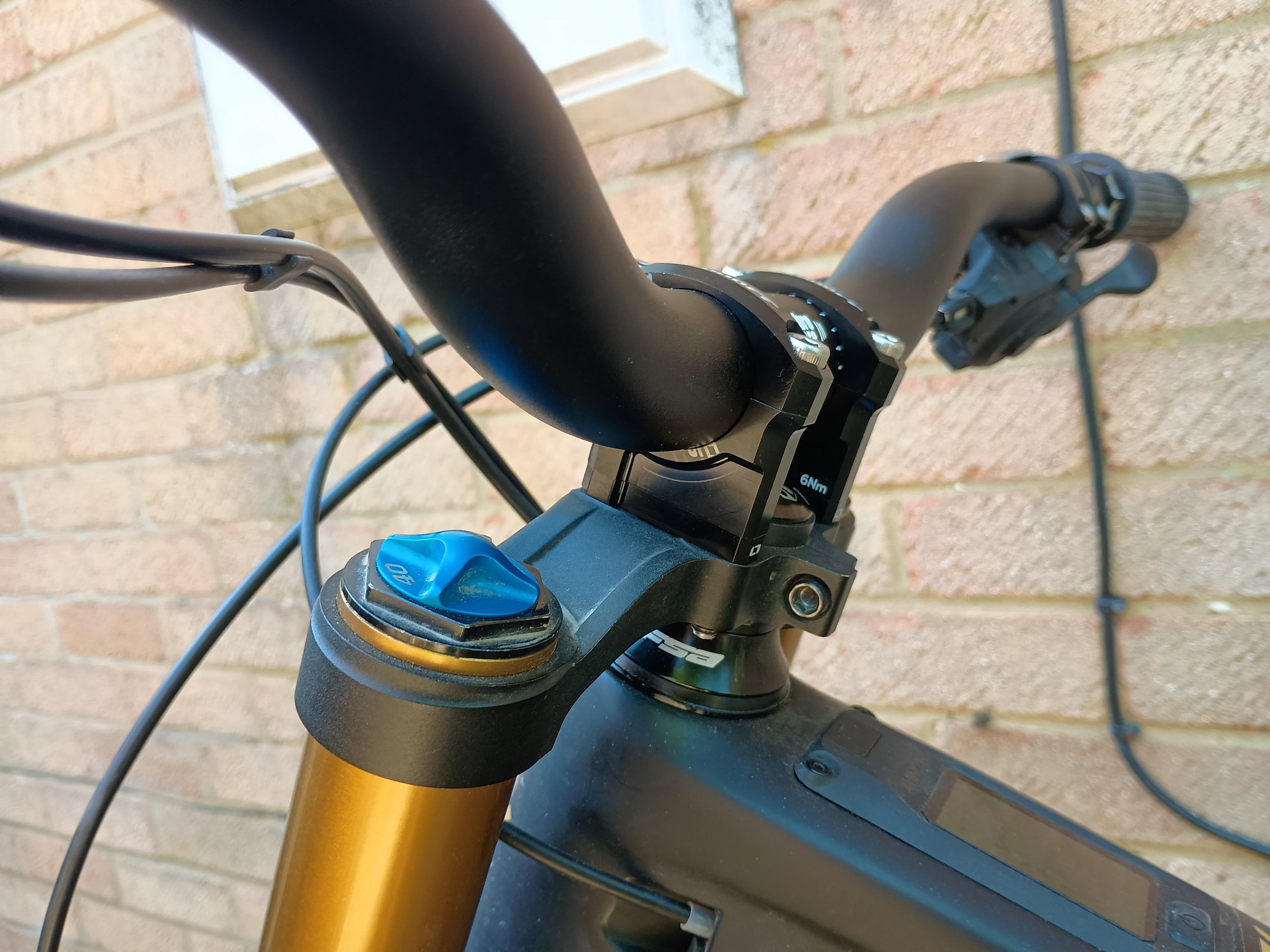

Fitted my onoff 10mm today. Thanks to @CJG for posting the deal a while back in this thread, came to less than £20!
Replaced a spank 40mm with this giving 16mm rise and 10mm length. With spank 50mm risers.
Feels decent, makes me think i could have gotten away with a medium frame 465mm reach rather than the large 485mm.
Hopefully it will help with my damaged back and give more confidence.
Ive been wary of front end grip since a serious washout crash a few years ago resulting in puncture lung, broken ribs and clavicle. So certainly don't want to lose any grip or feeling.
Haven't tried to reverse it yet, will try that once ive gotten some more ride time on this new bike.
I run this stem too for DH, really like it. If you reverse it, it will be 0mm, not -10mm by the way (direct mount bolts are 5mm ahead of 0)

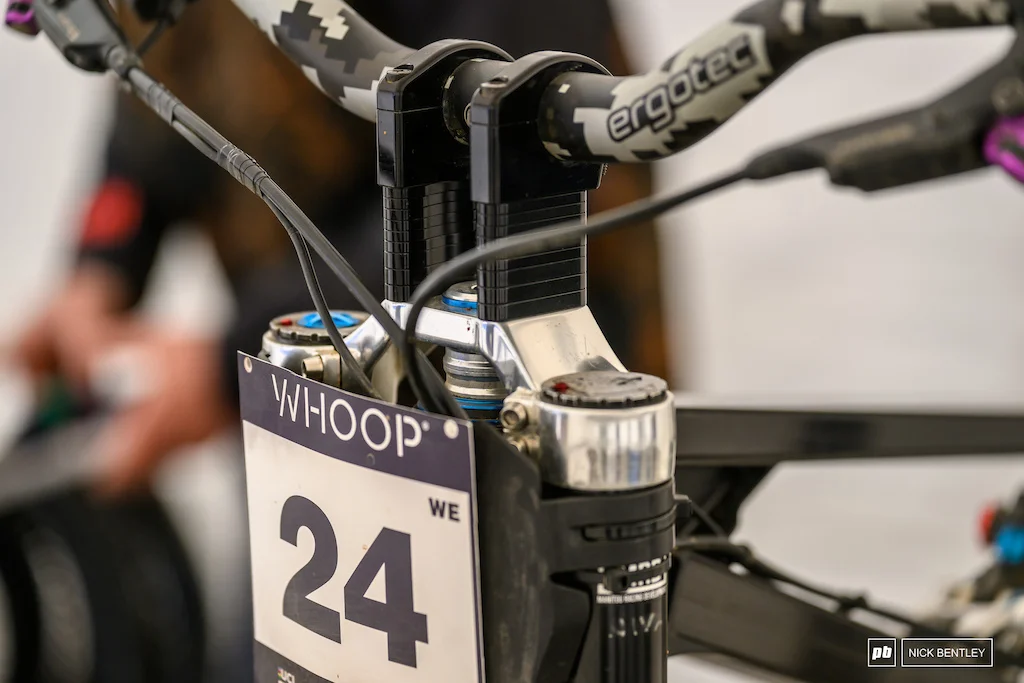

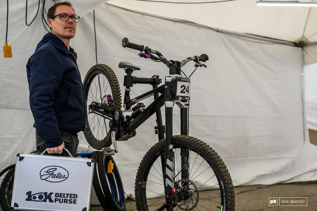

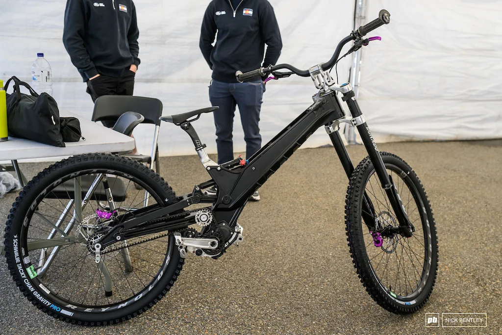

Hattie qualified fastest at the World Cup today with this setup.
Stem backwards with max spacers. Not sure why she isn't running the BMB stem like Reece Wilson is as they are both on AON, (assume its becasue she didnt want the full 150mm rise at her height) but @Bronson—I'd be getting her a version as I think she will have a few podiums this year! Reece came in 16th—pretty good.
View attachment 183531View attachment 183517
Looks like it doesn't have as much offset, perhaps?
So both Reece, Stan and Hattie qualify for World Cup DH finals, Hattie in P1 qualifying first position with fastest time.
Something about that stem setup eh?!
Well there's still questions.
Is it the stem setup ? Or is it the Gamux ? Or is it HAttie, Reece and Stan.
That's a tricky one as Stan for example was one of the (or maybe THE) fastest UK Junior anyway.
In 24 Stan was untouchable.
Hattie is Hattie, multiple championships, titles and god knows how many wins.
Reece is an ex-world champ and factory rider for Trek... so a top 20 isn't ridiculous either way.
But there's no doubt they've all done amazingly recently and look fast. But the stem may not be the only factor (could be the deciding factor though maybe ?)

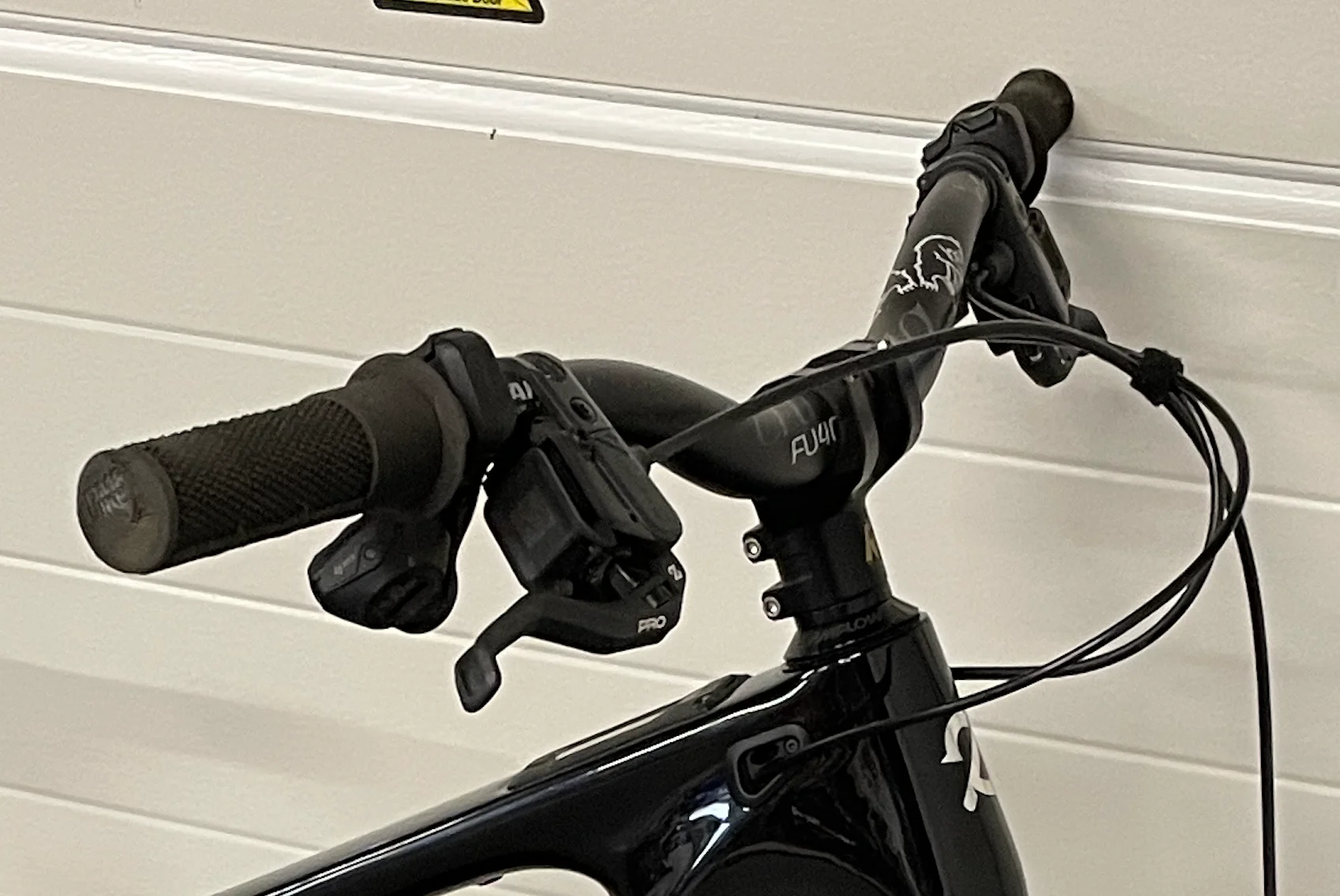

I went on a ride today and at the halfway point flipped the RR stem around. Felt a lot better with my setup. I think that the 12deg bars were bringing my hands too far back with it in the normal orientation. My hands are still well behind the steering axis.
The issue I was running into is when I tried to hip hinge and put my weight through the pedals either I felt like I was kinda over the bar in a way which felt unsafe since I couldn't catch myself if my weight was flung forward, or I had my weight back and was hanging off the bars. I'm starting to get a feel for what I like with all this experimenting so that has been helpful.
Try rolling those levers up some. They’re very low. That’ll help put you in a better position for dh and staying lower/countering when braking will keep you from flinging forward.

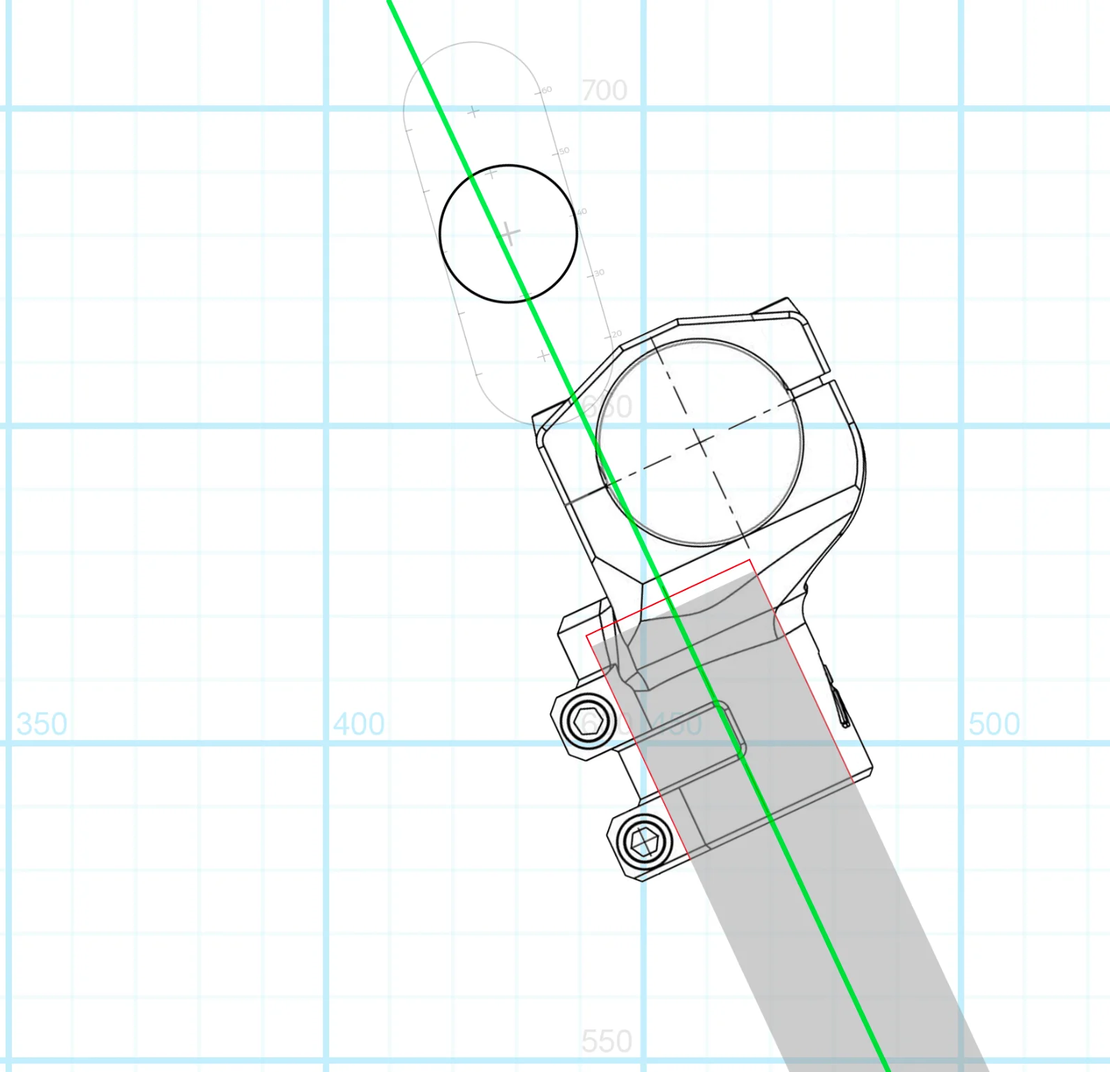

I run a Rulezman 15mm stem, and with 30mm rise bars it puts my grips directly inline with the steerer, and 60mm bars about 5mm in front of it (at the roll I prefer). I measure all my bars' rise where my thumb lies on the grip, as these numbers are usually much higher than the bar's official rise measurement due to up sweep, and inconsistencies in how manufacturers do their own measurements.
There's a lot of comments on here, not too much describing the actual ride feel, so what are you feeling?
What I'm looking for is a setup which puts you most comfortable/confident position possible, then the bike holds that shape.
My most common type of crash is front wheel tucking, on flat terrain I can normally wrestle it back, on steep I'm normally over the bars.
Gone into a black hole of fork setup (going firmer and firmer) and bar height (going higher and higher).
But I don't think this fundamentally solves the tucking issue which comes from steering geometry, ie as the fork compresses, mechanical trail is reduced, if this happens quickly, momentum will carry it into a full tuck, with traditional stem geometry, your arms are at a mechanical disadvantage to fight it.
When I picture front wheel tucking with a setup with an RR stem, I believe you're better placed to deal with the wheel tucking torque, does it feel this way? Have you experienced less wheel tucks?

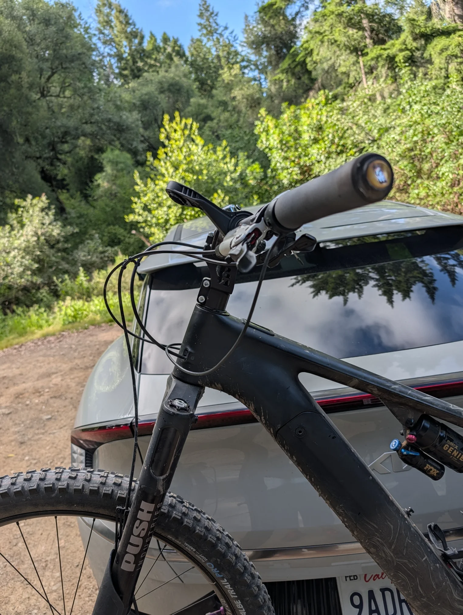

I've run a 35mm stem backwards with 70mm rise bars for couple of weeks and have to say I prefer it. Afterwards went back to a traditional setup and it feels like garbage in comparison.
No tucking feeling with the reverse offset and I feel like I can better load and unload the front end. I'm not overly committed to the front end like on a normal setup.

Yeah, but it was the easiest way to try out the concept. Now I have a yoshimura stem base kit and a 10mm direct mount stem on order to play more with.

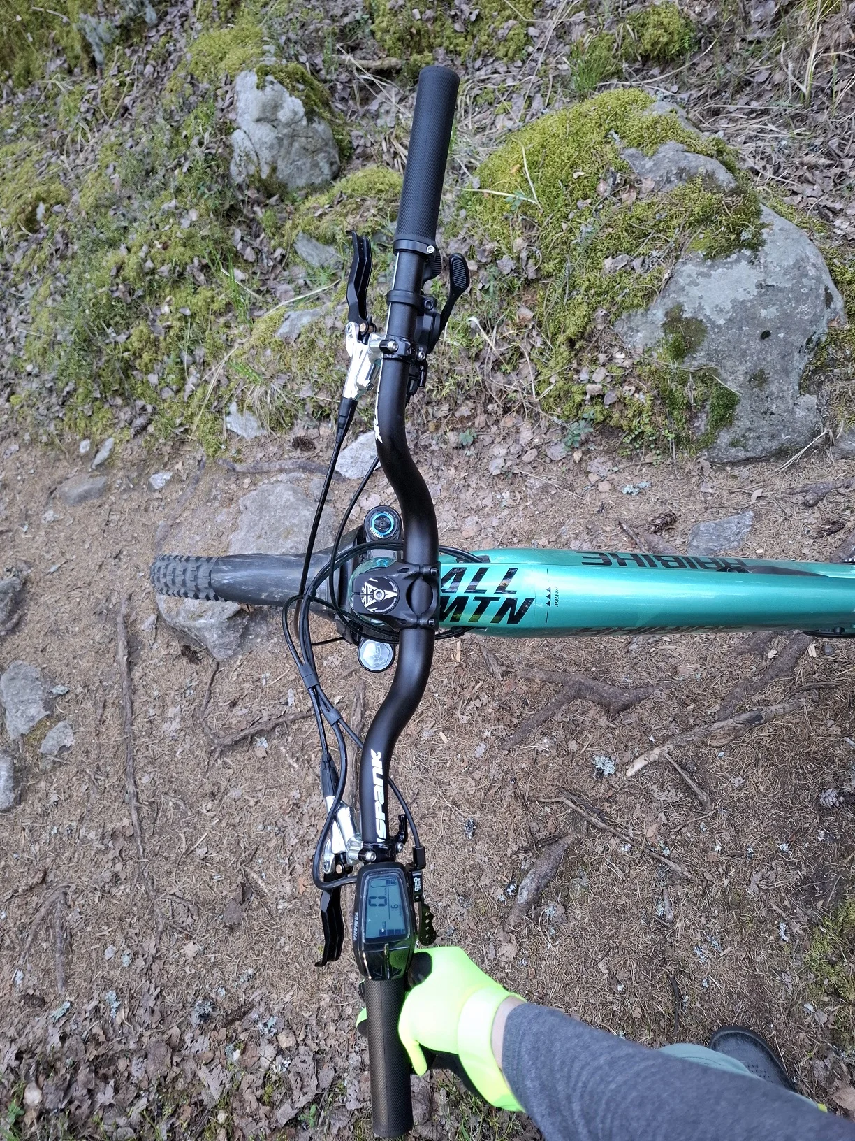

I went back to a regular 35mm forward stem because I was getting too much tucking with 15mm reversed, and it felt twitchy/unstable, especially in ruts or on skinnies, where precise placement of the front wheel is important. (I ended up having a fairly spectacular OTB after tucking the front at the entrance to a steep section, but that was partly caused by a pedal strike.) But I think that's more to do with the stem being shorter, leading to twitchier steering, because putting the 15mm in the forward position felt much more similar to 15mm reversed than 35mm forward. I haven't tried 35mm reversed yet. So be aware that getting a 10-15mm reversed stem might negate the benefits you're experiencing from high bars and/or reversed stems.
Yes, the feeling is that you are further away from the front wheel. Depends on the situation if that is good or bad.
On my photo with reversed 35mm stem, I have the bars rolled quite far forward. Distance from BB to grips is nearly the same as with my normal setup. With -10mm stem I'll roll the bars further back for more comfortable wrist position.
Funnily, I like a 40mm stem with the traditional setup. Steering feels worst to me when centre of grips are directly inline with the steerer. Hands either forward or back from steerer feels more stable. I think this random moto guy explains it well here:
