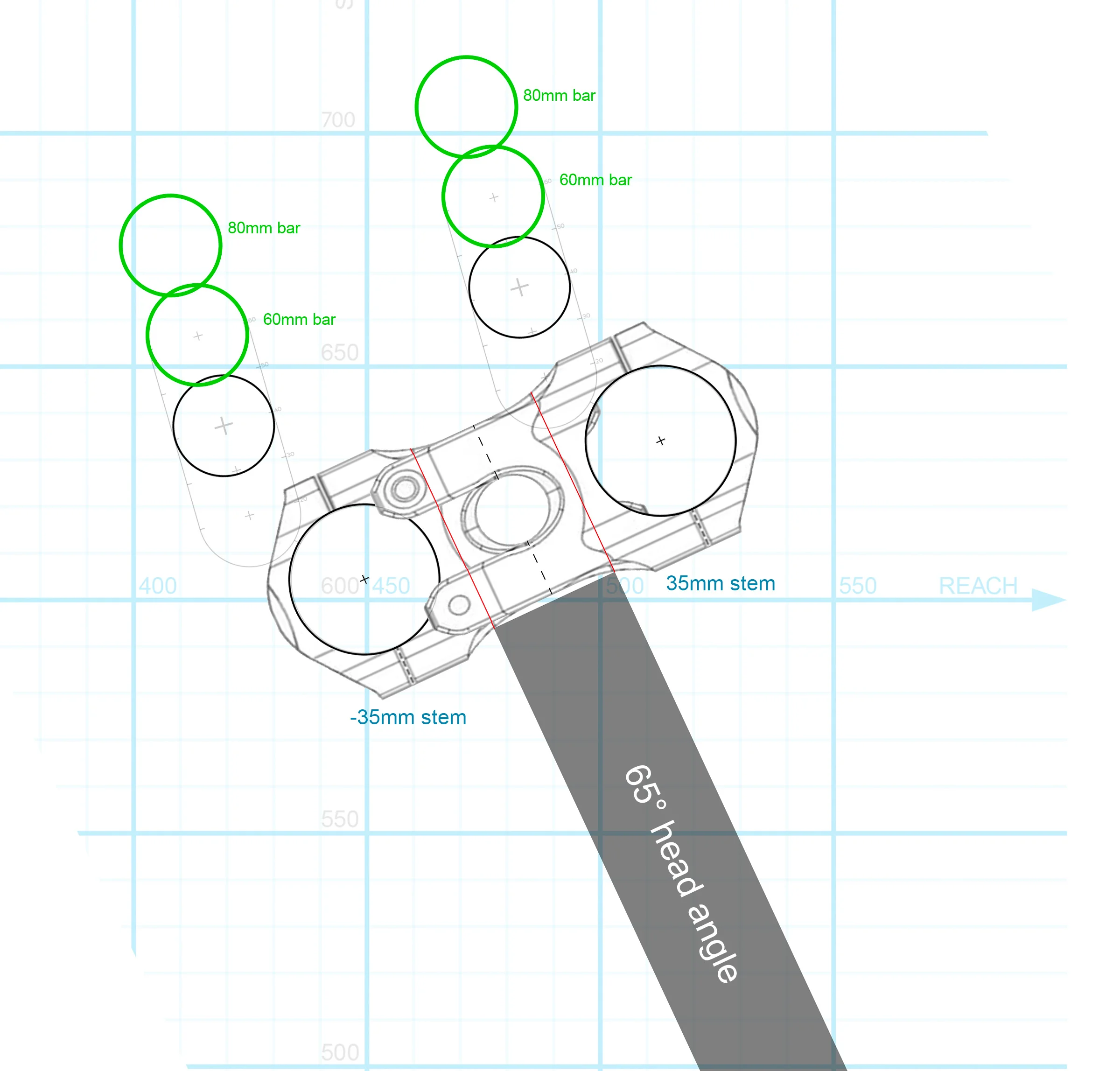

Not exactly, high rise bars don't shorten the stem, they shorten the reach. So if you reverse your stem and have -35mm reach, the high bars won't make that seem like -20mm, it will add to it, making the end result seem like -50mm. And 10mm rise is more like 2-3mm reduction in reach.
An 80mm rise bar on a reversed 35mm stem would put the bar ends approx 45mm behind the steerer tube, compared with 25mm in front of it the correct way round.

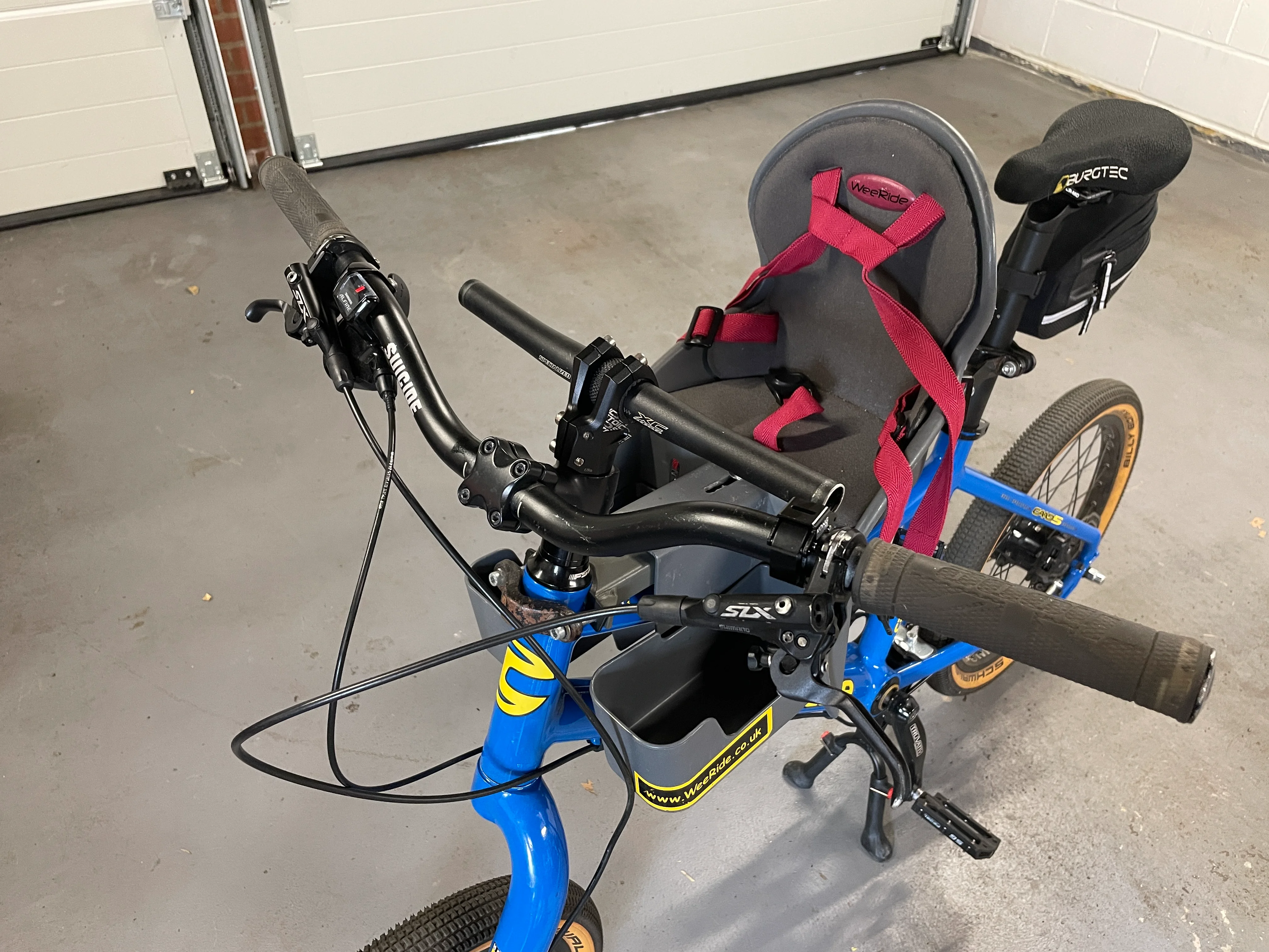

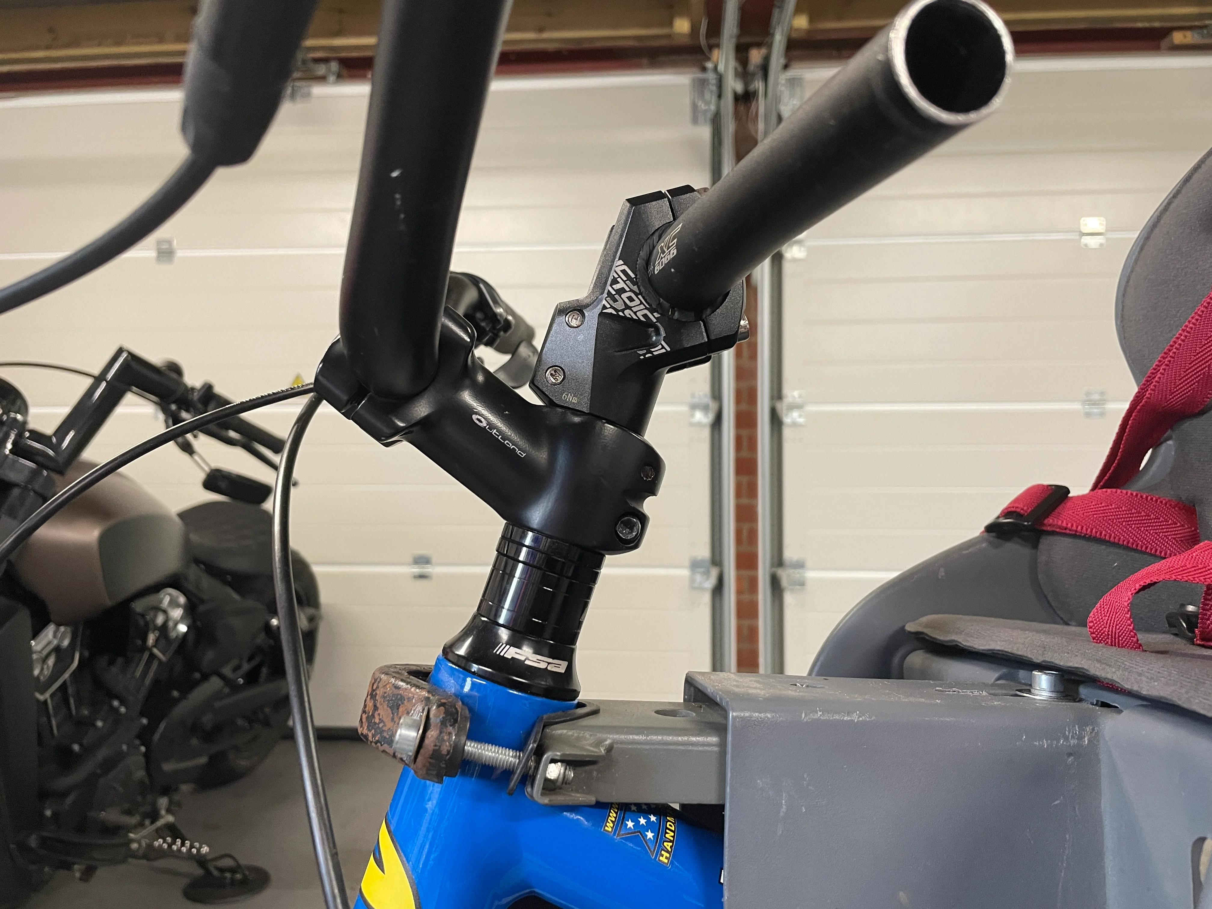

My riser bar has a vertical rise of 70mm on a -50mm stem on 63deg headtube angle.
Center of grips is -40..-50mm behind center of steerer tube.

You have your bars unusually rolled forwards then. The point of the short 15-18mm stems is that bars are usually angled rearwards slightly, putting the grip 15-18mm behind the clamp, inline with the steerer.
With your bars like this, when you had a normal forward facing 50mm stem, your grips would have been at ~55mm, whereas most other people's grips would have been at ~35mm.

Bars have printed on indicator marks of rotation, with 0 deg aligned with horizontal on my bike, if anythig 0-deg-mark is pointing a few deg upwards from horizontal.
The angle you have on the bars in your printout, where does it origine from ?

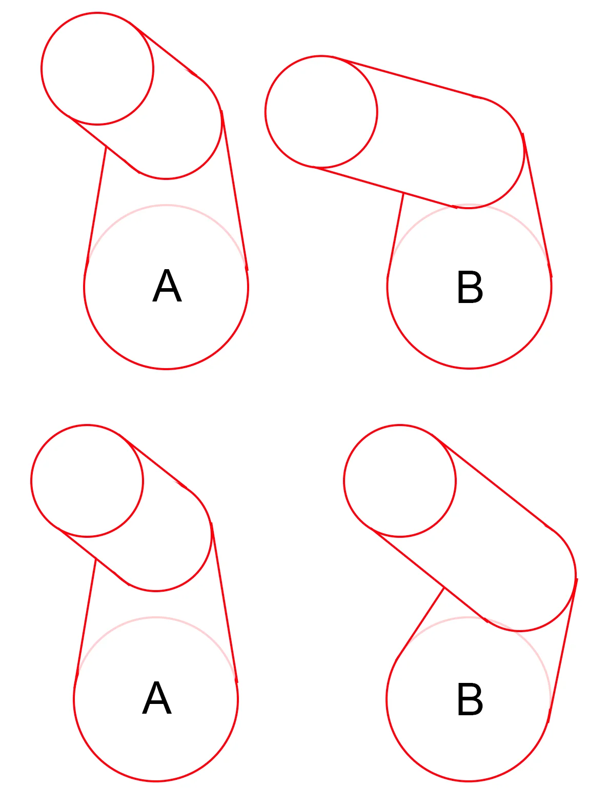

The 0 mark on bars isn't the 'correct' setting, it's simply the angle bars have their rise measured from. But more importantly, they can't be used to compare two different bars, as the sweep on bars isn't just 2 dimensional, it's 3D, so the angle that the bars 'go up' from the clamp doesn't necessarily have any relevance to the final angle of the grips.
This image shows two bars (A: 45mm rise, little backsweep, more upsweep, B: 35mm rise, more backsweep, little upsweep) (top) but both bars can be positioned so the grips are at exactly the same position with the same angle and rise (bottom), but the angle at the clamp is completely different. So the point I'm trying to make is that I only pay attention to the end position of the grip, and I would never pay any attention to the angle marks, unless you're simply trying to get bars back to the same position when taking your bars/stem off. And with that in mind, most grips are 10-20mm behind the bar clamp.
I got my angles from looking at all mine and my friends bikes, and various images of bikes online, and coupled with people like Rulezman who said they made their 15mm & 18mm stems to put the grips inline with the steerer, these numbers check out.

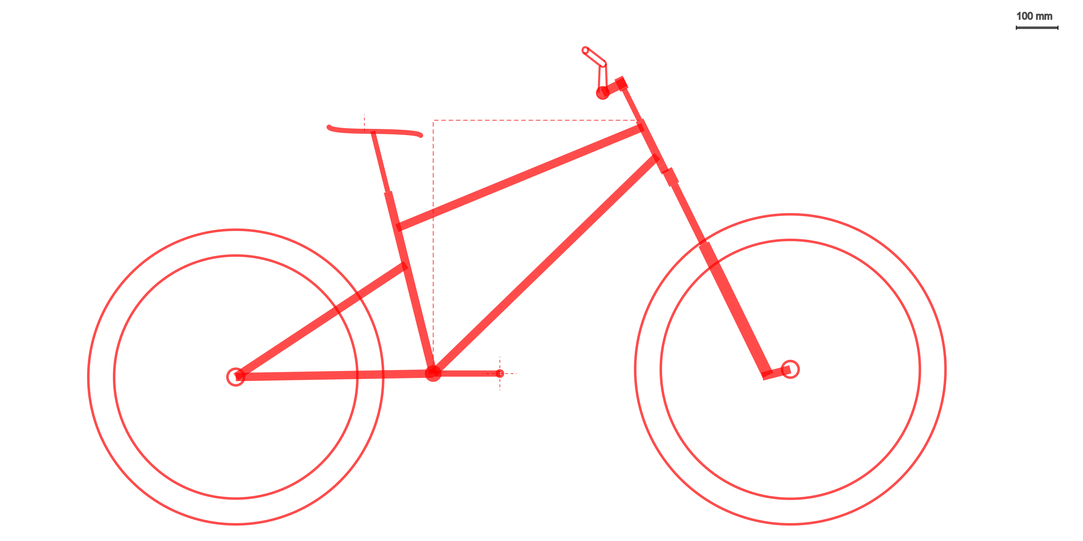

but shouldn't the f/r ratio be between front-center (bb to front hub) and rear-center (bb to rear hub)? and not reach-chainstay?

reach impacts the wheelbase length from the BB (with the fork angle, offset & stack).
If this indeed is this Wild, your ratio can be calculated as weel from the RTF value in the above page, i.e 64.22%/35.78% = 1.794.
A L one is 65.05%/34.95%=1.861. The chainstays don't move between the two sizes so a longer reach then gives a higher ratio.
ok, well thank you again. Wait where is this coming from? What happened to reach? What?
Reach has an effect on body position.
It does not alter the f/r ratio of the bike.
Longer reach is used to compensate for a higher f/r ratio. The ibis hd6 is a pretty good example of this.

Not sure, it's pretty much common knowledge like 2+2=4.
It's simply the foundational metric upon which to apply things like stack/reach/kinematics to get an idea for how a bike will perform.
Typically a bike with a ratio closer to 1.9 will have a more forward rider position, low and stretched out. A bike closer to 1.8 tends to have a more upright centralized riding position. That's painting in broad strokes though, there are always outliers.
Personally, I've found that bikes closer to 1.8 with a wheelbase around 1280-1290mm are my happy spot, but available terrain dictates desires for most people.
I understand the ratio, but I don't think it affects the riders position, only the front centre does; the chainstay (which forms part of the equation) doesn't affect your stance, it affects handling. Two bikes with identical front-centre lengths, reach, which have the same stance, but can have different F/R ratios.
formula for determining whether you can run a reverse, high-rise stem is common knowledge like 2+2? Lol. Ok. Thanks. That immediately tells me the efficacy of this formula.
That's correct.
But reach is a number that isn't just an anatomical fit type of thing.
Reach is specifically used to shift the rider's mass upon the bike.
You will see a shorter reach and higher stack on bikes with more balanced f/r ratios. You will see a longer reach and shorter stack on bikes with a higher ratio.
F/r ratio is the foundation that all the other geo numbers are built upon.
The reason there is a trend towards lower ratios, shorter reach, and more stack is that it allows for a bike that doesn't require as much shifting of body weight fore and aft. It's exactly the effect many enduro racers were after by sizing down on bikes, but without sacrificing high speed stability.
A bike configured thusly can also run a longer wheelbase for high speed stability without feeling clumsy in tighter corners.
I think only you can decide that, with Bronson's help perhaps.
I'd assume a bike with a ratio that's closer to 1.8 and is slightly oversized for you would be optimal for the rrs, but I don't believe there's a formula as such to make that decision for you.

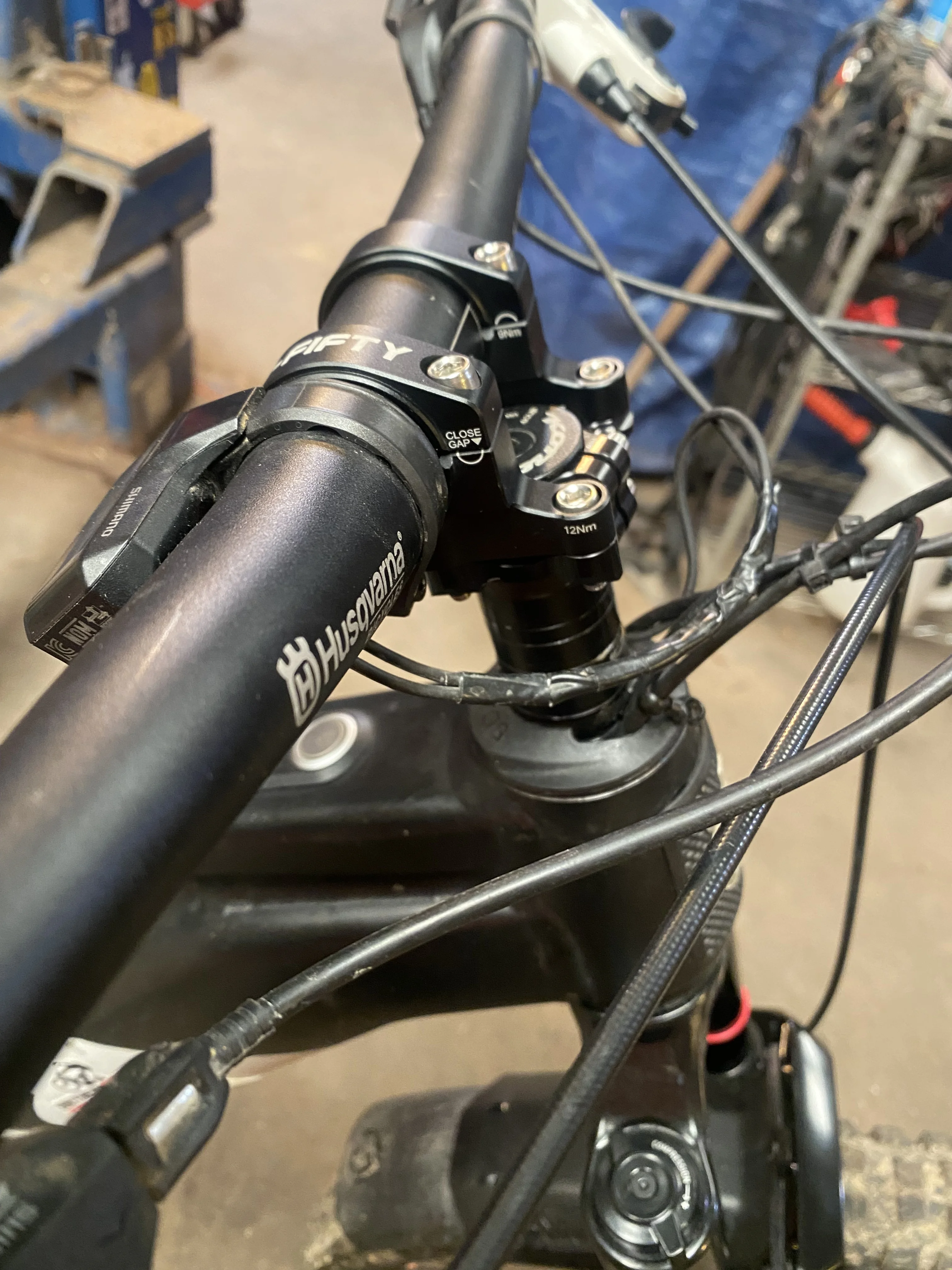

Yoshimura ENDH adaptor and FiftyFifty 30 mm stem.
Reversed stem is giving me about 22mm offset to the rear.
Unable to test right now due to persistent back issue.
If good I will make risers for the direct mount stem and lower the ENDH on the CSU for a better appearance , When I make the spacers I can add in additional mounting positions to tune the for-aft location.
