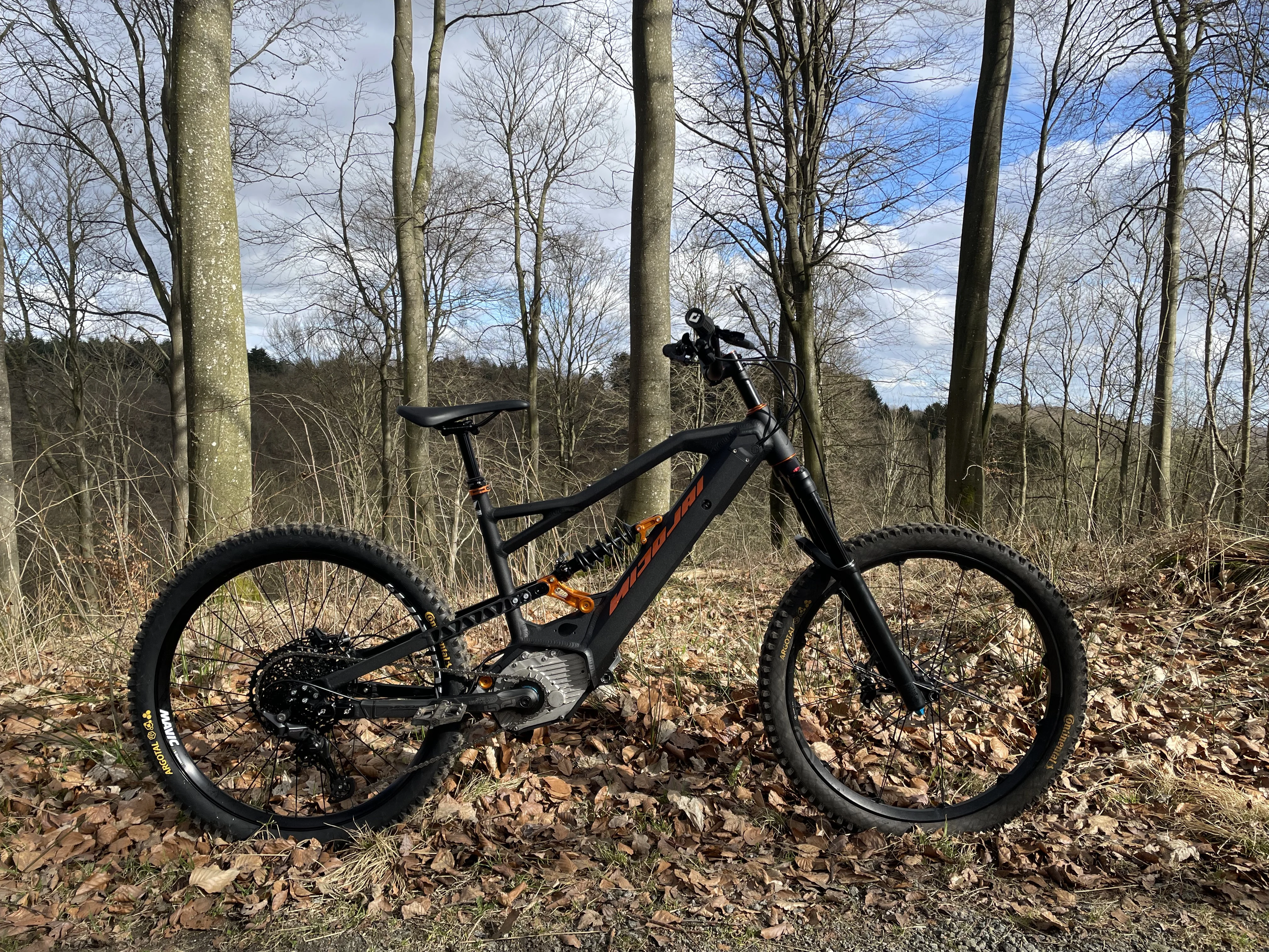

467 CS / 502 Reach / 173cm / RAD 836 at 63,4deg
23cm steeret tube,
-50 stem
+70 rise
Grips 30-40mm behind center

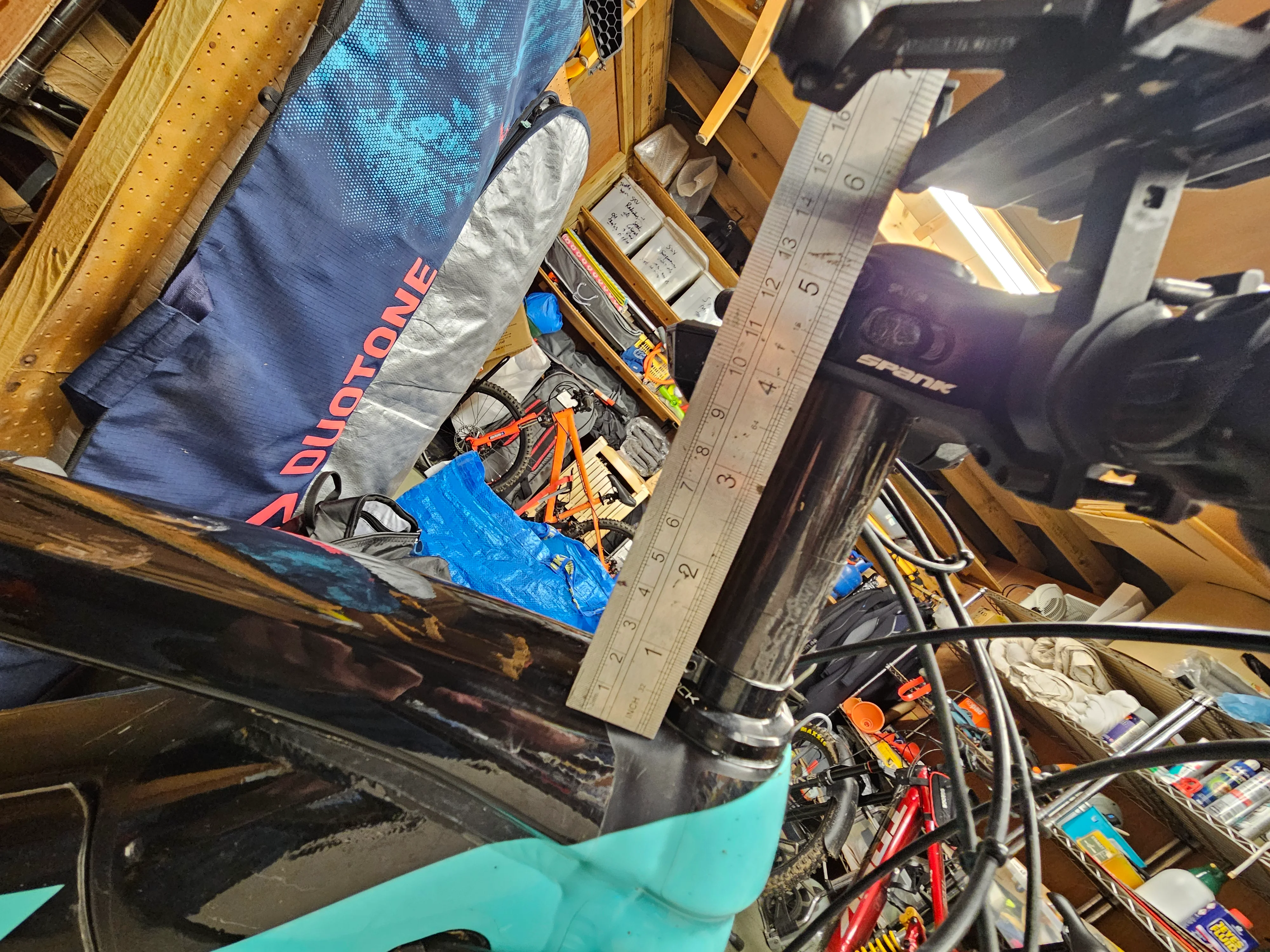

steerer looking at picture.
Interesting.

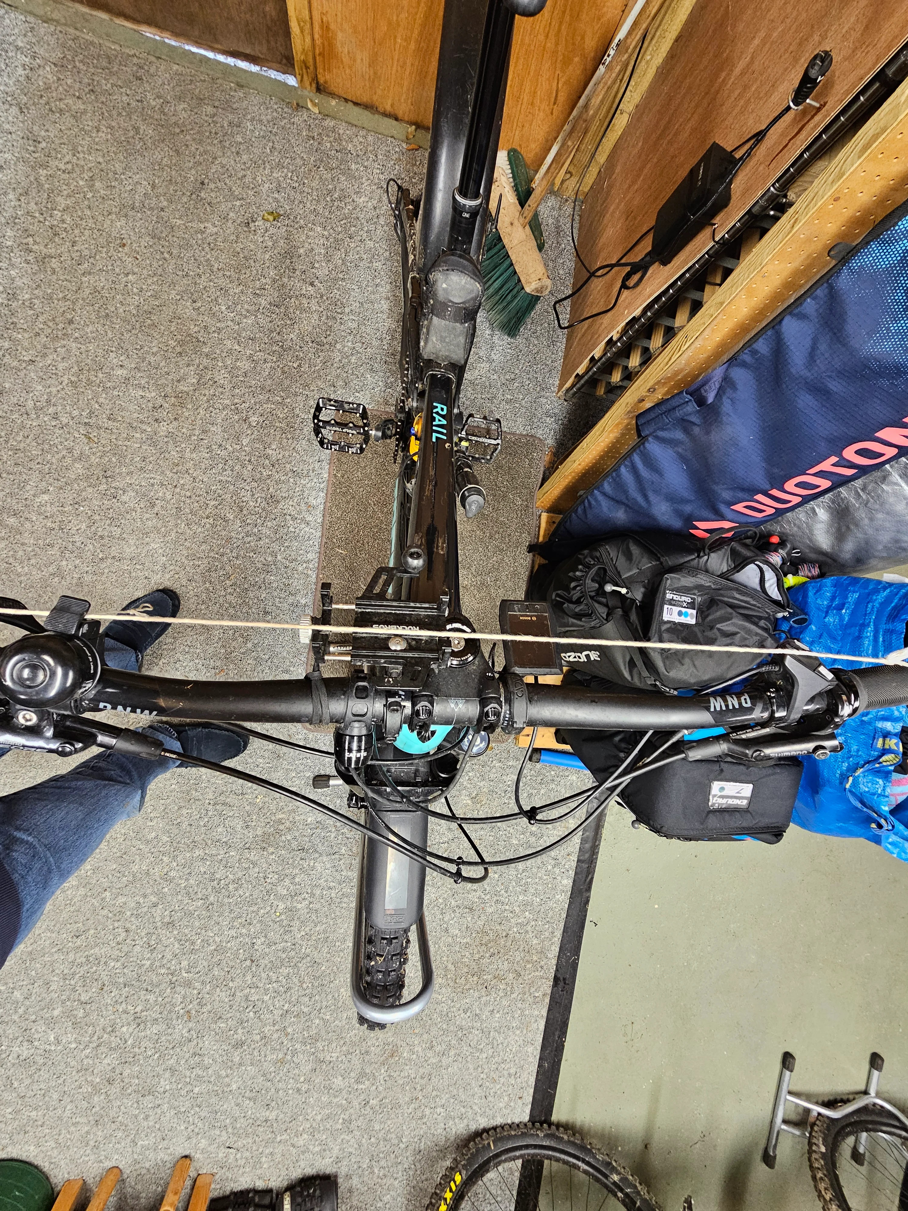

Just looked at my bike (2022 alloy Rail) with Lyrik D1 (44mm offset) uncut steerer tube (about 140mm?) and PNW Loam Carbon bars (cut to 780mm) which have 10 degree backsweep and the centre of grips are a few mm behind the steerer centre. Stem is Spank Split 38mm.

Well, don't want to spend 8k on a test mule, use what I have and buy the cheapest parts needed to get the geometry right and get going :cool: 850Euro used so far.
But it is quiet :sick: to look down at a -50 stem :ROFLMAO: Reversed arc fork and reverse stem are a bit mind cracking.
...it does not even have a battery o_O
Seems to me that the biggest problem is created by manufacturers cutting steerers very short for show room appeal. With an uncut steerer the fore/aft position of bars can easily be adjusted by changes to stem length/orientation and bar sweep.
