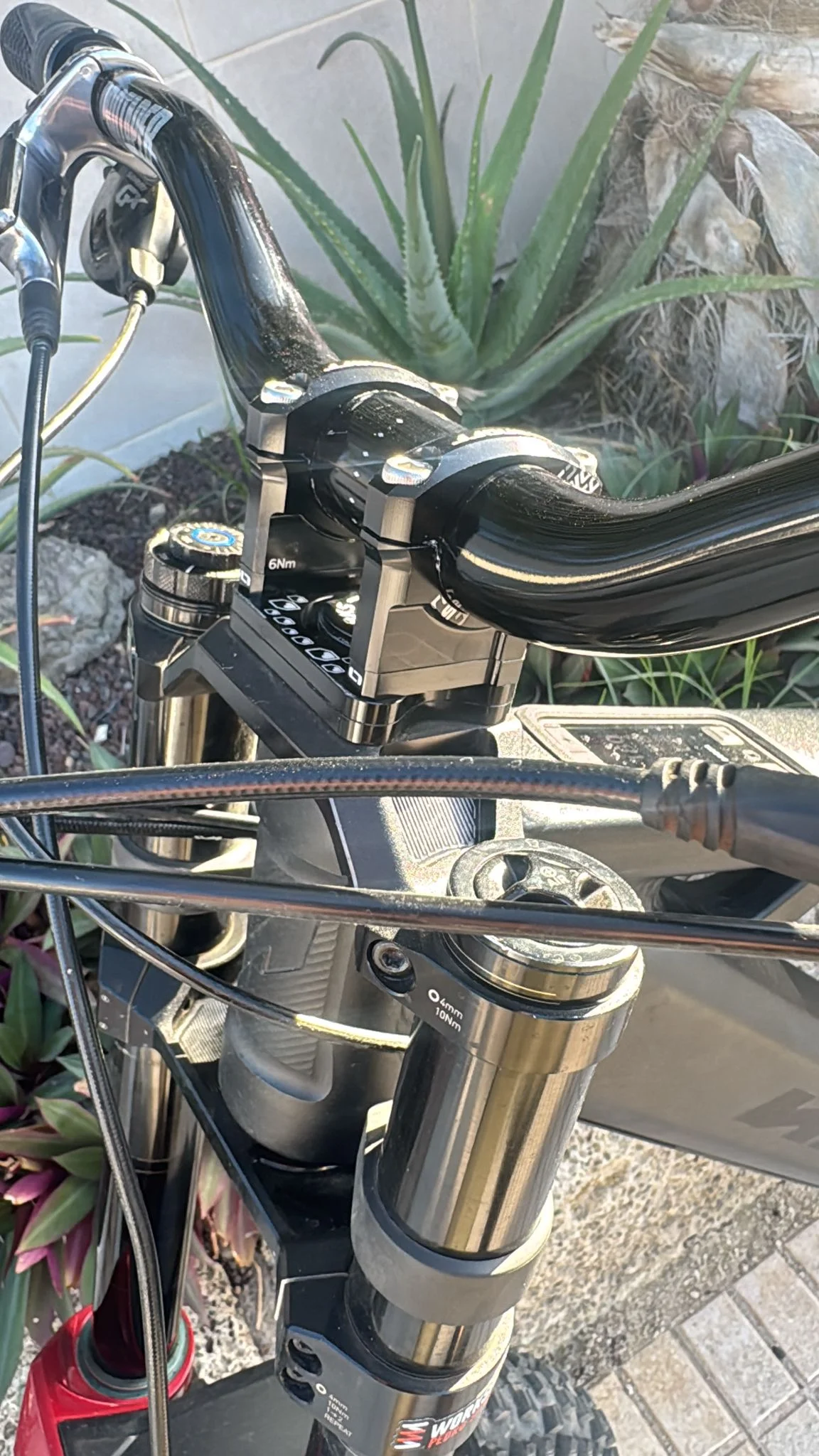

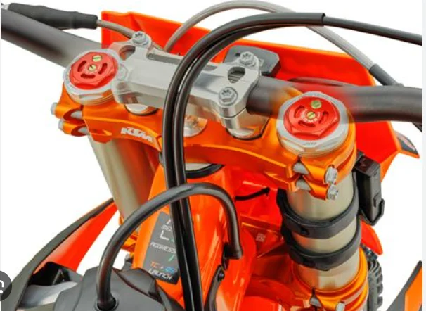

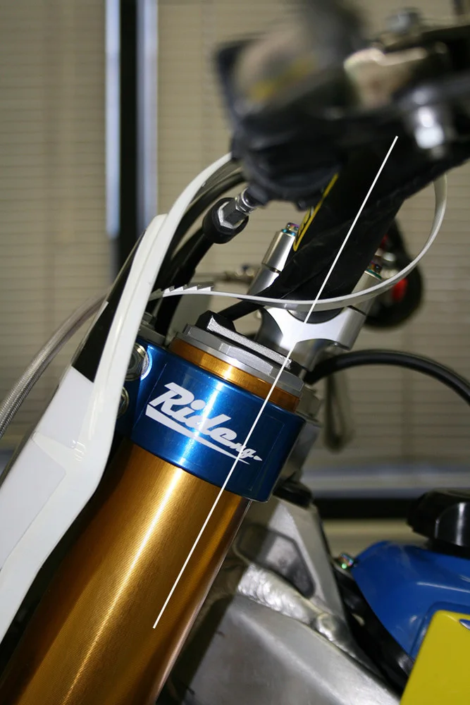

It’s taking notes from the moto world. Bars over/slightly behind fork.
I think it could be made to look ok if it wasn’t so tall then get the rise more out of the bars if needed. I’d be interested in trying one out
Maybe it needs a little nose fairing to tidy it up!
Hey, number plates are already used in dh. Can run cables behind for a clean look and like ktm mx bikes have on their number plate an integrated front brake line slot.

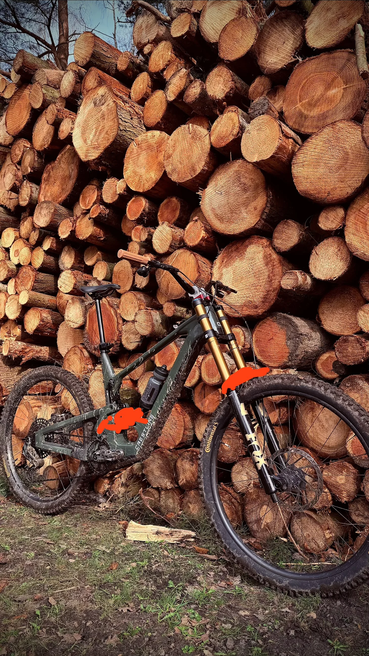

Ok, this setup is really insanely good and bat shit crazy.
I’d ride any track on this, it’s ridiculous capable with this reversed rise setup. I’ve got 146mm of rise all in.
I’m not sure what to make of it because it’s just so capable - my local DH techy tracks turned into a cheat code with this setup.
Even flat corners work because I can push the bike to extreme lean angles.
Looks so wacky, because we are not used to it.
I got the idea from Reece’s video:
With the fox 40, I put the bike back into the neutral headset position (was running -5) and the 52mm offset increases the front centre by a further 8mm. So about 13mm longer out the front than before, but now 18mm stem inverted and mahoosive 80mm bars from my moto.

Also I don't think it's exactly comparable to an MX bike. First, MX bars are pretty low and nearly straight so they don't sweep way back. Secondly fork offset is typically about 22mm, not 44mm like on a MTB. Thirdly if set up correctly, even after bar sweep, the bar ends should not be behind the inline of the fork. I do agree that on a MTB the bar should be aligned with the fork angle, but not a dirt bike. Because when you huck big on an MX bike your weight comes nearly straight down over the front end so that's the angle you want the bars at for the most absorption. But importantly, MX bikes turn on the throttle with very light front ends and really don't depend on front wheel traction the same way a pedal bike (or e-bike) does.
