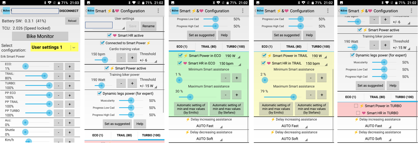

Yesterday's BLEvo smart power results:
I have been riding with a group of normal MTB riders and adjusted the ECO and TRAIL smart settings which I shared within this thread:
This time I deselected in Smart settings "Smart HR Active" and have set Smart Power to 230 watt (via the RC you can set it higher of lower during the ride) and adjusted ECO from 1% to 20%.
The result after a 1 hour and 53 minute ride for 34,98 km with 331hm was a consumption of 2,72Wh/km or 95Wh in total. With other words the theoretical range would be 184km and 1742hm. (but not sure if I could keep delivering the same power over that distance) I ride a Levo 2019 Comp with the 500Wh battery, Eddy Current Front and Rear, and weigh almost 100kg.
Long rides are possible also with the 500Wh battery but you need to limit the motor power and add some more rider power. ;)

Hi, I wonder if anyone could offer some advice. I’ve rode 2700miles in the last 12months on my 2018 Kenevo, using cm9 with eco 22 trial 38 turbo 80. I found it gave good power vs battery life. However I have just snapped the belt in my motor. Just been changed by Berkshire. Now have a x23 firmware so I cannot use my old settings. BLEvo now displays a different set of optionsAny ideas on an equivalent using the PP and assistance settings to give me the same feel.
With firmware x23 you can use eco 22 trial 38 turbo 80 with PP 44/80/100.. more or less the PP should be the double of the assistance %.
But if you use the Smart Power, the PP should be always 100% for each level
