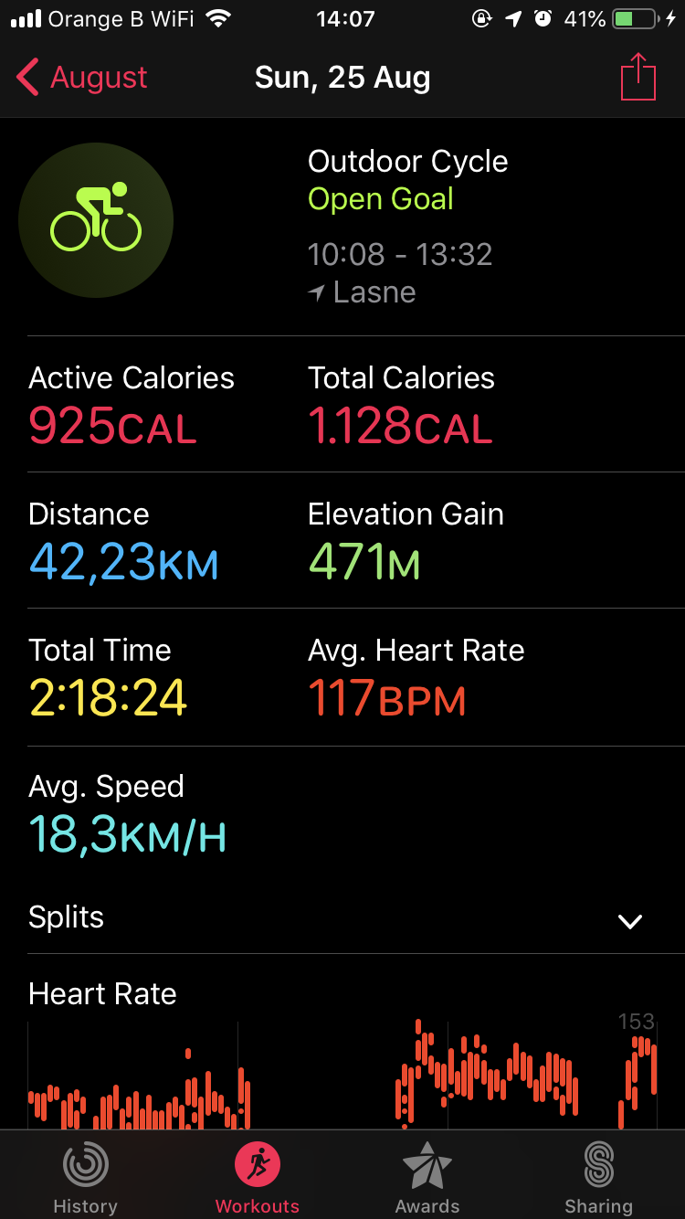

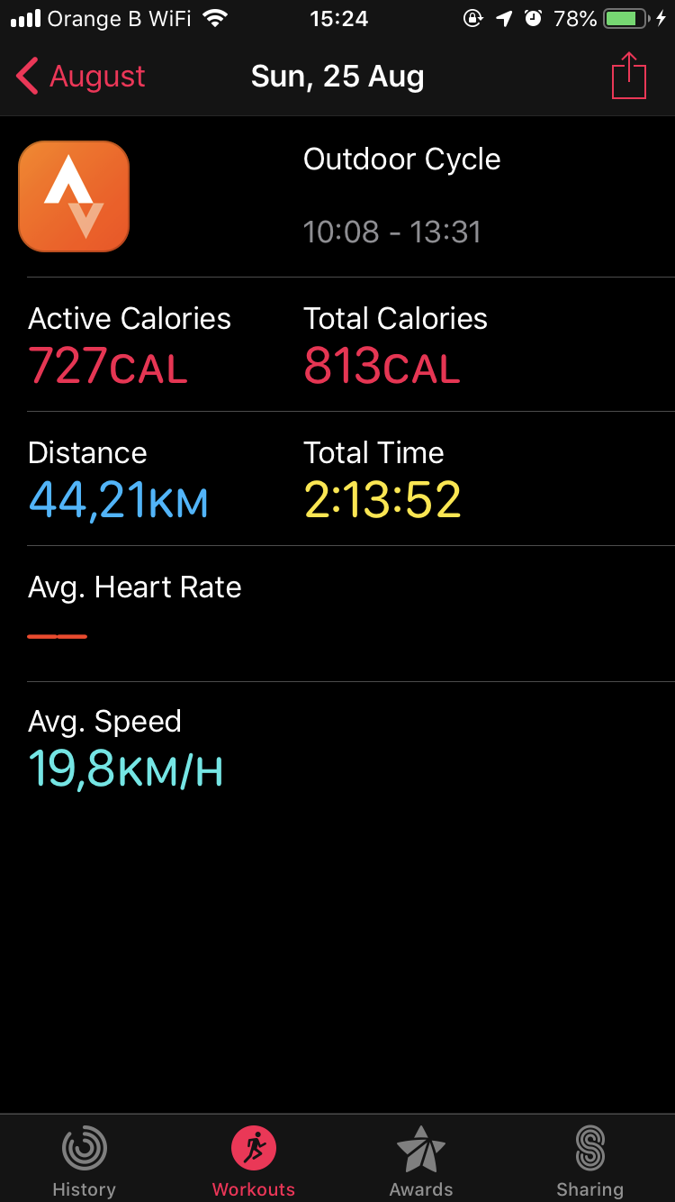

I still have two issues on iPhone Activity workout, not sure if the issues are related to BLevo:
From BLevo, I push data to Strava which push to Apple Workout/Health data.
A) The elevation gain is missing.
B) The heart stats are missing (I use the Apple Watch as heart rate sensor and I see it working on the BLevo display)
I have attached two pictures: BLevo/Strava vs Apple Workout.
Is there any way to fix those?

Hello,
In the latest version of BLEvo for iOS (v3.5.1), there are some missing data in the statistic..
Before the end of the week, I will release a new release with the bugs fixed..
Sorry for the bugs..

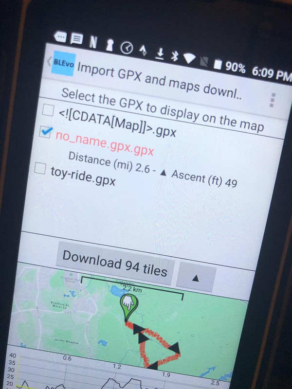

I am starting to use the Android version. When I use google drive to get some GPX files in there, the first two filenames are messed up. Is this normal and how can I avoid it?
IMG-6422.jpg[\img]
IMG-6422.jpg[\img]
I will check your gpx.. Thanks
