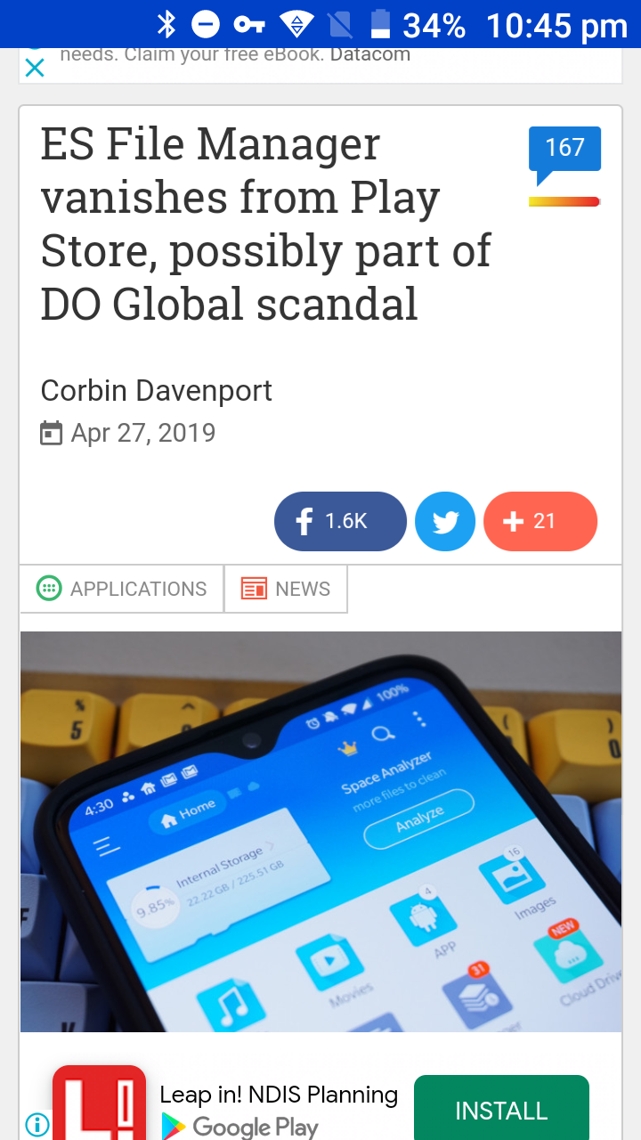

I checked mine and when selecting "Open CSV/TCX/GPX file folder" it opens the maps in ES File Explorer. Maybe you have installed ES File Explorer but didn't open ES File Explorer yet? I needed to open it once if I remember correctly and give some permissions.
After these permissions I can immediately open the maps via BLEvo.
Actually it seems that the real ES File Explorer has been removed from Play Store due to the developers being involved in a click fraud scandal
I wasn't aware about this. I just checked some websites and it seems they advise Android users to remove this app. So that's what I did and installed Amaze File Manager as a free alternative. Only one issue now... I can't open via BLEvo the CSV/TCX/GPX map anymore. @PaoloBLEvo , can you maybe solve this via an update? ES File Explorer is not available anymore on Google PlayStore. Thanks!

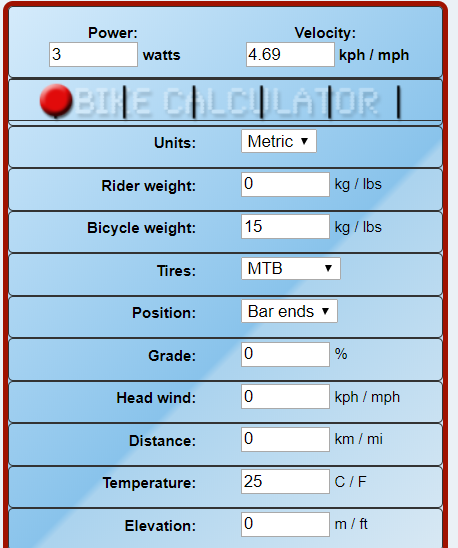

Feature request: I tried to replicate a road bike once and it was not really possible because of the differences in air drag made the forces get much higher as speed got higher. So the amount of boost needed depended on speed.
You can play with this and see how the wattage needed to stay at 20 mph on a road bike on drops is 170 watts and a MTB is 285:

So it was impossible for me to come up with a percent boost that would work at all speed ranges since air draft is a force that squares.
But Blevo could totally simulate a road bike effort by accounting for this difference in drag! It would just need to ramp up boost as a function of speed with the appropriate curve.

I think I like your idea, just to make sure I understand you correctly, you would like a new BLEvo smart function related to "e-bike weight compensation in relation to speed" to compensate the additional weight of an emtb compared to a normal mtb.
So when I use the calculator you send where I selected a rider weight of 0KG (as you like to compensate the additional weight (+/-15kg) of the emtb only), you would end with something like this:
In the calculator I inserted the speeds below and came to the following wattages:
3W @4,69km/h
11W @10,10km/h
27W @15,07km/h
55W @19,96km/h
101W @25,02km/h
167W @29,98km/h
259W @35,00km/h
So to summarize the wattages above should be compensated at the given speeds to compensate the additional weight of an emtb, right?
Maybe @PaoloBLEvo can add this feature as an exclusive option for BLEvo riders only ;)?
What I was proposing was to compensate for air resistance / drag and tire rolling resistance between an eMTB and a road racing bike. That way we can pedal and not be faster than friends on road bikes when riding on pavement.
There is no way to do that with a dumb algorithm. Need a drag curve of both bikes and riding positions (which is easy to make from the calculator), and then ramp up power to compensate for the difference depending on the speed.
I don't think there is a way to compensate for weight because it would depend if you were going uphill or downhill.

If I understood well, you want to ride with a constant motor power..
For example if you set 100watt, the assistance percentage should be changed by BLEvo increasing or decreasing the assistance percentage if the motor power is lower or higher 100 watt.. is this correct?
No. I just want a road-bike simulation mode so that I can ride beside friends who are on road bikes and have my effort feel the same as theirs. The key to making it work is to have the power change based on your speed to compensate for the difference in air drag between the upright riding position of a MTB and the leaned over riding position of a road racing bike.
Due to differences in air drag and tires, it takes 170 watts to ride a road bike at 20 mph, and 285 watts to ride a MTB at 20 mph. But this changes depending on the speed.
So in this mode, Blevo will increase assistance the faster that you go to cancel out the differences in air drag.
Now what I understood is:
- if the speed is lower than 20mph, BLEvo increases the assistance percentage
- if the speed is higher than 20mph, BLEvo decreases the assistance percentage
Is this correct?
Nope,.
First you use this program: Bicycle Speed (Velocity) And Power Calculator
And calculate the number of watts needed for a MTB at 1, 2, 3, 4, 5, 6, 7, 8, 9, 10, 11, 12, 13, 14, 15, 16, 17, 18, 19, 20, 21, 22, 23, 24, 25 mph.
Then you calculate the watts needed for a racing road bike with hands on the drops at 1, 2, 3, 4, 5, 6, 7, 8, 9, 10, 11, 12, 13, 14, 15, 16, 17, 18, 19, 20, 21, 22, 23, 24, 25 mph.
Then when this mode is active, you add additional boost equal to the (road-bike-watts - MTB-watts) as a function of the current MPH.
If this idea would work than I would be interested in a "simulate an mtb" setting in case I ride with friends with non-assisted bikes. I however am wondering why you wrote additional boost.
If you like a "simulate a road racing bike" setting then I guess you only need the support outcome of the calculator difference and no additional support on top of that?
Not boost in addition to other boost.
I meant the motor should provide assistance equal to the difference in watts between what it takes for a racing road bike and a MTB to maintain whatever speed you are currently going.
And bonus if it also compensated for weight differences by using the angle sensor in the phone. Then the app could have a “weight subtraction” feature.

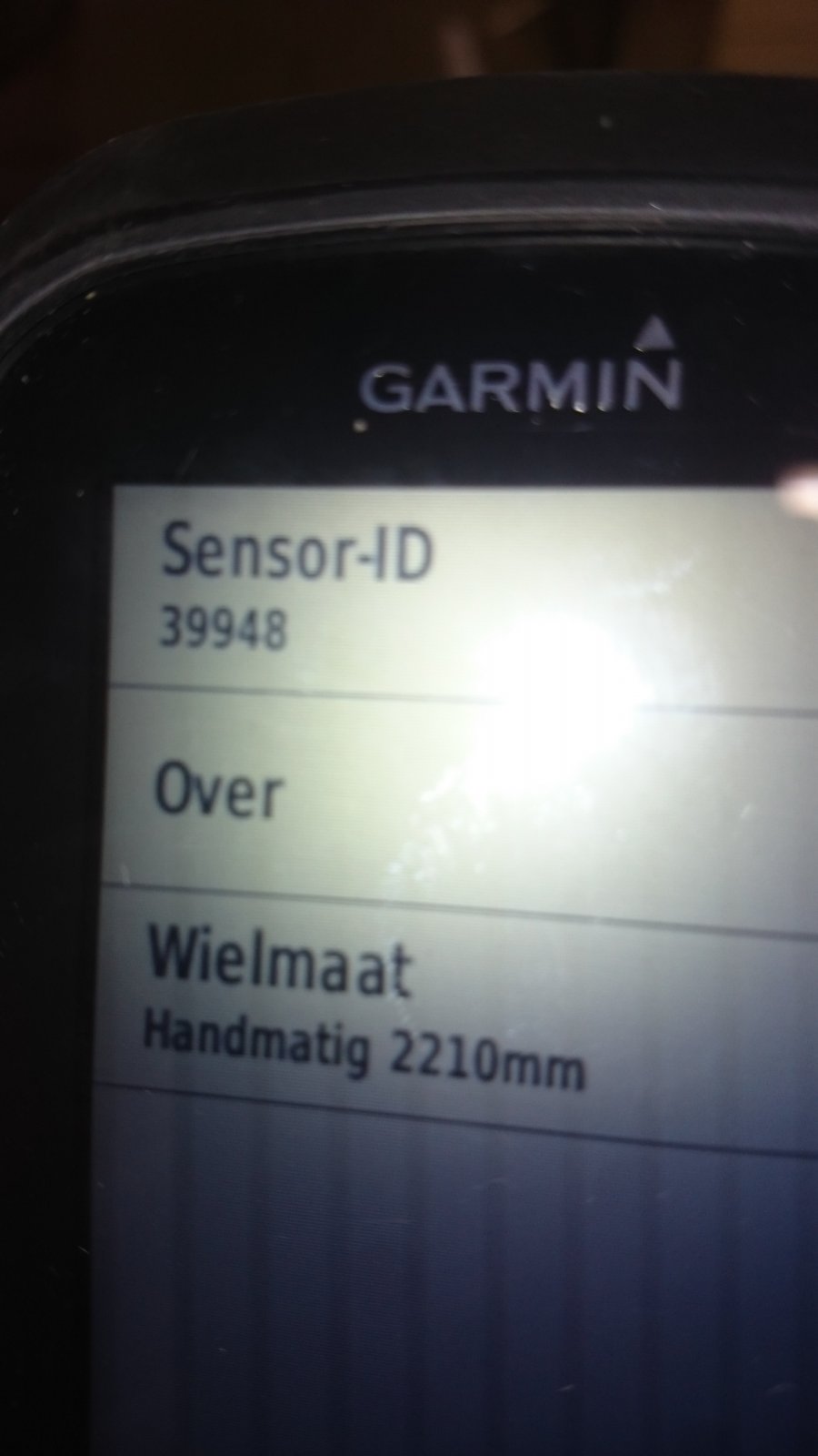

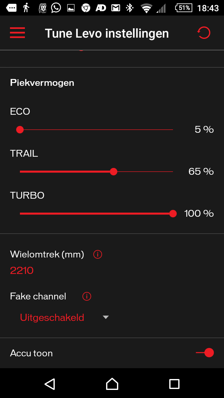

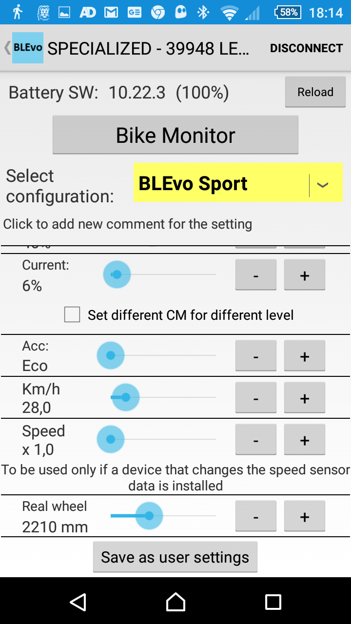

Has the bike been hacked by someone? (previous owner?) In MC the wheel circumference motor setting is visible. If it there says 1973 then that can maybe explain the speed difference which you are measuring between BLEvo and GPS. At which GPS speed does the bike cut off?
Can you please share screenshots of MC and BLEvo setup page?
Can you also share the real wheel circumference which you measured with toothpaste?

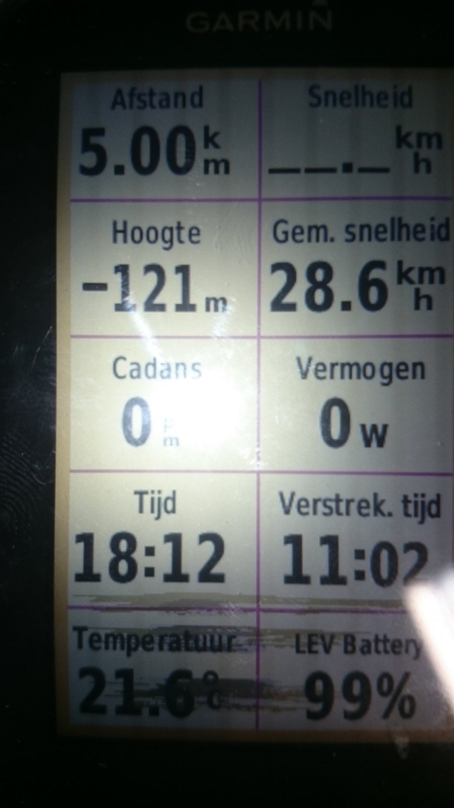

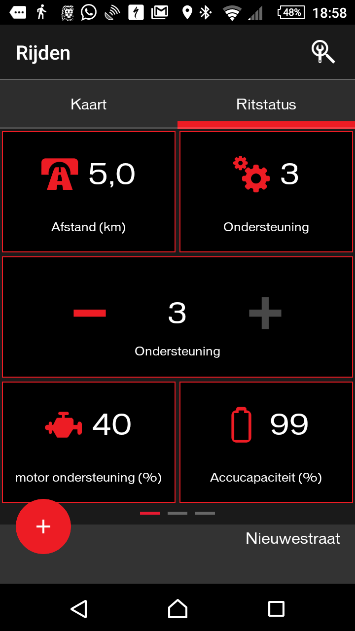

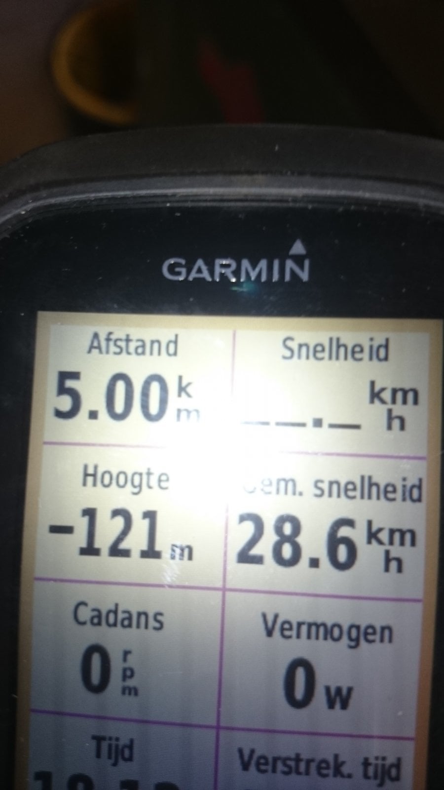

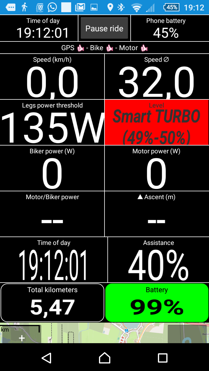

I decided to use wheelcircumference in stead of GPS. Now is in BLEVO and MC the wheelcircumference set at 2210 mm. Also in the GARMIN.( picture 1,2,3) I made two little rides of 5 km. One time with MC and GARMIN(picture 4, 5)
One time with BLEVO and GARMIN (picture 6,7)
Between the two rides I did not change anything except turning of MC and turning on BLEVO. Very strange there is a difference of 10% between BLEVO and MC. The real distance was excactly the same. Maybe Paolo has an explanation.
 View attachment 17470View attachment 17473View attachment 17474View attachment 17475View attachment 17476View attachment 17477View attachment 17478
Hi,
I think the issue is that you have set the speed limit in BLEvo at 28km/h instead of 25km/h where I assume your real wheel circumference is 2210mm.
((28/25)x5=5,6km so 5,47km seems pretty accurate.
But maybe Paolo has a different thought?

Hi,
I do not understand what the speed has to do with distance
