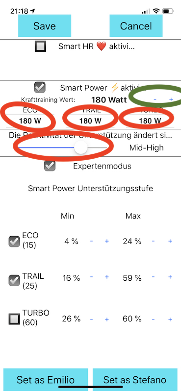

A problem that remains however is, that I currently run the iOS version of Blevo and I have not yet figured out how I am supposed to setup the Watt values for the different levels.
In the screen above, I cannot not modify any of the settings marked in red -- I can however modify those marked in green.
I wonder what I am doing wrong here!?

Thanks, Maastricht, for providing me such detailed hints. I guess that provides me with a good starting point.
Markus
Hi Markus,
Thanks!
You can scroll the values up and down in ios version to change them. I can change the slider too.
Hi Markus,
Thanks!
Thanks Maastricht. Now I feel stupid. :-) I always tapped on these Watt values but nothing happened. Scrolling works and increases/decreases them by 9. I still can't move the slider though.

Thanks Maastricht. Now I feel stupid. :) I always tapped on these Watt values but nothing happened. Scrolling works and increases/decreases them by 9. I still can't move the slider though.
Be aware that I asked Paolo the same question as ios user about half a year ago. So no need to feel stupid. Besides that I recently felt stupid myself as well. I drove my car backwards in a ditch a few weeks ago in Italy. Bike carrier was still hanging on the back side of the car kids and my wife still in the car and only front wheels where hanging on the edge of the ditch. First time in my life this happened. A nice German guy came to help help me and he pulled my car out with his VW Transporter. Luckily my car and bike carrier had zero damage. I promissed him from now on never ever to make a laugh about a German anymore. So happy to support you ;)!
I however don't understand why you can't move the slider. When I try it on my phone with latest ios version it works.

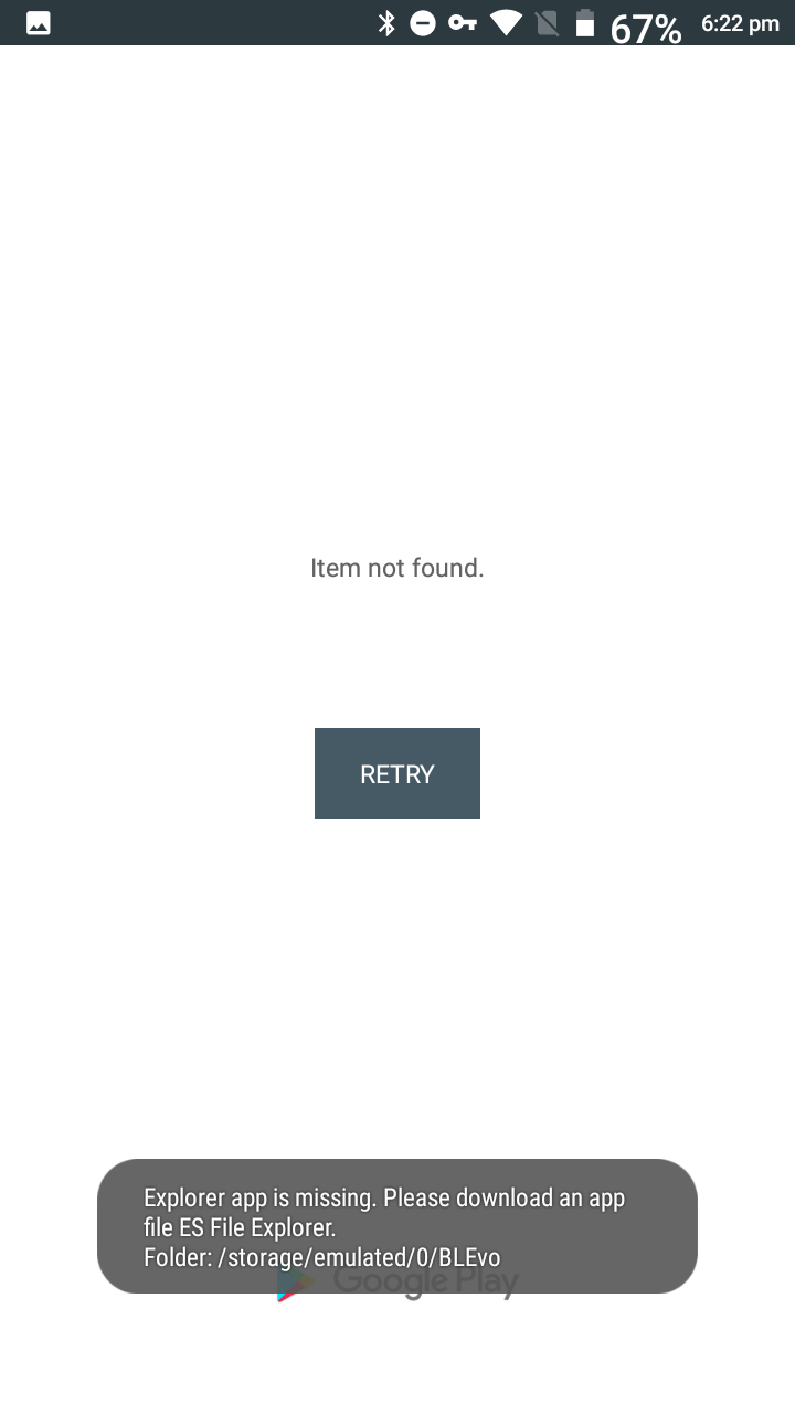

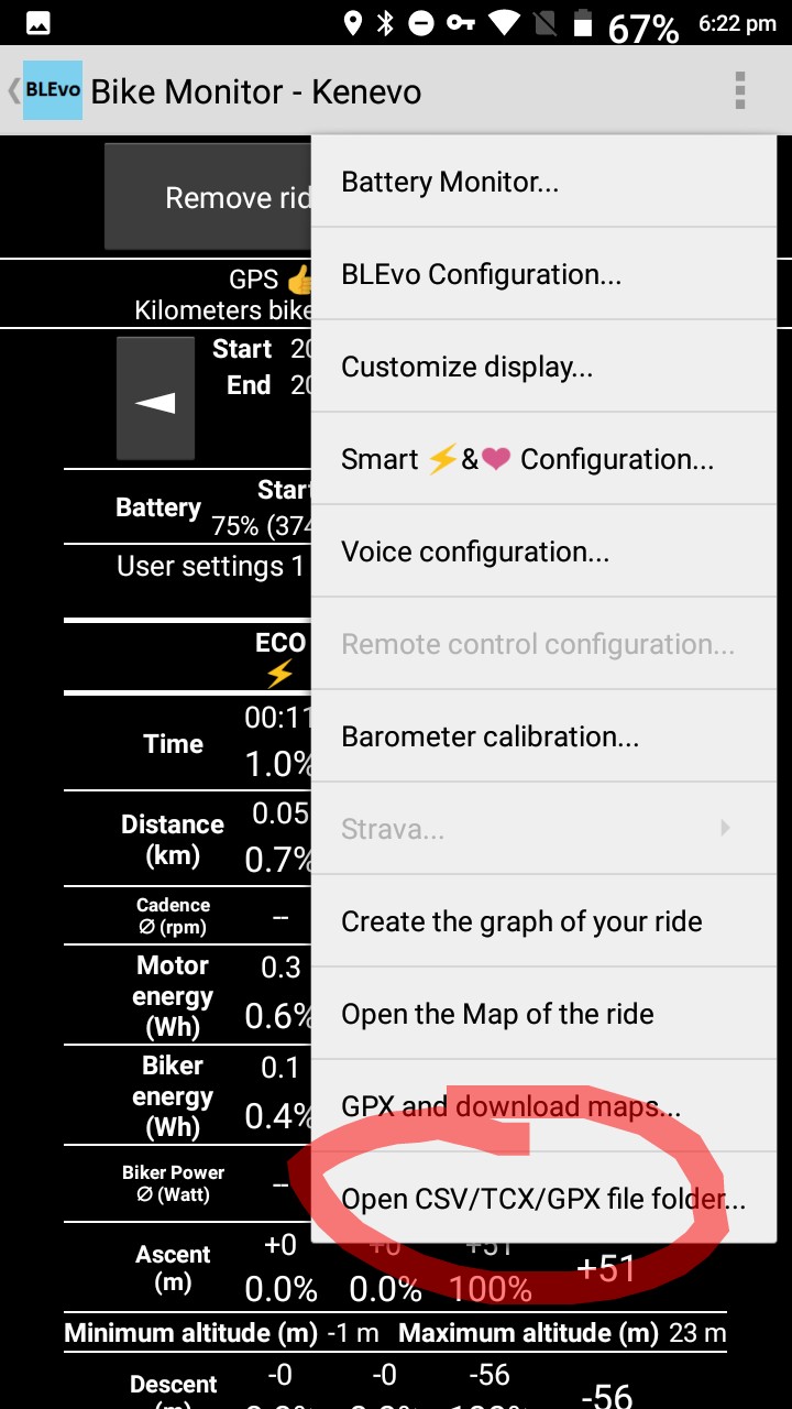

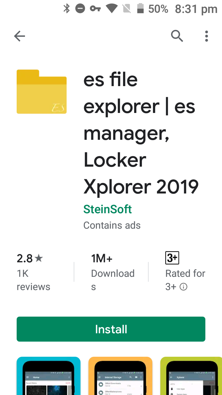

I'm gathering lots of ride files so makes sense to organise them, keep or flick basically. I tried the ES File Explorer option but got the following. ES File Explorer isn't available - File not found in Play Store. ES File Explorer is there but doesn't appear to function with Blevo when installed separately.
Likely something I'm not doing right.
View attachment 17360View attachment 17361
I checked mine and when selecting "Open CSV/TCX/GPX file folder" it opens the maps in ES File Explorer. Maybe you have installed ES File Explorer but didn't open ES File Explorer yet? I needed to open it once if I remember correctly and give some permissions.
After these permissions I can immediately open the maps via BLEvo.
