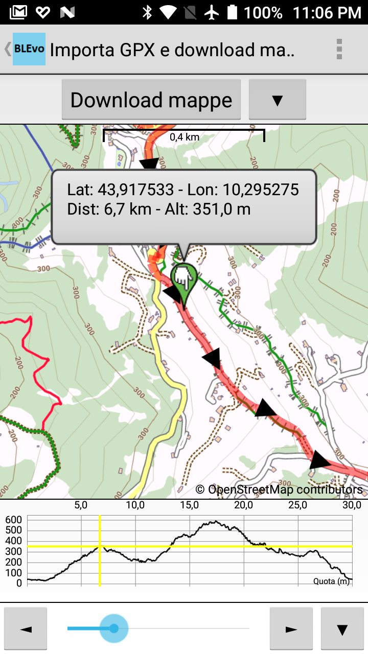

- Added elevation graph in GPX management
- GPX files can now be imported from other apps (like Google Drive)
- Now you can rename, delete and add GPX files directly from the GPX management menu
- Improved GPX ascent calculation
- Added the possibility to choose the color of the GPX track and the track made
- Now the recorded track is on the GPX

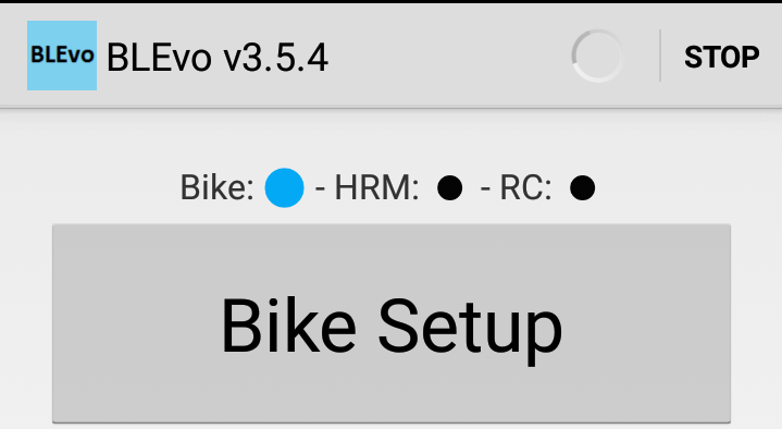

The 3 LEDs located at the top of the initial page represent the status of the BLE devices that must be connected to BLEvo. The LEDs can be up to 3 because the connected peripherals can be:
- Bike (Turbo Levo / Kenevo)
- RC (Remote Control)
- HRM (cardio band)
The flashing black ⚫LED indicates that the device is not found by BLEvo, so it is either not turned on or connected with another app or the phone's bluetooth has some problems.
The fixed black ⚫LED indicates that BLEvo is not scanning devices. To activate the scan press the button at the top right.
The blue ? LED indicates that the device has been found and can be connected to BLEvo.
Before proceeding, I advise you to wait for the fixed blue LED to light up for each device registered.
In this example you can see how it is represented when only the bike is turned on.
Here you can find a screenshot of the selected GPX elevation graph
