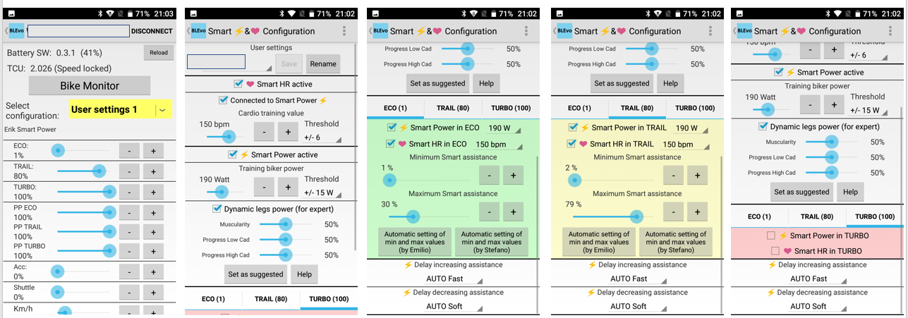

Hey! I've been using Blevo (iOS version) with a Levo 2019 for a while now. I really like the SmartPower function, because it keeps me a bit more involved :)
Yesterday, I was doing a long ride with some pretty hard climbs. On one of those I got demotivated (I was tired and that part of the ride went through a not very interesting area, just a plain boring road going up the hill), so I wanted a bit more support for that section, so I switched one assistance level up (from Smart Eco to Smart Trail) but that really did not give me that much more engine support. I am not really clear on why that happened... I suspect that I was not motivated enough to put in the 180W required to get some additional "push", which I was previously putting in while riding in Smart Eco!?
What would be the correct way of adjusting this? Raising the lower (and maybe even the upper) assistance percentages for Smart Trail? Decreasing the power level for Smart Trail (maybe from 180W to 160W)?
If decreasing the power level just for Smart Trail to 160W would be the proposed solution -- how would I do that on iOS? It seems that I can only adjust it "globally", i.e. for all assistance levels!? BTW, I also haven't found out how to change the "reactivity", the slider in the Smart Power settings can't be moved...
Thanks for any help.
Underneath an example of my settings:
These will give you in Eco a smart range between 1% and 30% and in Trail 2% until 79%. Sometimes I learned also not to use Smart HR and not connect it to smart power to save battery. In these case I just use Smart Power. So in the 2nd screenshot you then deselect "Smart HR active".
Turbo just 100% but rarely use it.
The settings above give you smart power with a cap at 30% in Eco to save as much battery as possible for a long ride. In Trail almost provide the whole range up to 79%.
When I ride with non emtb group I limit eco even to smart power with a max of 10% or 15%.
Then I also use the o_synce remote control to adjust the set leg power during the ride.
Hope this helps...
