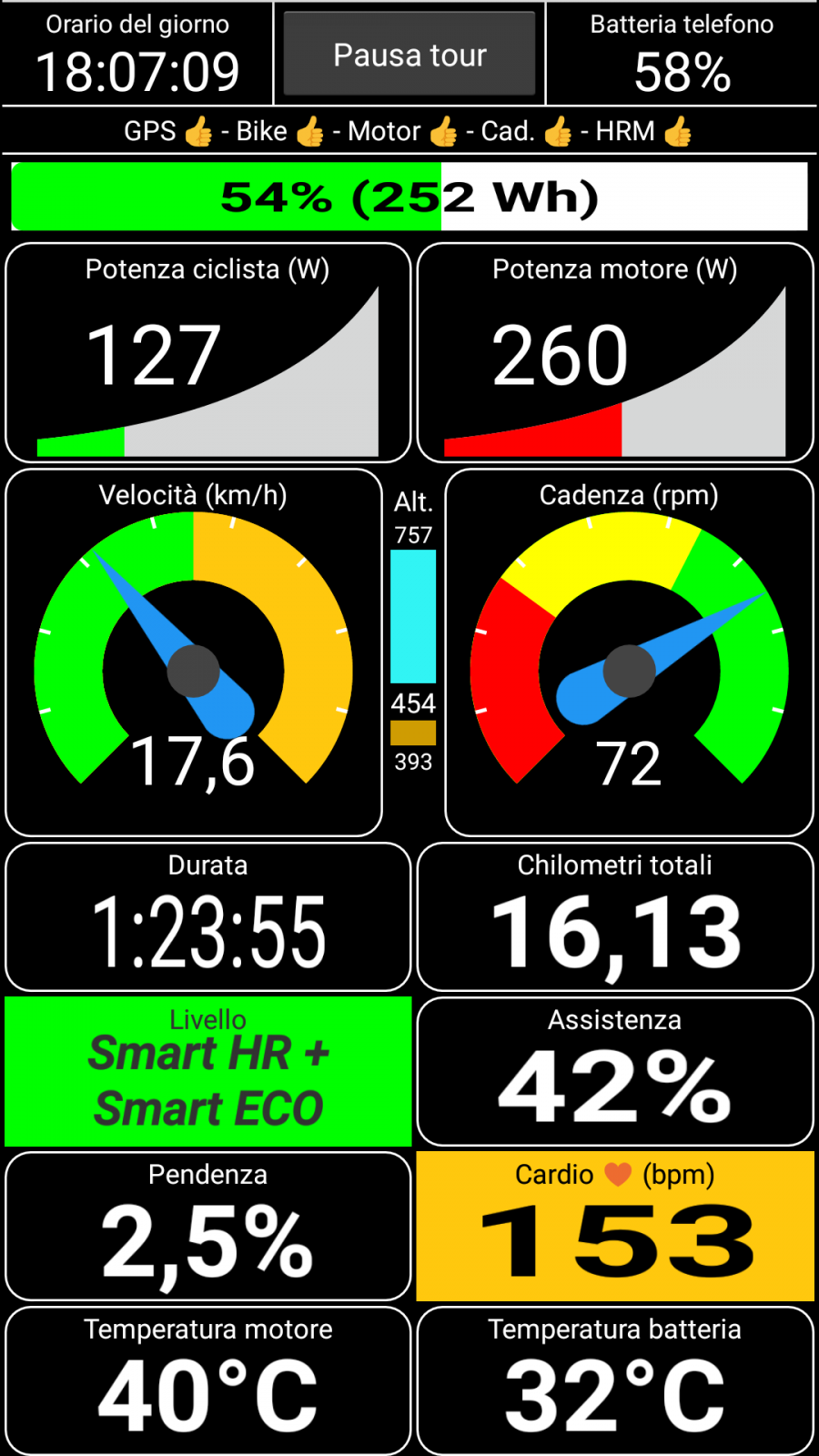

I just released version 2.21 of BLEvo for Android.
Here are the news:
- New BLEvo Monitor
- Speed up the response of the Smart Power
- Added display of degrees in Fahrenheit
- Now the tour is saved on the same file even if you change the battery
- Added the "Auto FAST" increase of the Smart Power to get more assistance faster
The new monitor must be selected and configured in the "Display customization" menu.
The 8 fields are customizable by the user.
Update it from Google Play
https://play.google.com/store/apps/details?id=com.dopa.android.blevo

Did my first ride with smart power yesterday and all I can say is this is a game changer. This sets the Turbo Levo above all other bikes IMHO. I have lots to adjust and learn but my battery consumption appeared to be down and the power delivery was smoother. Blevo was fantastic without this feature enabled but with this Smart Power feature it really changes the bike to be almost seamless. Amazing to review the stats and see how many times power levels are adjusted. I didn't use this feature for several rides but a ride buddy encouraged me to try it and once getting over the initial setup it is amazing. Rode about 17 miles, 1500 feet of climbing summit at about 8000 feet. Used 37% of battery. The smoke was bad.
Paolo - Fantastic work on this application. I loved my bike before it but now it is so much better.

Can anyone post their smart power settings and possibly explain what the hell it all means! :)
Try to use preset "BLEvo Smart"
10/80/100 pp 100/100/100
Smart Power settings (as Stefano, or "not expert")
Eco 6-79
Trail 11-99
Turbo 100
For legs power start with 160 watt and increase it if the assistance is too high.. otherwise decrease it..
