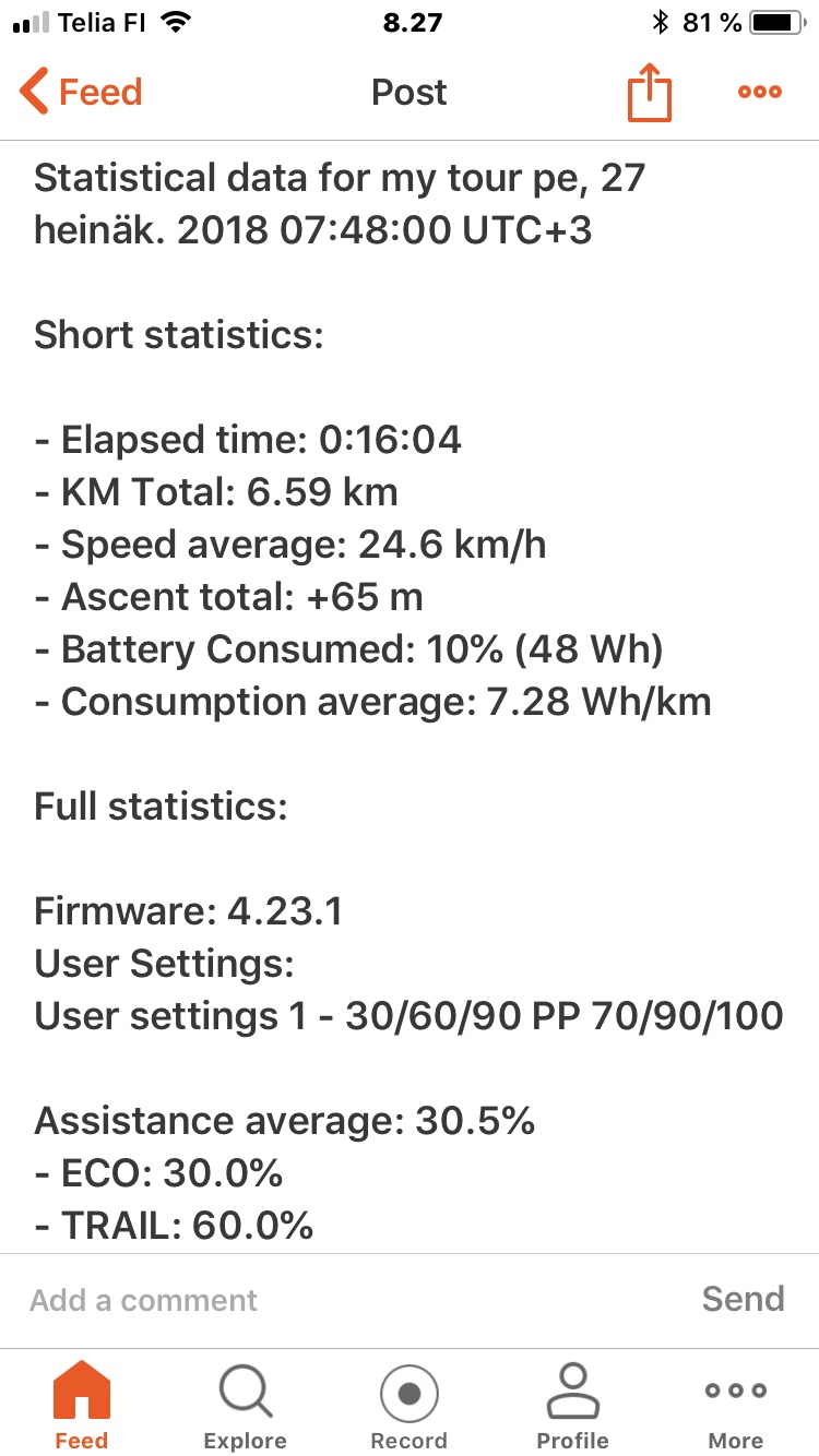

Something else i dont understand: upload straight to Strava looks like this:
Where’s route? And this does not apply kilometers to my gear at all.
That’s pretty poor.
And gps is poor; on and off all the time.
Is it really so that Blevo does not collect and show data all your rides? Only last ride? Total kilometres of your bike would be nice.
Yes you can run both BLEvo and Strava.. but why you need to run Strava? You can upload to Strava directly via BLEvo or with tcx file generated by BLEvo.. the information saved with BLEvo include also cadence and biker power...
With iPhone 8 this doesn’t work. Upload directly to Strava gives only ****load of data/text in Strava. No route at all. No segments, no kilometres added your gear etc. Strange.
