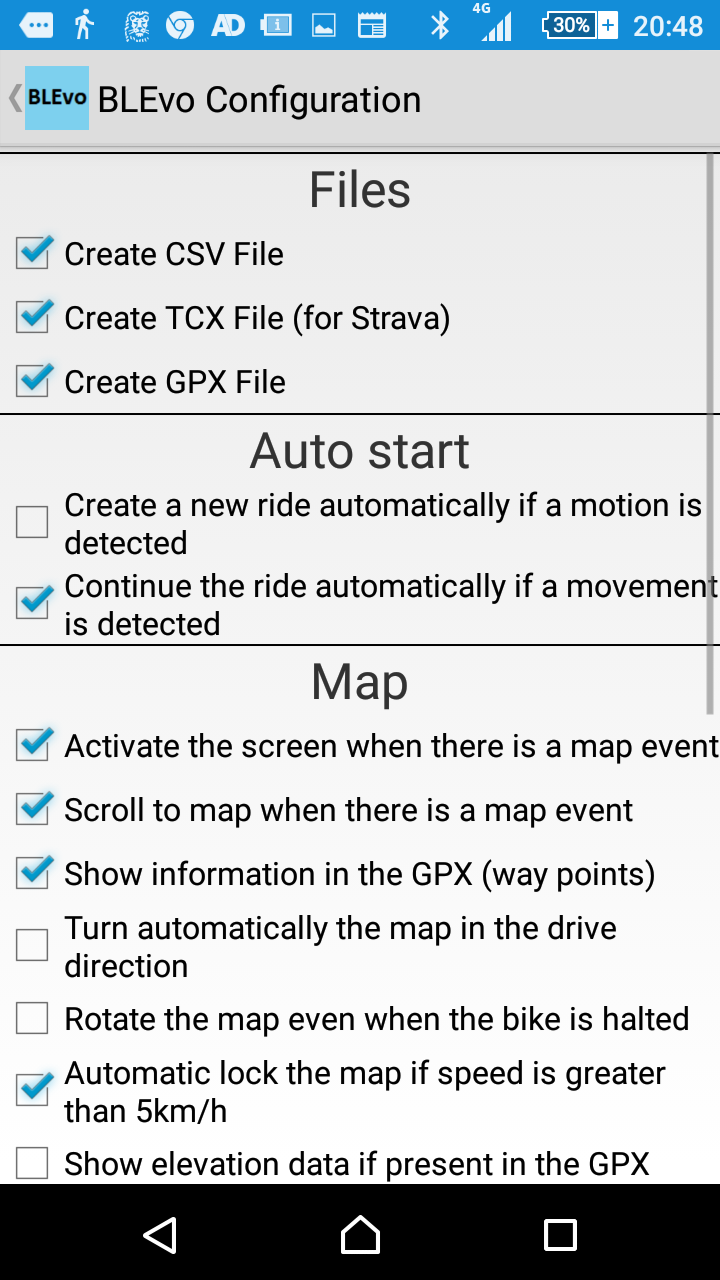

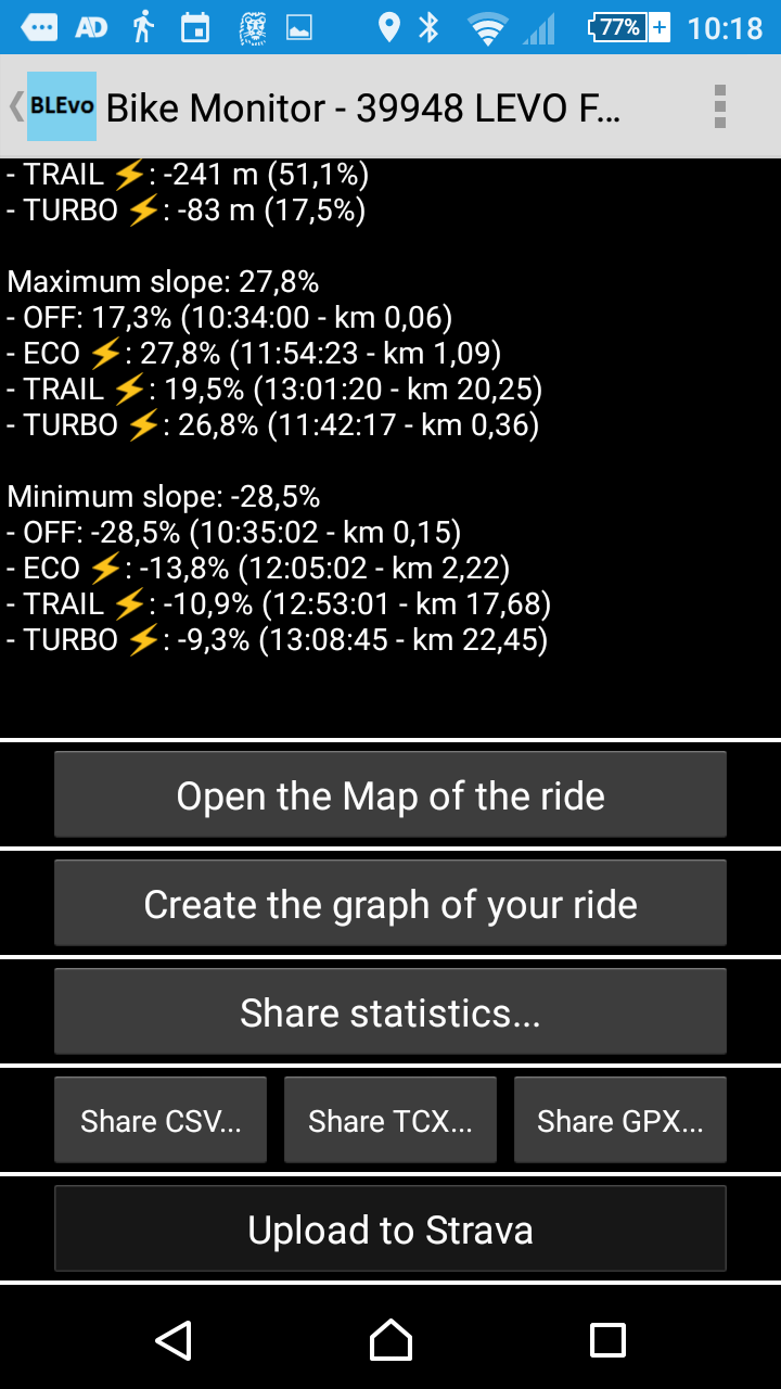

Hallo. Yesterday I did my first ride with smart power. I had some problemin the beginning but ad the end it worden perfect.
Now I want to upload the track to Strava but it does not work. I ended the ride but No action when I push " upload to Strava"
I have a Sony z1 Android. My bike is LEVO FSR COMP 2017
Did you do the authentication in the Strava menu?
I already had an Strava account. When I send the GPX file to STRAVA it works
Sorry but I don't understand..
BLEvo uses the TCX file for Strava, maybe you don't have selected the creation of this file..
What you mean with "When I send the GPX file to STRAVA"? Do you mean that you import the file GPX in Strava without using BLEvo?
Paolo ,
I think the the TCX file was Made. Look at the foto I send with this message.
I am not sure what I have to do to upload to STRAVA. I mean with send a message the button. SHARE GPX
Paolo ,
If the Strava authentication was done in BLEvo and the TCX file is created, I think you can upload the ride in Strava.. Did you press the button "End ride"?
Sorry. I do not understand what you mean with STRAVA authentication. How must I do that ? And yes I did press the button EN RIDE. Look at the picture

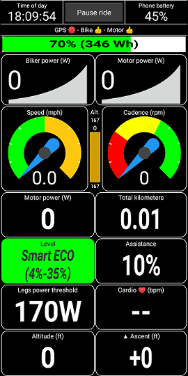

I configured Blevo for miles but the only choice for data fields is total kilometers and that's what shows in the ride monitor. The ride stats do say miles. Is it a label issue and the value is miles or is it actually kilometers? Wish I paid attention at the end of my first ride today to compare with the stats.
Secondly, time of day is a 24 hr clock. The phone is set to 12 hr and I don't see a setting in Blevo.

First time user of Blevo for Android (latest release as of yesterday). I think I saw someone else mention this but thought it was fixed already.
Google doesn't release the version with the bug fixed.. sorry for that..
