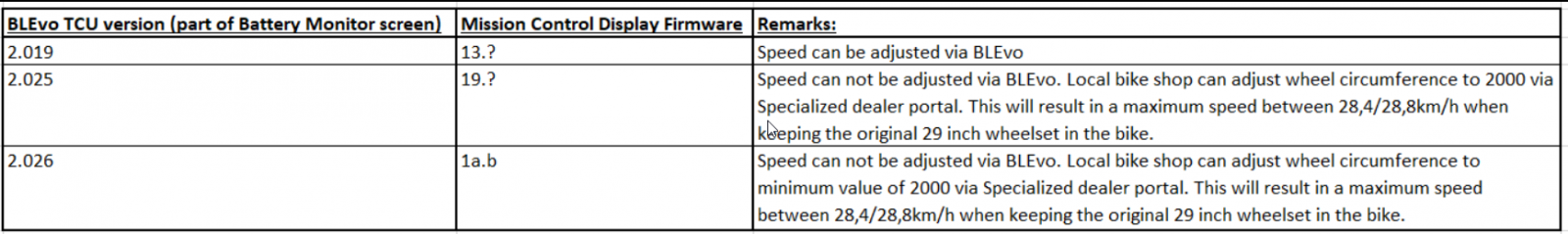

May I try to answer your questions?
First of all it's important to understand which firmware version you have today;
When you have TCU version 2.025 and 2.026 only the dealer can modify the wheel circumference setting via the Specialized dealer portal software which is saved in the motor.
So when you are riding with the original 29'' wheelset you will most likely see a value around 2300mm. which should correspond to a cut off speed of 25km/h as you are based in the UK.
When I measure my wheel circumference exactly when sitting on the bike with the original Butcher tires I end up at 2270mm. So I have set in BLEvo the real wheelcircumference of 2270. BLEvo will then calculate the real maximum speed based on the wheel circumference setting which is entered by the dealer so if that it 2300, the real maximum speed should be ((2270/2300)*25)=24,7km/h. BLEvo just needs to know the real situation so all calculations are compensated for the difference between the wheel circumference value which is set in the motor and the wheel circumference value in reality.
So if you change to a smaller wheelset, for example 27,5'' then you measure the real wheel circumference again by sitting on the bike. This value you will enter in BLEvo. BLEvo will then recalculate the maximum speed based on the wheel setting which is still saved in the motor which you will also see in MC. If this is still 2300 than you will notice a misalligment in cut off speed. Cut off speed will be lower than 25km/h.
Specialized dealer can set wheel circumference at minimum 2000mm. When you then leave the original wheelset in the bike you will end up with a theoretical cut off maximum speed of 28,4km/h.
BLEvo does not communicate with MC. For firmware versions 2.025 and 2.026 BLEvo can only read the wheel circumference which is saved in the motor by the dealer. For firmware version 2.019 BLEvo can also overwrite the wheel circumference which is saved in the motor.
Hopefully this helps. In case of any questions left, just let us know.
Thanks so much for that. Really appreciated. New bike so presume it will be latest firmware.
And if I finally understand then I can change Blevo circumference myself to make Blevo speed and data perfect but MC will remain incorrect and speed cutoff slightly lower unless dealer changes it?

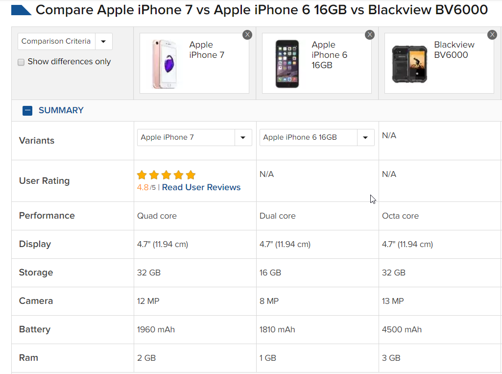

When I started using BLEvo I used it on my iPhone 6. (meanwhile have an iPhone 8) I guess you are right battery consumption is significant if you leave the screen at full brightness and always on. You can also choose to turn off the screen or only turn it on when you need it.
When I used my iPhone 6 I also used a Topeak powerbank which I mounted on the handle bars while as you can see below the battery of your iPhone 7 isn't much bigger than the one of the iPhone 6:
Later I was talking with Paolo (the developer of BLEvo) and Paolo recommended to buy a cheap BV6000 (you can use it without sim maps can be stored offline (Android only!)) and the BLEvo Android version.
This combination works very well. I also use the optional O Synce remote. As you can see the BV6000 has a large battery. So now I never need the additional powerbank anymore.

About power consumption for iPhone, another user found a solution remove the auto brightness and adjust it manually..
In any case the BV6000 is the best solution.. expensive, but less than a Garmin..

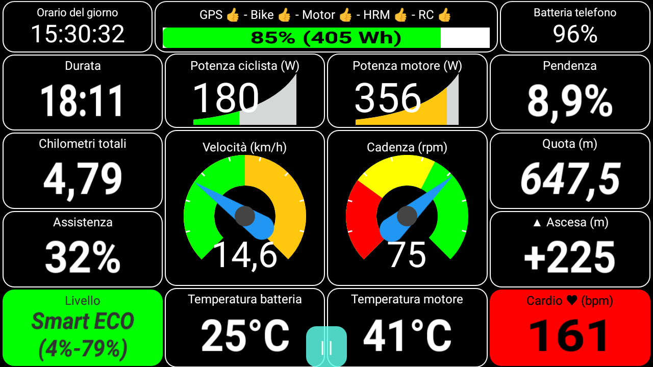

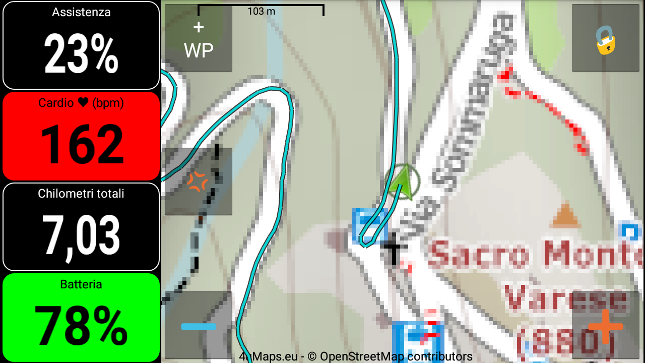

Finally after several days of testing I released the 3.5.0 version of BLEvo for Android. Thanks to all the testers.
In the attached photos you can see the new horizontal Bike Monitor.

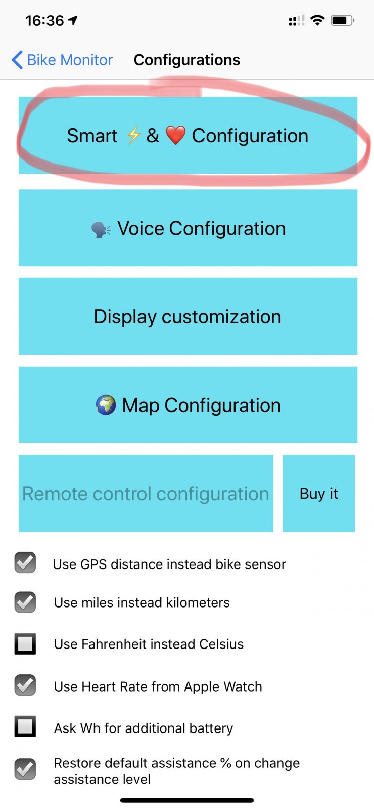

Sorry but nothing is similar to madness.. you can reach something similar with Smart Power and special settings of dynamic legs power..
Ok so I may be a little nieve here but in the smart power settings
If I understand this correctly the higher the smart power level eg 180W the harder the rider has to pedal before he gets assistance of the motor?
So if that setting was changed down to 50W the motor would assist a lot sooner.
Is that correct?
Is that correct?
Yes, correct..

Here are all the news:
- New horizontal Bike monitor
- Optimized the display of the map for horizontal monitors
- Now if the main battery is not 100% charged at start-up, the Wh available for the second battery will be related to the primary charge percentage
- Added option to remove biker power and motor power bars from the display
- Optimized GPS fix
- Bugfix: Altitude calculation with negative quotas
Minor changes:
- Negative altitudes are displayed correctly
- Added GPS Speed, GPS Distance, GPS Altitude as data field
- Added LEV coach as a remote command
- No activity restarting when the screen is rotated
- Increased arrow size on the GPX
- Bugfix: correct ascent calculation at start-up after barometer calibration
- In the CSV the ascent and descent are with a decimal
- Proper autonomy with extender battery
- Added voice message with time of day on level change
- Bugfix: map_rotate_on_stop and map_auto_lock_on_speed were not saved correctly
Download the update from
https://play.google.com/store/apps/details?id=com.dopa.android.blevo
and let me know if you found issue..
Thanks and enjoy your ride with BLEvo..

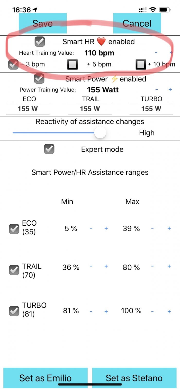

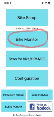

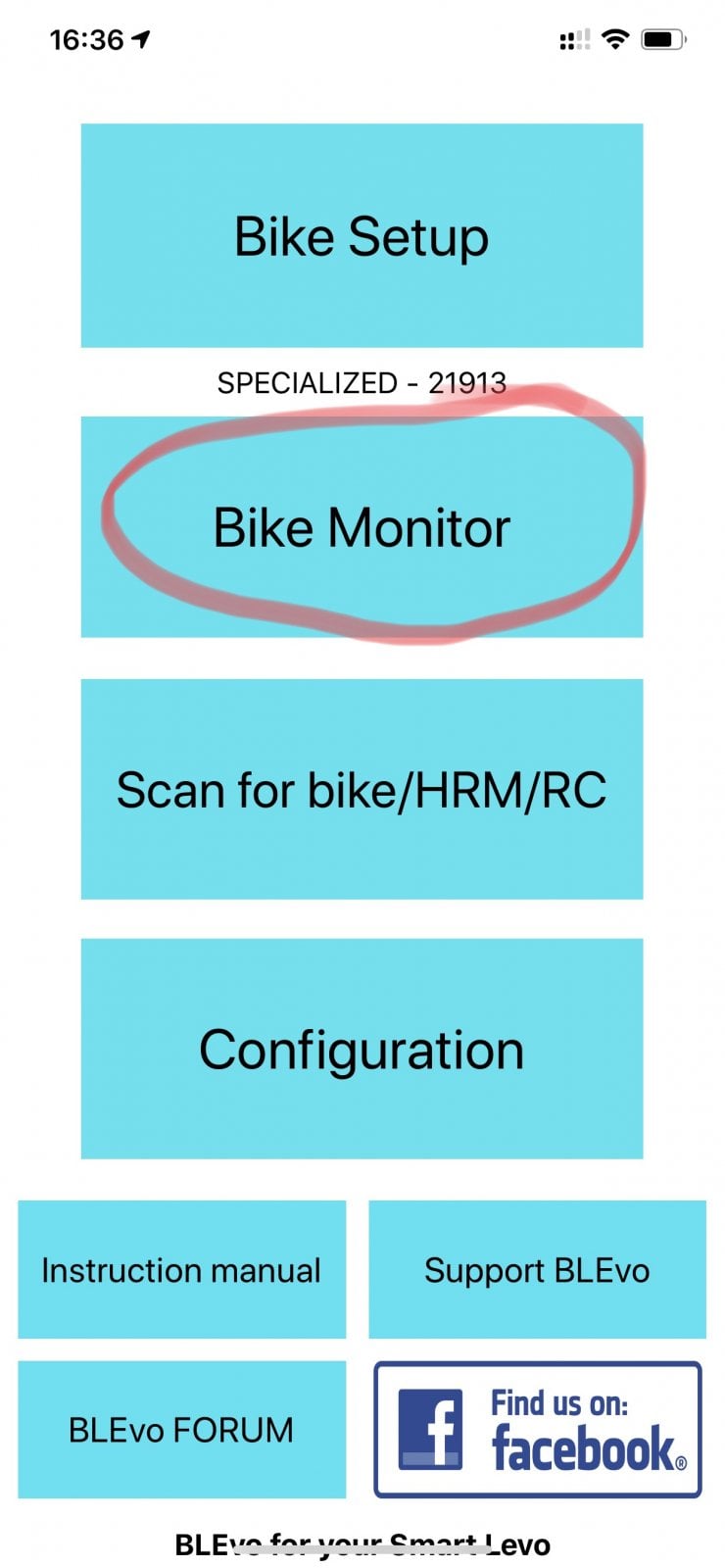

Page 13 of the Blevo manual says:
“Smart HR and Smart Power are active at the same time I suggest to activate the linking function between the 2 algorithms by selecting “Connected to Smart Power”
I can’t find “Connected to Smart Power” anywhere. Running iOS 12.2 on an iPhone 6. Maybe it’s another one of those Android only things? Then again I don’t see it in the screenshots either.
Available on iOS - follow these
A6AF1FAD-2F0A-447A-A25B-A3FB127CCB82.jpegE3603682-3DE5-4F98-82B5-87287C72639C.jpegCFF1F86F-C1DA-4114-A221-EF28ADD3A505.jpeg
