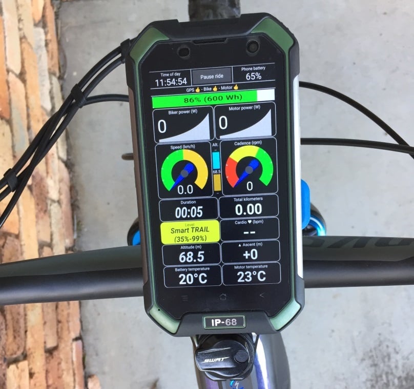

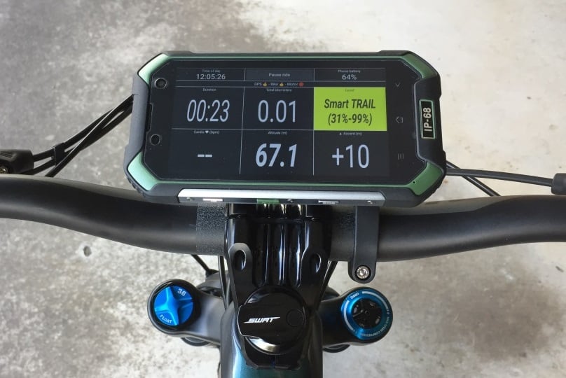

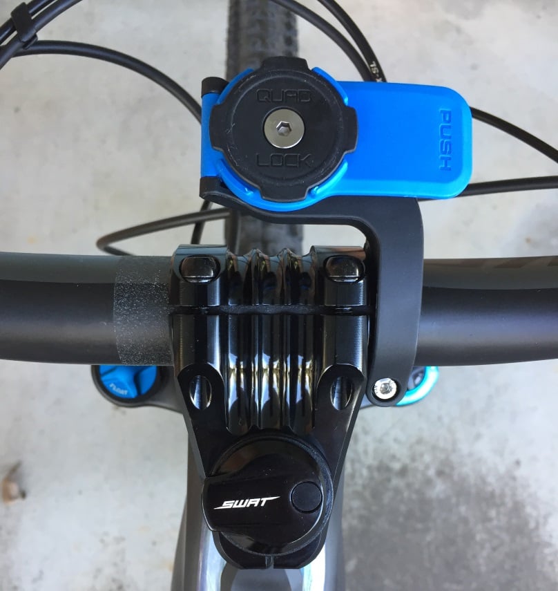

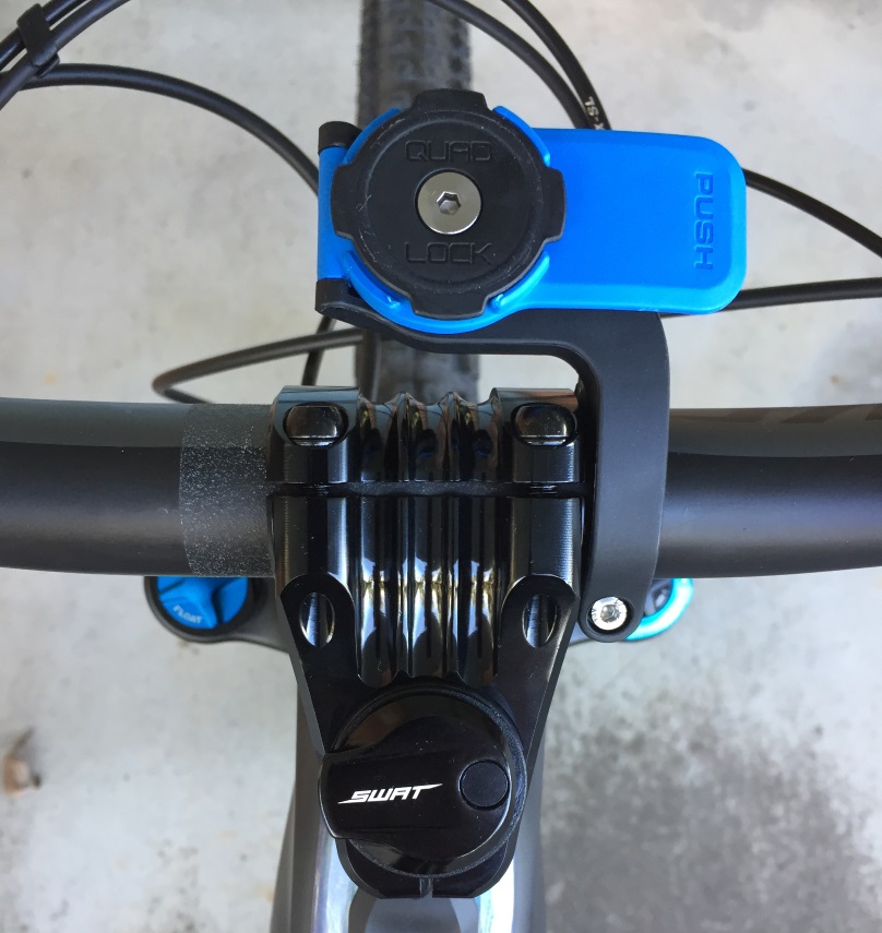

Thanks for the idea and the procedure! Can you maybe post a picture of the BV6000 on the handle bars in portrait and landscape version? Thanks a lot!
Due to the off-center position of universal adapter (see post #2,060); for the landscape example above, I positioned the clamp 12mm away from the stem. This set up I did just for the photo and I now prefer it to my original setup, as it hides the cables better and just looks right.
I also tried the "out front mount" rotated 180deg to position the phone behind the bars, but having the connector in that position blocks access to the SWAT tool.
Hi, thanks for the pictures! Looks very nice! You did a good job...
Don't know you preference but soon there will be a new dashboard in landscape version. Paolo has already been testing it:
