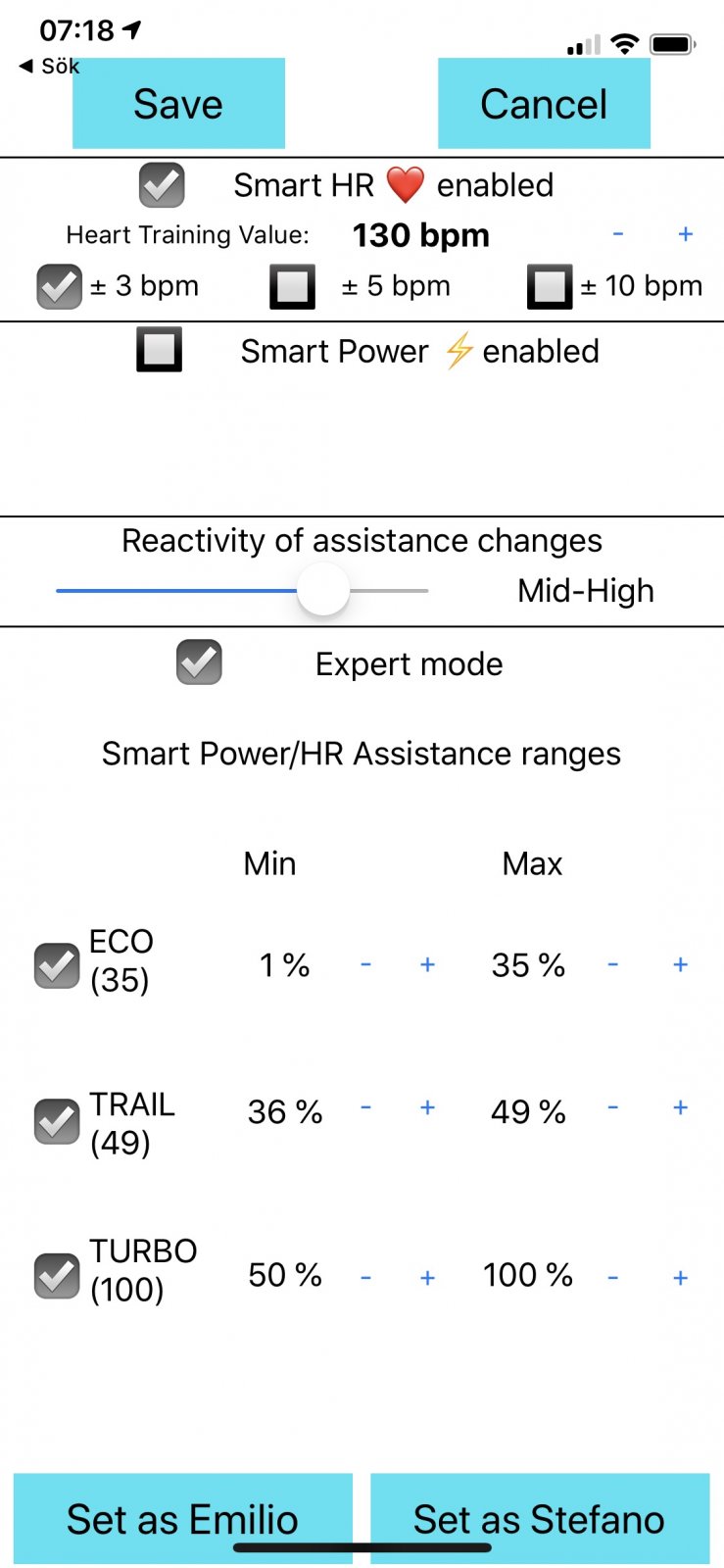

I was riding 2.5 hours today, used smart heartrate set to 130. I could not tell it was working harder when approaching that pulse or beeing over it. Should the assistance figure change?
On my level of firmware on a 2019 levo the rider watt is totally wrong all the time if that can be a cause.
Did you configure smart HR settings between an min and max %? If you add the assistance % to your display you should be able to see the assistance % change as soon as you reach your set heart rate value.
Can you test this?
Smart HR is enabled, heart rate training value is set to 130bpm, I have checked the +-3bpm. There is no Min and max hr to set what I can see on iPhone version.
I have expert mode checked and choose “Set as Emilio”.
You have set it correctly. Yesterday I was thinking you maybe would have set the min and max assistance range very closely to each other and this could maybe explain why you didn’t feel any difference.
As I don’t have firmware 3.019 I can’t compare. Maybe Paolo has another idea?
I tried today again with +-10, no difference at all to the assistance level when pulse going from 70-145. Tried all three modes.
Just one idea more...
Have you selected BLEVO SMART in this screen?
Did you start the ride and keep the phone connected to the App?
Is the heart belt connected and detected?
Could you try to make a short test with the phone in your hands or on the handle bar in order to understand if the heart rate is read correctly?
Thanks.

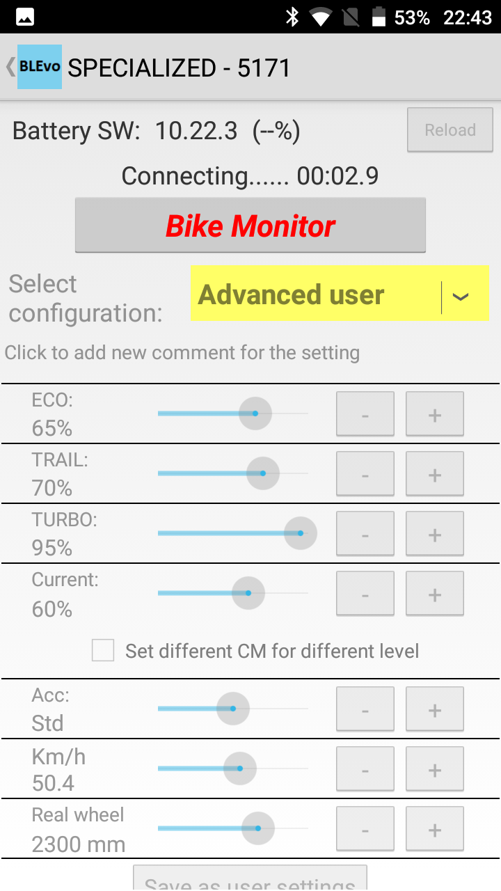

I've tried to get my head around with Current Motor and Assistance etc. values. I've been lately really happy with my setup, as I was getting a good range and also a good exercise (i.e. the uphills haven't been too easy, but the bike has assisted just the right amount), but here comes today: I bought a bluetooth-enabled heart rate sensor. Pairing etc. went just fine, and off I went for a ride. I did not change any other values on my setup, but just enabled the "Smart HR". The bike became crazy: I was well below my HR threshold (140 bpm), but even in ECO mode, a series of pedal thrusts made the bike to increase the power to 400-500 watts. The assistance percentage increased the normal way with the set delay, but series of pedal thrusts made each time the bike boost away like never before. I knew that that is sucking the juice out of the battery and I also did not like the way the bike behaved.
So, I thought that there's something with "Smart HR" and I disabled it. However, the bike kept acting the same way after that. I tried changing the settings back and forth: CM values , assistance levels, etc. etc. Rebooted the bike a couple of times. I stopped like 20 times during my ride, but nothing helped.
I know that there is some bug/thing with CM x assistance should stay below 999, but I don't understand that. Any chance that you @PaoloBLEvo could elaborate a bit more? I'd like to have settings, where ECO mode assists some amount, but gives a good range (i.e. for example will never give me 500 watts). I use TRAIL only for short but really steep uphills and TURBO for going over fallen logs or other similar, very technical stuff. I had my setup like this, but not anymore :unsure:
I'm using the latest Android version of BLevo. Bike is 2018 Levo with x.23 firmware.
... I removed and re-installed the app and got it to work again with my old settings. I'm sure that enabling Smart HR did something, which I wasn't able to revert again.
You should also share the settings..
With firmware x.23 there is no bug like with x.22..
I don't understand how can be possible what you describe..
Sorry, I actually have 10.22.3. I got confused with "3".
These are the settings, which work again after re-installing the app, but which went crazy after enabling Smart HR.
Screenshot_20190602-224338.pngScreenshot_20190602-224143.pngScreenshot_20190602-224151.pngScreenshot_20190602-224155.png
View attachment 14431View attachment 14432View attachment 14433View attachment 14434
Are you sure, you want to ride with ECO set to 65%??!?!?
I think you don't have associated the HRM... the Smart HR is not available...
Please set the CM to 9 so you can use the setting from 1 to 100% without thinking of the bug..
That was it, now it works. Thank you, it somehow reset itself to custom.
