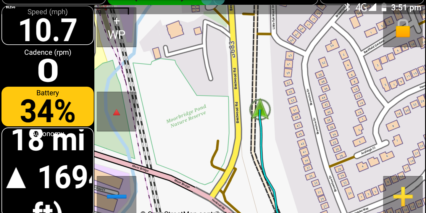

I'm loving the new Horizontal display mode, but I've discovered a small display bug that you may want to correct. If you have the range (Autonamy) displayed on the map page and it adds the elevation the text is too big for the box. See screenshot below
RrEi-Yw-zrO2K9kf4h7GTBL9zmgWi-j30MpQ5lxP46IynsIRRIK760FIzk73NMAIi5lAOy7iPCleEgrO5JRbGjH8ySR5usR888eoZYmIdRTGlcab9Bb9dfw1z1K2MQgzJHfFScPZrBqNL9wB8cCrtI-j7UzbHC_gkaFNwGaATZFaLImMRPNEQKhcP4juKcDSuAFlyCVt7Lr6A1T0fIBsGiQqRTBszpfoQSjQppT01lx8JenePCJzjlO98tESuBeo4qb5dgauovwHPDN4Y1KKUFbjkkV8TzkDfS1_oKWKYd1dhc6y4VGmRavA_wEbE_LKvCjh_WX230j7BsN9zCbacX62aRjQZV64CmhAqqsx7ZNpdxCC_Xk-o1FqEti8wCLiOtJRp3qNpu5Q4nEN2hkOYWpPwp6x8iazx5oqqGzUdNTDf8TsIJXP4-YXBHYaj7BkEwhih5FjHuhoFYbcsJGSR9RVDxnCPs8R4ae_y3Qjs9OgbAY7k0V5zNEunf-x2gEFduSkOzw1g-jCJ7-ZqrT47OPcGadWhwxaT-Jk9KGzPfWVZ-0Izu2HbepMvtL63YZUJsDax5nPF8Pf2OTeGgOVNeZ3Bj78JFexJaG2M8zdrxw7L473NnpTAL9_lqQ85nVpRRmO4jZ-laypfukOtEbyhUjTtRvT7I9k=w1440-h720-no
Sorry but I cannot see the screenshot..

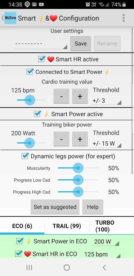

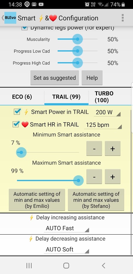

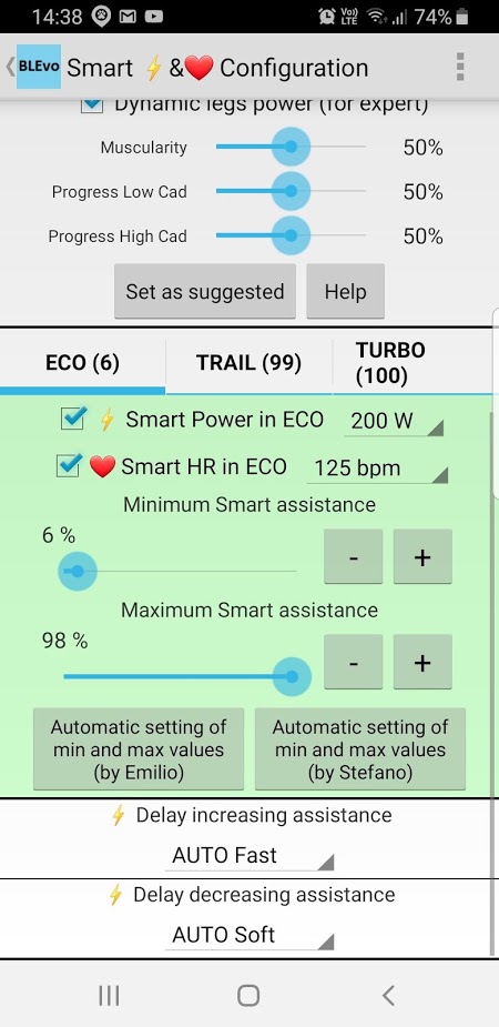

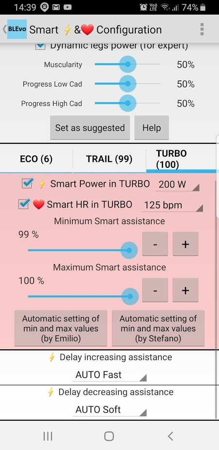

HPee said
Hi there, I bought blevo some weeks ago. I have tried to found out good settings for smart hr & smart power. Is somebody able to share some "best" settings? Bike is 2018 turbo levo expert.
Hi, I have been trying various settings based on past posts, and currently I find the attached to be the best. Set the bike page and the smart/heart as below. I then use trail for the ride and get infinate variable assistance from 7% to 99%.(you can set heart and leg levels to suit youself). The turbo 99% to 100% is just for the steepest parts or a lazy ride home! Hope this helps
Robert.
