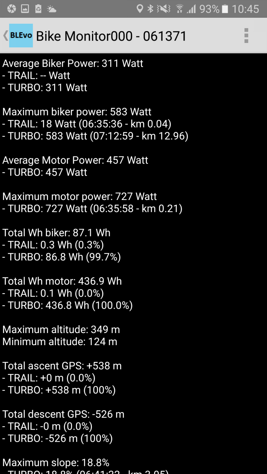

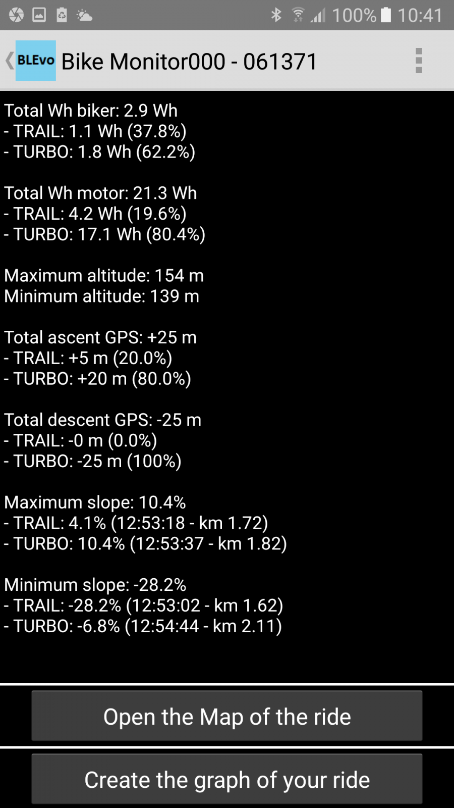

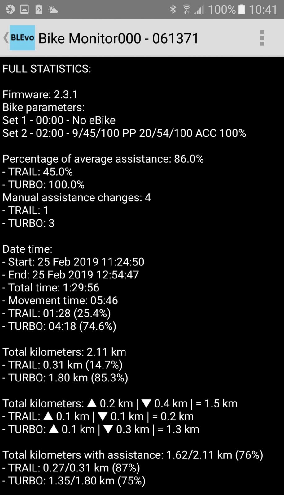

Why do I need it? Simple, because the information is available and is ‘Currently’ pardon the pun, what I need for an ongoing investigation of mine. If the info I have requested can be displayed in the ‘after ride’ stats that would be perfect for me.
I suppose you could ask why I also need the info in the screen shots below.... my simple answer is... If it’s available, why not? I need some of it but there maybe someone out there who needs all of it. I don’t want to spend loads of time calculating when the results can be just be displayed like everything below.

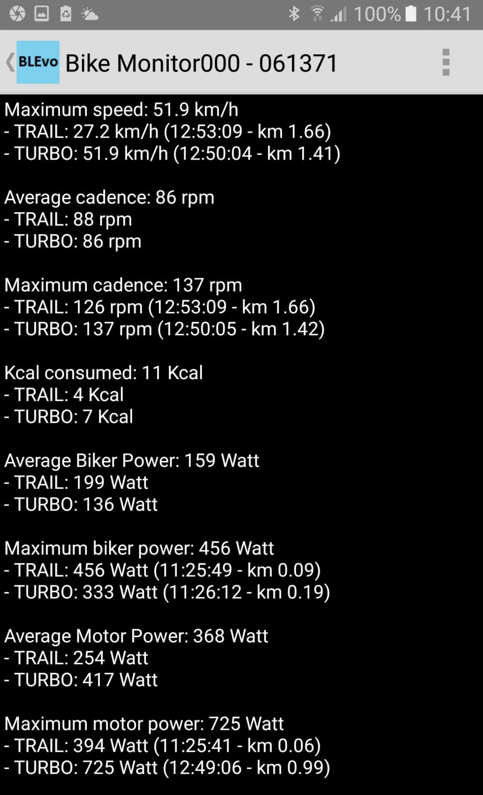

I want to know this information as some of the 2019 Levos are only putting out just over 700W of Maximum motor power. Mine puts out between 700-725 @ a draw of 18 to 19 Amps. I get almost identical data out of Mission Control but it is live on the display and not captured like BLEvo and not easy to read....
The 2018 Levo’s are consistently putting out (with the new fix) 760-790W of Maximum motor power @ 19-21 Amps.
The marketing blurb was the new 2019 Levo’s had 410% assistance v 380% assistance for the 2018 Levo’s.
I would expect all the 2019 Levo’s to be putting out at least the same 760-790W if not more but am I not sure about what is meant by ‘410% assistance’ how it is calculated and what it actually means if anything in regards to maximum motor power output. It appears that more Amps drawn from the battery = more Maximum motor power. I know this extra power is obviously going to affect your range.
What I am seeing at the moment and hearing from other forum members is some of the 2019 Levo’s are lower on max power output compared to the 2018 Levo’s.
The reason I want the Battery Current displayed is so it is easy for other forum members to look at what their readings are so they can feedback without having to download csv files and check various columns.

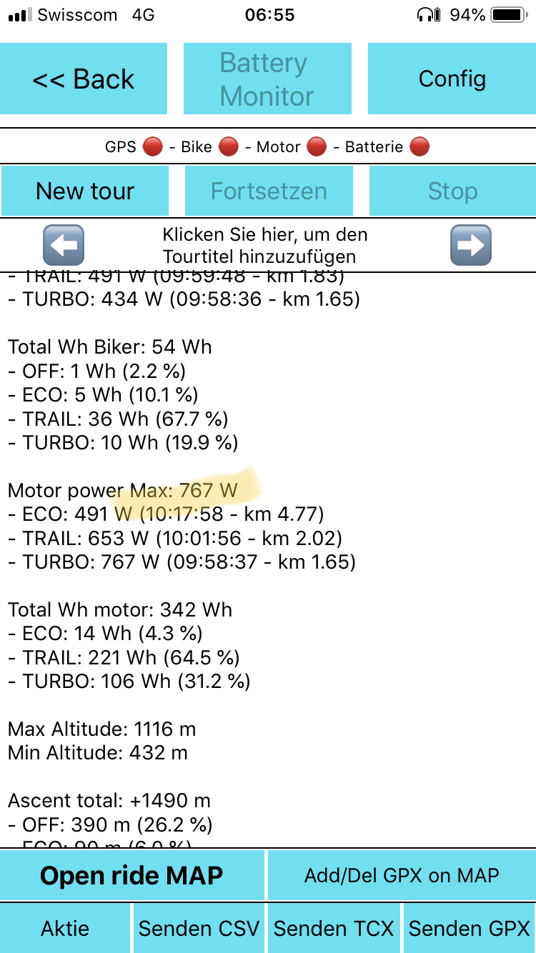

I had my 2019 motor exchanged early January due to the noise issue. After the exchange I noticed the motor firmware was 6.0.0 where my old motor had 6.1.0. I don't know the difference between 6.0.0 and 6.1.0 so I thought the newer the better. Maybe this can explain the watt peak power difference? What firmware are you having? Be careful, for obvious reasons, too that when upgrading motor or battery firmware at your LBS, they can not exclude the TCU so if you currently are running 2.025 or 2.019 it will be upgraded to 2.026. (like mine)
My max. recorded motor peak power is 723W at 37V and 19,8A. My cadence at that moment was 77rpm and I delivered 305W at that moment. The assistance was 32% with peak power 100%. I was riding with BLEvo smart heart rate and smart leg power.

So taking the above in mind at the moment I received 723W from the motor as a peak, my input was multiplied by factor 2,37 and that most likely is due to the assistance was set at 32%.
What I will do next time when I go, especially for you Kiwi, I will run turbo at 100%/100% uphill and will give all power which I have in me. I will check the results afterwards and let you know. I guess you then have a good comparison between a 2018 Levo, your 2019 Levo (of which I don't know the firmware update) and mine.

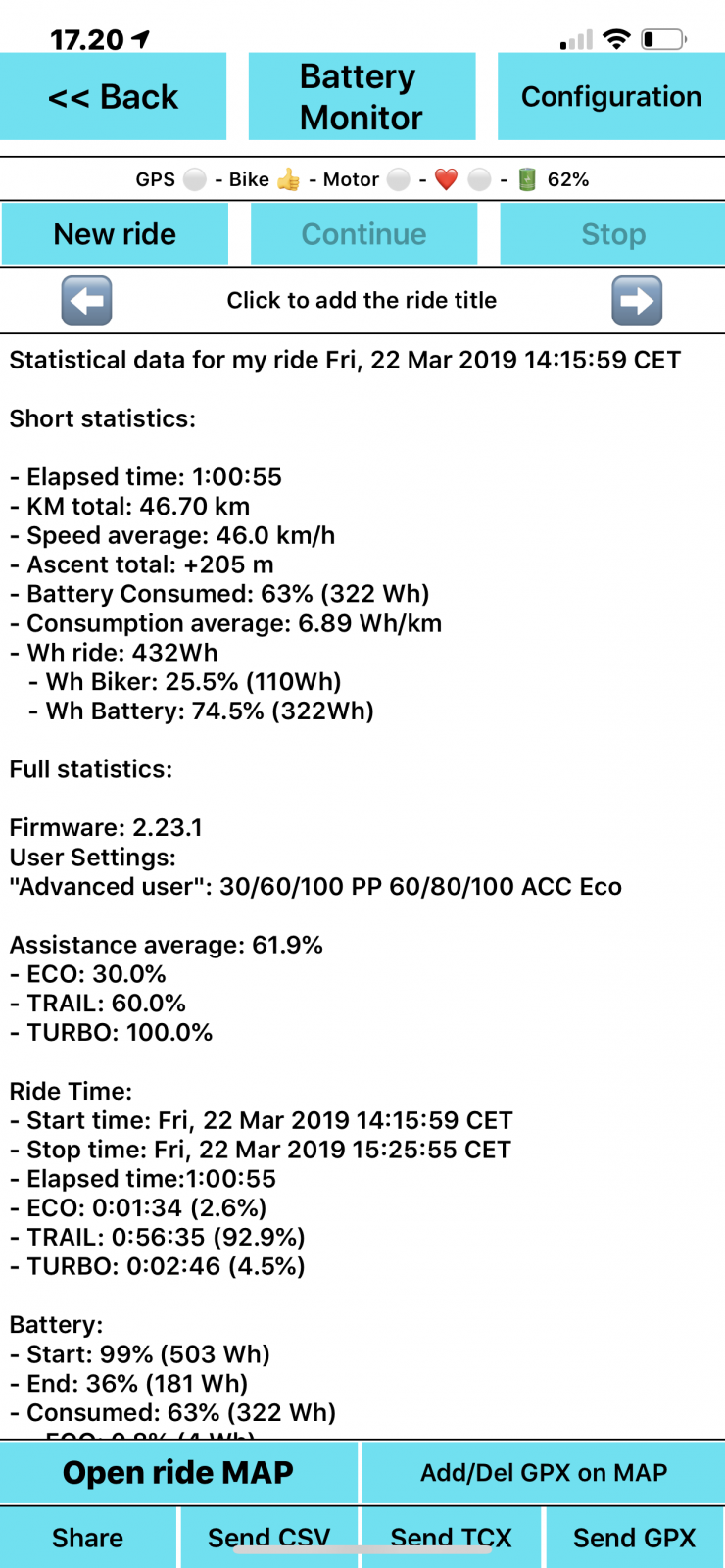

Below is my last ride where I did not go over 727W and did not go over 19 Amps

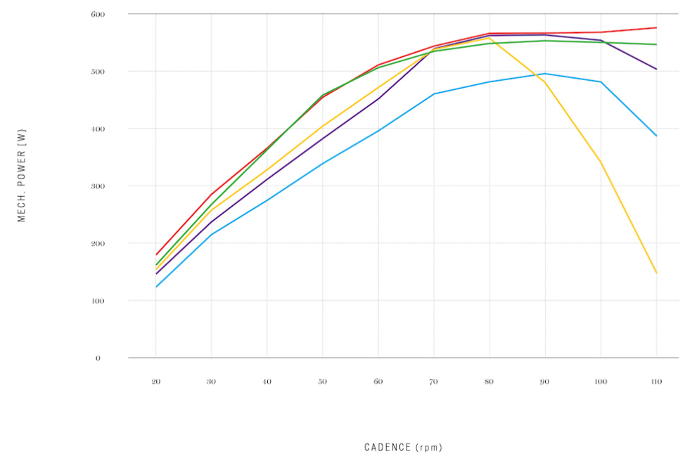

Underneath you can find a graph which shows the maximum mechanical output power of the 2.1 motor:
But we are now zooming in on the max. electrical input peak motor power which is a result of the current (A) and max. voltage (V) at a specific moment. As I promissed I will do a test within next few days where I will first full charge the battery as I need to have the max. voltage.
The difference between the maximum mechanical output power and the electrical input power is the efficiency. Now I am starting to doubt as well. You would expect a high value would be the best here. I am now starting to doubt as, as long as the mechanical output power is at 560W, the higher the electrical input power (of which you like to record the highest value) actually means we would like to know the worst efficiency possible to reach that 560W. Do you understand my thought? Maybe you have other better ideas?

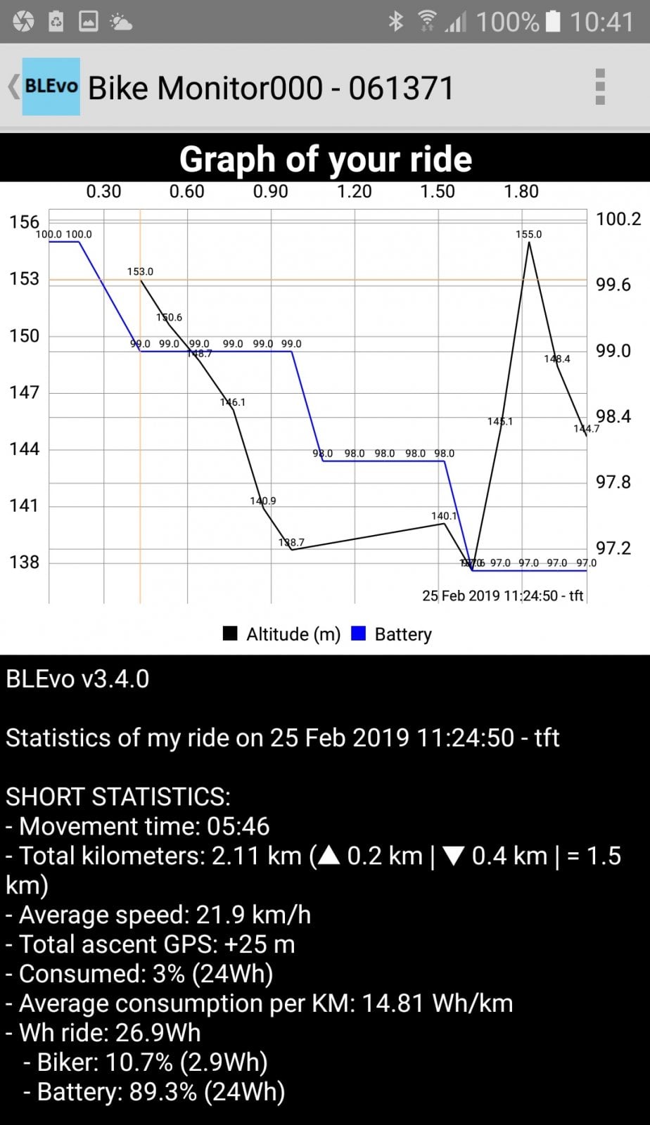

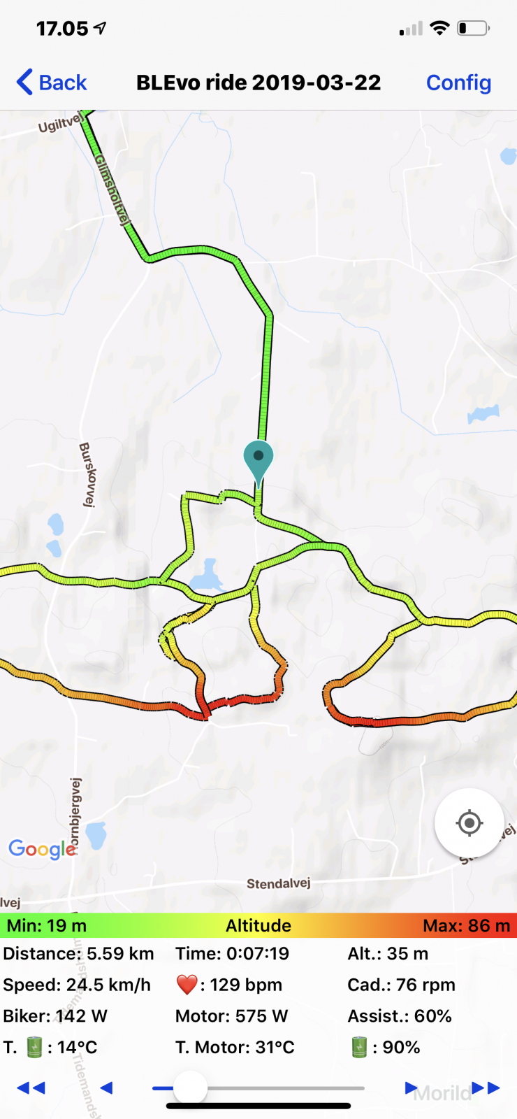

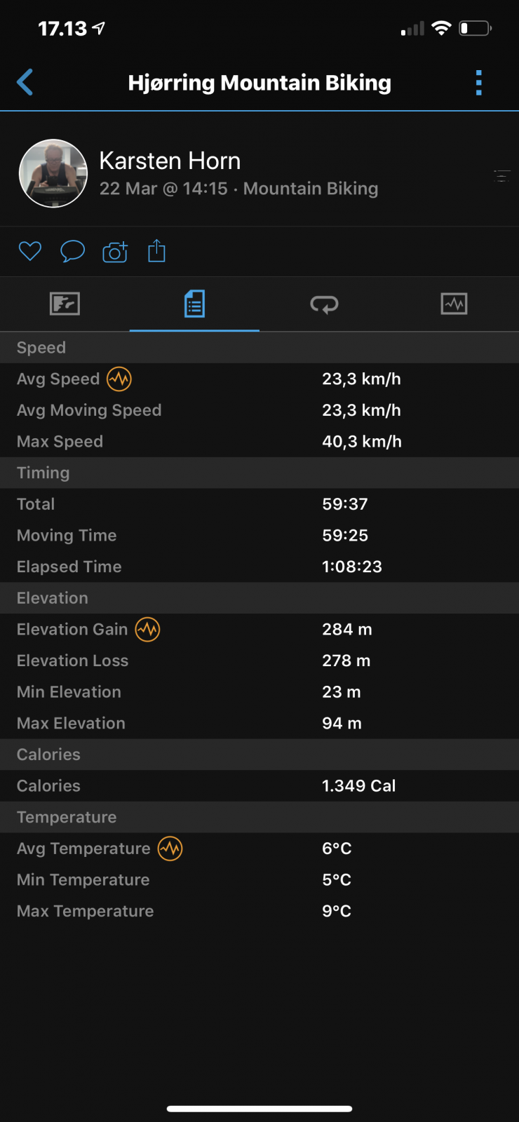

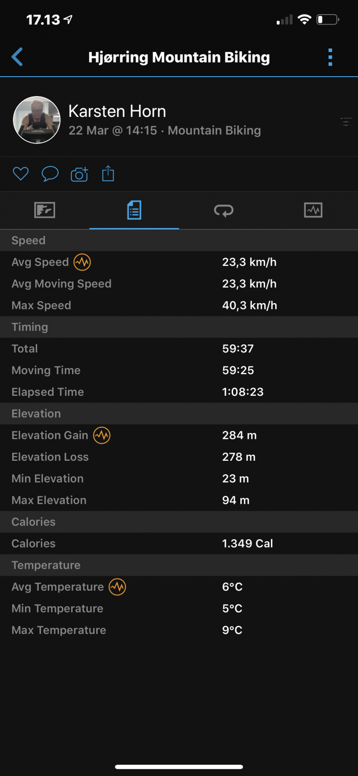

I tried to use BLEvo to record my ride for the first time today and for some odd reason it is showing exactly double distance but the speed is correct. As you can see below I have ticked the box to use phone gps as input:
This is the ride summary where you can see the totals and speed/distance is exactly double compared to real data:
Then when I go into the map view of my ride and look at a random spot(small asphalt road) the speed is indicated correct as seen here:
I would love to be able to move around with that speed but no way I can pedal that fast on a flat road without serious assistance ?
For reference here is the statistics from my Garmin:
What am I doing wrong?
Karsten
Hi Karsten,

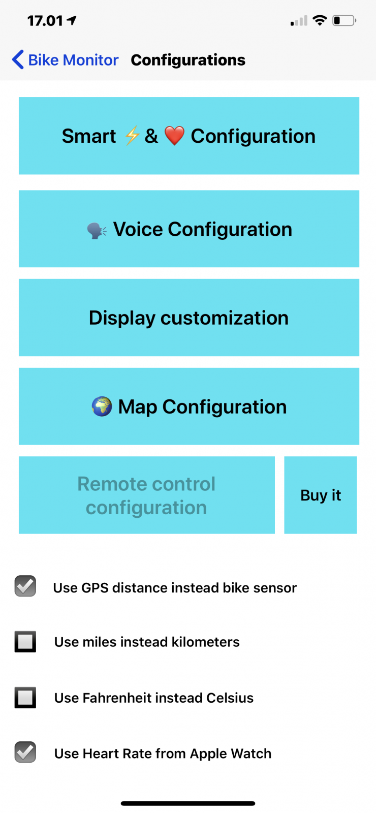

Did you set the real wheel circumference? There are two sliders. One for speed the second one for wheel circumference. Here you need to enter the real wheel circumference.
I think you should not select use “gps instead of bike sensor” in your case. Adjust it and just try a very short ride of 1km if it now works correctly. I am curious about the result.
Hi Karsten,
I did set the wheel circumference correctly and funny thing is that in map view replay speed is correctly indicated but distance is double up - Very strange!
Karsten
Maybe there is a bug in the latest release of this week but I guess Paolo needs to check it...
Karsten
Hi @khorn , thanks for your post..
I think there is a bug in the distance counting as @Maastricht says.. try to remove the speed to use the gps..
I will fix in the next release..
Thanks again.. and sorry for the issue

Hi @Kiwi in Wales ,
Hereby my results:
Sorted by electrical motor input power (largest to smallest):
Sorted by biker power (largest to smallest):
Sorted by current (largest to smallest):
Long list where I received a max. of 20A.
Hope this helps...
Thanks Paolo, I’ll try that on the next ride.
Karsten
Hi @khorn, I didn't found the bug in the distance calculation...
Could you send the CSV file to [email protected] ?
Thanks.
Paolo.
